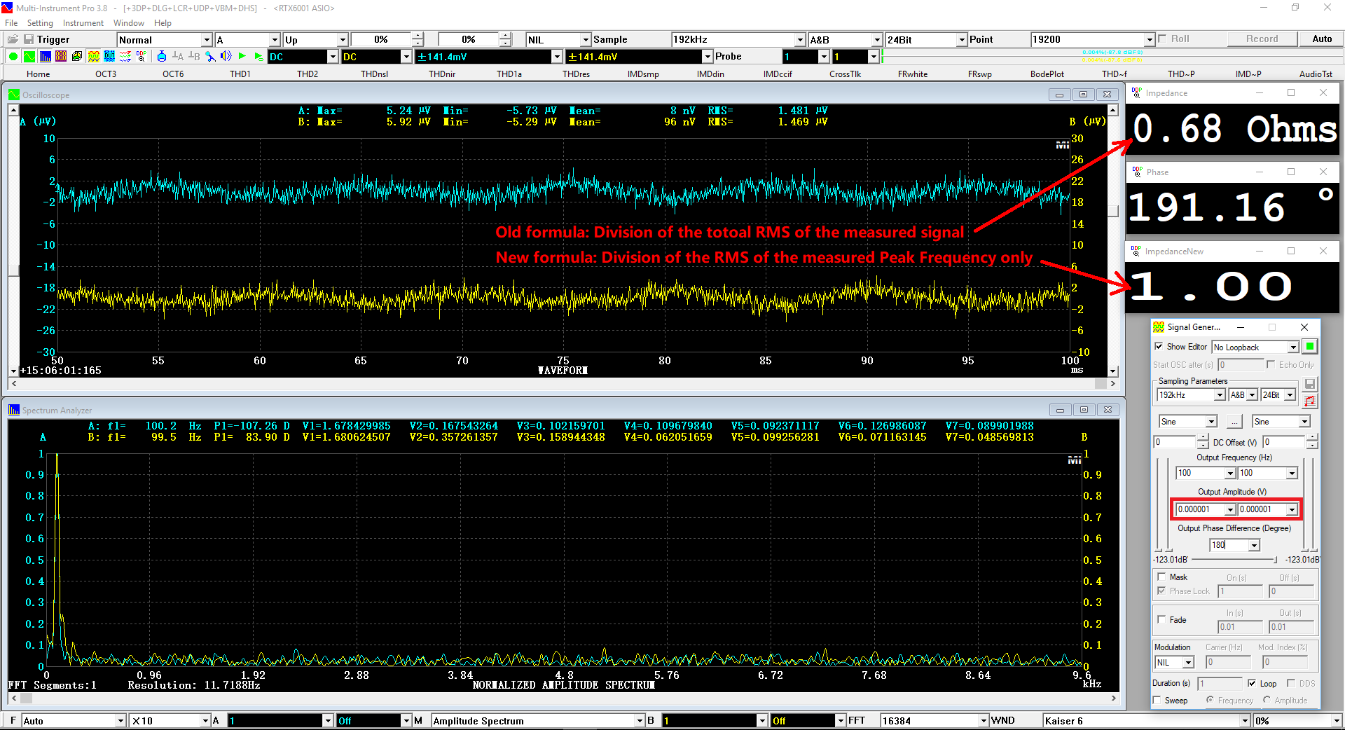

2. Improvement on Impedance Formula
I realized that the impedance UDDP definition can actually be improved. Currently it is defined as:
1*[RMS_A(EU)]/[RMS_B(EU)]
where [RMS_A(EU)] and [RMS_B(EU)] are the total RMS values of Ch.A and Ch.B respectively. It would be better to use the following formula instead:
1*[f1RMS_A(EU)]/[f1RMS_B(EU)]
where [f1RMS_A(EU)] and [f1RMS_B(EU)] are the RMS values of the peak frequency detected in Ch.A and Ch.B respectively. The latter one is immune to noises. In the above example, the measured impedance is 1 ohms using the improved formula (see attached screenshot), which is more accurate.

Improving measurement SNR by narrowing the frequency band of interest
An impedance can be represented by its magnitude and phase in polar form, from which its resistive and reactive components can be readily derived. In this particular case, the magnitude of the power supply output impedance is equal to the division of the two RMS voltages (not the instantaneous voltages).
According to the previous measurements, the two RMS voltages are above 1mV which are not very small compared to the minimum voltage that RTX6001 can measure. However, it is of interest to check what would be the minimum voltage that RTX6001 can measure. I have thus performed a dual 1uV 100Hz sinewave loopback test (see attached screenshot). The generated amplitude is 1uV and phase difference is 180 degree. The measured phase difference is 191 degree. The measured voltage ratio is 0.68 using the total RMS and 1.00 using the RMS at the peak frequency detected (100Hz). So the latter is still supper accurate while the former becomes inaccurate under this supper noisy condition. This example clearly shows that the measurement SNR can be improved drastically by narrowing the frequency band of interest. This can be very useful in some cases.

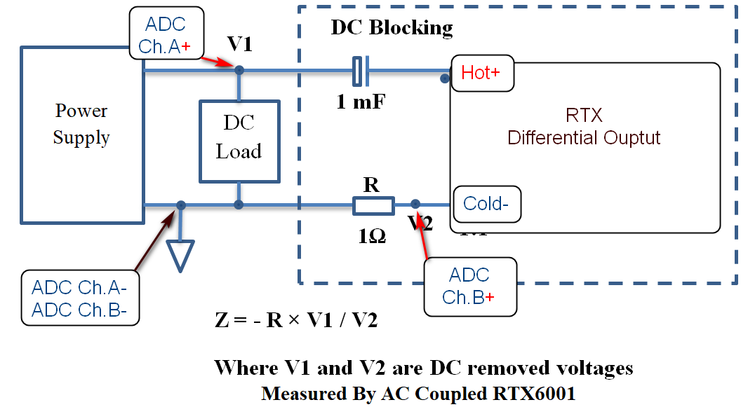

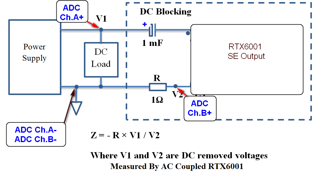

Here is the diagram, that I used for the Zo-Phase measurement
That will only work if there is no connection between the RTX chassis and the DUT. Measure the resistance between the chassis before connecting the low side.
If there is a connection you will be shorting the - out with the 1 Ohm resistor.
The Earth of the IEC plug connects to the PSU chassis, only.
The gnd of PSU isn't connected with the Earth of IEC.
RTX gnd and Earth of PSU is connected but RTX gnd and PSU gnd isn't connected.

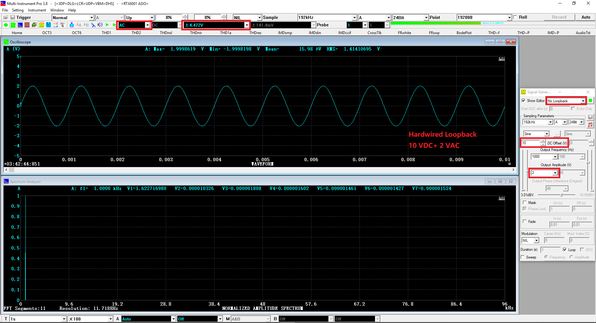

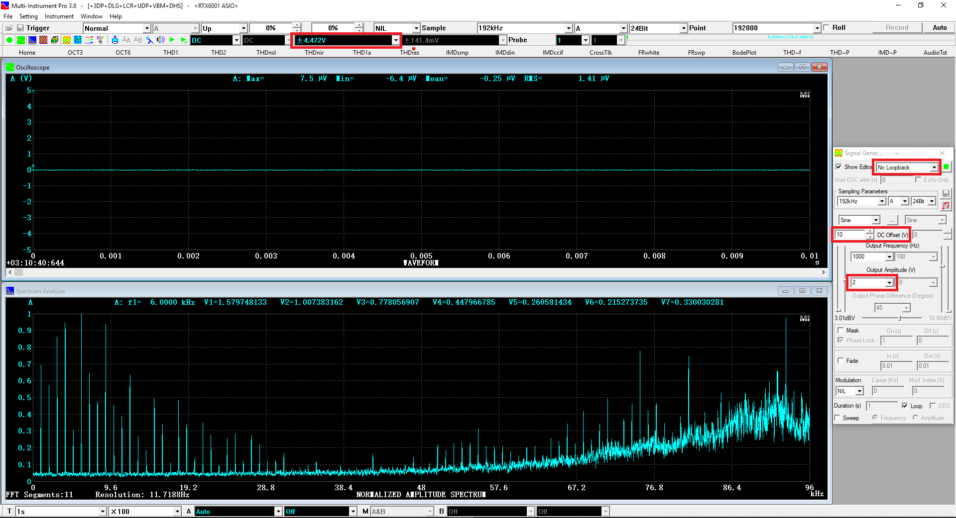

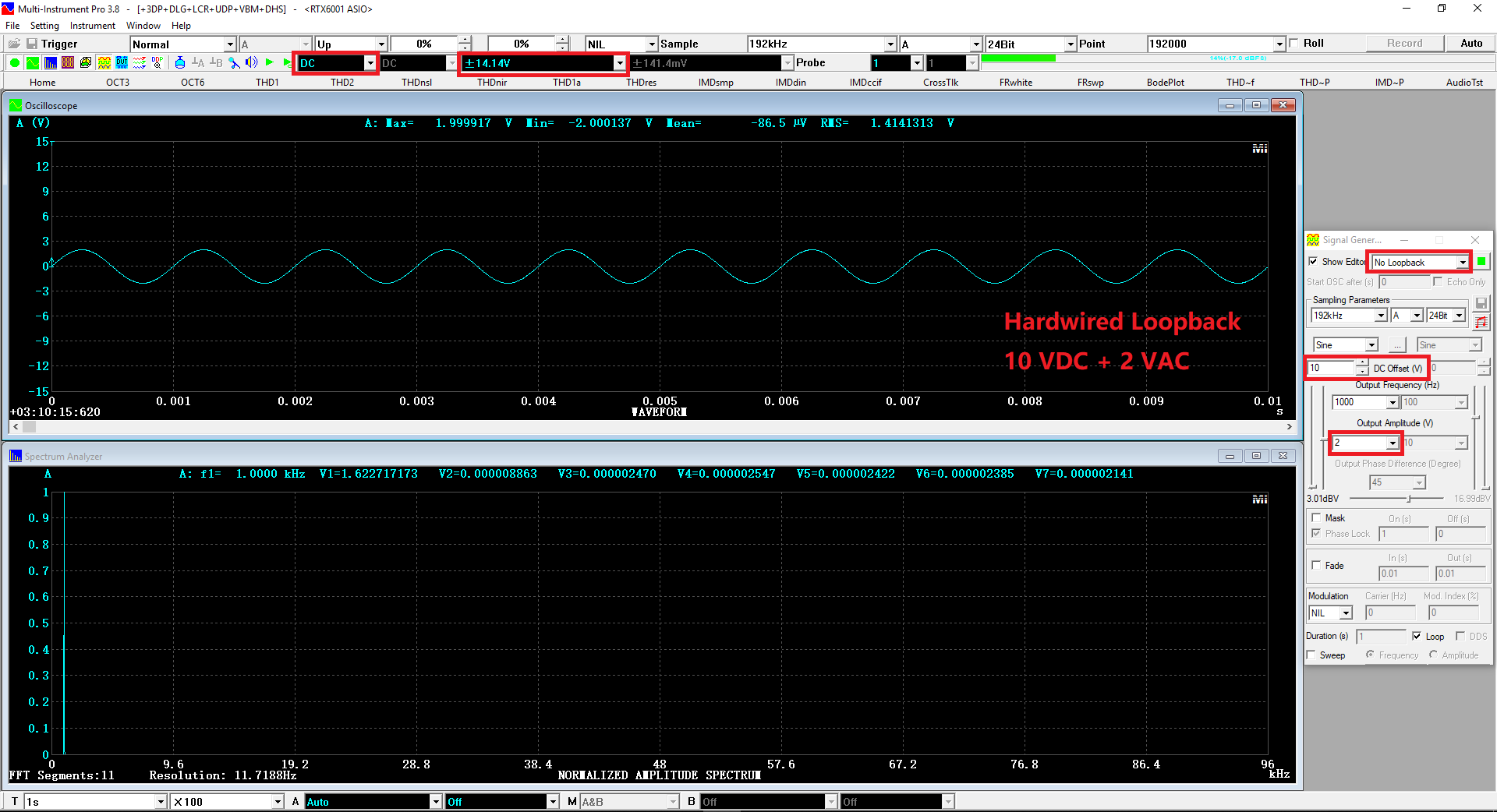

Some thing special about RTX6001's input DC coupling
@lemon
Thank you for the detailed information provided. I do not seem to find any problem on your connection described. It looks like that the issue should be caused by something else....
It had been known that RTX6001 could measure an AC signal only even under DC coupling mode. Therefore, the three Panel Setting Files (PSF) in this power supply output impedance test were configured as DC-coupled, in order to test the impedance at very low perturbation frequencies. However, the DC coupling is still DC coupling not AC coupling. It cannot measure a DC signal due to its internal digital high pass filter after ADC (my guess only). Under DC coupling, the DC component of the power supply under test will go directly to RTX6001's pre-amp which will cause it saturated if the input attenuation is not set properly. Therefore, the issue should be solved by using AC coupling instead in the three PSF files.
RTX6001 can output DC signals. I have thus performed the following tests to verify the above analysis. A 10VDC + 2VAC (amplitude) signal is generated from the RTX6001 signal generator (see attached)
Figure 1 shows the software loopback test. Both DC and AC components are captured in the oscilloscope.
Figure 2 shows the hardwired loopback test, input DC coupled, Input Range +/-14.14V. Only AC component is captured in the oscilloscope due to the high pass filtering after ADC.
Figure 3 shows the hardwired loopback test, input DC coupled, Input Range +/-4.472V. No signal is captured in the oscilloscope due to input DC saturation and digital high pass filtering after ADC.
Figure 4 shows the hardwired loopback test, input AC coupled, Input Range +/-4.472V, only AC component is captured (DC component is removed by AC coupling).
@lemon
RTX6001Output10VDC+2VACHardwiredLoopbackInputRange4.472VDCcoupled.png102.4 KB · Views: 318
RTX6001Output10VDC+2VACHardwiredLoopbackInputRange14.14VDCcoupled.png83.4 KB · Views: 310
RTX6001Output10VDC+2VACHardwiredLoopbackInputRange4.472VACcoupled.png82.3 KB · Views: 309

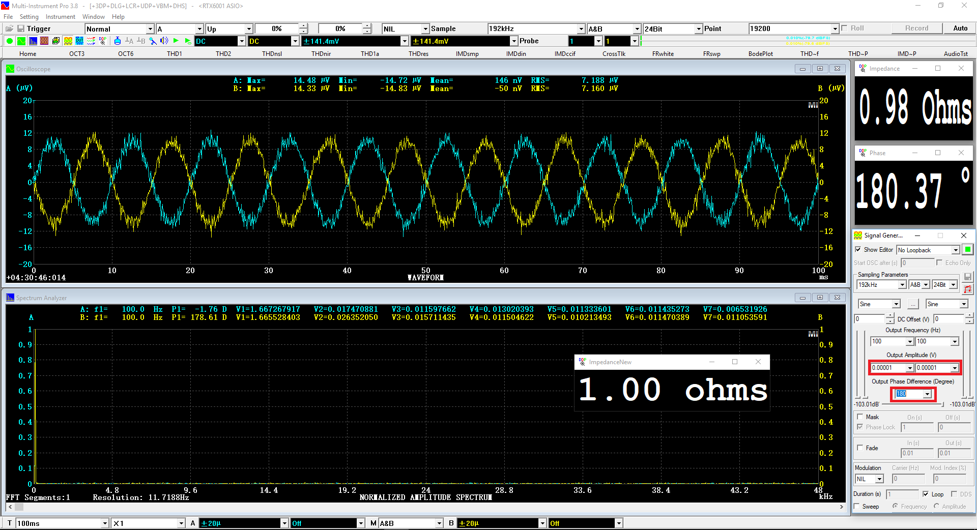

Thanks Virtins, for the supporting.
From what I have seen at your post, the issue that I have should be solved by AC coupling in the three PSF files.
I have done the tests and yes the issue has gone.

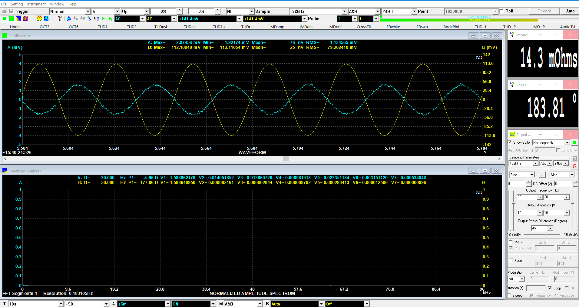

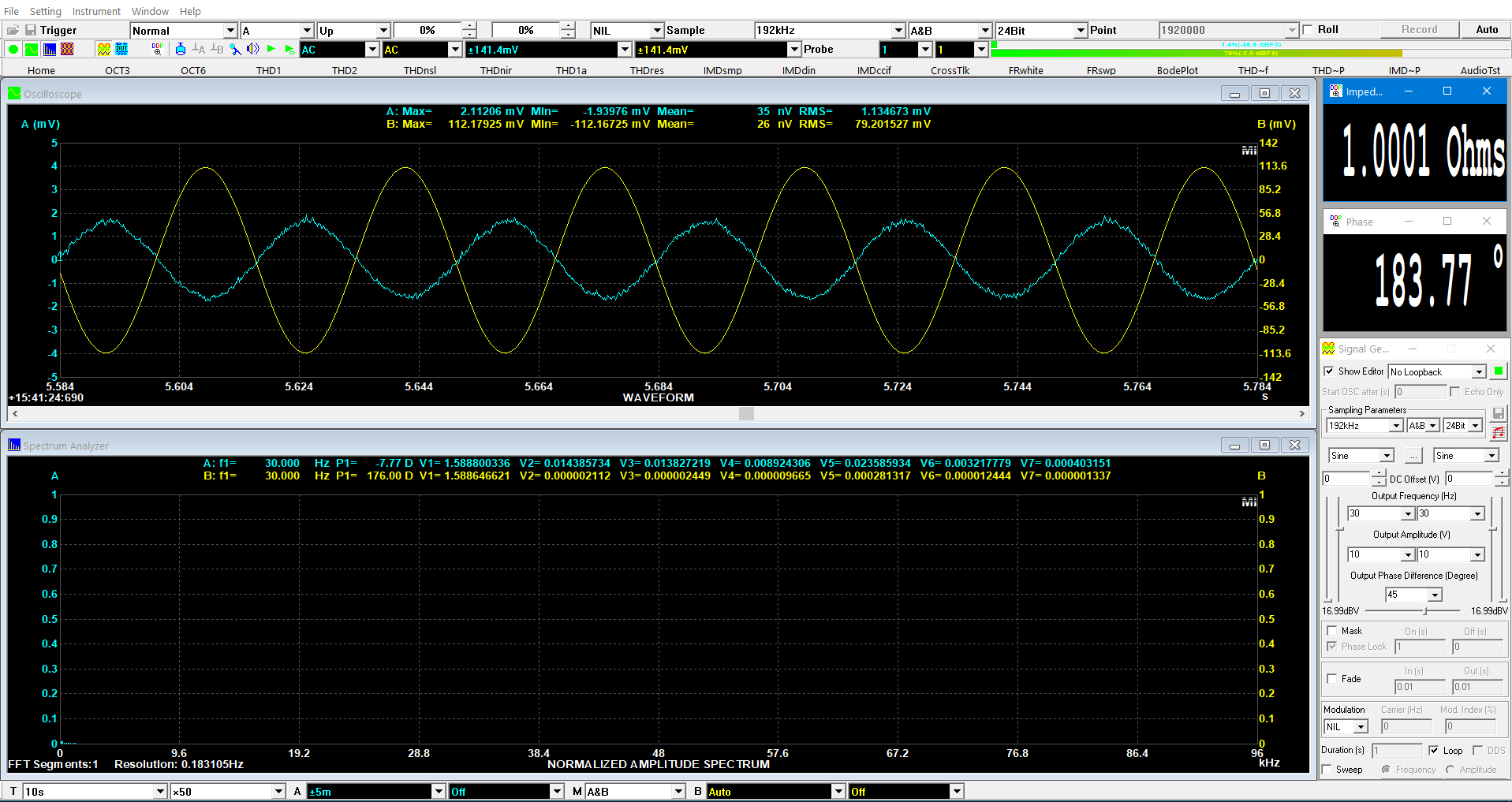

In the meantime, I tried and the new Improvement on Impedance Formula that you have presented at the #441 post.
I opened a psf file, set the coupling to AC with ±141.4mV level and Output Frequency to 30Hz.
The Zo Impedance Formula was the old.
The result was a Zo=14.3mOhms and a Phase of 183.81° (see the first attachment).
I kept the same settings but now I changed the Impedance Formula to the new one.
The result was a Zo = 1 Ohm and a Phase of 183.77°(see the second attachment)
The Phase has remain the same but the Impedance has a major difference, it is not a small change due to a more precisely formula!
For this reason, at the same time I connected a Fluke45 multimeter to the two measurement spots (V1/V2).
At the V1 measure the Vac output (1.22mV), at the V2 measure the current (63.51mA) through 1 Ohm resistor by the drop voltage (Vac) at the edge of resistor.
With that we have a Ζο=17.8mOhms.
At this example, It seems that the old formula gives more precisely results that the new one (14.3mOhms vs 17.8mOhms vs 1 Ohm).

Is the ESR of capacitor important to this measurement and if it is related, can we put a bigger capacitor than 1000uF for a lower ESR?
RTX6001 differential output impedance is about 100 ohms, the impedance of 1mF capacitor at 1Hz is 159 ohms, so the AC current is about 10 V/(159+100+1+0.0xx) ohms=0.038 A (peak) at 1Hz. The voltage drop across a 2 mohms impedance would be 76 uV (peak). To increase the SNR of the measurement, the excitation AC current needs to be increased, which is hindered by the output impedance of RTX6001 as well as the impedance of the DC blocking capacitor, especially the former as the latter drops fast with the excitation frequency.
ADC xlr cables (for V1/V2 spots) are important to have the minimum length?
No, given the 200k input impedance of RTX6001 and the low testing frequencies.
RTX6001 Unbalanced Zo is 50 Ohm.
From this point of view, probably is better to use the SE output against the balanced.
The SE output voltage is only half of the differential output voltage. So the AC perturbation current does not increase with the SE output.
