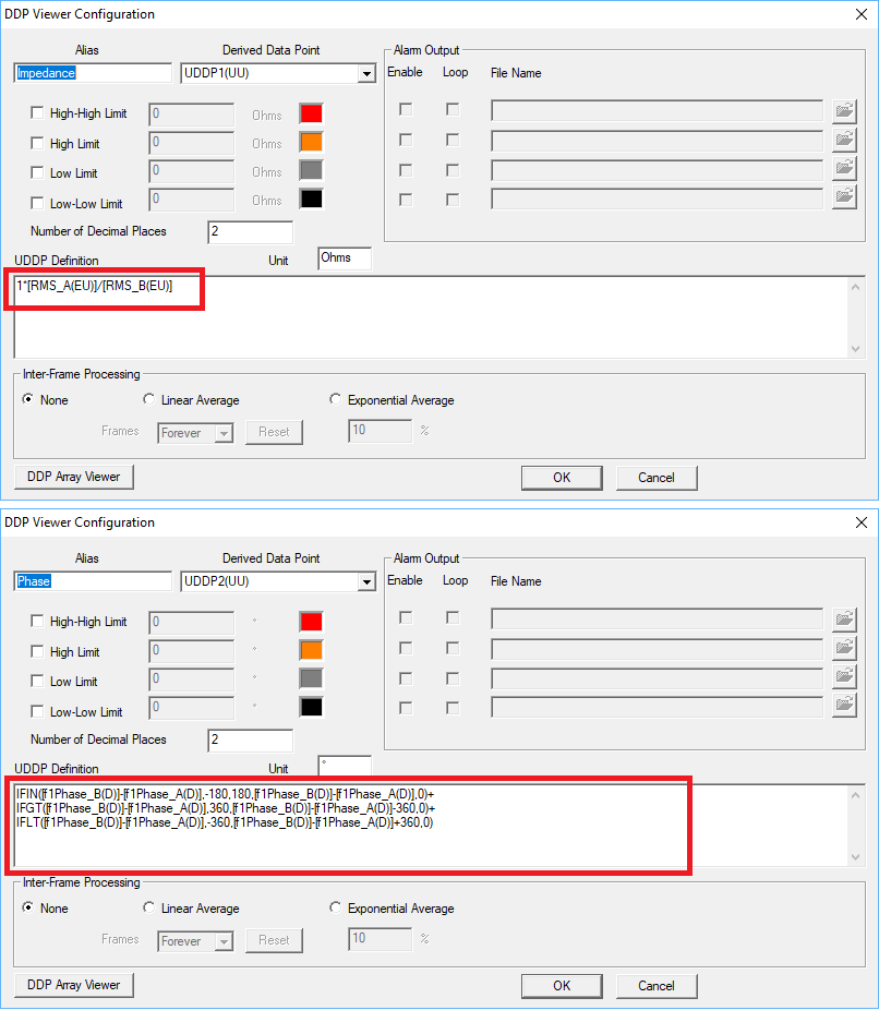

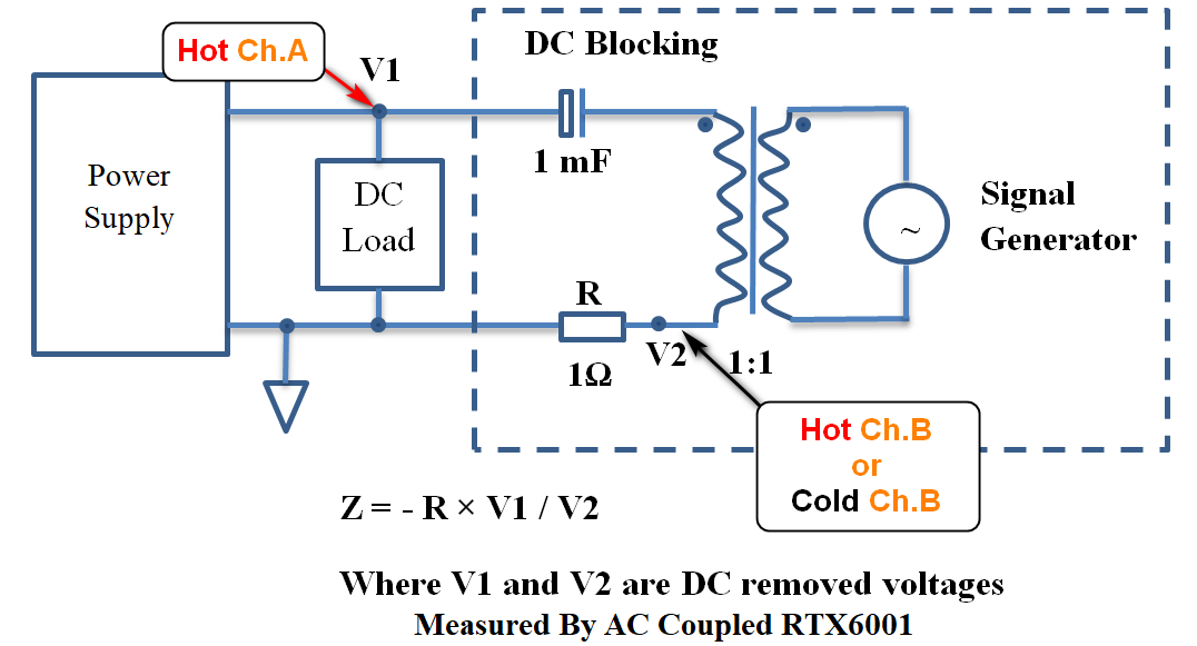

Measurement of Power Supply Output Impedance at a particular frequency
The output impedance may be DC /average load dependent. Therefore a variable DC load would serve the purpose.
Attached is a sample Panel Setting File which can be used to measure the power supply output impedance at a particular frequency. It can be loaded into MI via [Setting]>[Load Panel Setting]. The two UDDPs are defined as follows (see attached screenshot):
1. UDDP1 (Impedance): 1*[RMS_A(EU)]/[RMS_B(EU)]
2. UDDP2(Phase):
IFIN([f1Phase_B(D)]-[f1Phase_A(D)],-180,180,[f1Phase_B(D)]-[f1Phase_A(D)],0)+
IFGT([f1Phase_B(D)]-[f1Phase_A(D)],360,[f1Phase_B(D)]-[f1Phase_A(D)]-360,0)+
IFLT([f1Phase_B(D)]-[f1Phase_A(D)],-360,[f1Phase_B(D)]-[f1Phase_A(D)]+360,0)
The above phase definition here is a little complicated than its simplest form “[f1Phase_B(D)]-[f1Phase_A(D)]”. It wraps the phase difference into the range of -180 degree ~180 degree. The definition of those math functions IFIN(), IFGT(), IFLT() can be found in Section 10.2.2 of the software manual.

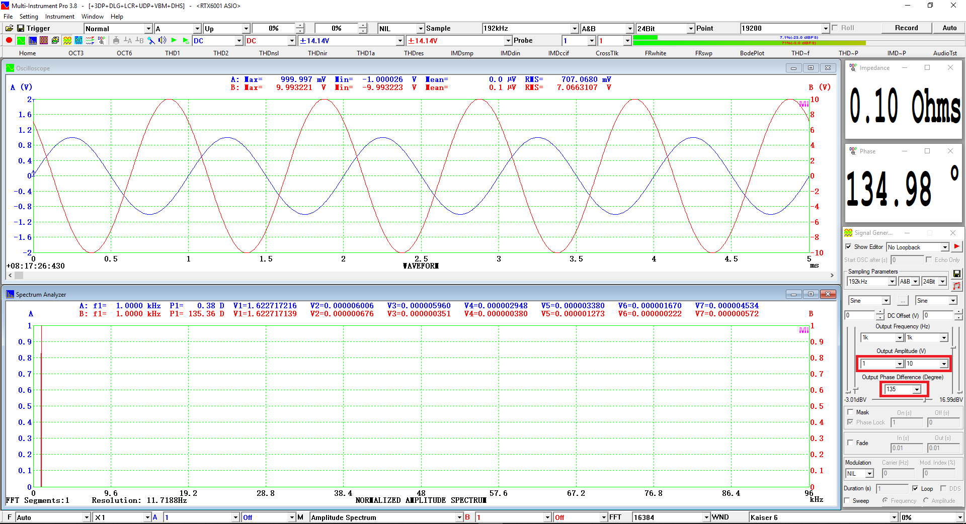

The attached last screenshot shows a loopback test result using this PSF file. The signal generator generates a voltage ratio of 0.1 and phase difference of 135 degree in the two channels. The measured impedance and phase shift is 0.1 ohms and 134.98 degree respectively.
OK, I will try the method 4 via Device Test Plan, but I will need more time, the DTP procedure is unknown to me for now.
I have a Rigol dc load, then it is easy this implementation in my situation.
But, it is not clear to me the role of the dc blocking capacitor and line transformer in the circuit?

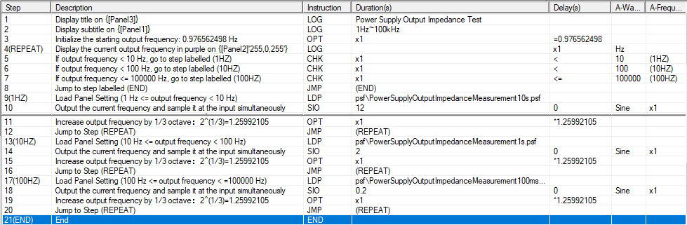

Measurement of Power Supply Output Impedance in a frequency range
Attached zip file contains a sample device test plan which can be used to measure the power supply output impedance in a frequency range from 1Hz to 100kHz at a step of 1/3 octave. It contains three Panel Setting Files (PSF) and one DTP file. The PSF file should be put in the \psf subfolder of MI, and the DTP file should be put in the \dtp subfolder of MI. Then the DTP file can be loaded into Device Test Plan to run.
The test plan uses a variable X1 to generate frequency stepped sine waves from 1Hz to nearly 100kHz (limited by RTX6001’s max. sampling rate 200kHz and its analog bandwidth). In each signal output step, the test frequency will be increased by 1/3 octave: 2^(1/3)=1.25992105, that is X1=X1*1.25992105. (It is also possible to specify test frequency explicitly rather than using variables. Specifying test frequencies explicitly is simpler but needs much more test steps)
The lower the test frequency, the longer the sampling duration required. Three PSF files are thus created for 1Hz~10Hz (10s), 10Hz~100Hz (1s), and 100Hz~100kHz (100ms) respectively. They are:
1. PowerSupplyOutputImpedanceMeasurement10s.psf
2. PowerSupplyOutputImpedanceMeasurement1s.psf
3. PowerSupplyOutputImpedanceMeasurement100ms.psf
The script of the test plan (PowerSupplyOutputImpedanceTest.dtp) and its loopback test results are shown in the attached screenshots.

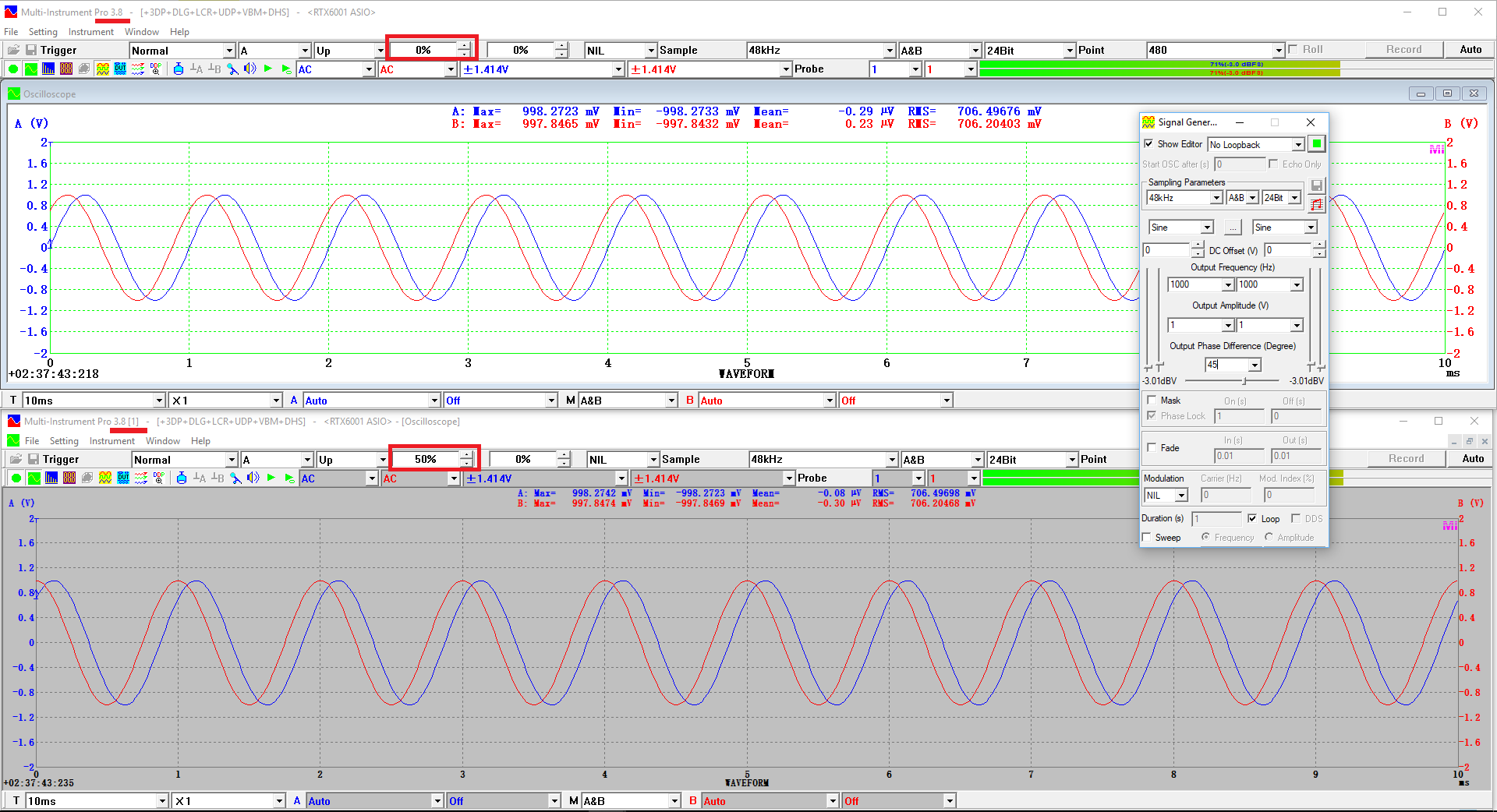

Multi Instances of Multi-Instrument
Yes, currently one instance of MI supports two analog input channels only. Multiple instances of MI can be launched from the same PC. Each instance can point to different ADC devices, different pair of channels of the same ADC device (sound cards) , or even the same pair of channels of the same ADC device (sound cards), thanks to the multi-client support capability of MME driver and some ASIO drivers.
The attached picture shows two instances of MI pointing to the same pair of input channels of RTX6001 under ASIO. Instance 1 has the trigger level set at 0% while Instance 2 has the trigger level set at 50%. And they work independently in this regard. There can be control conflict, though. Usually the RTX6001 follows the latest control received.

Correction on Post #401 and #402
Sorry, I made an error in the UDDP definition of the Phase Shift. It should be defined as follows:
UDDP2 (Phase):
IFGT([f1Phase_B(D)]-[f1Phase_A(D)],180,[f1Phase_B(D)]-[f1Phase_A(D)]-360,0)+
IFLT([f1Phase_B(D)]-[f1Phase_A(D)],-180,[f1Phase_B(D)]-[f1Phase_A(D)]+360,0)
The device test plan containing all the required PSF files is attached here.

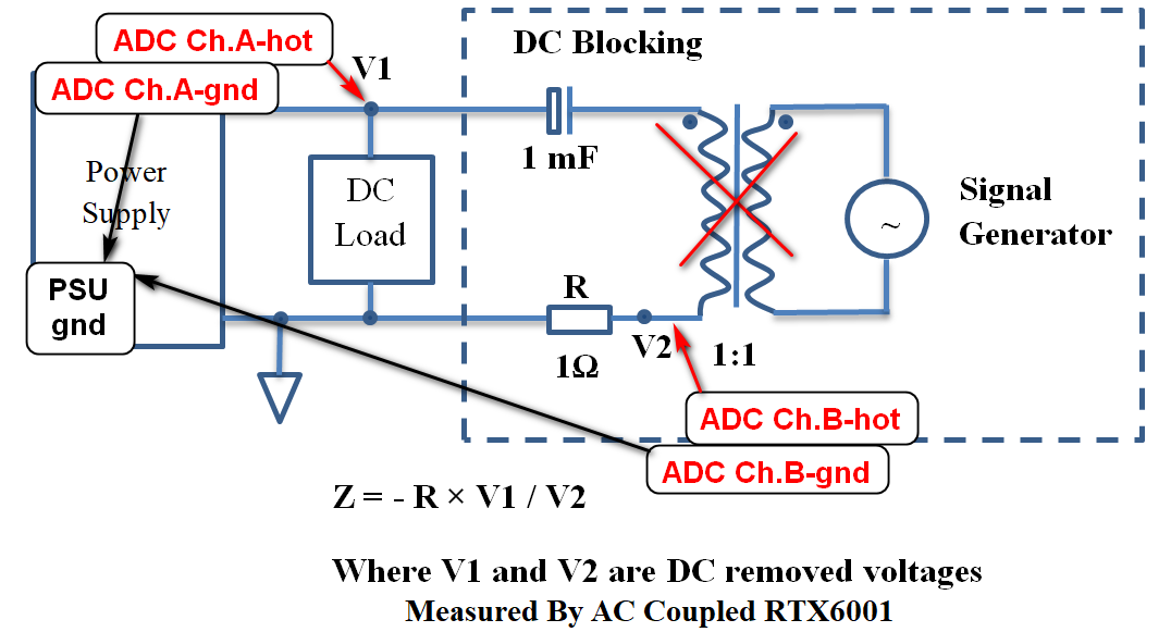

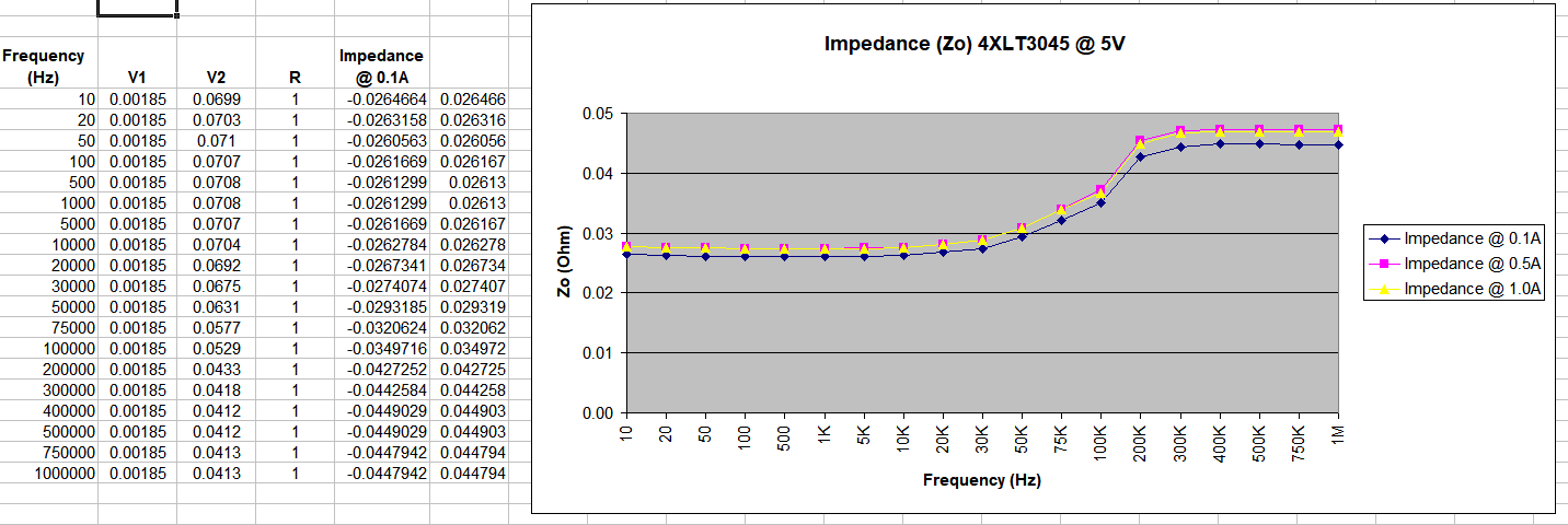

Guys, something goes wrong with my measurements.
I have made two kind of Zo measurements.
A. without RTX - two Fluke RMS multimeters on V1 & V2 measure Vac values . A function generator (Hameg HM-605) feeds the ac signal without any transfo btw. A Rigol dc load, a 1uF capacitor and 1R resistor.
The following diagram seems the connection on this test.
Here the array with results and a diagram of Ζο on three dc-loads (0.1/0.5/1.0A).
At the Impedance Zo column the formula Z=-R*(V1/V2) used for the Zo, but this gives negative values! I used the positive values of them and draw the diagram.

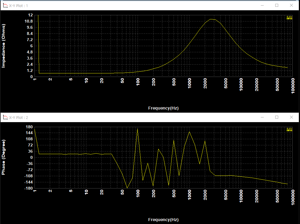

B. Next, I followed the Virtin's directions with the RTX-6001 (I removed the 1:1 transfo, I haven't complete yet). The connection was as following:
I run the script on DUT and I had completely different results than A
What I have done wrong! Please, any help will be welcome!

1) The signal output of RTX will be the SE?
2) As you wrote we used the two ADC inputs Ch.A & Ch.B. for the V1 & V2 respectively. For V1->hot(2) of xlr Ch.A and for V2 hot(2) of xlr Ch.B or cold(3)?
3) What about gnd(1) of xlr? We let them without connection?
1) Using differential output would nearly double the output voltage, as compared with SE output, which is preferred when the power supply's output impedance to be measure is very low.
2) V1 and V2 are ground referenced voltage. V2 hot(2) should be used. Using cold(3) of xlr Ch.B is also OK, as long as the 180 phase difference is accounted for in the phase vs frequency plot. It will not affect the |Impedance| reading.
3) No need to connect gnd(1) of xlr.
