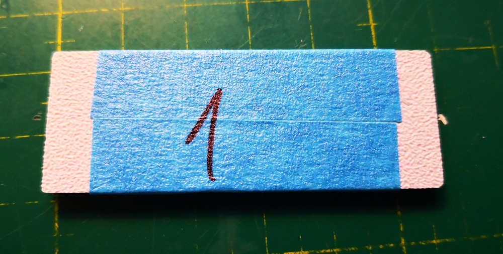

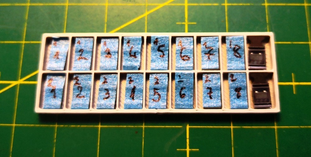

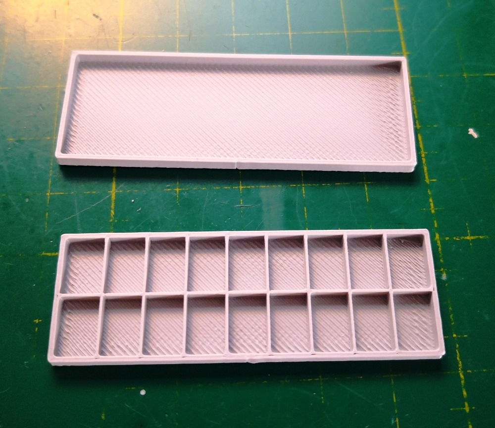

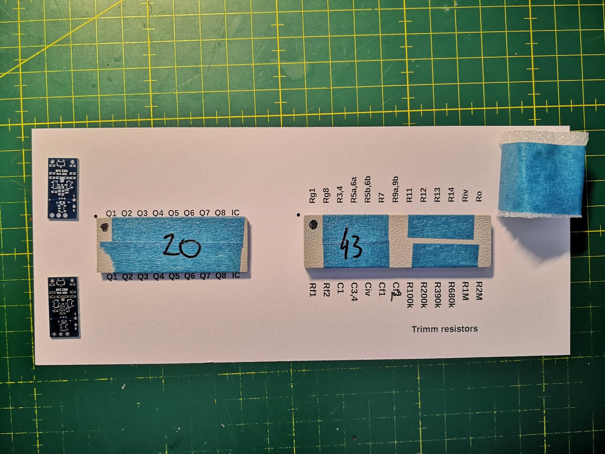

Hey, guys I finished measurements, so now I need to take a look at the numbers and pair them together, order some other parts and put everything together in nice packaging so everyone will know what is what... Go easy on me I just recovered from Covid...My holidays were mostly spent on my couch watching TV...

3D custom printed boxes for matched devices !!!
