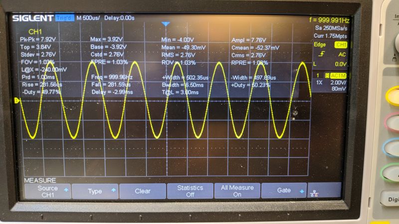

Today myself and @EUVL did a second beta test on the SMD FC CEN IV, testing each stage of the circuit section by section and everything checked out OK. This is good news as it verifies functionality and gives very good assurance that the built modules will function excellently. Everything seems completely stable, 2 hour stability test was as expected.
Photo attached of a 1khz sine wave and the subject of the experiment.....

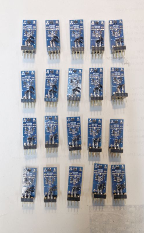

Hey guys, quick update.
I managed to solder 13 pairs so far. First 10 pairs will be on the way to Fran for testing and final assembly this week. And I plan to finish the rest by the end of the week, and send them to Patrick next week...

20 units are now in Ireland with Fran, the other 20 on their way to me, i.e not arrived yet.
That was how long Ripster needed to solder part of the components to reduce our work load.
Fran tested the first unit, and both MOSFETs were defect, most probably due to electrostatics during handling.

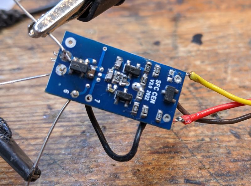

A short update from me.
I have now finish tested and built 10 of the 20 units sent to me.
3 units needed MOSFETs replaced; another had a defective resistor.
They are now all finished except for DC trimming.
Without trimming, DC offset is 40~60mV, very consistent.
AC tests behaved as intended.
So no design fault, and all (unobtanium) JFETs worked perfectly.
The only defects were damaged MOSFET gates, most likely due to electrostatics during handling.
Each unit took me 1.5~2 hours to build and test.
This is longer than normal as we have to build in small steps in order to locate defective parts, before they can damage the rest of the circuit.
I shall finish the remaining 10, trim DC for all, and then send to Fran for burn-in tests.
He has similar progress, but it will still take a few more weeks to finish the rest.
