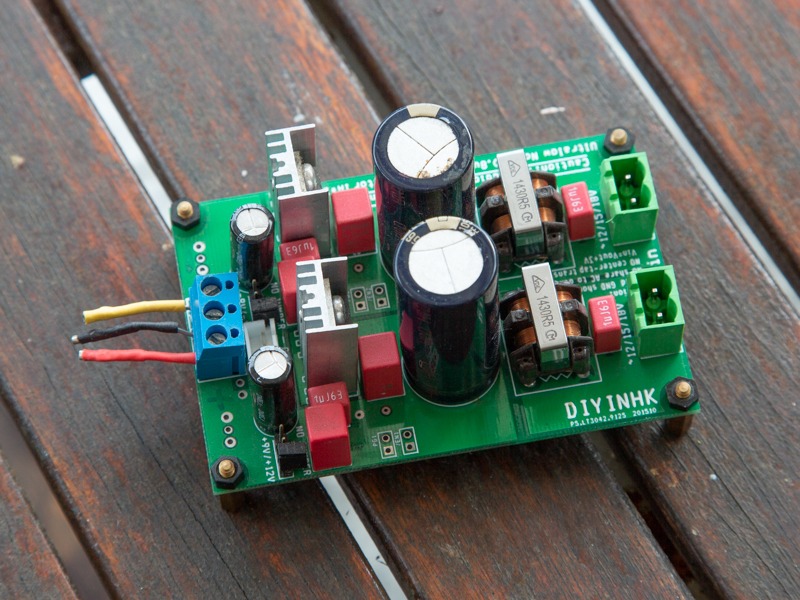

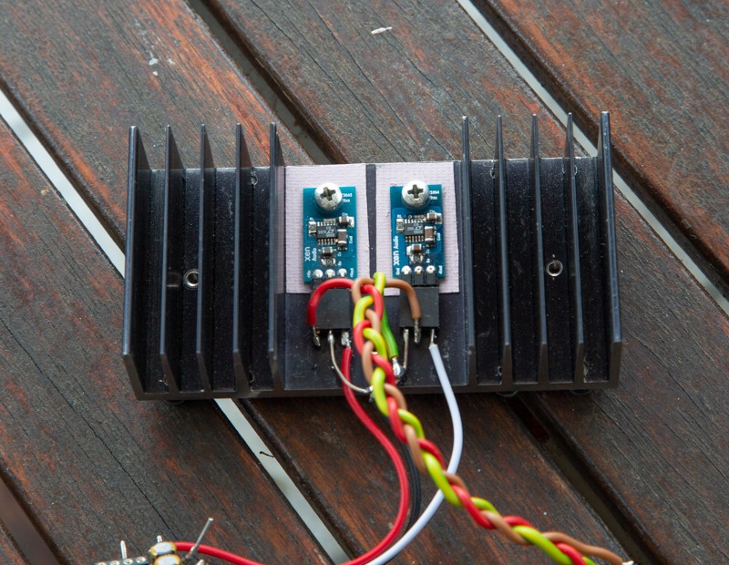

We've had a few queries on power supplies - unsurprising given the advice already given in earlier posts.
Personally I have used 2 supplies with success:
1. Diyinhk low noise supply - based on 2 LT3045 tied at the output to give bipolar supply. This supply is long since replaced I believe, and as EUVL has mentioned above, please do verify layout and components if buying something and not DIYing yourself. With this type of arrangement you must have 2 separate secondaries in the transformer.
2. A supply loaned to me by EUVL to help in testing. It is a true complementary supply using both LT3045 and LT3094 and are regulators only - a pre-regulated supply is needed.

Would EUVL be willing to share the boards/artwork for the LT3045/LT3094 regulators? I purchased the (new) DIYinHK solutions but it would be nice to have something vetted for components as valuable as these.
