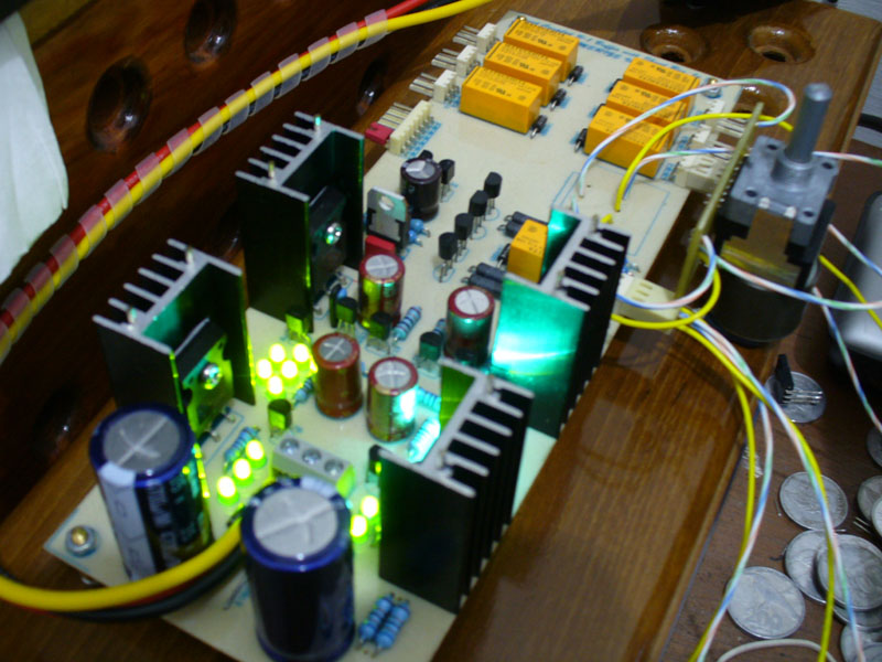

I have just tested the assembly ( basic version) after goofing LED connections and missing one jumper. Everything looks allright except relay power.
- There is an oscillation across Relay power - around 5 -6 Khz - causes Whooshing continuous sound. IF you check voltage across the diode/could see 5 khz oscillation ? The sound starts when start delay finishes and power is applied to the Relay? I have to check few things later today when I come back in the night to work on this. I also see voltage being 10.5 V and -11.1V not symmetrical due to LED mismatch probably. I will do further testing later. I will try to load the picture soon

Yes, after the capacitor gets up to 6-8V, the npns open and latch the relay. Then you can have sound. What bjts you used there? You can see the relay voltage on the oscope between the 600R//600R and ground. Oscillation there? Mysterious.

Try another type of low Hfe NPN transistors in the delay circuit? Like BC182,3,4. But first it has to be seen with oscope. If its there, stick a 0.1uF between 7812 out and ground pins directly on them underneath the board, first.
I found the relay driving NPN ( BC550B) is having Oscillation. I connected a ceramic .1uF across its base to earth . This reduced this to a minimal level and the sound is gone. The sound is coming from relay chatter due to low frequency oscillation. still I see a small oscillation on my Fluke 867( I do not have a scope but my Fluke 867 shows oscillations as it is almost a mini scope). I may have to try a different NPN here or a suitable cap across the supply line. I am going out now and will be back after 8 hours to do further testing. Offset is almost nil on the buffer side. The Regulation seems fine and it looks working fine except this small oscillation and it is near the Buffer amplifier /so should be eliminated completely

Probably some trace inductance or the TQ type coil excites the 550s. But there is no reason to be 550s. They can be much slower. We check a couple of suitable ones and update the BOM. Or stick a ceramic underneath. Try between collector and base also. Crt did not use TQ relays and did not chance on such an issue. Neither did I. Leave your reg assymetry as it is, it worked fine with your JFET matching in your audio side. Still we have to see if that warmer than others mosfet has a different enough vgs or its 3 leds are a bit strong. We will know when you tell me the R1 vdrops. Good for now.

sorry, i forget to tell if i use PC for source so i don't need volume control.🙂
i put 22k to replace 220K.
but after i read this, i try to put pot. (alps motor) 50K and change the 22K with 47K.
everything is fine, NO PROBLEMO!:cloud9:
