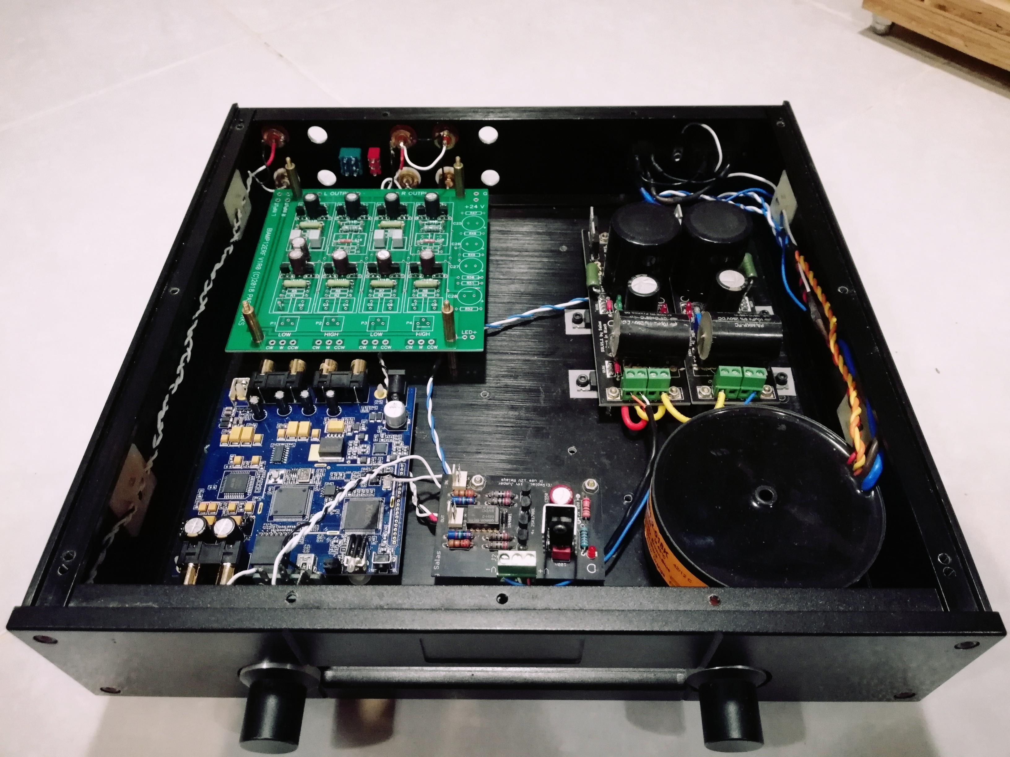

previously I was using dcb1 to drive FW clone and behringer nu3000dsp, now i got another step into 4 ways with additional minidsp 2x4HD and LXmini board.
if my memory still good, behringer has around 20+ kOhm input impedance, while i dont find any details on minidsp but maybe the same around 20's because it must be using opamp input buffer. With 25k LXmini potentio, it means dcb1 might see around 5k load.
will this be OK? i still have alot of SK170 pairs hence I can build another 4 buffer but no space on my chassis 😀

I wouldn't recommend below 10K loading due to the limited current a small JFET like the 2SK170 can provide. The load limit mostly depends on the interconnect wires length and their per meter (or foot) capacitance spec. The higher the frequency and the higher the signal amplitude more current is needed to charge the load capacitance faster. Fortunately in music the HF energy is usually lower than in the power range 200Hz-800Hz. Bottom line is, if you won't hear HF smear or distortion in your setup its still sufficient. Use low capacitance cables in your situation.
If there were no interconnects and no other load capacitance, or much available drive current, the minimum would be 2.5k loading due to the DCB1's 250Ω Zout (satisfying 10xZo loading rule of thumb).
DCB1 has around 30Ω Zo from the JFET itself + 220Ω from the output resistor (anti-oscillation guard). The resistor's value can be lowered when there is fixed low capacitance loading. If square wave is still good on the oscilloscope without ringing edges and no whistle noises are born in the listening then the lowered value is enough.
