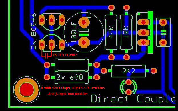

Finally - 12V with jumper at 600 Ohm resistor location also caused chatter- increases with the cap aross base to Earth ( more of short spikes from the Transistor collector) I soldered .15 UF Cap across base and collector of BC 550B , it stopped. I removed the other Ceramic 10NF cap. Now I see 3mV noise across supply to the coil. So solution is this Cap incase you hear Whoosh type of noise from the relay or provide this on the BOM. BOM should also specify jumper for 12V relay clearly.

Good work Kannan! Chatter occurence remedy is 150nF ceramic cap from relay driving BC550's base to collector underneath, direct to transistor with short legs. Check.
Is my attached guide OK?
