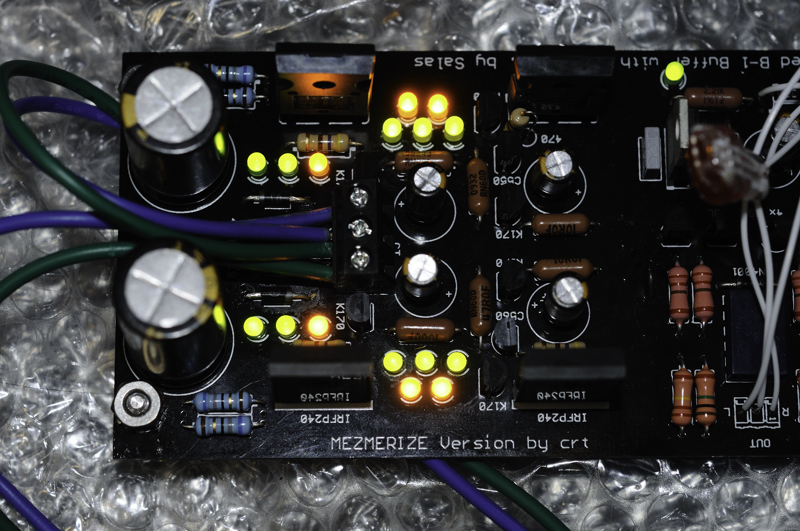

I crawled a little closer to my build and took two more photos.
So.... How mad am I? I just got my resistor order, all my nice Takmans are there and the prps for the rest are there but instead of 68R they sent 68k!!! I double checked my order and I definitely ordered 68R. Darn, darn, darn.
You don't need quality resistors for the 68R//68R position. They just set the DC current. Any decent metal film will do. What you got in your drawer? Do you have any 33R 0.5-1W? Or 6x 100R 1/4W? There are pads for 3X100 per side. We have given some play space there with Crt.
That's good news, I'll see what I can dig up. Looks like Radio Shack, a local store, should carry either the 68r or 100r. I will be able to pick some up at lunchtime. I'll be listening to this thing tomorrow!!
No worries. Pick 6X100R 1/4W from RS local store. Later on you can get your PRPs for aesthetic continuity with the other PRPs against the black PCB. For sourcing the DCB1, their total dissipation will be around 130mW per side. I advise 0.5W to 1W total capacity, bcs I have found that resistors in general, better be at least 3X dissipation safe so to last for ever.
If others gonna use the regs part only, those resistors will change for much more current, and sinks or metal floor Mosfet mounting will be a must.
