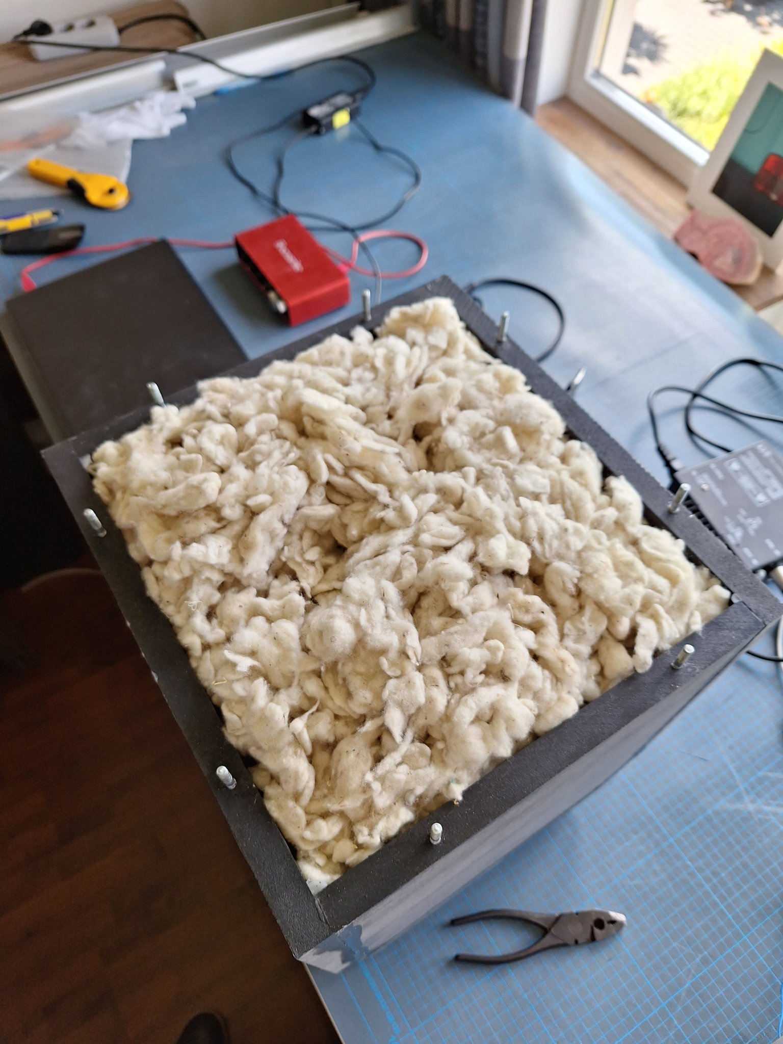

@ctrlx , the wool i used in the test , the 900gr case:
This is wool that has been in use from 1991 till 2006, as a result the fibres curling making the flake like shape of the pieces of wool when pulled from the pressed block of wool into more curved shaped lumps .
Quite different from lhw ;-)
Obviously this happens especially with woofers, for midranges this curling is a lot less.

with reference to the picture in post 82, do you leave some space behind the driver to allow it to breath?
Not sure what you mean. What i do is cover the openings in the basket with an fabric netting quite open so the wool cannot get in touch with the cone or spider.
Then when applying the wool, the wool nuggets against the netting are placed loosely, i pull them a bit looser. Then the remaining wool is placed.
One thing to avoid is an open space. It can become quite audible. The wool content has to sit quite firmly in the cavity.

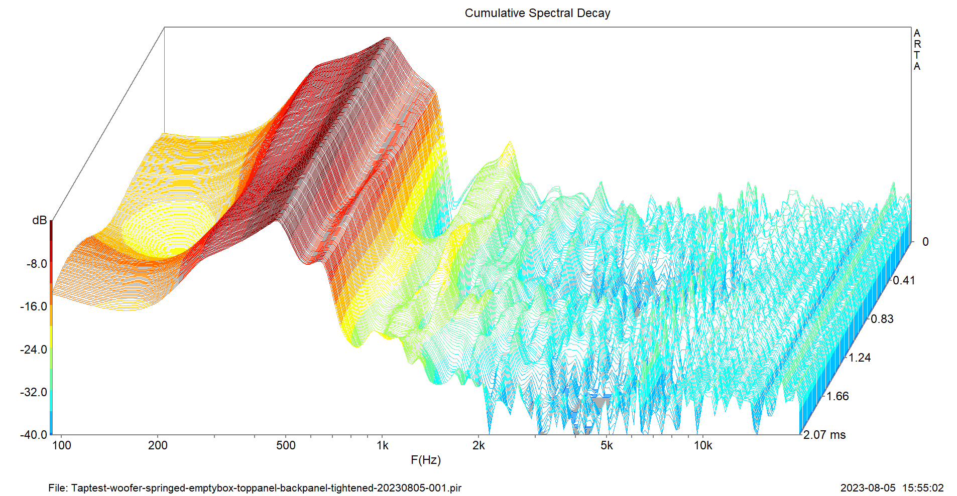

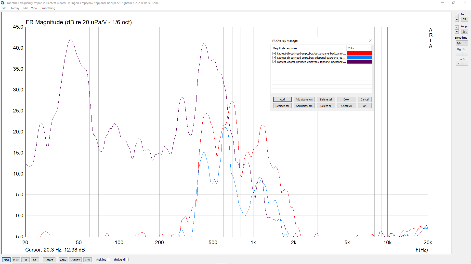

Back from a week away with children and grandchildren, i tested the testbox on resonances. So here the outcome, with no wool in the box:
The setup is Arta Impulse set to record, and knocking on the side or bottom panel or on the woofer cone.
The blue and red cureve is the response of the TIB connected as source the dark purple is the Woofer connected as source.
It is clear that the anomality in the distortion graph is caused by the panel resonances of the testbox, which happen to be also almost overlapping .
A CD shows the very slow decay ;-)
Basically this means a lot of sound radiated by the cabinet itself, not so good :-(
Anyhow the testbox was primarely for testing the amount of wool to use.
But i will do some tests on how to reduce the panel resonances (thus sound radiation), intrigued as i am, after studying the possible approaches.

good work. I also use the driver it self as accelerometer (connect the woofer to the sound card mic input) and then tap the box various places. the recorded pulse reveals the resonant modes (including bass tuning). thanks to the reciprocity the measured response reflects how the woofer excites the panel being hit
Thanks @lrisbo , you mentioned it in the spk16 brief i believe, and yes it works nicely, and quite sensitive as well in the z direction.
To isolate the box from the desk i placed it on large but soft silicon grommets, giving the testbox a base resonance of about 5 Hz.
So above that frequency the box is basically isolated from the activeness of the desk/table. Makes quite a difference.

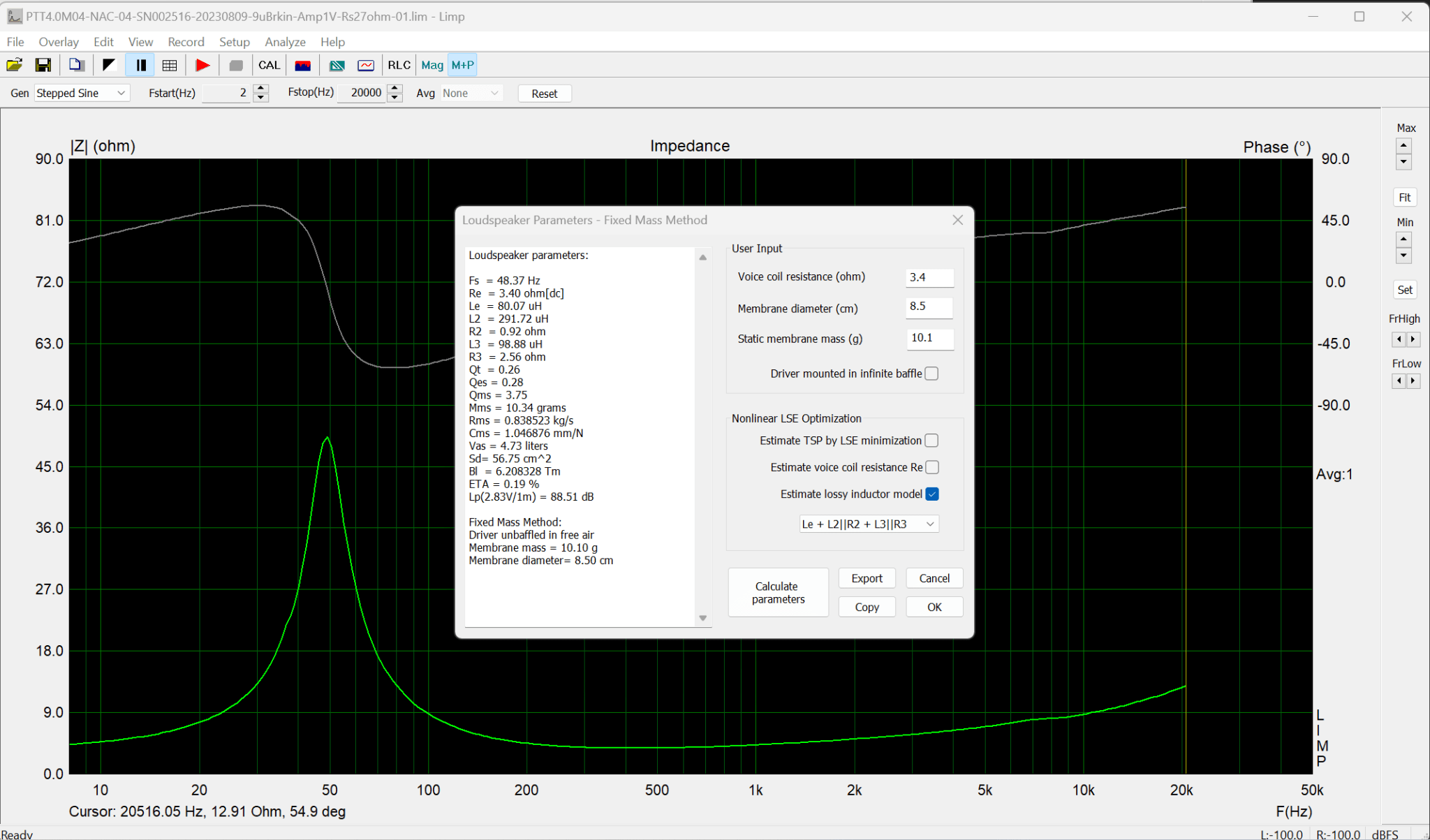

@lrisbo , a question about breaking in the PTT4.0M04-NAC03 driver.
Out of the box it is ~60 hz, spec says 48Hz.
I did one but even after 12 hours of low frequency 15Hz or 25Hz ,amplitude about 6mm p-p , directly after breaking it was ~50 hz but quicly went up a bit. And after a nights rest it measures about 58 hz.
(With the PTT8.0X08-NAB02 it went nicely to 26 Hz and stayed so )
So what is good breaking in for this PTT4.0M04-NAC03 driver?
sounds strange. we do not do burn in prior to measuring for data sheets. Please send me the serial number and I will follow up.
thanks. our end of line test database says fs of 47 and 48Hz so pretty much on spec. Can the difference be due to the setup or test signal used? you are welcome to email my colleague Morten at mh@purifi-audio.com to further discuss and resolve the issue. Crossing my fingers
Issue is no more, Kudo's to Purifi-Audio .
It is direct consequence of voltage used to measure the impedance, and the Rsense value used.
Case01: Rsense 49.7 Ohm, via loudspeaker-output out of Scarlett 2i2, open voltage 550 mV
Case02: Rsense 26,7 Ohm, via amplifier out, output Voltage 1V
Morten of Purifi double checked by testing with 0.1V and he too then measured ~ 60Hz.
I do not know how accurate Arta-LIMP is, but as far as i am concerned it is close enough:
Case03 will be with Rsense of 0.1Ohm, and with amplifier output 2,83Volt as proposed by Purifi. Hopefully tomorrow or Friday.
Note: same Rsense of 0.1Ohm also to use for Current Distortion measurement.
