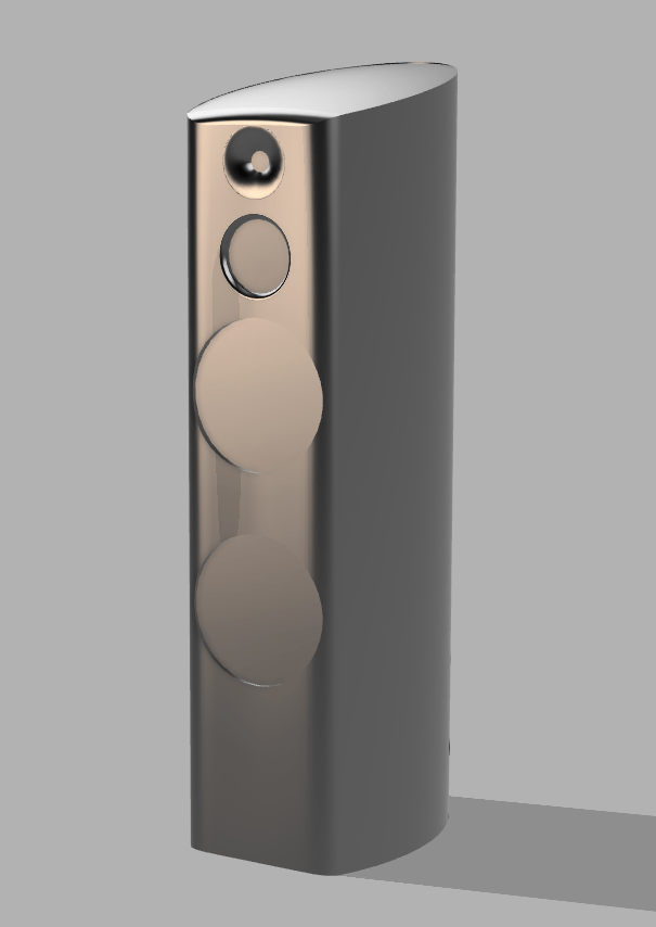

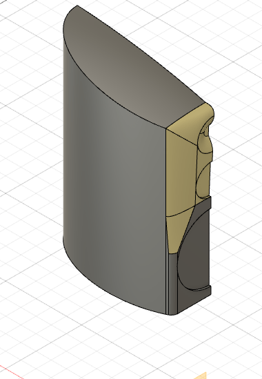

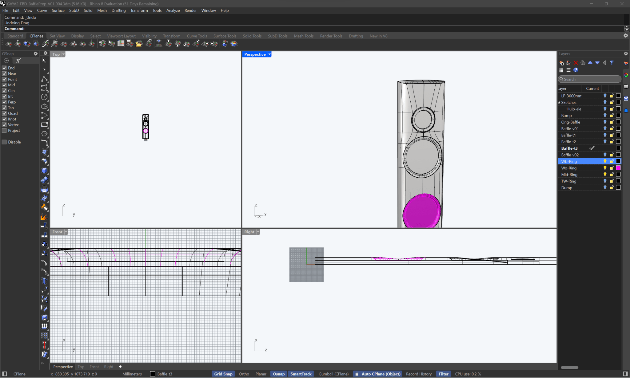

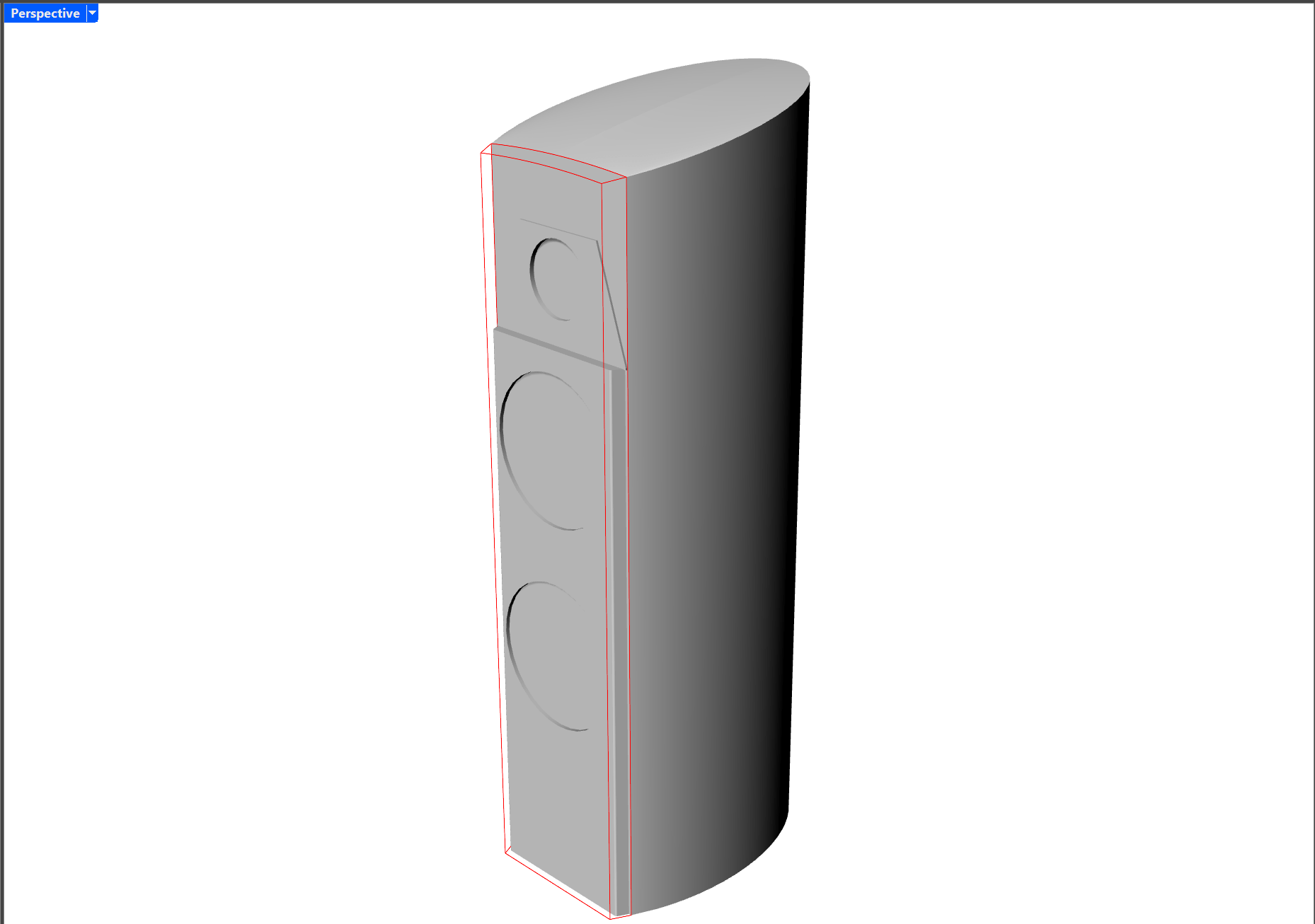

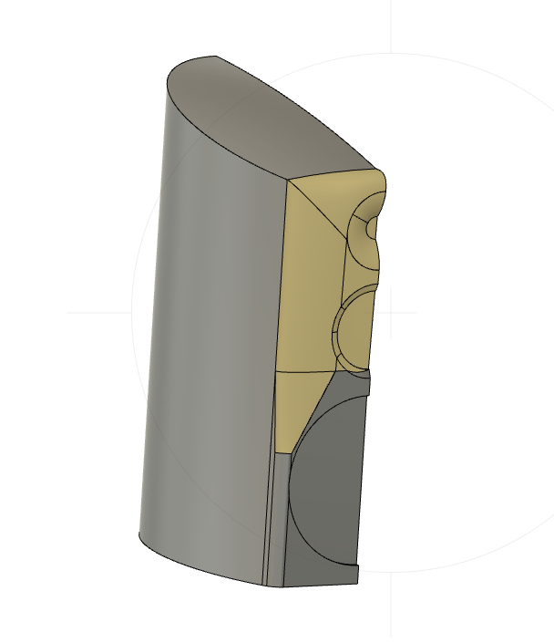

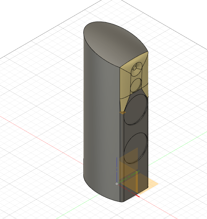

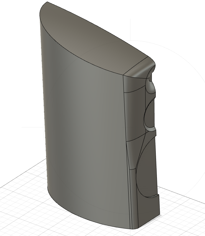

Thanks for the support @fluid , in F360 i finally got a reasonable looking surfacemodel:
The beige surfaces are spline surfaces. I assume a waveguided tweeter so i modeled what looks like a waveguide, and for the midrange (PTT4.0M08-NAC03) i wanted to model a "waveguide" of 6mm deep and covering the rim of the driver, but i failed to create the surface (much like the model made for @wesayso 25 driver line enclosure).
The baffle holding the M and T is tilted 2.5 degrees forward. The whole enclosue in its physical state is tilted backwards by 5 degrees, with the 2.5 degrees tilt for MT means it is better "aiming" at listener position.
Next step is to "cut" in half and then the part below the upper woofer i guess, as the woofer and the tweeter will influence the radiation of the midrange.

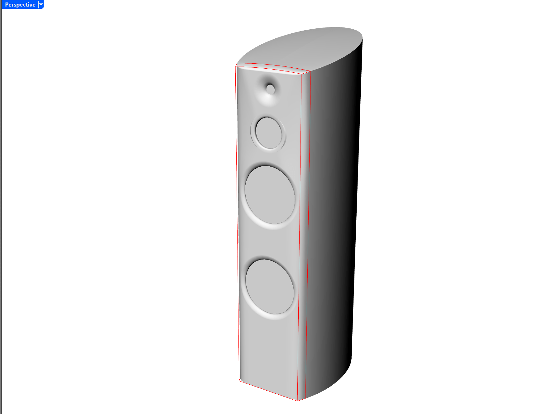

When using a flat disc approximation, the size should be representative of the Sd of the driver. The cones can be moddeled but there can be an accuracy issue with the BEM as used in AKABAK. The cone is more accurate at lower frequencies but becomes less accurate at higher ones, vice versa for the flat disc. There are things that can be used to make the cone model better but they are relatively complicated and require some empirical validation.
There is a similar issue with a lower woofer, with a flat disc it is more like a flat baffle, with a cone the cavity of the woofer is better represented. The wall impedance for particular surfaces needs to be considered too. Is the membrane metal and reflective, or softer paper and less reflective.
I tend to think it is better to just assume a flat baffle area and optimize for that, as otherwise you can be compensating for things that will not be there in the final measurement.

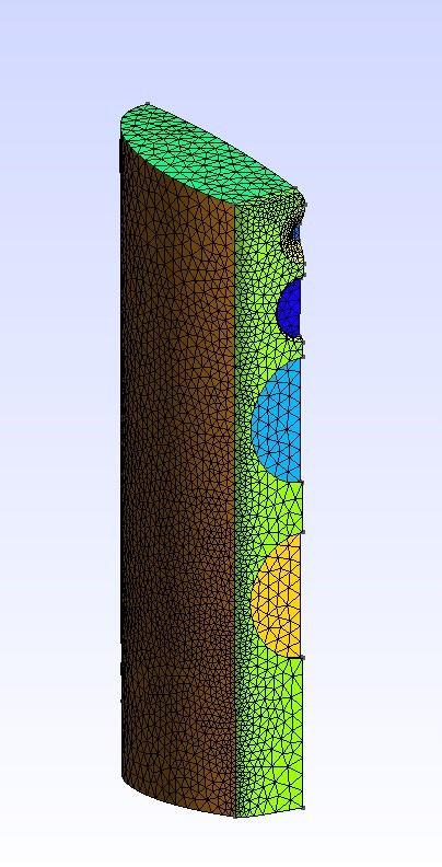

For the mesh it needs to be very different than the STL. Long thin triangles need to be avoided, they do not solve well. The triangles should be as regular as possible. Often this means means brute forcing it with higher resolution. GMSH has quite a few ways to modify the mesh to concentrate the resolution where it is most needed, Ath leverages this well. Doing it manually is quite unintuitive and difficult to describe.
In the mesh advanced tab there is an option to compute elements from curvature. Values of between 12 and 30 seem to work as a kind of auto routine.

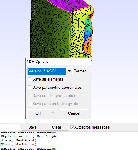

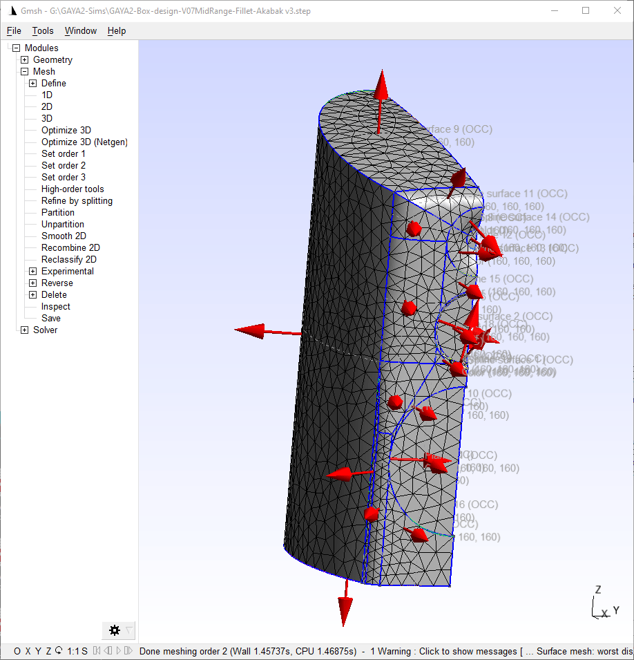

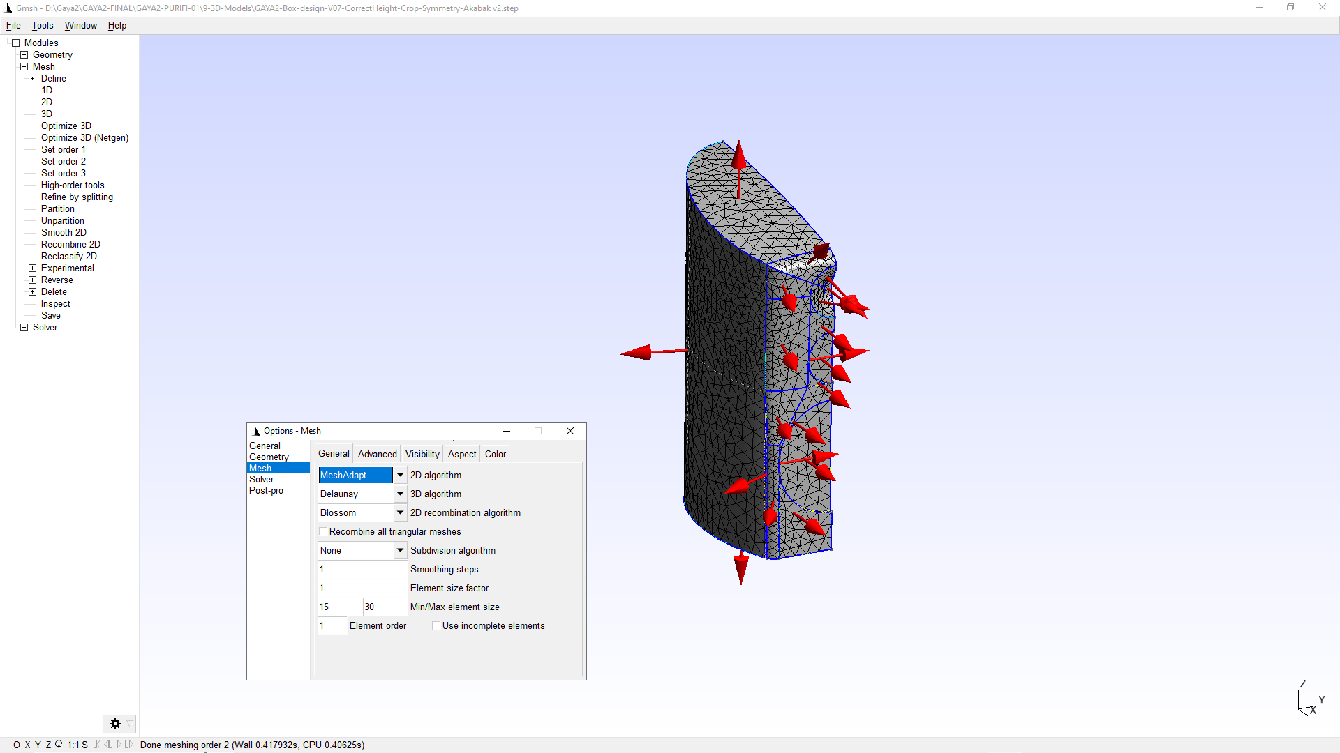

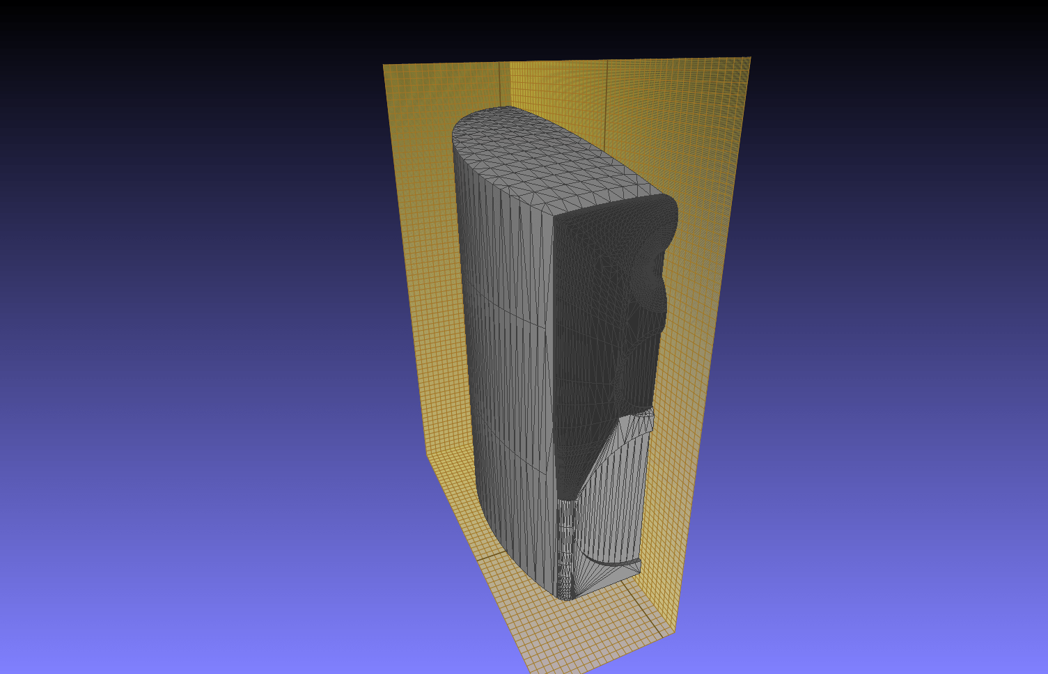

The easiest way is to use the export function, add the .msh to tell it you want a gmsh file and choose version 2 ASCii, then hit OK. If you save a higher version AKABAK will not accepot it, and that is the default in the save options.and to see if i can get the mesh accepted in AKABAK.
In GMSH created a mesh with 2016 elements:
Saved as Version 2 ascii:
Could import it into AKABAK, so far so good.
Now studying the "subdomain" part, interesting!

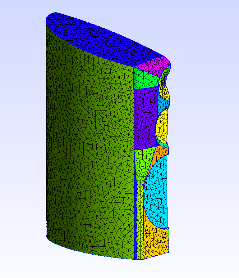

A simple way is to split the baffle and rear enclosure into two separate files so they can be meshed at different resolutions. The higher resolution is more important on the front.
Alternatively the same file can be meshed twice and the tags for the correct faces picked in the entity in akabak.
Just watch the junction between the two that a gap doesn’t open up.

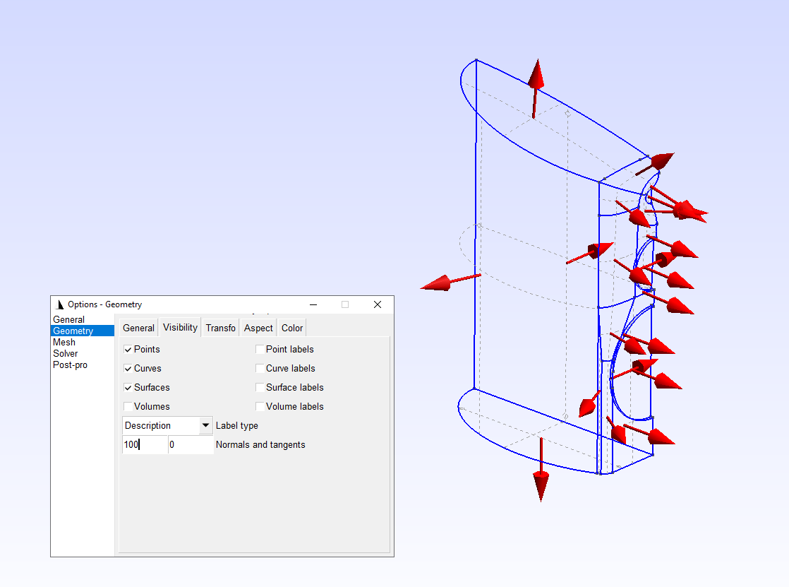

GMSH is a fine tool, not only for meshing, also for proof that all surface normals are ok.
Meshing in GMSH works fine:

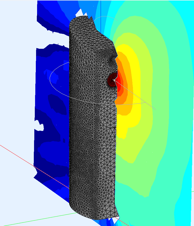

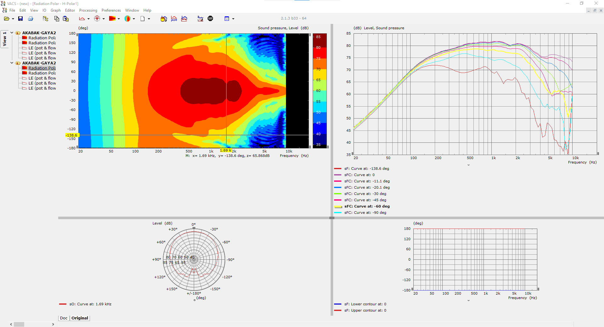

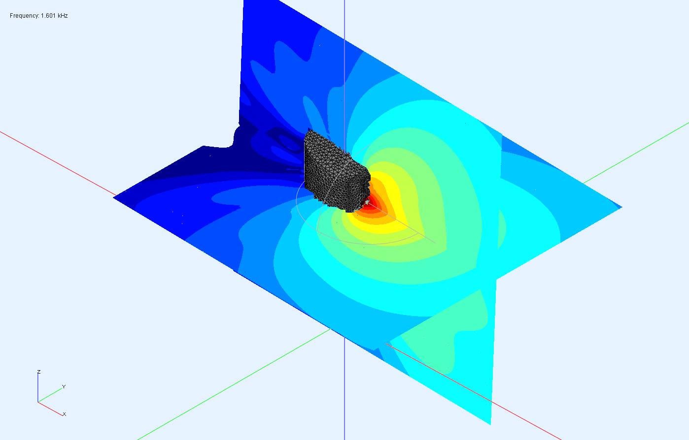

Some results now:
The midrange-tweeter baffle part is tilted by 2.5 degrees. In the final situation the whole enclosure is tilted backwards by 5 degrees. The midrange is about 88cm above ground, my listening position about 100cm.
The radiation aka diffraction is quite neat already.
The influence of the bass recess is next thing to look into.
And to use a 3D outsie model of the midrange as well, this apparently is possible?!
Quite happy with results sofar.
Note: the recess of the midrange is 6mm deepr into baffle and that edge is filleted.

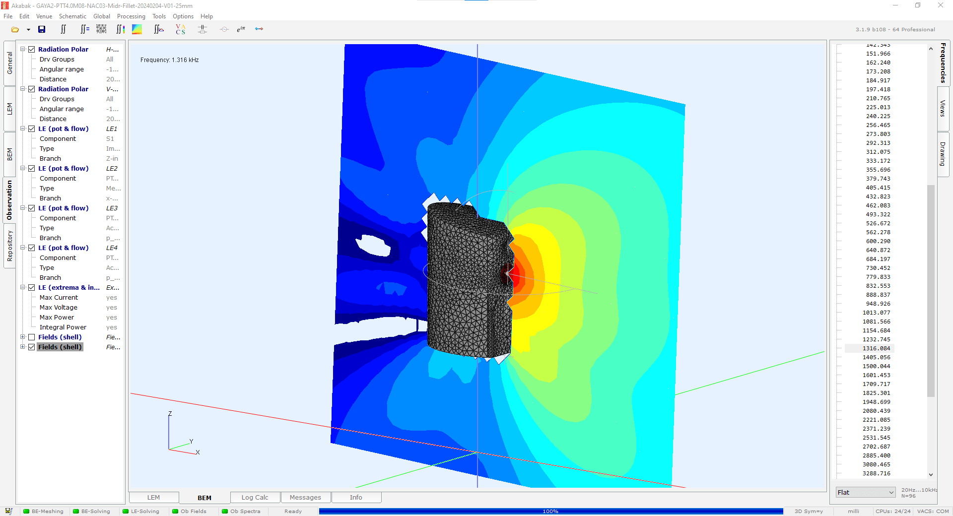

A lot of learning while doing with AKABAK and VACS, but once i got repeatable results, i started to experiment with baffle shape impact op sound radiation with the Purifi PTT4.0M08-NAC03

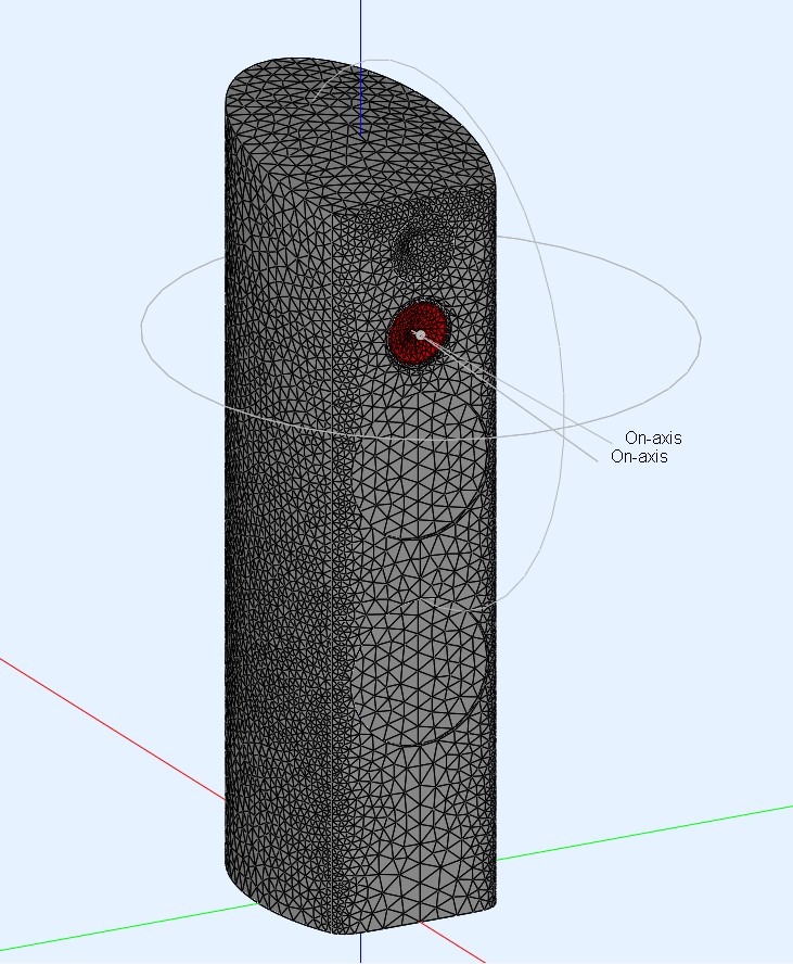

To start i used a portion of the speaker enclosure, in order to find out the impact of the complete enclosure i tested that as well.
As stated earlier i also worked on reducting the number of 3D surfaces in the 3D CAD model, which must lead to less triangles, thus less time for processing in AKABAK.

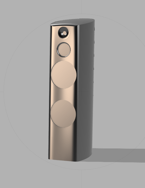

The last tested baffle shape is sort of visible in this quick render, the first one straight up, the second one tilted backwards by 5 degrees as is the real enclosure:

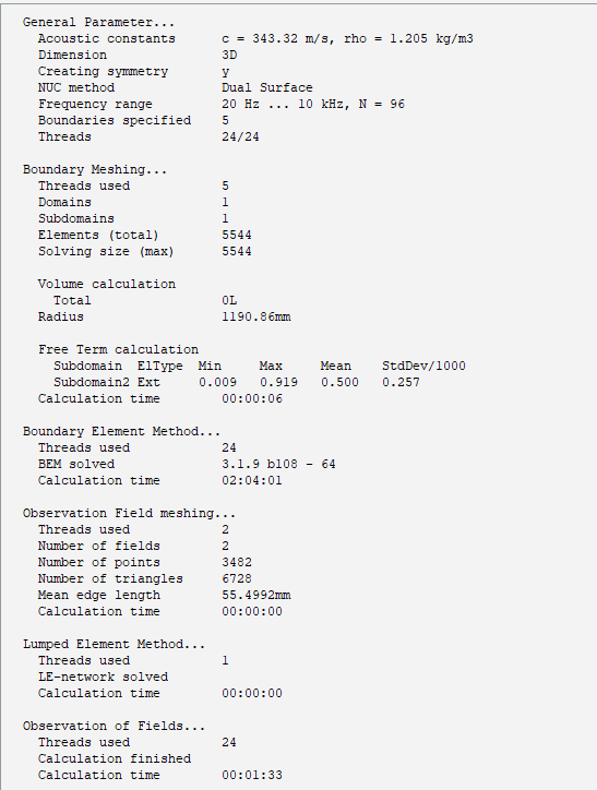

The meshing went fine:
Loaded into AKABAK, and used AKABAK driver modeling to simulate the PTT4.0M08
Processing little over 2 hours, and as far as i can tell, went quite ok:

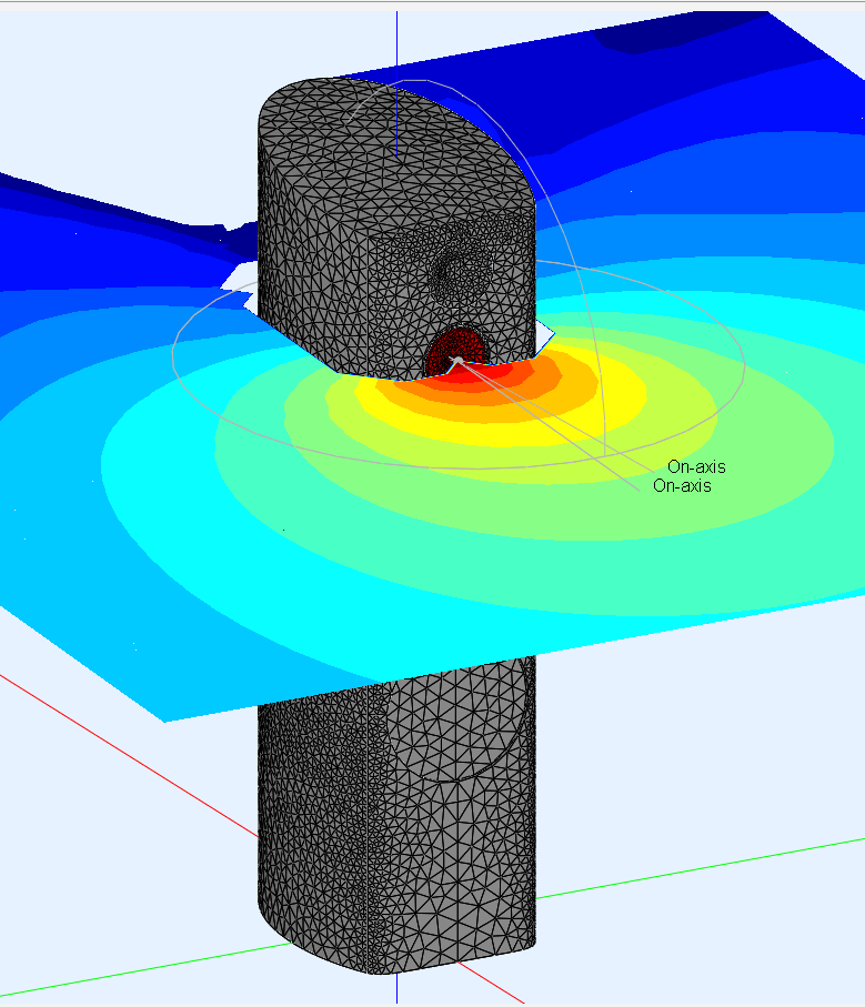

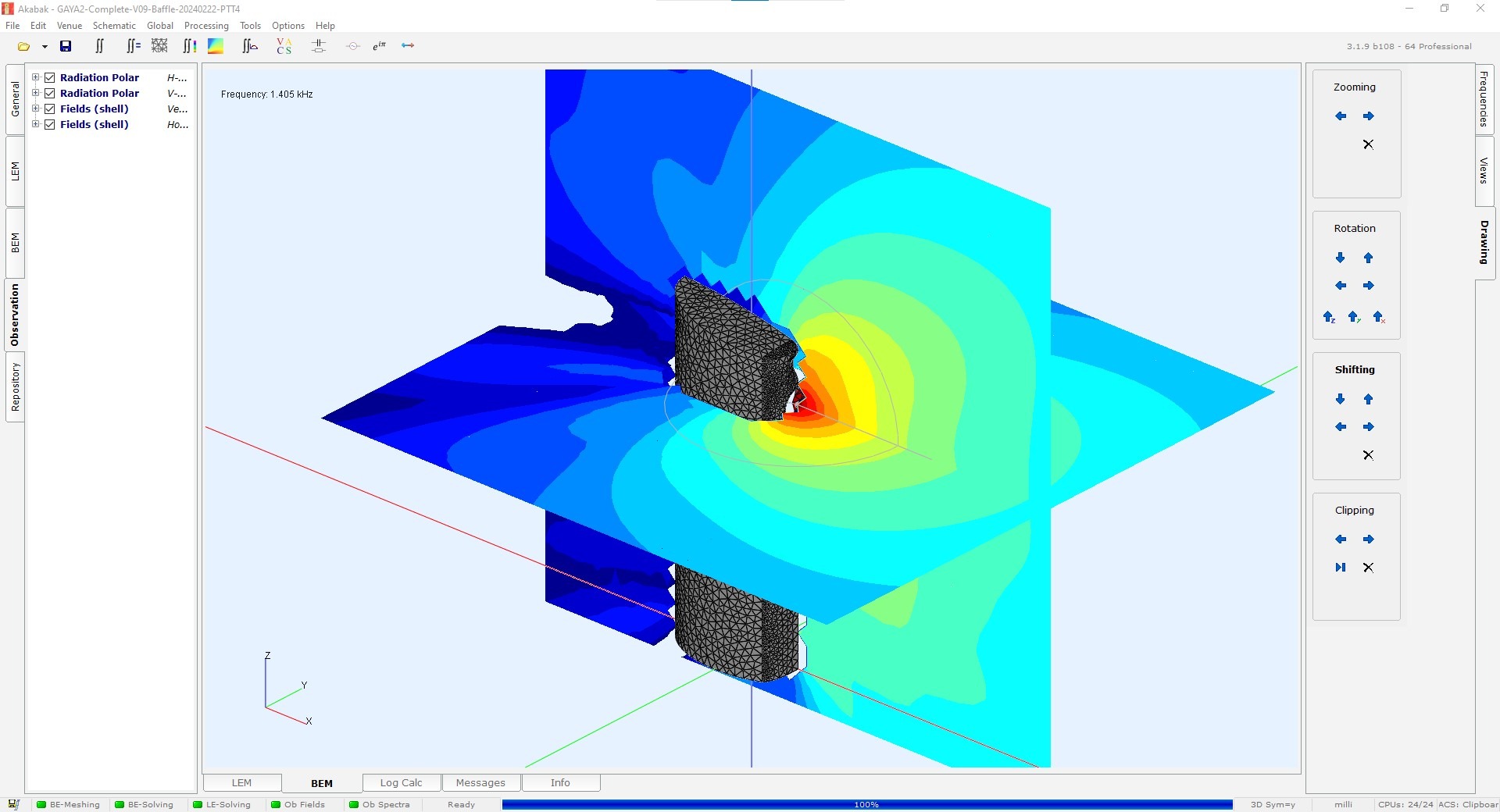

The vertical field in AKABAK at 1405 Hz:
( the tweeter waveguide does impact the vertical radiation, contemplating on if that can be reduced, not yet figured out how).
The horizontal field:

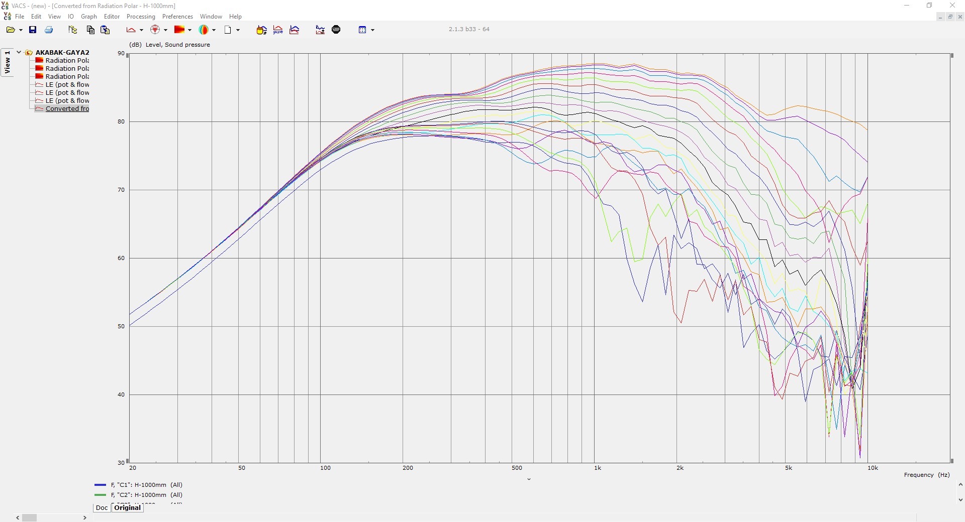

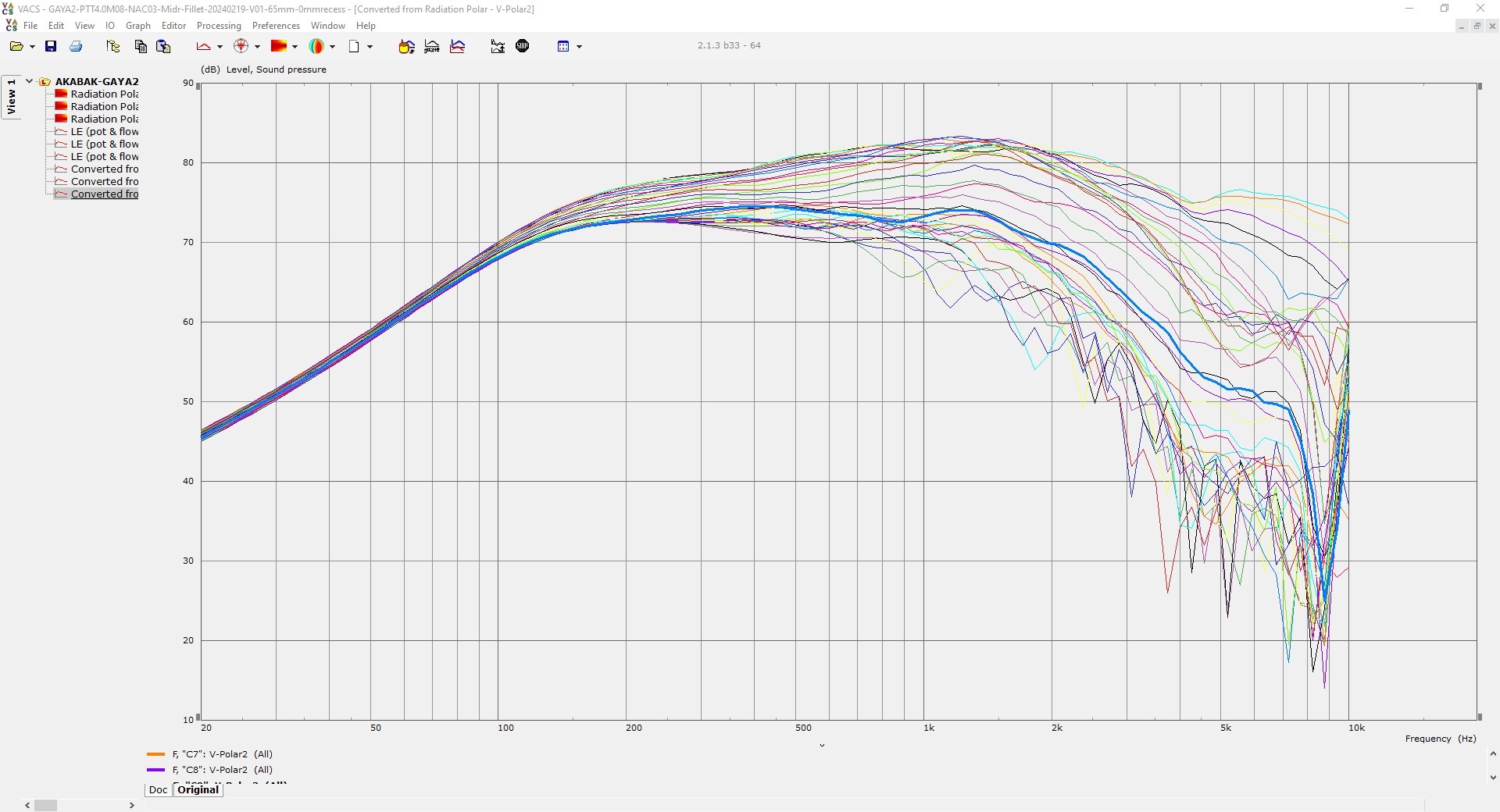

In VACS the graph 10 defree steps measured at 1000mm radius from baffle:
Horizontal:
Vertical:
Surprisingly smooth in both H and V planes?! (in the short version i get a dip of 1-2dB arounf 2000Hz)

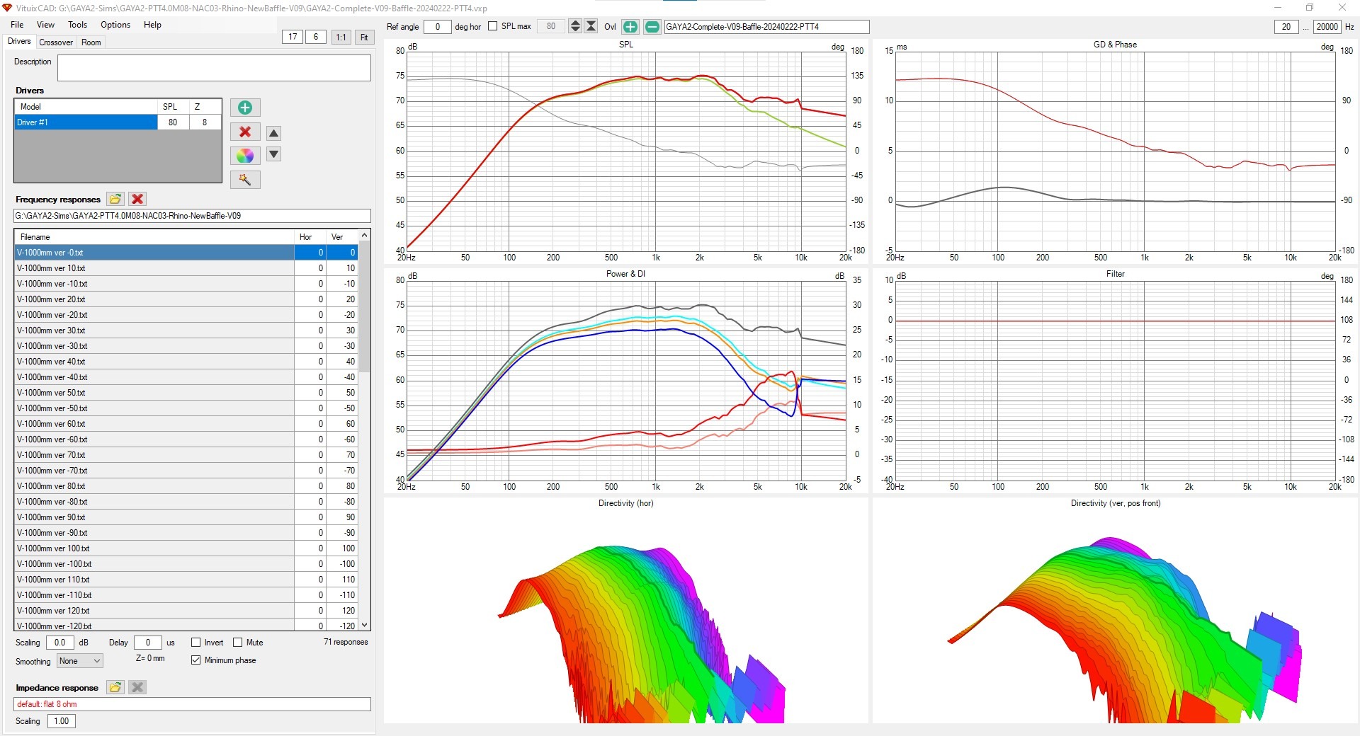

Horizontal:
Vertical:

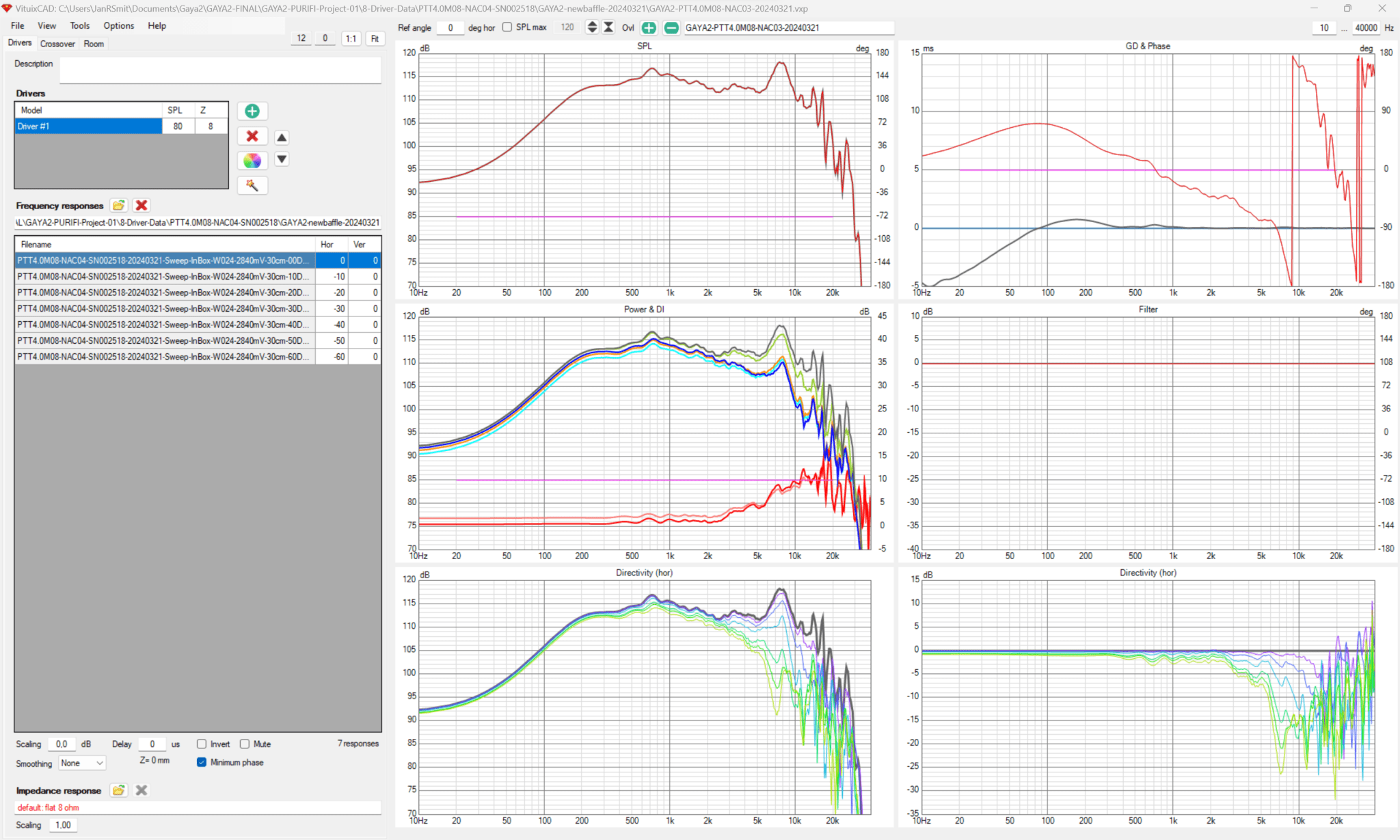

You can use this for 0 -180 if you want. Ticking the minimum phase box in Vituix will remove the fixed delay so the phase response doesn't look weird.Working on getting these SPL curves data-sets into VituixCad, trying to put together a batch rename file.
https://www.diyaudio.com/community/...-design-the-easy-way-ath4.338806/post-6800791
Advanced renamer will have to wait, i got a bat file to do the renaming quick and straightforward.
So i can load into VituixCAD and see more.
I also modeled a different baffle shape:
Compared to the one above a bit more rough.
Next step is to examine in more detail

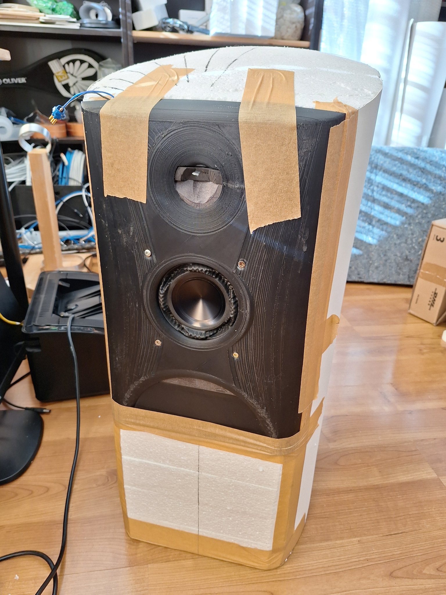

Basically the baffle shape will be printed with stiff filament and added to the existing baffle, with round opening per driver. In these openings i want to place a printed ring printed with flexible material TPU.
The shape of the baffle arounf the midrange is made such it minimises the typical bump, and augments where the typical dip occurs. This because the driver i chose PTT4.0M08-Nac03 has a bit if a dip by itself at about the same frequency range.
Sims and test with a 3D printed baflle gave good results.

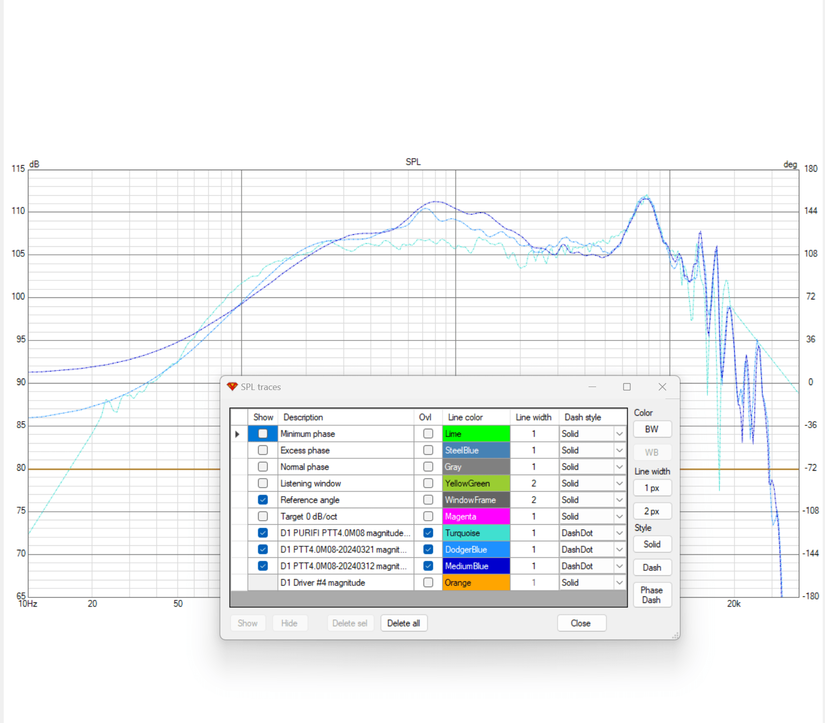

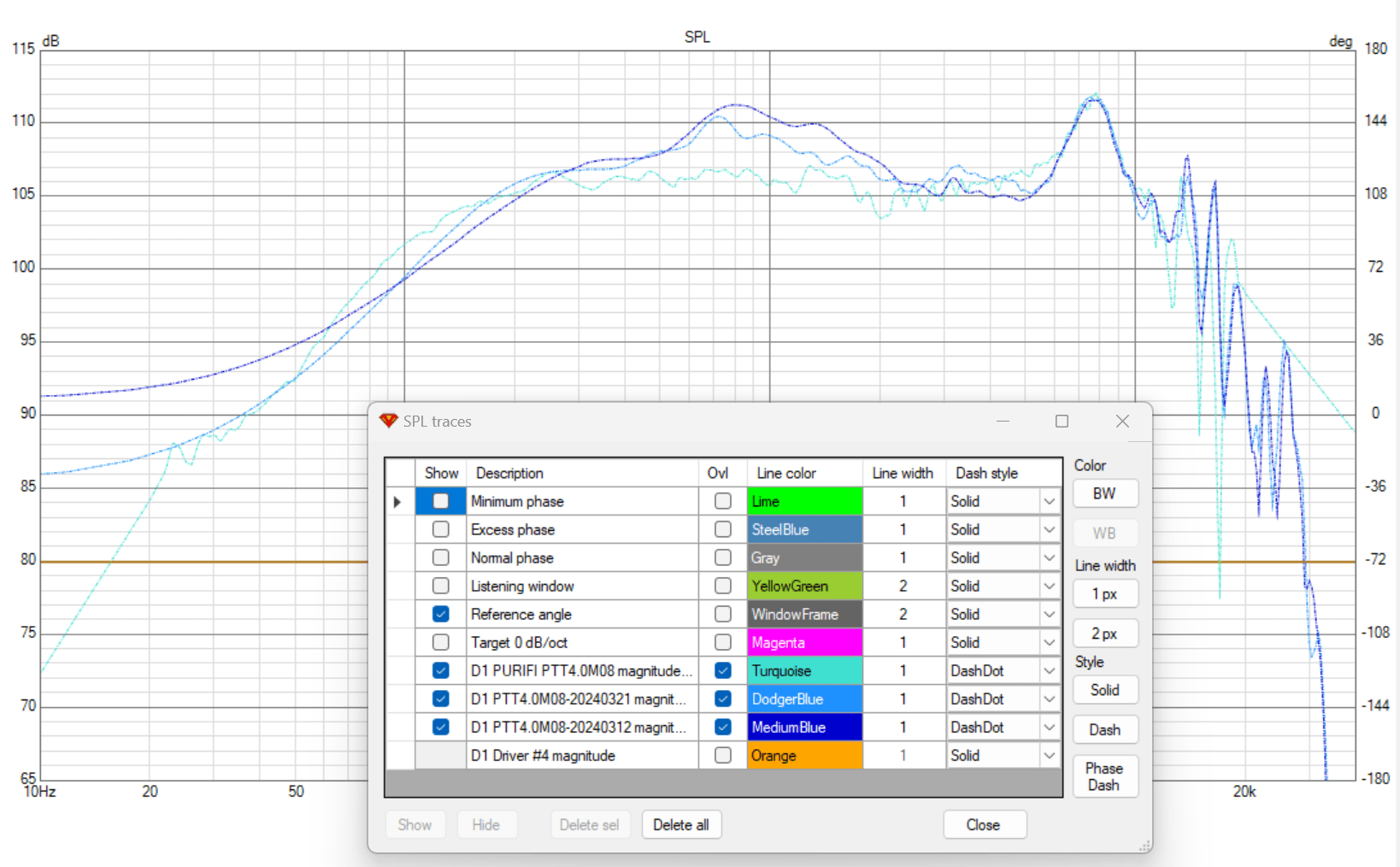

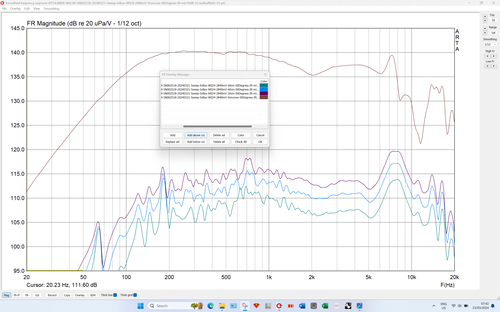

Some measurements:
Turquoise: the PURIFI provided SPL
DodgeBlue: the latest version of my testbaffle shape (20240321)
MediumBlue: the testbaffle versin of 20240312
(SPL levels not calibrated, so should have been more around 85dB, using 2.83V rms)
A off-axis measurment at 30cm from 0 to 60 in steps of 10:
The off-axis performance is quite good.
In an update i will show the simulations with AKABAK and VACS
And the DUT ;-):
The shape i am starting to print now:
The red-lines depict the current grille limits, as agreed with my wife , those are the battery-limits so to speak ;-)
As a reference, the current baffle:
For the tweeter i assume a waveguided version, and i hope the PURIFI tweeter will be available soon. Nevertheless i also work on a plan B.
