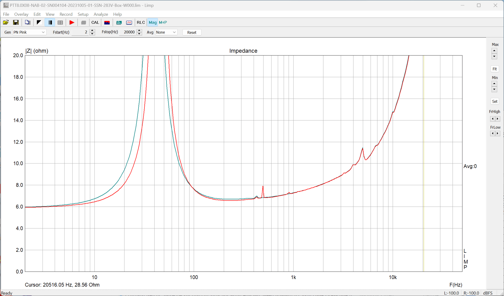

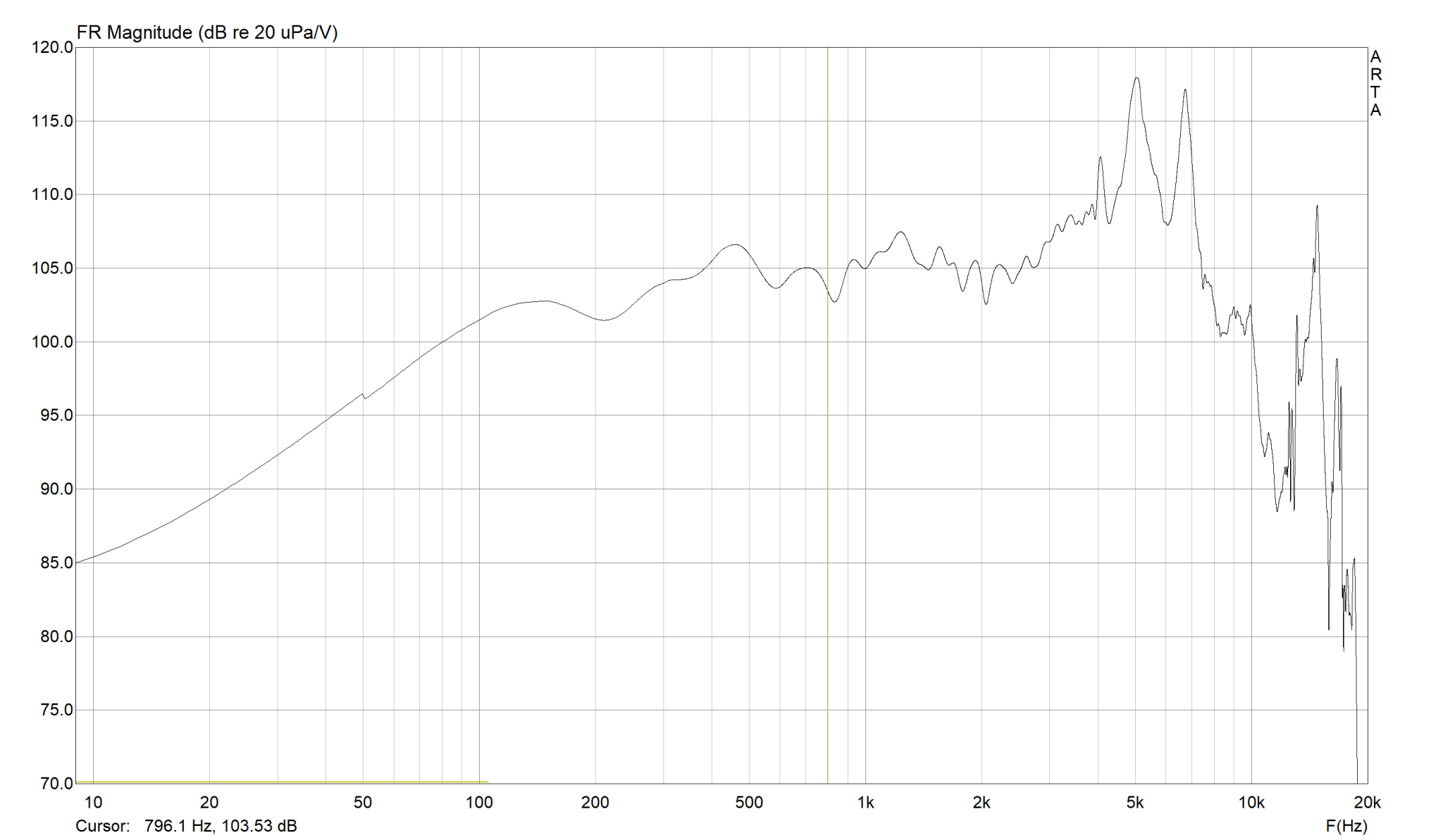

Impedance mesurement, in stiffened testbox with no wool (W000 - Red curve) and with 700gr wool (W700 - grey/blue curve)):
The internal modes show up in the red W000 curve, but no longer in the W700 curve. Except for something at ~ 420hz, possibly the spider resonance?

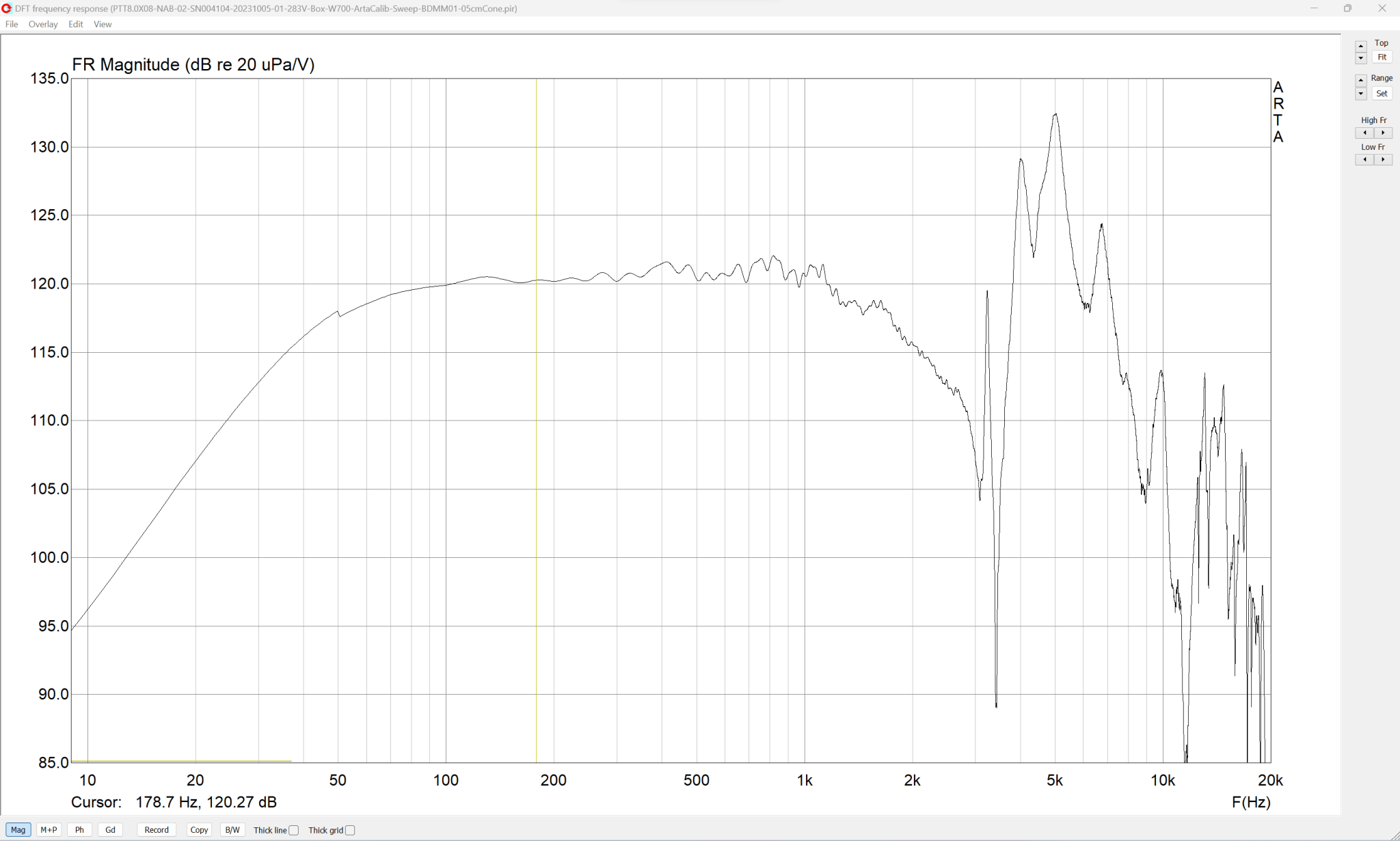

The frequency response is also as expected.
With mic close to mid-point of dome:

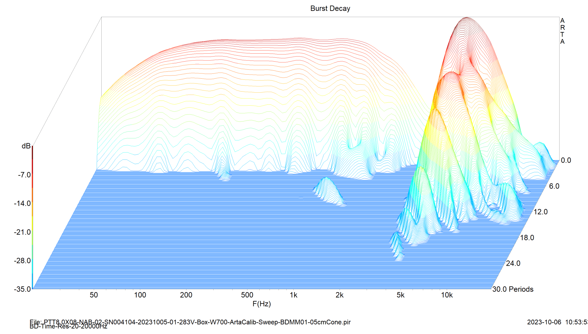

The Burst Decay also looks ok to me:
Note the response measurements were done in a small and furnished room, so quite some reflections.
But at 30cm from baffle it is still doable:
It shows a rather flat mid region and an strong breakup effect above 2 kHz, as expected from the Purifi datasheets.
Listening to it off-axis with music shows a clear and engaging sound, i am happy.

The cabinet panel resonances of the testbox i delt with by glueing an extra layer of MDF on the sides and top and bottom. The rear panel was already stiffened by braces.
So what remains mostly is the modes , and that should be dealt with with the wool.

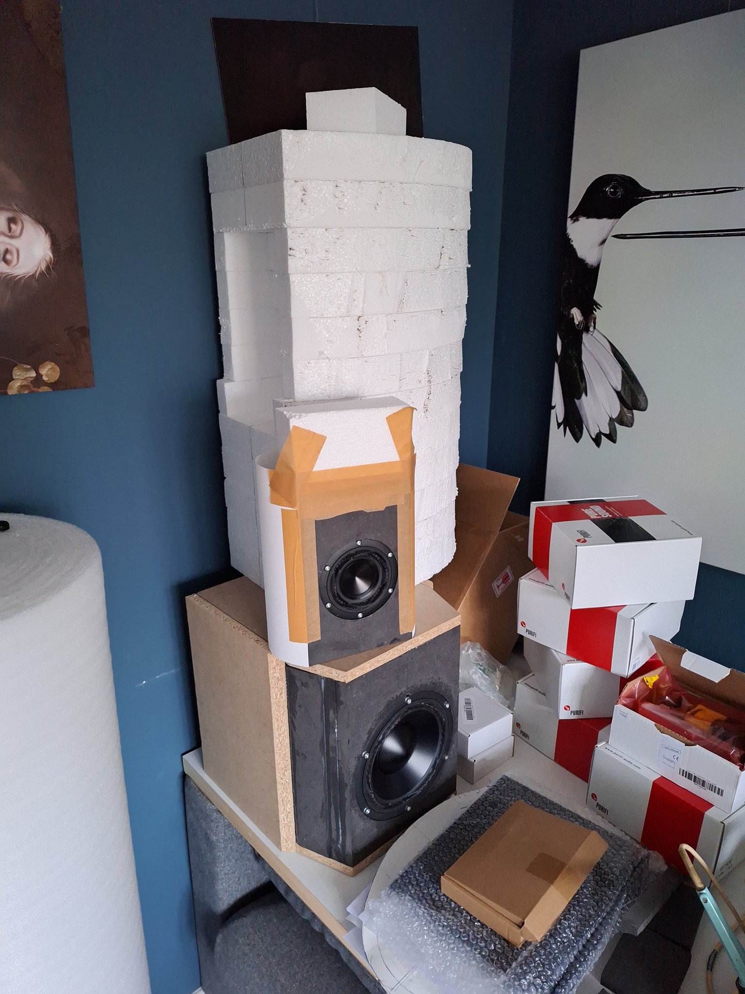

A new year, with more time to spend on purification of my GAYA2's ;-)
A quick and brief recap: The challenge is not so much the woofers aka bass, it is the midrange tweeter baffle shape. The main enclosure shape is a given, so room to play is pretty limited, nice challenge. The deadline is Spring 2024. Balancing time vs cost made me decide for a hybrid active concept. The purifi eval1 amp parts arrived and will be assembled and tested this week.
The past week i had some more time ;-)
So i started making a foam replication of the GAYA2 cabinetshape as a platform for the M-T baffle shape testing. Also modeled the cabinet platform in Fusion 360, and did a first mesh in F360 to see if it would give issues. The goal is to simulate baffle shapes to find the best fitting compromise, simulation without real-world correlations has little meaning, so a foam replica is made (the originals weigh ~ 75-80kilo a piece).
In the foam replica the small midrange testbox will be fitted, so i can test acoustically.
My wife and i are also rearranging our house, as "collateral damage" i will have a room avilable of 5.3x3x2.45 m size, great for testing ;-)
Joerg Panzer of RandDTeam.de just (as writing this post) granted me a student license for AKABAK, great, thanks Joerg!
@augerpro pointed me to posts in DIYAudio for some support in using BEM simulation, thanks !
Some pictures:
A rendering of my GAYA2 platform with Purifi PTT8 woofers:

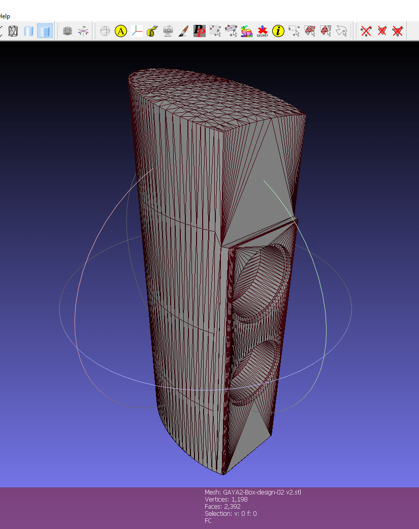

Just the outside, meshed with F360:
The testcabinets for PTT8 and PTT4 and the foam replica under development stacked away to make room for overnight guests:
Now comes the difficult part, learning curve AKABAK for BEM simulation ;-)

Start by using whatever symmetry you can to split the model up, export it to STEP and use GMSH to mesh it, exporting the .msh at version 2 for use with AKABAK.Now comes the difficult part, learning curve AKABAK for BEM simulation ;-)
Yes only the outside surface for exterior radiation problems. You can mesh the solid and only select the tagged faces for the outside in AKABAK or create a copy of your model and split the solid into surface faces then mesh that.
If it is only the mid you are looking at you might want to make a cut down model that you can use quarter symmetry with. Otherwise the solving time gets quite long or the resolution has to be low.
