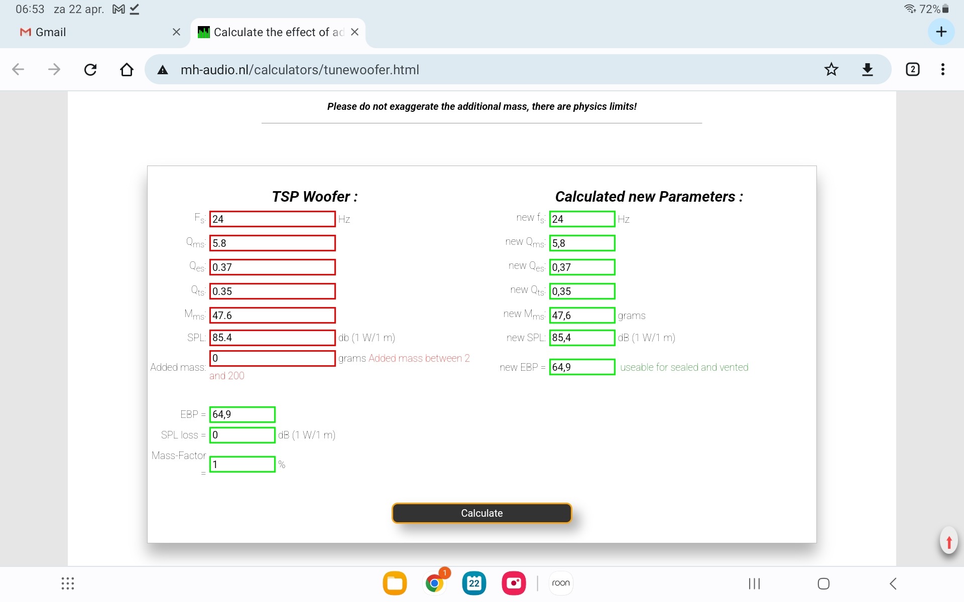

Sort of matching, and in vituixcad enclosure sim it is close enough.

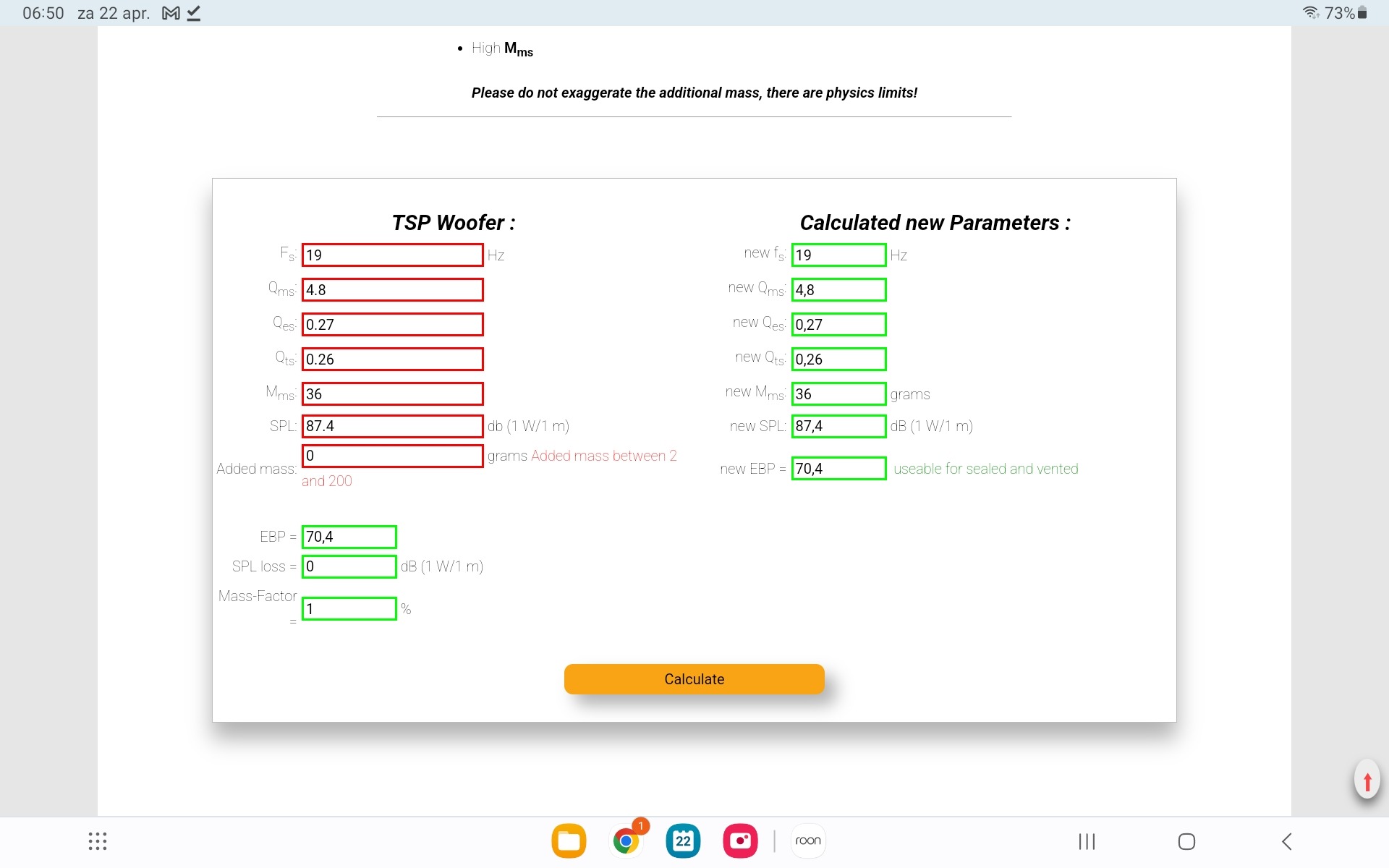

Not behind my computer so cannot share screencopies,other than ebp calcs i foundation on a website yesterday.
Fisrt one is puri 8", second one ss 8555 , thirth one ss8555 mod
I am not so sure about the accuracy of this calc as f.i. the sensitivity is a bit off, but then again the woofer mod i figured out was 17 years ago and cannot recall using this ebp. I did use some tools for sim then but records are gone helas.
The vituixcad enclosure sim i will show later, the f3 is little bit higher and with a bit lower q, which is what i prefer. The woofer enclosure volume physically is 27 liters, the type of sheep wool i use acts like a volume increase when you try to sim the result obtained with wool. At least then and if memory is correct i used boxsim ;-)

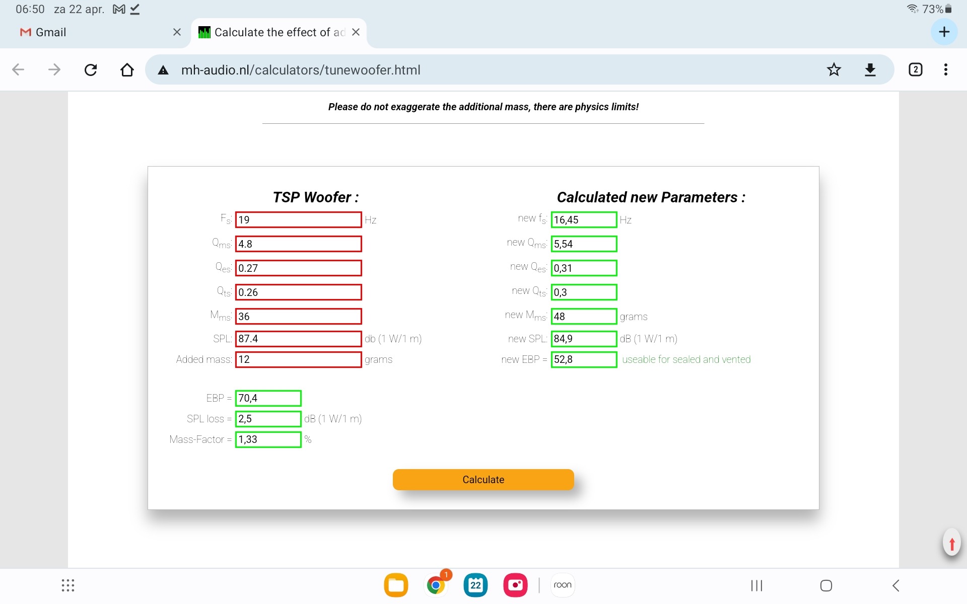

Regarding Qts and sealed box volume relation , that is what we used if memory serves me correctly @lrisbo . Your remark triggered my memory.
It was a search then for a woofer fitting the limited size of the box as that was driven by WAF (wife acceptance factor) (my dear wife).
I knew from my history then that adding a bit of weight would help, and by glueing that on the inside of the vc former where the cone is attached would not give resonance issues. The 12 gram is what i believe is used. Lifting the dustcap was easy then ;-)
yes, adding mass is lowering EBP and thus increases the bass extension possible. In terms of T/S the fs goes down and Qts up. Alternatively, adding extra series resistance is increasing Qts without changing fs Again lowering EBPRegarding Qts and sealed box volume relation , that is what we used if memory serves me correctly @lrisbo . Your remark triggered my memory.

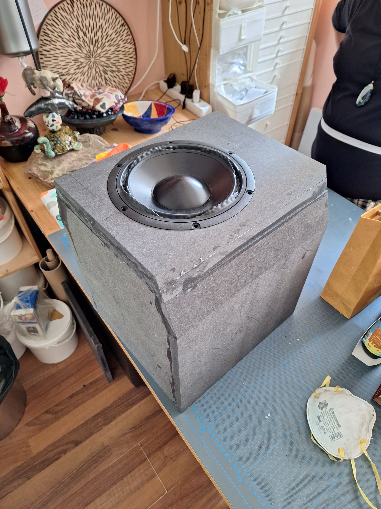

After some time(other priorities helas) something to report. I did a breaking in on one woofer, after a couple of hours it is indeed close to the specified t/s Parameters.
The test cabinet for the woofer is almost ready:
Internally coated now and just the wiring of the unit and the inside mounted tweeter to complete.
Expect this weekend to start with measurements.

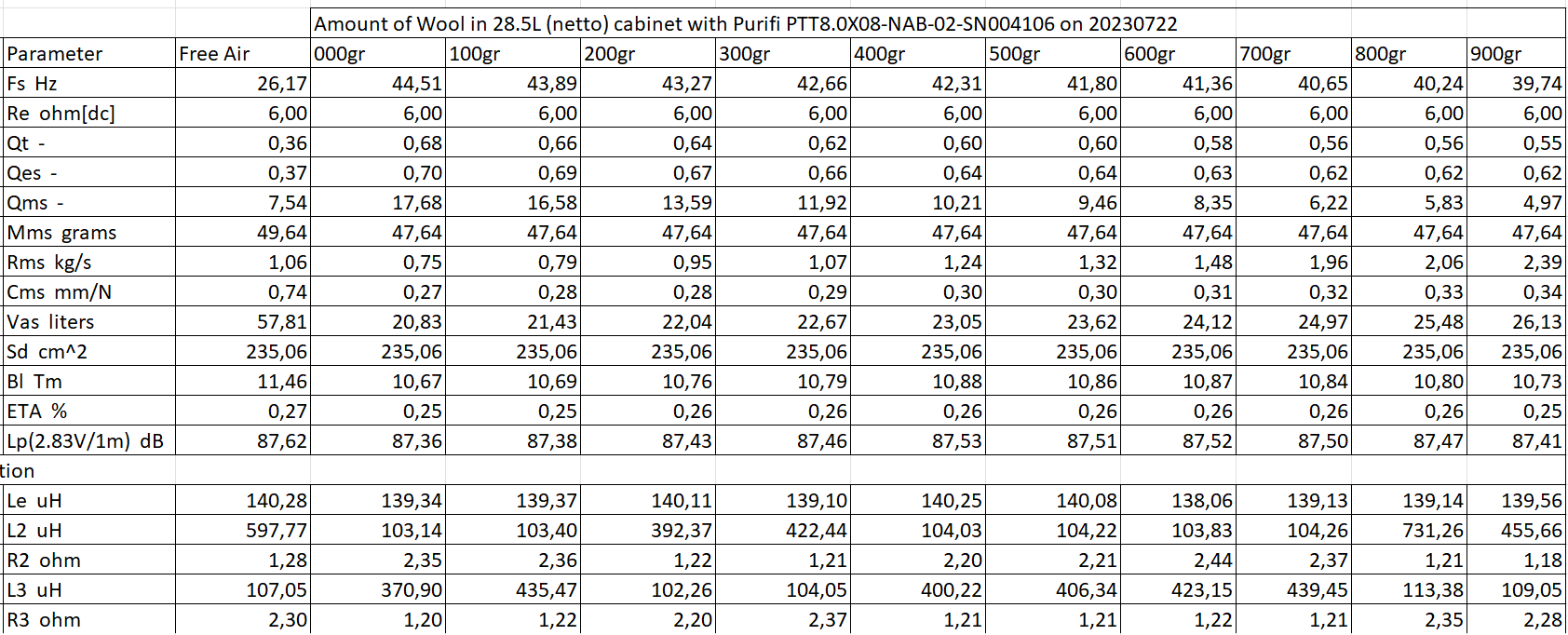

Finally had the opportunity to do some testing with the PTT8.0, with the focus on the special wool filling i have been using for many many years now.
Steps of 100gr increased the wool amount and measured the impedance with Arta-LIMP, including the T/S parameters:
I have not yet extensively studied the outcome, but i was surprised how much wool i could place without signs of too much, which in the past was that Fs no longer dropped in value. In '91 i did a system with 8" Focal woofers, and in a 22liter enclosure the max amount of wool was 300-350gr as i found on a sheet in the remains of my dossier. I knew i did a similar study in 2006 (for my current loudspeakers), so i searched through my dossier again for measurements done in 2006 and after touching each sheet one by one found the one, and that with the current woofers (to be replaced with PTT8.0) i indeed used 700gr wool in 28.5liters netto volume.
I did listen to the woofer with 900gr wool , no filter etc, just one box, and it did sound surprisingly clear and dynamic.

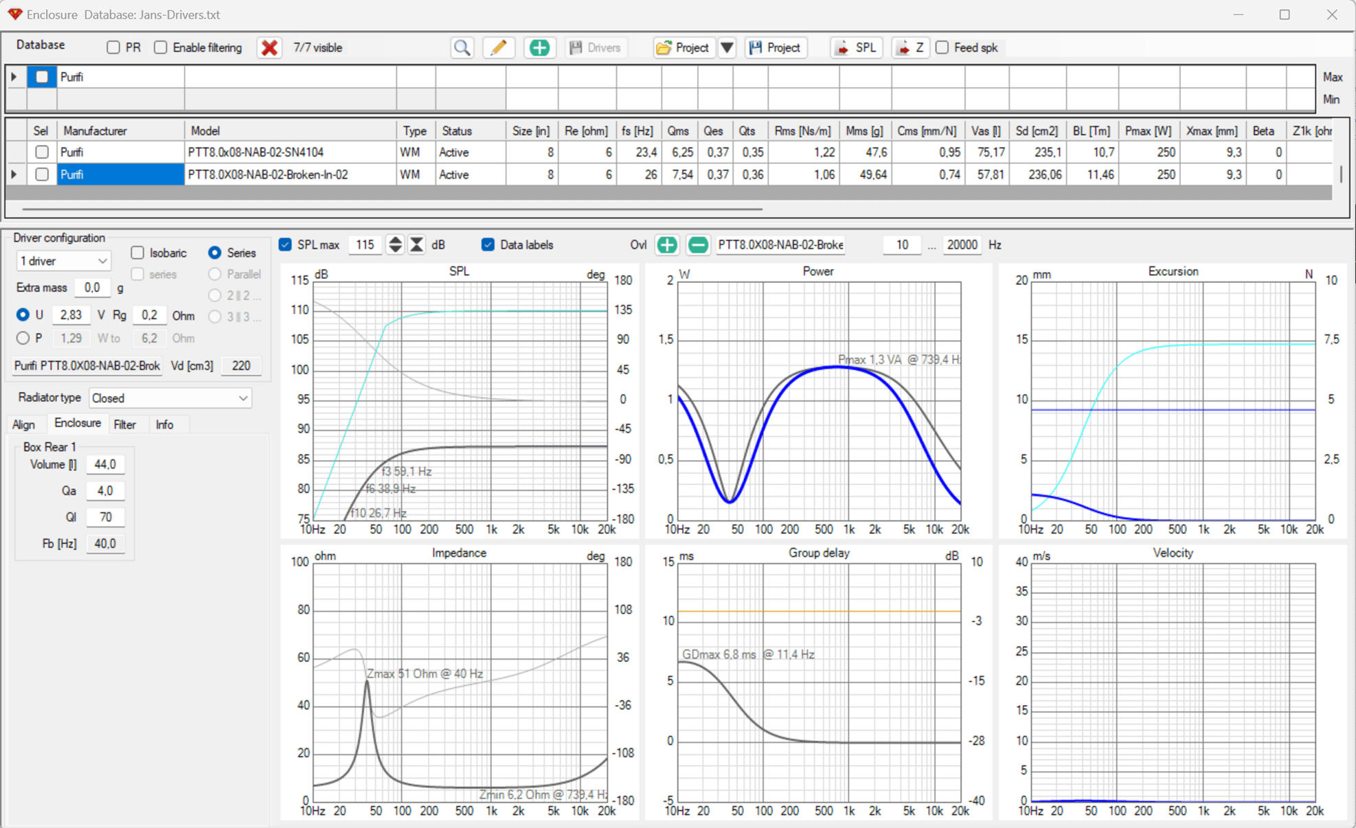

I tried to simulate the result in the enclosure tool of VituixCAD, and came up with this:
So a lot of absorption is going on, also a significant apparent increase of the volume. Note that the enclosure is quite free of air leaks (cone popping back immedeately), but there is always some, so i set it to 70 instead of 100.

I would also expect the apparent volume to go up and absorption loss factor Qa to go down. Question: normally damping is added to reduce the Q of the standing wave modes in the box. Are you wanting to lower the Q of the driver beyond that?
For wool stuffing in a sealed box, I generally use 16 grams / liter. Ironically (or amazingly) this is equivalent to 16 oz / ft^3.
I weigh the wool to get the correct amount, then tease it out as loose as possible. When stuffing this fully fluffed-out wool, it is necessary to slightly compress it to get the full 16 g/l pushed into the box. I found this level of stuffing is sufficient to suppress standing wave acoustic resonances.
350 g into a 22 l box is 16 g/l, so our build process is similar.In '91 i did a system with 8" Focal woofers, and in a 22liter enclosure the max amount of wool was 300-350gr as i found on a sheet in the remains of my dossier.
A good question @lrisbo !I would also expect the apparent volume to go up and absorption loss factor Qa to go down. Question: normally damping is added to reduce the Q of the standing wave modes in the box. Are you wanting to lower the Q of the driver beyond that?
The first testrun was to find out how much wool is too much, apparently the PTT8.0 can handle a lot, i did not reach the usual signs of too much.
