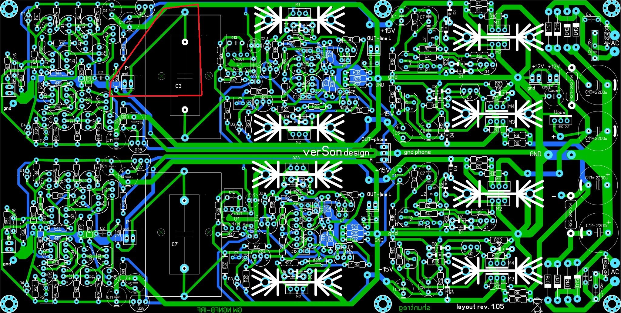

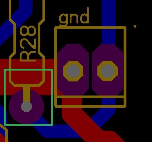

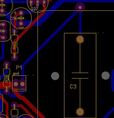

This pcb is kind of cursed! There is a short in one channel around P1, even on a bare board. It's shorted out in the places I've marked, but you can't see anything through the JLCPCB either.
I found it, on the top of the pcb is R28 connected to GND

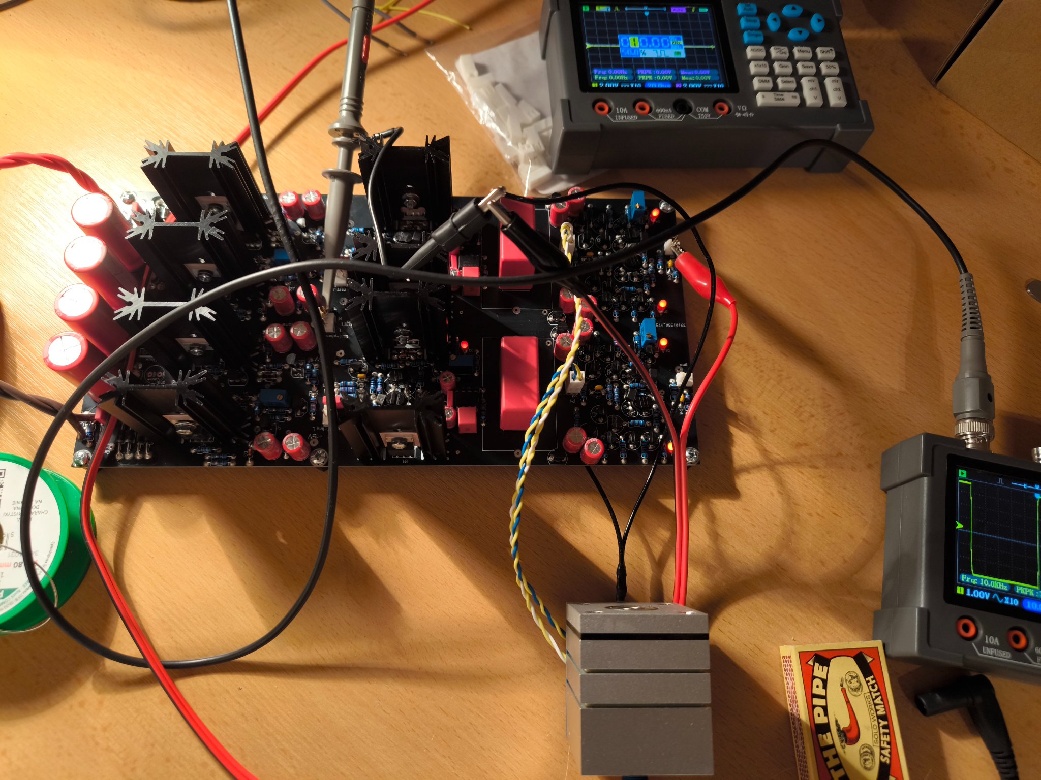

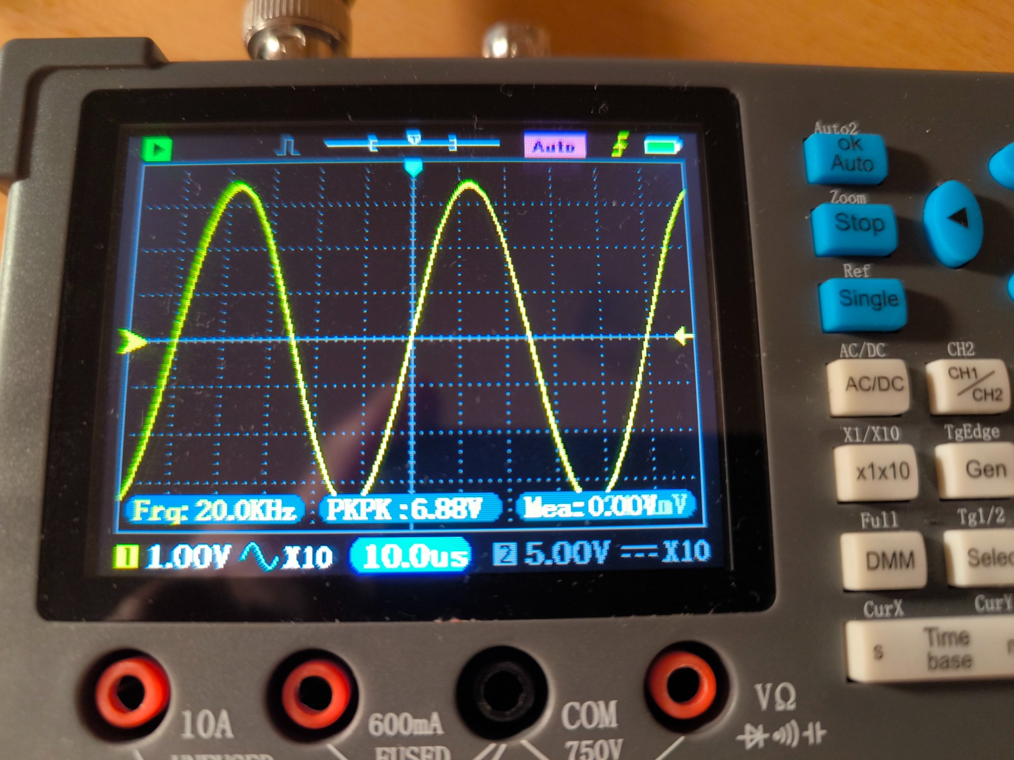

Do it like that, try to get the bias of 120mA or close to it. As DN2540 has Idss min of 150 mA (most of them I have it around 200mA) shunt regulator must have enough current going throgh shunt mosfet, let say 50mA, to regulates properly.
Adjust voltage to +-15V too.

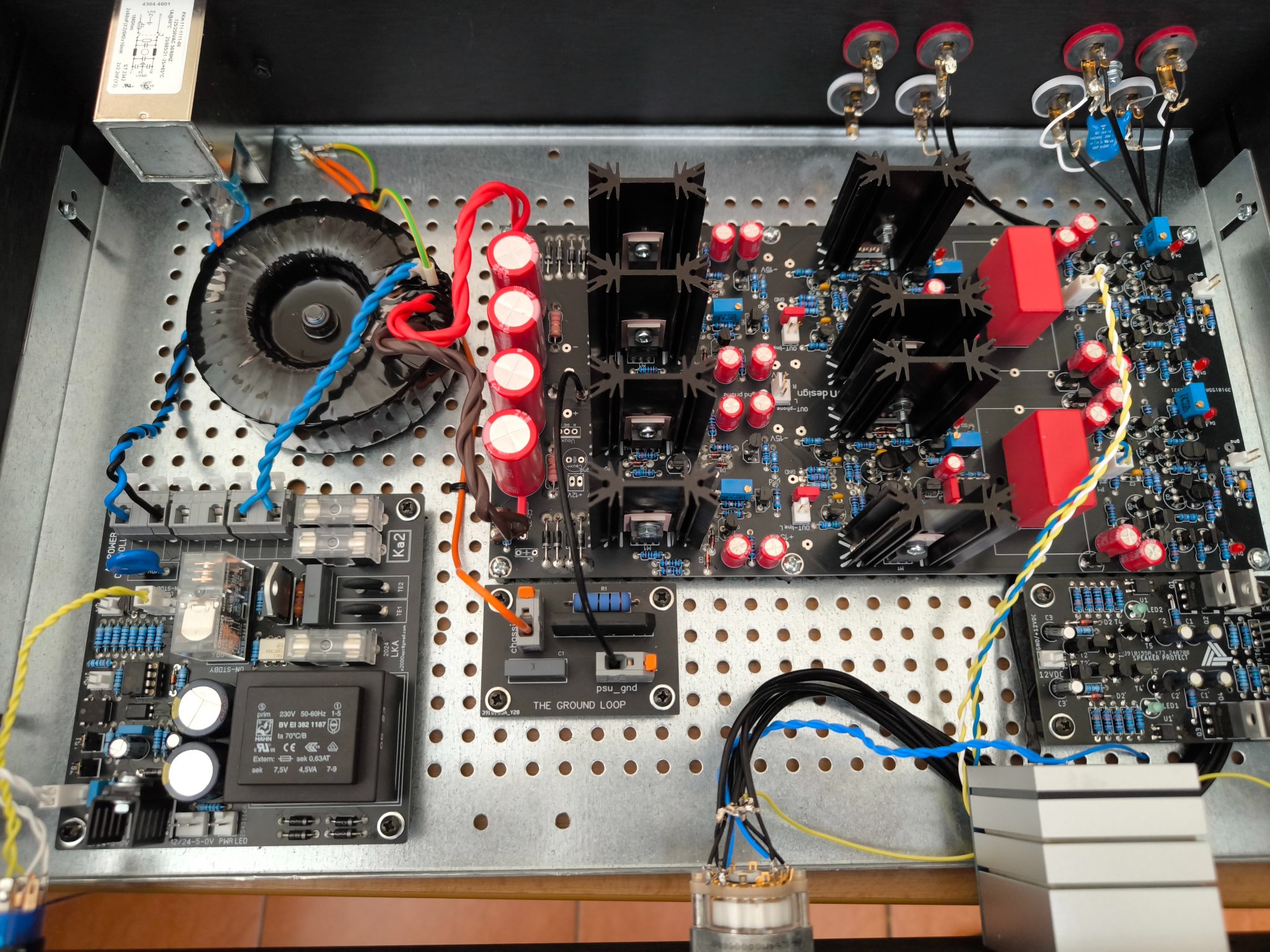

I got a new transformer, on which I left the primary at 230V, because I live close to the substation in the network I have 237V which gave me a slightly higher secondary (16.2V AC). I ended up at 33k (R7), after settling I have a bias of 145mA and the shunt regulator goes up to 15.5V, after about 30 min of overclocking I set it to 15V
Today I hastily plugged it in, I listened to it only as a preamp and I can confirm that it plays great for me.
