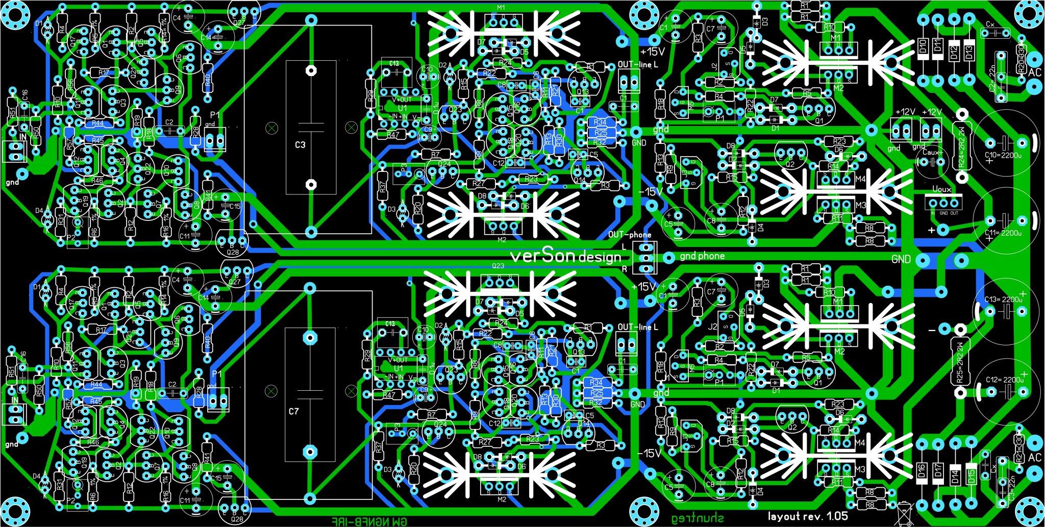

GainWire line/phone non GNFB preamp
I haven't heard this version, so I can't judge. If I didn't have DCG3 worked out, I'd definitely go for this one. It would certainly be an interesting comparison to the GainWire MK3.
@dadod, If you've heard both, how is this one better than the GainWire MK3, as they both have a similar harmonic profile.
Yes I've heard both and I like both, those are mine creations, and it's not easy to judge. There is one tehnical reason to prefer this one with no GNFB over CFA, same SNR value for all volume levels, volum control is after gain block not at the input, look for explanation in this thread.

Damir, it looks great. Now I'm on the fence about which version to choose for the final build. If I look well this GainWire has mosfets on the output, I think sonically it will be a bit different from CFA GainWire.
Also in this pcb layout is it necessary to use the GND connection as in post #7?
Roman, best way to know the differences is to build both versions, I have both.
This is corrected layout with those wires as a part of the layout, so not need.

Just remember not to solder C6!!!
One observation:
The capacitor wich influence the SR mostly here is C2. I use 22pF. I tried with 10pF but one channel got unstable, so stayed with 22pF as did not 15pF at the hand.
You can try with 10pF and if there is no problem with stability live it at 10pF.
I am talkig real preamp not simulation.
