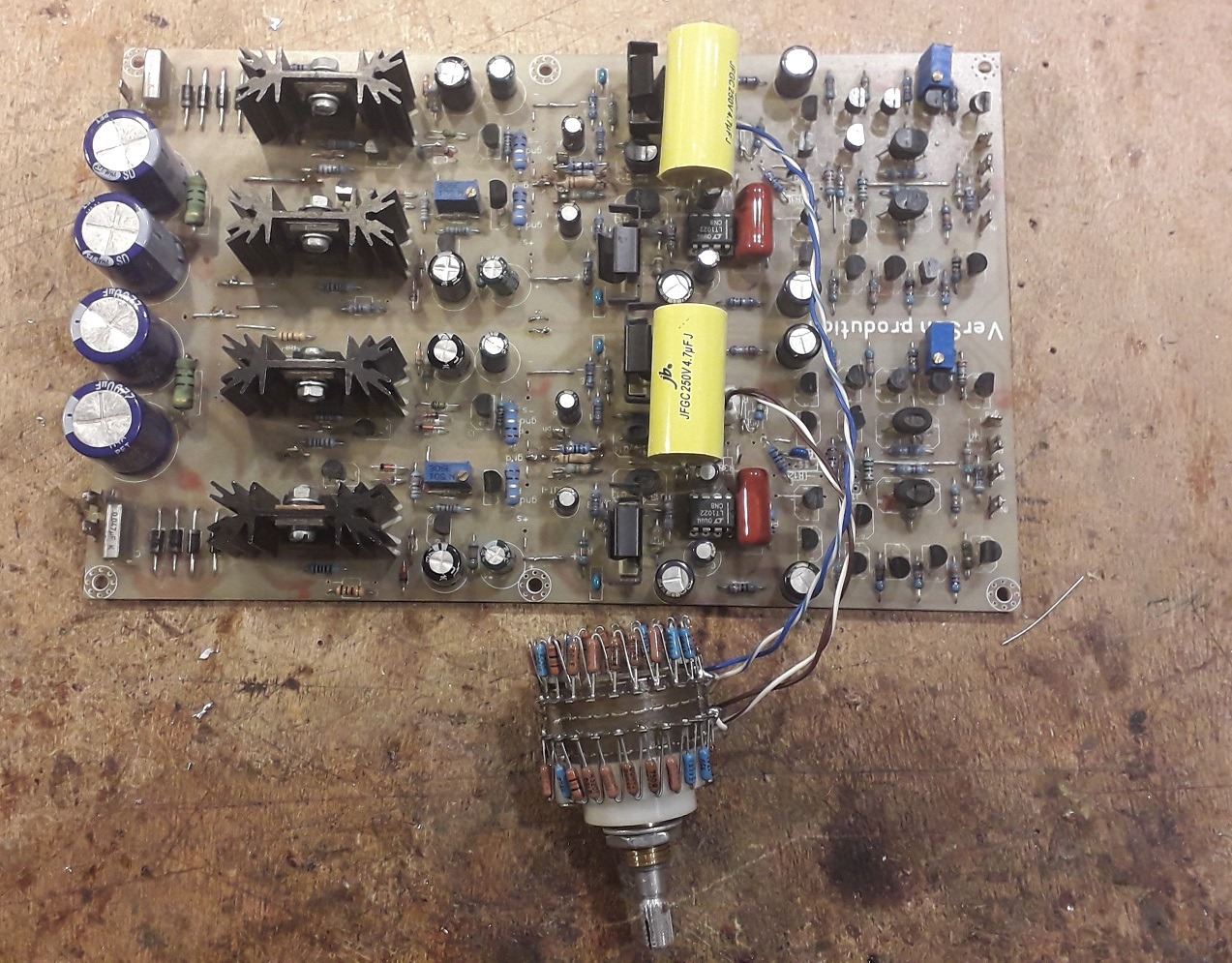

GainWire line/phone non GNFB preamp
This is a line/headphones preamplifier with no global NFB used, but still with very low distortion.
First stage is input gain stage with variable gaain
Secon stage is a buffer.

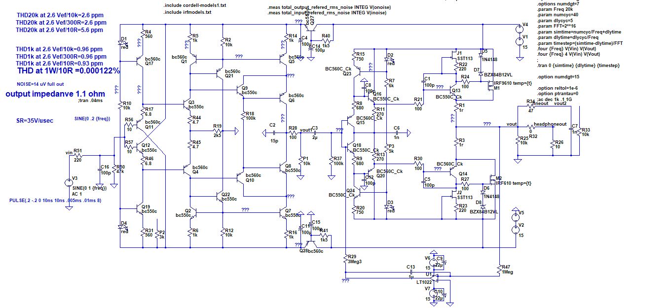

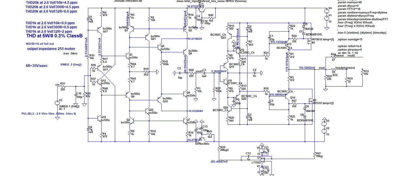

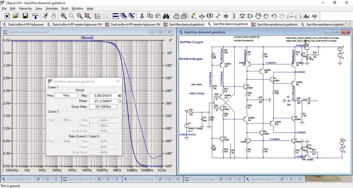

Here is description of first/gain stage.
It started as GainWire CFA preamplifier, and I decided to redesign it in to a non global NFB preamp.
The gain is set to 4 times at the rheostat P1 value of 10k and it's calculated as P1/R19.
It uses a current conveyor as a gain block.
SNR does not change with the gain, so it is the same for low as it is for high gain, as the input signal is never attenuated, signal noise ration stay the same for all gains.

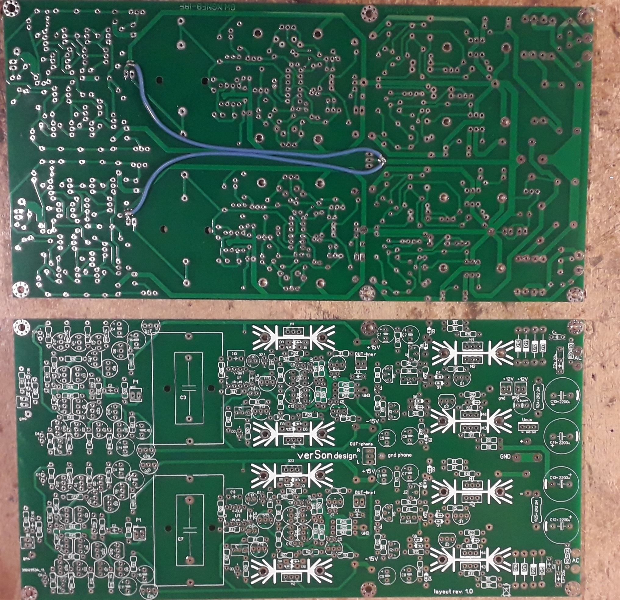

Gerbers are here: https://www.diyaudio.com/community/...ne-non-gnfb-preamp.395695/page-3#post-7733838

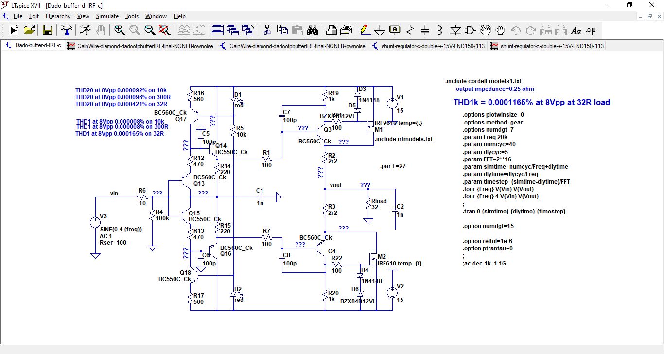

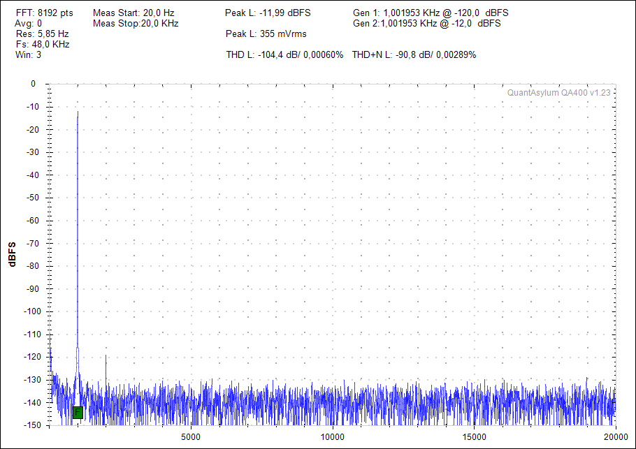

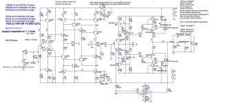

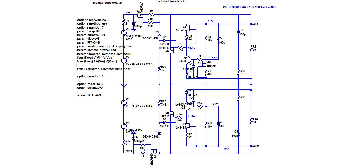

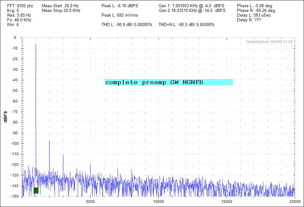

After the gain stage there is a buffer.
First is the simulated buffer, second is a built one and last measured THD.

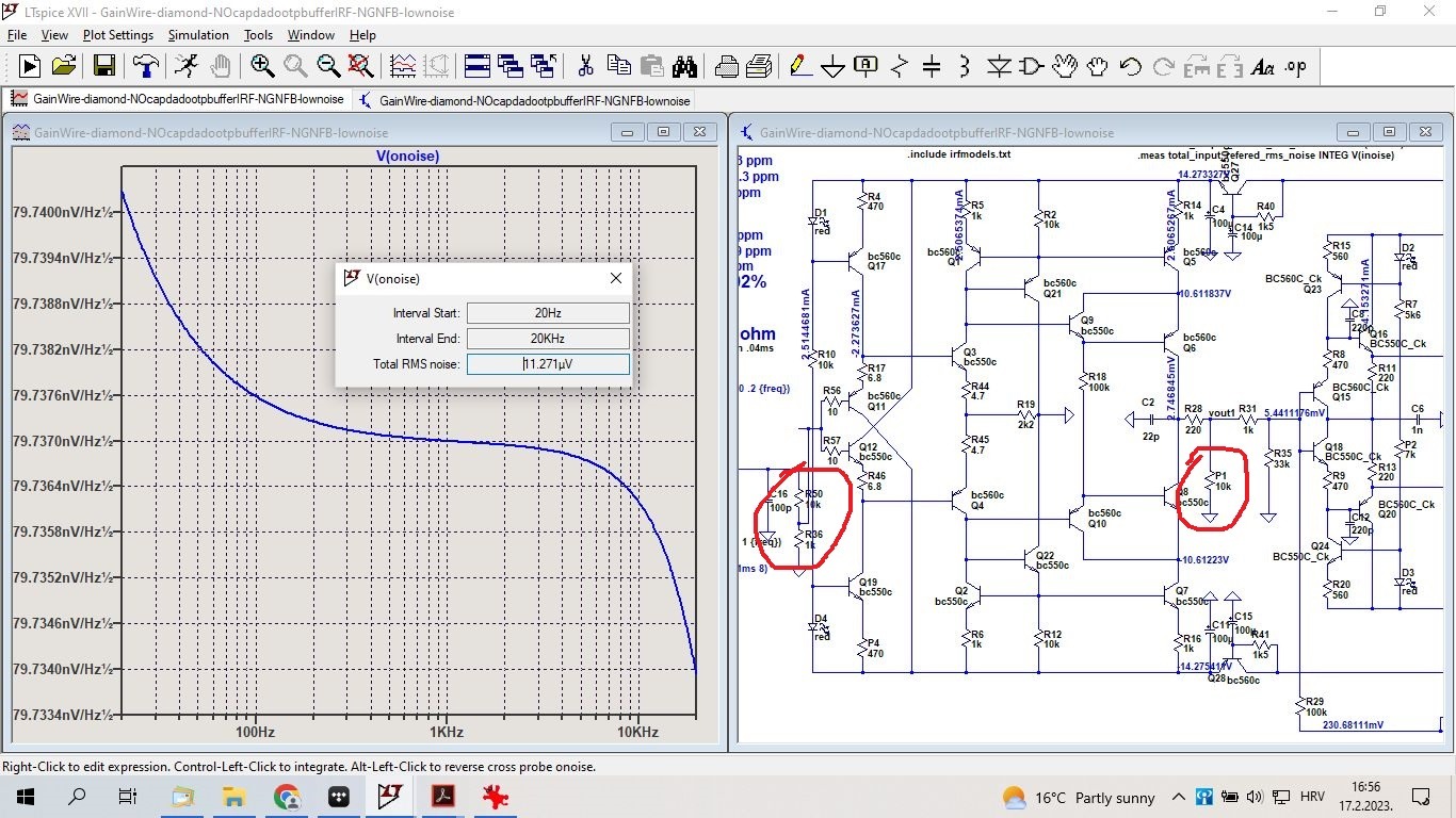

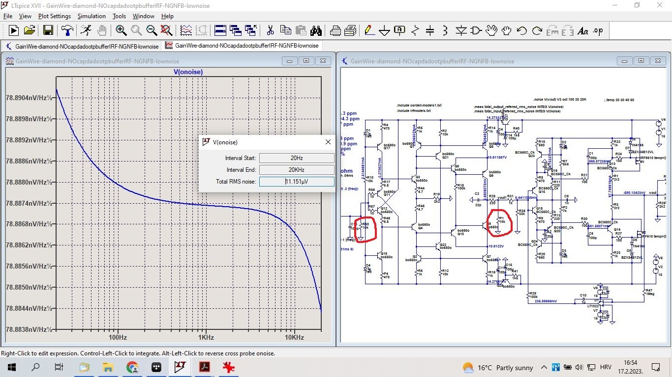

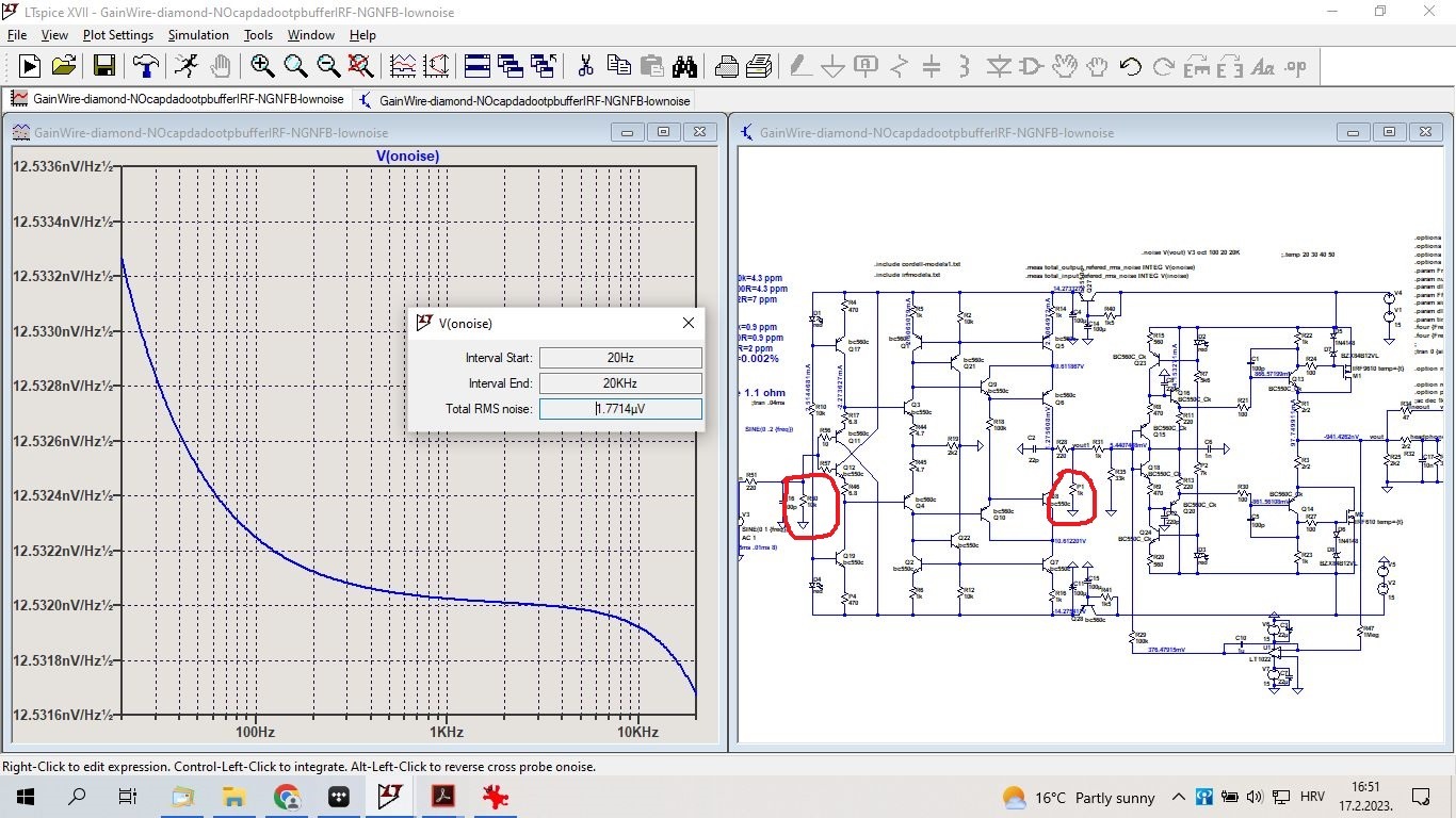

Here I will try to argue way is good to have volume control after gain stage and not at the preamp input.
First simulation shows the preamp output noise at full gain. P1 is volume control.
Second simulation shows preamp output noise at 1/10 of the gain.
Third simulation shows preamp output noise at same atenuation 1/10 but at the input.
So with volume control after the gain stage this preamp keeps SNR low for all volume settings.
With input volume control SNR drops at low volume settings.

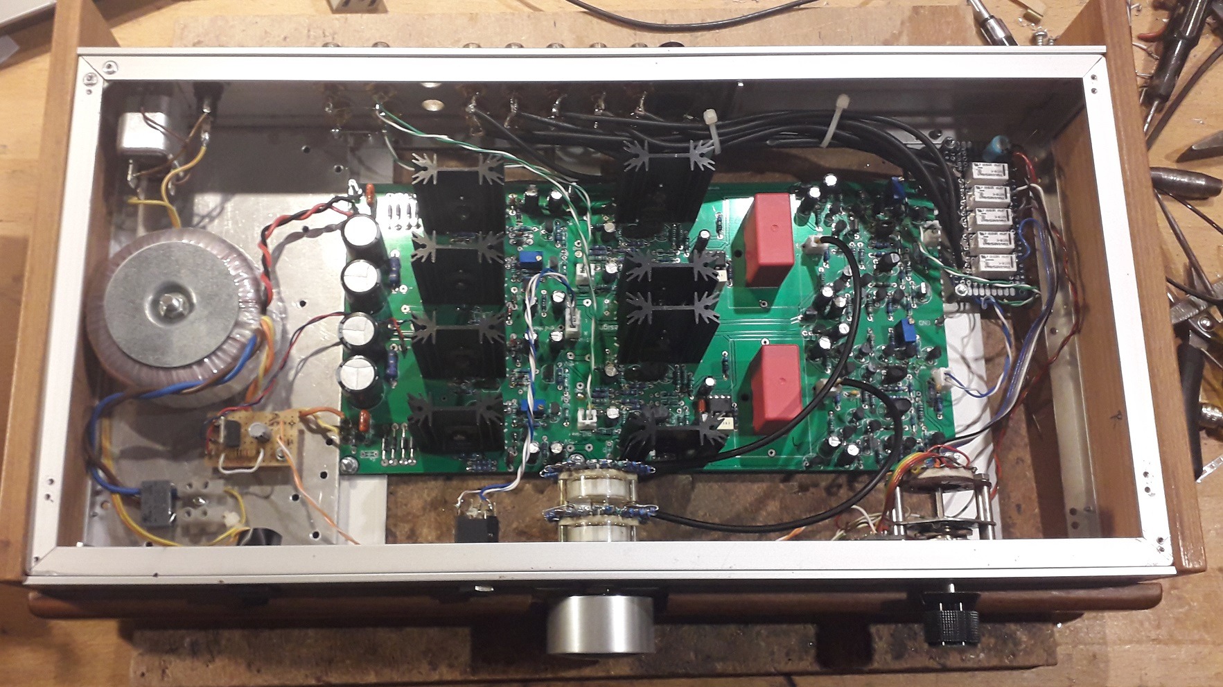

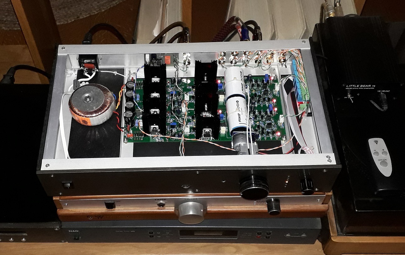

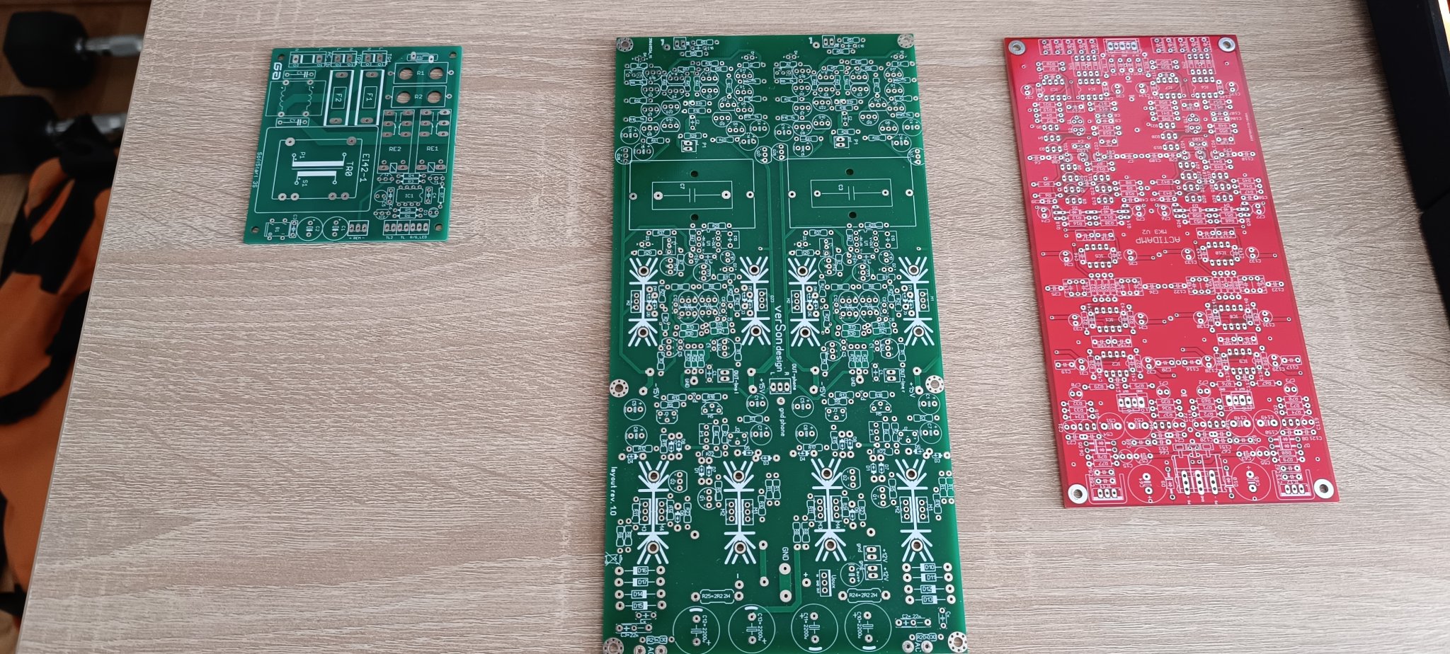

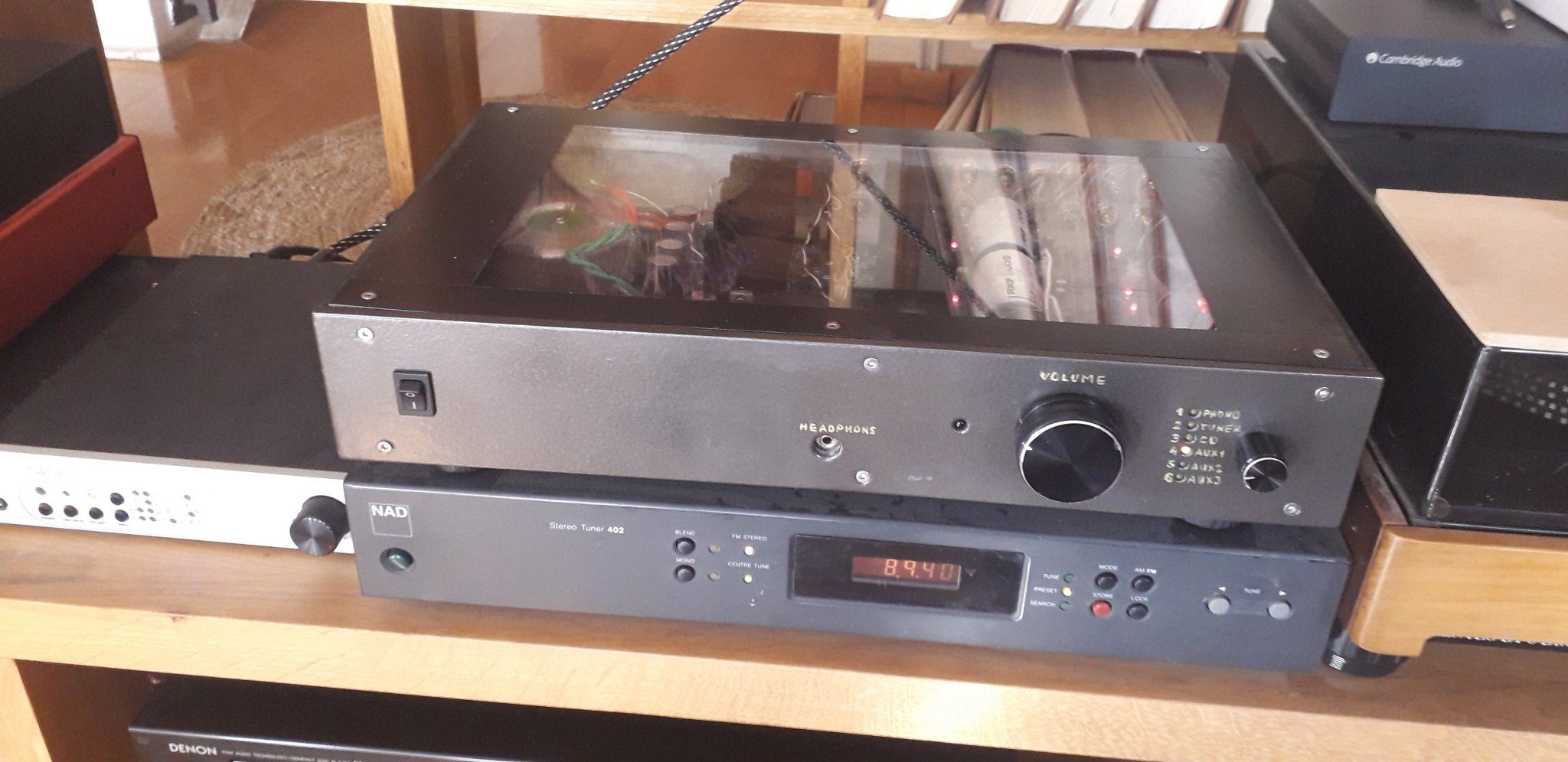

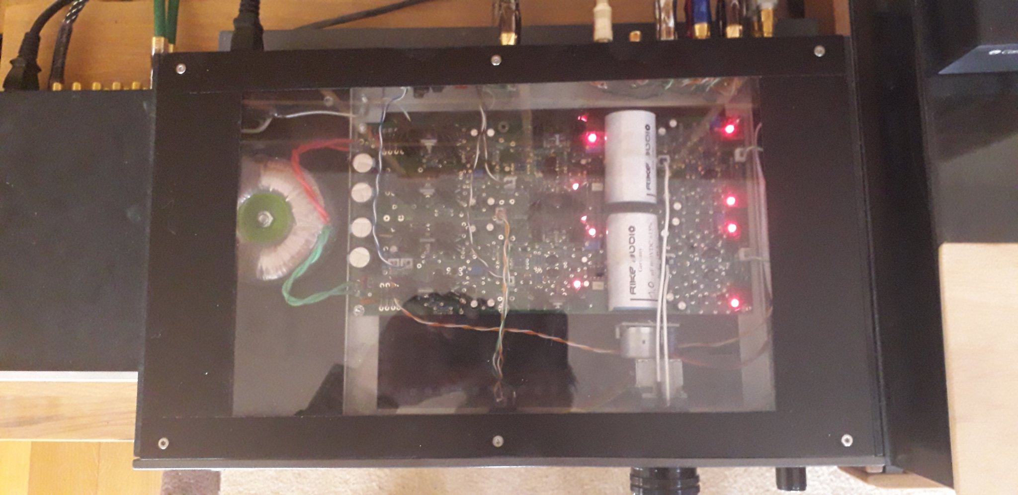

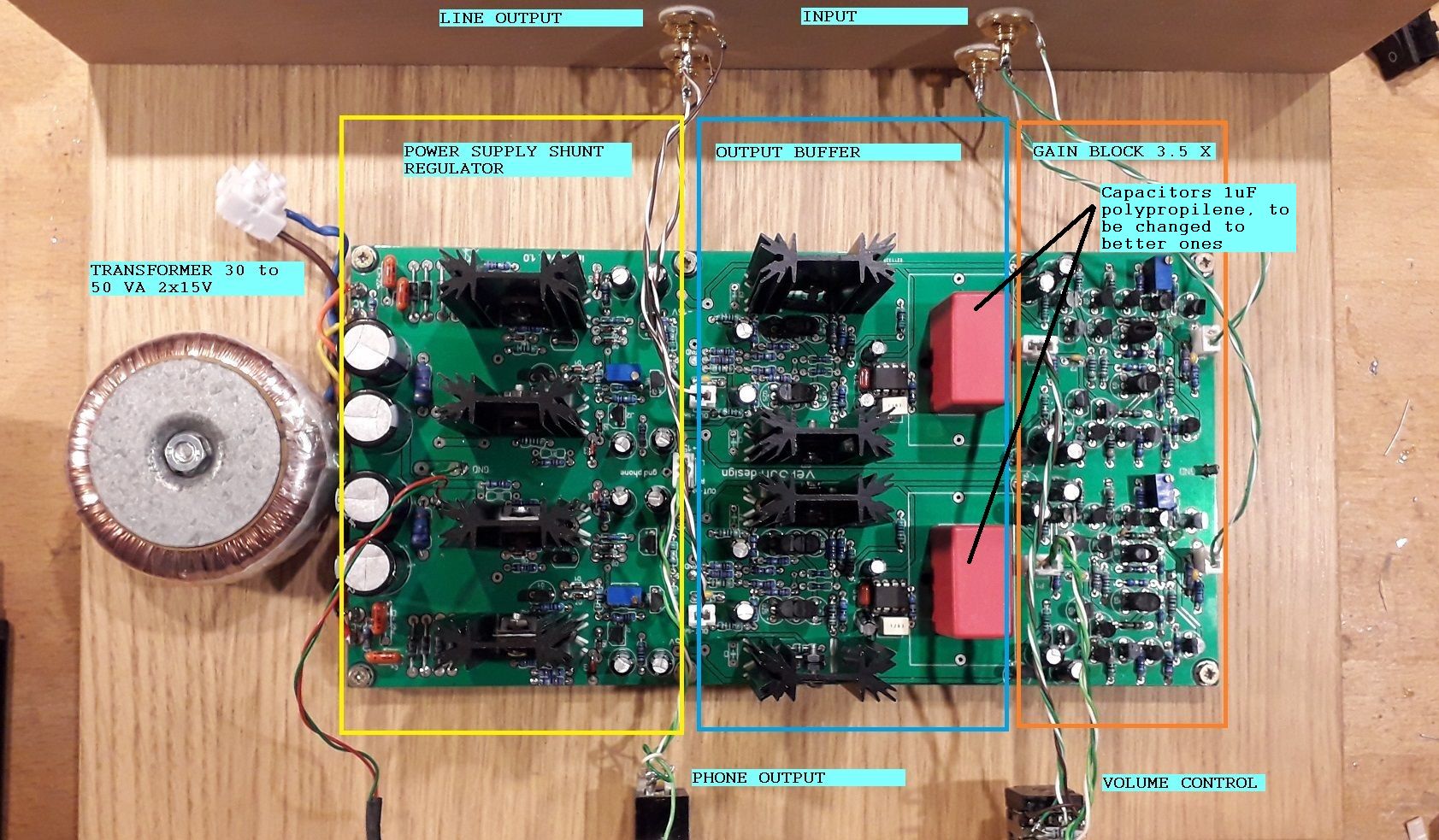

My new preamp, coming soon 🙂
1, Red pcb (reference MM phono preamp)
2, Green pcb (reference line preamp GainWire)
3, small green, inteligent on/off module

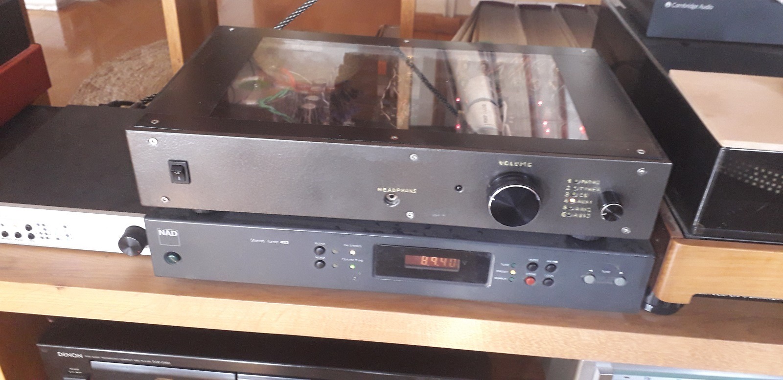

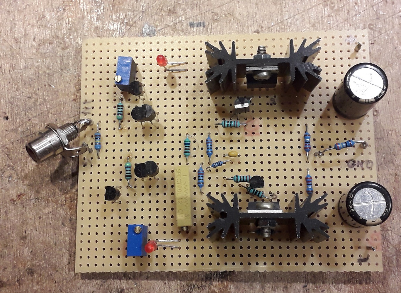

What is the effect on the sound of selecting the capacitor at position C3 (Wima vs Jantzen Superior Z-Cap)
