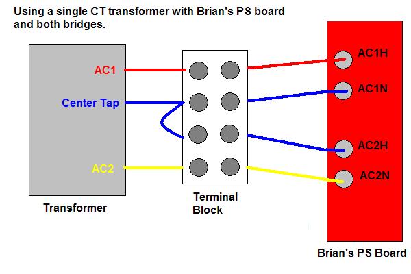

center tapped confusion
I recently attempted the wiring scheme suggested by Sherman...
" The center tapped transformer is running through both bridges (just like a "real" transformer).
Wiring was done like this-
AC1 from transformer to AC1H on PS board, CT from transformer to AC1N and AC2H on PS board and AC2 from transformer to AC2N on PS board."
but it didn't work... the scheme appears to allow current to flow from the CT through pg1 to pg2 and then to AC2. Thus causing a short when the grounds are connected.
What am I doing wrong?
Thanks,
Steve
Re: center tapped confusion
but it didn't work... What am I doing wrong?
Thanks,
Steve
Steve,
Below is a diagram of how I connected my CT transformer to Brian's PS board.
Here are the specifics: My transformer is a 40VCT which gives 20VAC between lead one and the CT and 20VAC between lead two and the CT. As you stated PG+ and PG- are connected on the amp board. That means they *must* come from the same lead on the transformer or it will cause a short (I know from experience!).
On the PS board AC1N becomes PG+ and AC2H becomes PG- for output to the amp. That means that AC1N and AC2H have to be from the same lead on the transformer or it will short. If both AC1N and AC2H are from the same lead I don't know how that could cause a short, you are basically connecting a lead to itself, no problem with that.
I wired my transformer as in the diagram below. I connected the trafo leads to a terminal block and used a jumper wire to double up the ct as illustrated. I then wired from the terminal block to the ps board as if I had a dual secondary transformer, treating the ct leads as both AC1N and AC2H.
I hope that helps.

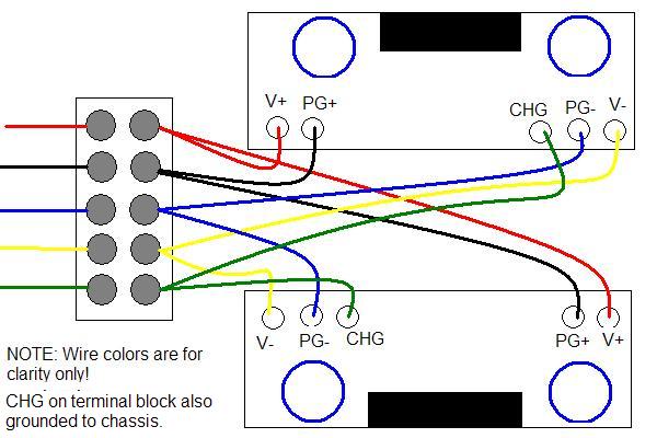

No, I connected the wires to the "AC input" section of the power supply board as shown in the previous diagram. I then connected all the outputs to the amp boards as shown in the diagram below.
Please note the wire colors are for clarity only, they are not the same as in the previous diagram!
The CHG wire is connected to the ps chassis and to the amp chassis as well as to the amp boards, it does not come from the ps board.
OK to clarify even more where the wires come from. The AC and CT wires from the transformer connect to the AC1H, AC1N, AC2H, AC2N points on the PS board as shown in the first diagram.
In this diagram- red is V+ from the PS board, black is PG+ from the PS board, yellow is V- from the PS board, blue is PG- from the PS board. Those connections are on the opposite edge of the PS board from the AC connections.
The green wire is the chassis ground, it connects to a screw in the PS chassis and to the ground wire in my AC cord from the wall socket, it doesn't come from the PS board at all.

Just wanted to post a followup on my progress regarding my problems using a center tapped transformer.. I recalled that Peter Danials had reported using the same transformer that I was working with so I e-mailed him to ask how he implimented the bridge.. He replied that he had converted the center tapped transformer to dual secondaries by opening up the outer tape where the center tap is attached and simply disconnecting the two secondary neutrals that are tied to the center tap... I followed this procedure and... works great... thanks again PD.
Steve
