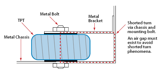

This is bad..... I just ruined my amp by moving the transformer on yesterday. It spiked once when I try to put the transformer back into the chassis, then I quickly turned off the power. The next time I turned it on, the speaker have bu..... sound. Then I knew I messed it up again. It is lucky that I am wearing plastic gloves in this operation. So no one can answer me why the tranformer heating up the entire chassis? I am surtain that the transformer causes the heat, and the whole chassis and the heat sink is fine when I removed the transformer from the chassis. This transformer wasn't causing heat before, because I had been using this transformer since the first IGC I had completed, and the 3 weeks testing of brain's board with out the chassis. I remember it is not even warm when I touched it after running for a day. Besides this problem, how can I isolate the transformer form the chassis that the plastic warp of the transformer started to break. Can I warp it over with some sort of electronical tape to prevent the next shorting?

What parts are ruined? I can send you some extra parts to get you going again. As for the transformer, can you post some pictures of how you had it mounted? Make sure that you don't have a shorted turn. See attached image for illustration.

I mounted it like your post #469 without the ac inlet aginsting the tranformer, instead my chassis wall and the heatsink are tightly keep the transformer in place which is a bad thing..... btw I haven't check which of the compents are fired yet, so Brian don't need to worry. And thx for your offer, but I got extra parts form the my IGC first failure...... 5 more LM3875 including the one on my IGC to go and two fully functional bridge. I hope those LM3875 are fine cuz I am planning to bridge it to make a sub amp with the Mox crossover.
Addition: Oh great I got a short turn then...... It matches everything they said in that thread. My bolt got hot too. AM I going to need a new chassis? Am I spending those $100 for nothing.....T_T😡

In my case, are there any ways to solve the problem without remaking the whole chassis? Plz help guys !
Couldn't you just attempt to insulate the TPT so you don't attain the loop? Isolate it from the chassis and break the short...
You could use a plastic bolt.
widman said:You could use a plastic bolt.
I like to just hold the things down with multiply zip straps.
