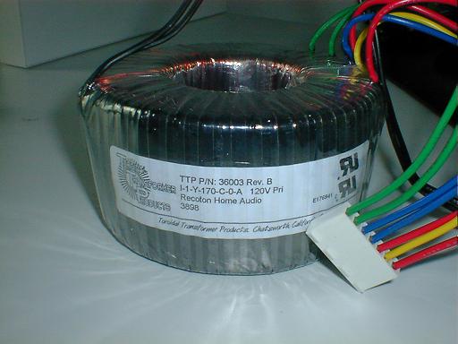

I have this transformer I want to use with a gainclone (picture below). Of course I don't want to fry anything. So I hope some one can tell me if I got it right.
The transformers black wires go directly to an outlet. The blue and green pairs measure 21 VAC each. These go to each gainclone channel, right? Is this enough VAC for the gainclone, usually (might be optinion question, I'm not sure)?
Then the red wires have 220 VAC between them and 105 VAC when one is hooked up to the yellow wire. But they do nothing for the gainclone, right?
My last question is about the fuse. It's 2A slow blow right? 5A is too much?

Sounds like you have it correct. Make sure to have the slow blow fuse in series with the primary AC hot wire for safety. I am using a 3A slowblo in mine, since I had it laying around.
I would cut off the two red and yellow wires, and insulate the ends, not using them.
The two 21vac secondaries should be just fine for the gainclone. You will put all 4 of these wires into the rectifier pcb, which will power the 2 gainclone channels.

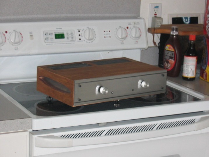

Here is a picture of my nearly completed prototype of a 3-way
electronic crossover with 3 of Brian's Gainclones. Although you can see I still have some grounding to complete, I couldn't help but take a quick listen last night and was very encouraged.
I can't thank Brian enough for the effort and hard work he puts forth on behalf of the DIY community. There are obviously some great ideas promoted by some very talented people on this site.
Thanks to all of you.
