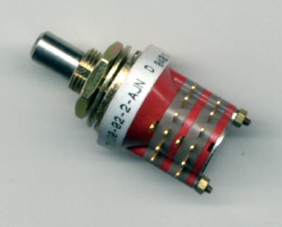

chipco3434 said:There seem to be a lot of choices in Grayhill switches, and that brings up a couple questions. Do you switch both the imput and the ground? Could you suggest a Grayhill that might be the "perfect?" selection for a three input selector switch?
This is the Grayhill switch that caught my attention in DK catalog. Part# GH7104.
It offers 2 decks (2 poles per deck) and choice of 1-6 adjustable positions. So this one will allow switching both signal and ground for each channel. Similar, Grayhill switch (but PCB mounted) was used in an older ML preamp.
Peter

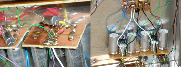

Why have the caps to be nude? Is this some kind of obsession with nudity? Well then go to the naturist beach! I can hardly believe the sound is better.

Electrolytics do sound better without their sleeve and I did not believe that either when someone pointed it out to me. I even know guys that take off the alu case and make a wooden one (!) instead filled with bees wax
This is really one of the weirdest and potentially dangerous practices I've seen since I am doing this audio-hobby.
Because of safety I don't do it though. Short circuits, possible reversing polarity are some of them.
