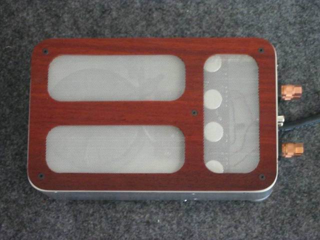

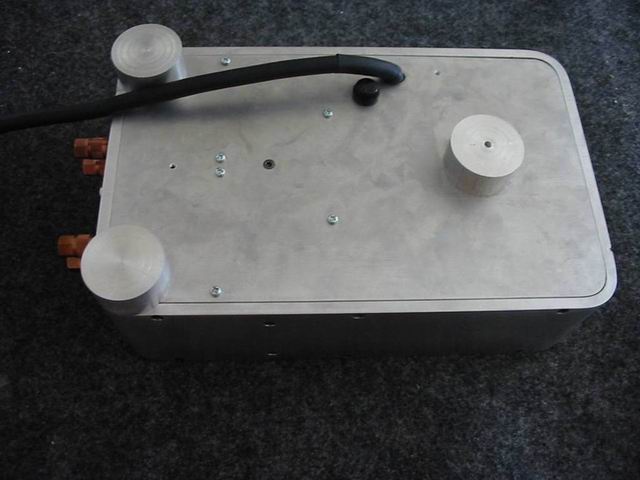

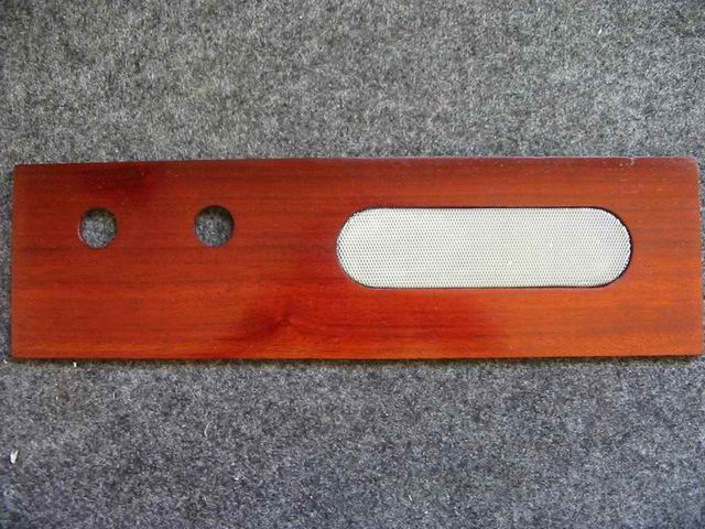

BTW. I built this unit totally DIY guerrila style. The 1/4" al was cut on a table saw, all holes were drilled with a drill press, the holes in the top sub plate were drilled with a forstner bit then the holes connected with a jig saw, same as the wood layer. I did have access to a rather large bender though( my friend is a blacksmith
). The finish, so far, is about eight hours of watching tv or listening to music and scrubbing with scotchbrite pads.

I designed it to match the face of my DIY'ed Pas pre amp.
