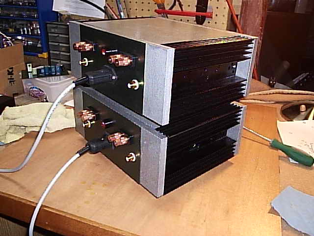

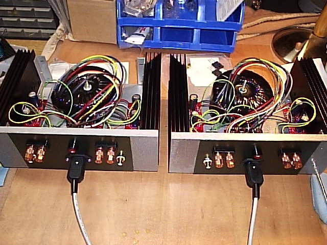

All three are done, will do the hook up wires tomorrow.

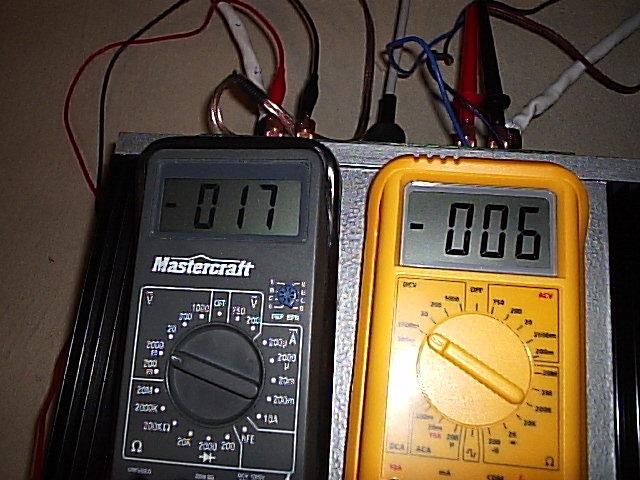

First time power up of GC#2 tonight, no hum, DC offset at binding post -109 and -98 mV not as good as GC#1 weighted in at -68 and -34 mV.

The only connections made to the GC when the DC measurements taken were the power cords.
When connected to the system with input and output. I could only hear a very faint hiss with my ears three inches from the ribbon driver when the CD tray is open. And that hiss reduced much much further once the DVD players' laser pickup engaged like when the CD info is displayed and waiting for instruction. My listening position is around 12 to 15 feet away. My speakers are 10 feet apart. To me that's no hum to worry about.
Chris
For me, I think low DC offset will be better to your speakers. And I never see some skillly constructed GC got DC offset over 100mV. Maybe it is the way I test the output dc offset different from yours. I connect my laptop/MD/CD player straight to the input, and measure the binding post DC offset while it is connecting to the speakers. It is two bookshief speakers which sitting on the desk while I am doing homework. So I am really close to it. If the hum is not a problem, then it is fine. (I think)
