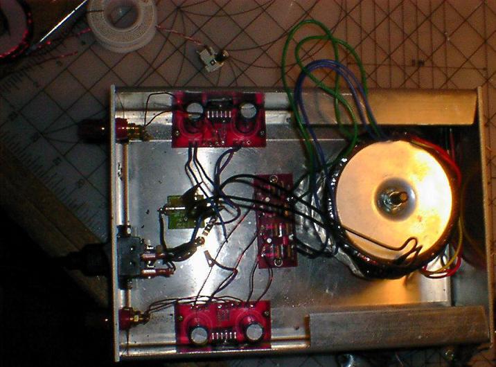

I removed the signal imput wires so I can focus on what's making this humming noise.
I think I might have fired the caps also, I had something wrong with the soldering and/or cleaning of the PCB's and the caps started to smoke and also the power supply and also the soldering joints that go to the terminals and probably other stuff too. So if it's the caps, I don't know if I will ever solve this problem. I don't know if the amp can play music with damaged caps cause it does play music, only with that hum.
I have grounded the plug, and two channels at one point on the bottom of the amp chassis and screwed it down. I don't know what more to do with that. I have resoldered everything and replaced all the wires. All wires are 18 gauge.
The RF/EMI interference I don't know how to fix. Should I use twisted CAT5 network cable wire pairs inside for all the wiring? This would take some time cause there 22 or 24 AWG I would have to use 2 wire pairs for to joints.
Do you (any one) think that I damaged the caps? The caps didn't start smoking I think it was V+ soldering joint under the cap that was making the smoke.
Here's a picture of it maybe some one can tell what wrong.

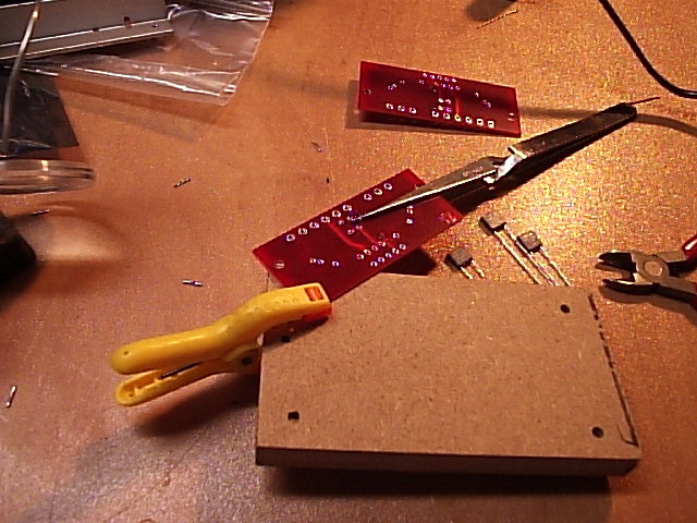

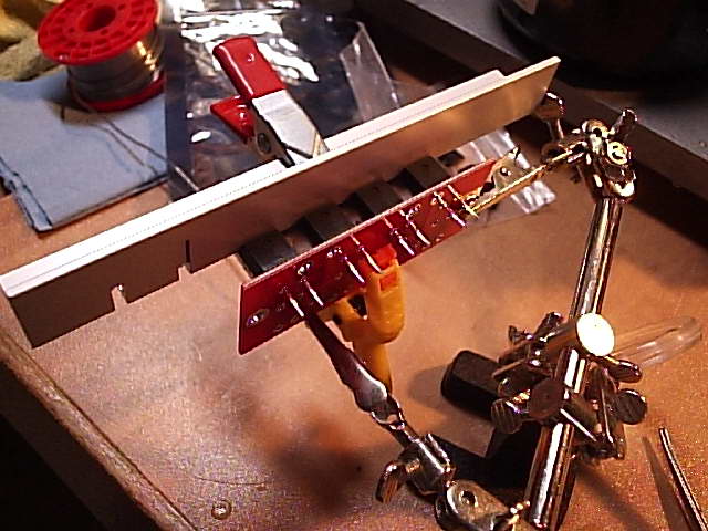

Here is how I line up the rectifiers with scrap material and clamps doing the B_GT bridge board. One clamp to ensure perpendicular to the pcb and one clamp to secure pin depth so that the ironing tip could not move the diodes. This can also allow using two hands to do the soldering.
Chris
