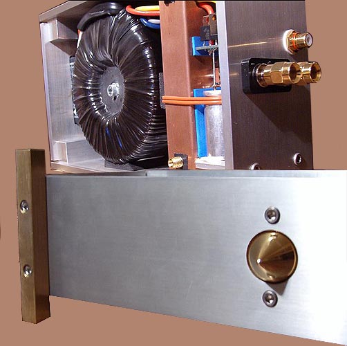

chipco3434 said:Are there any issues about mounting a toroid vertically in an enclosure...
My planning has left me little alternative.
I don't see any issues with this.
Brian
S.C said:Peter's AMP-2 transformer was mounted vertically, and mine too hehe
I like the way he did it too.
Brian
