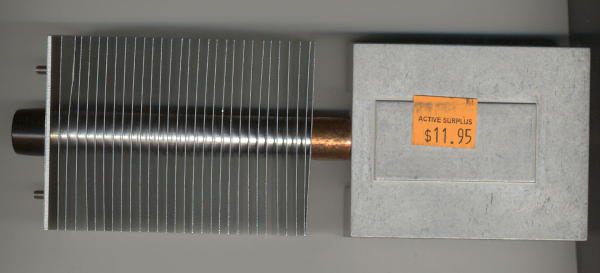

Re: Re: -=Sneak Peak=-
I guess there are two different Active Surplus stores in our area
Coulomb said:
Hey, I have seen those Heat transfer pipes at a local supplier for $3 CAD each!
Antrhony

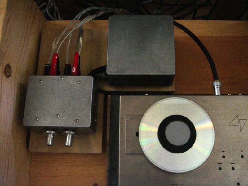

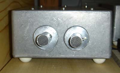

Re: How good is this 47Labs player?
It's the best one yet (out of my 3). I think the very short wires made a difference. But the construction was difficult (the plitron TF was a pain to fit) and I made the mistake of not pre-wiring the boards so I was soldering in a tiny space.
The stepped attenuators are home made and they help too.
