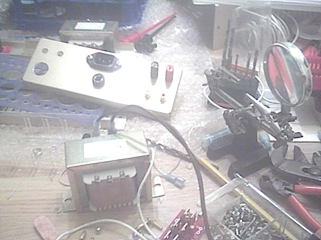

uvodee, i wish my workbench was that neat while work in progress 😛
I should add tho , probably the only reason im not is that They would have ot be shipped across the country, and not worth it as a result 😛

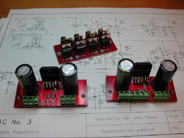

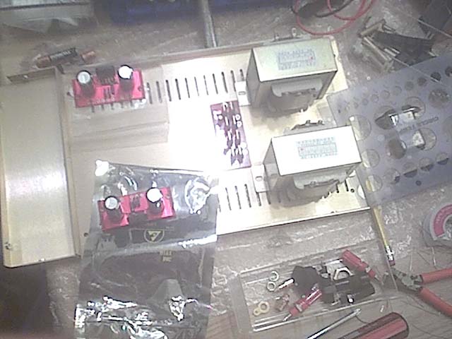

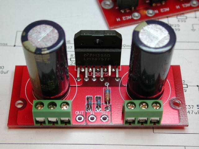

My kit arrived Saturday. Sunday I soldered up one amp board and the PS board. I have a center tapped transformer so I wired it like this- AC1 from transformer to AC1H, center tap from transformer to AC1N and AC2H and AC2 from transformer to AC2N. Powering up I'm getting exactly 25.9V + and -. I haven't connected it to the amp board yet.

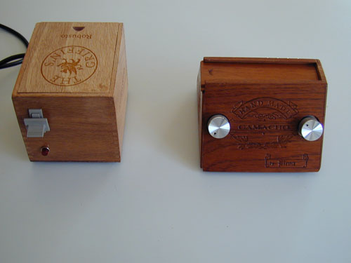

The case I intended to use may be a bit too small (a pyramid shaped cigar box). I might be able to use it by redesigning my heat sink. I hope to get the other amp board soldered today and the new heat sink cut to size. Maybe then I can verify that everything fits.
Here is a photo of my PSU and the intended amp case. If I can't fit it into this case I have a larger cigar box that should work with no problem.
I'm really looking forward to getting it operational!

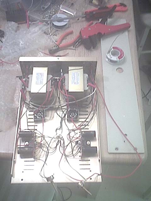

Sherman: THIS IS BIG!!!
I have been tormented because I have center tapped transformers also. Brian helped by showing a single bridge scheme for center tapped but OF COURSE we want the double bridge approach everyone else is doing. Especially since I have 2 transformers, so will be making a dual monoblock type approch.
Everything seemed top indicate that the center tapped could be used, but the experts seemed a little concerned. PLEASE continue to keep me informed as you attach the amps to the power supply.
-especially regarding possible explosions and/or sheeets of flame
No photo I can see- I guess it was too big. Would like to see the
PS wiring in a photo, although you described it well....

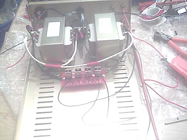

I will post the results here when I actually try to connect it to the amp and turn it on. I'm truly hoping the magic smoke stays inside the components! I actually tried a different approach, making the CT = to the AC1N and AC2N but connecting the grounds together blew the fuse. I think that since the two grounds PG+ and PG- in this new configuration both come from the CT it should work.
Here's the photo.
Here's hoping your magic smoke remains where it belongs.
It's a little tricky for me to figure out what the center tap is up to also. I was planning to try it as your first unsuccesful experiment. I've been told that if hooked up wrong, the fuse blowing is the result, so your first results make sense and make us think that you have it "wired" now 😉
I'm jealous that you are so far along...

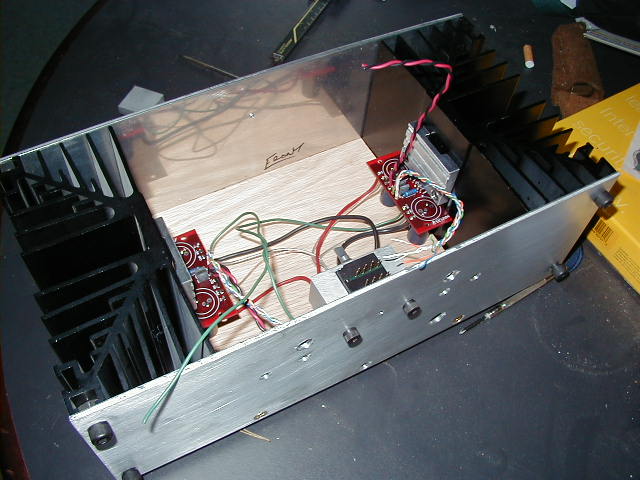

Coulomb said:Well Brian here are a few work in progress pics of my Dainty Amp project. 🙂
I am not sure of the chassis design yet.
