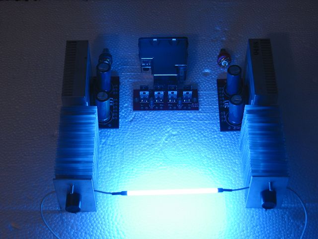

That's way overkill for the heatsinks. You'll be able to put six GCs in that case!
yes, but they are free and I had "matching" 1/8" plate on the shelf.

Wardsweb said:Without giving away to many secrets, here is a pic of a work in progress. Realize the light is NOT that bright. It just looks that way because of the camera speed set low to get enough detail from the surrounding area. Yes it's blue.![]()
Hey, I have seen those Heat transfer pipes at a local supplier for $3 CAD each! 🙂

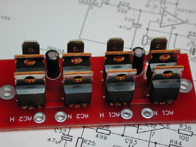

I don't think that you would want to have the diodes for the power supply rectification that close to the inputs.
A single board would be interesting looking, but not too versatile. If you look at my gallery, you will see how different all the designs are using the pcbs:
http://www.BrianGT.com/gallery/nigc
Brian

It would be nice and interesting, but this would limit the application of a single board. People would be forced to use it in one specific way only and this would not allow much creativity.
I'm bugging Brian to come up with revised rectifiers board layout, where amp board and rectifiers board are separated by 1/4" standoofs only and PS pads on both boards are aligned so only 1/4 wire lengths connect power from rectifirs to amp board. This is 3 dimentional construction method and has advantage over using a single board for those circuits. I would also use ground plane on rectifier's board to shield amp's circuit from rectifiers.
Then you only connect AC power to that module. As to the RCA input and outputs, a short wire runs would be better that PCB traces, if proper wire is used. Also different kind of binding posts and spacing on them would be allowed this way.
Heres the example of what I'm talking about, but spacing between two boards would be less. As it's now, there is no interference from bridges.

Brian, if you do a revised board, why not also have the amp boards symetrically on each side of the power board with the chip attachment holes on the outside ends of the whole board. As it is now , only one chip is on the outside. That way if you WANTED to be limited, you could leave the whole board in one piece, and the heatsinks would attach on the ends of the board. If you WANT versitility, you snap the board in pieces....
Not if you leave in the score lines so you could also snap it into pieces exactly as you can now. Of course the traces couldn't continue across the scores, so I guess you still need jumpers across them.....I guess Thomas B wanted the traces to be continuous, yes, that would be limiting- I get it now!!!😀
I think you could combine Peter's and my ideas. The amp boards on each end are identical, it's just that both sides have the chip/heatsink connections on the outside...
P.S. Did you notice that Sherman seems to have come up with a way to use the dual bridge with a center tapped trannie?
