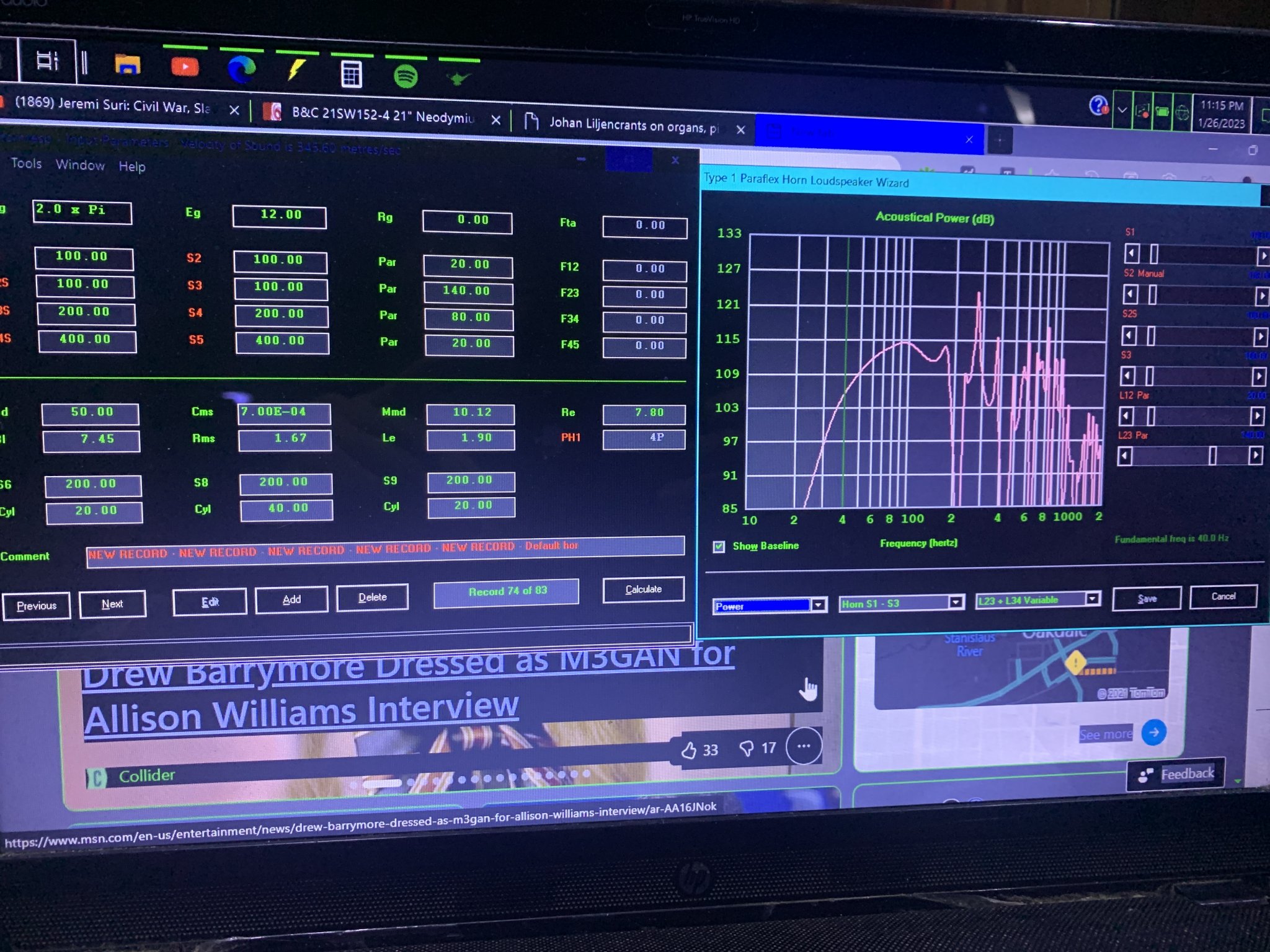

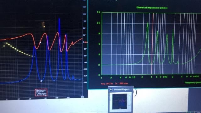

its all there if we look…. ’ random’ wizard mode simulation results by sliding things into where they ‘look’ good makes mediocre subwoofers. But when looking for something that already exists using horn response, and finding it, is the 🚀🚀

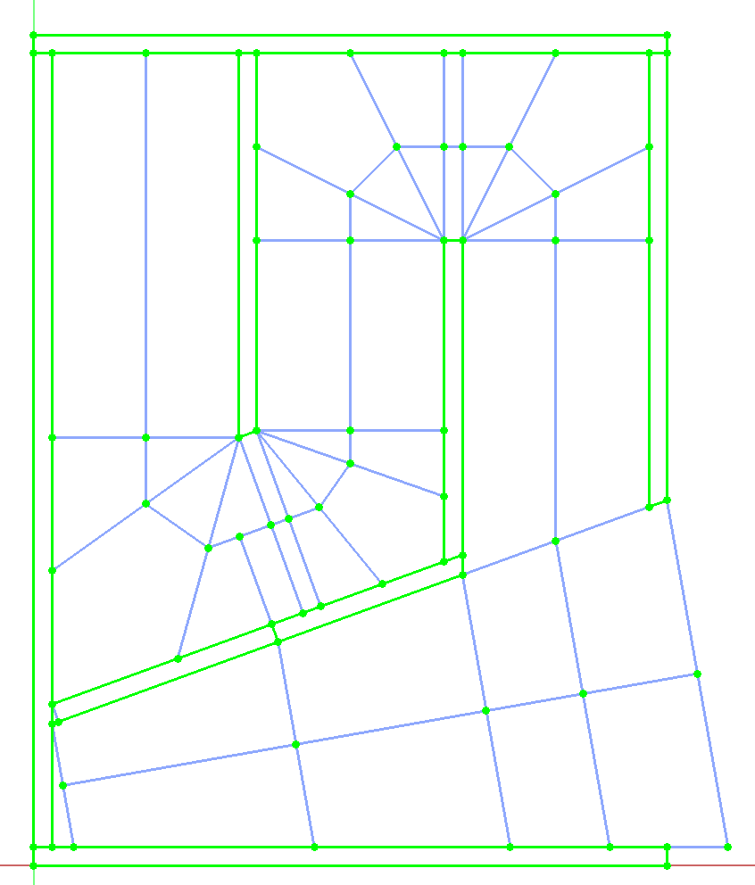

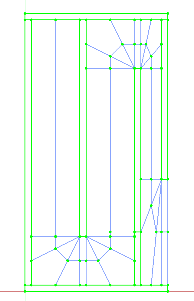

I implement two of your regular post layout and played with them in hornresp and FreeCAD, I played with some different lengths, ratios and cross section areas but I wasn't able to see improvements compared to others design so I quite and didn't complete the models. Maybe Brian can better explore them.
Reducing the cross section area in the last segments helps to damper things, but it will increase air speed, I din't check any value precisely. Specially for TH type this approach will increase the difficult to assembly the driver.

I don’t know, but my impedance plots measured and simulated are dead nuts at it. I am folding these in thirds, and not complicating it with all kinds of extra weirdness

I can complete both models for you in FreeCAD, the Paraflex and the Tapped Horn - TL, in addition just indicate the driver you want to work with so I can set up
Thielle Small parameter in the model and so you can focus only to adjust the dimensions.
Change them according to your math and show us the results, like comparing the phase response from your model to the classic TH-SS or any other consolidate solution. We can create a specific thread to discuss your design advantages but it's important to find a good way to demonstrate it using screenshots. Angled photos and random numbers are not helping much. Even simulating them I can't find what you say.
Let us challenge you and learn with real results.
3:1 as measured and as simmed and we don’t have the discontinuity in them as you can see in the white picture sim and measurement

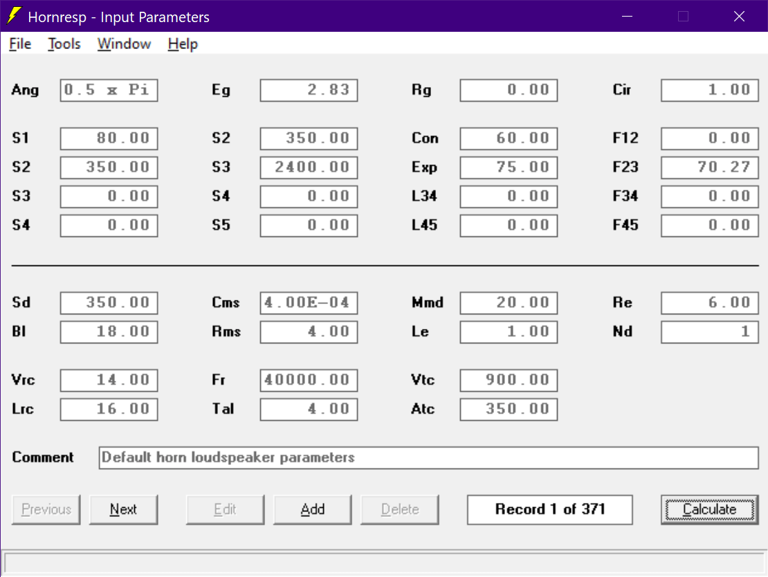

Can you be more specific and show all your hornresp screens ?
Your graphs cell pics lack the necessary optical detail
Share/upload your hornresp txt file so we can see clearly in our own copy of hornresp the complete scenario cause we don't have a clue what you try to show

my computer screen is broken from testing speakers in the field and the screen is what it is. I can’t do anything about that it’s about to seperate from the lower half and apologize. Lord sansuis ideas are excellent
