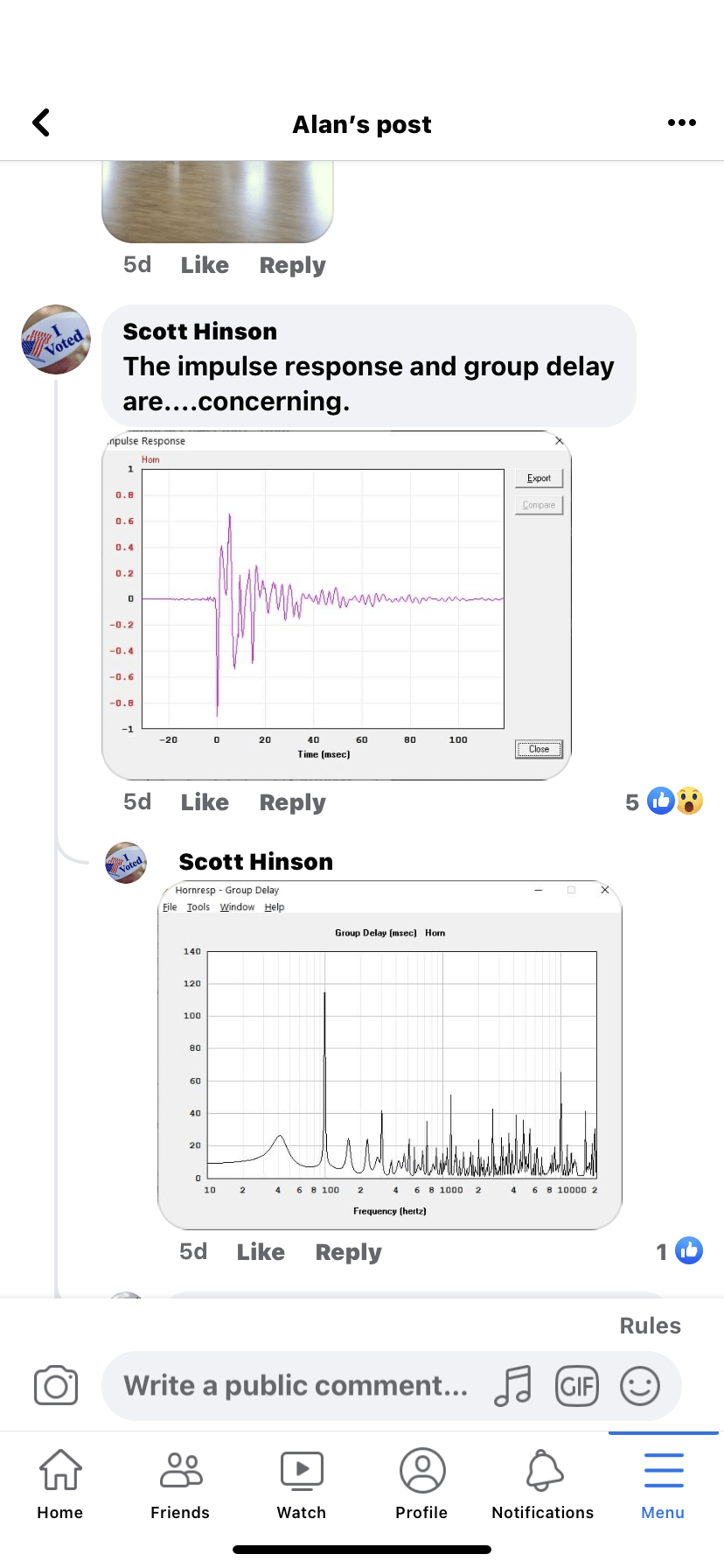

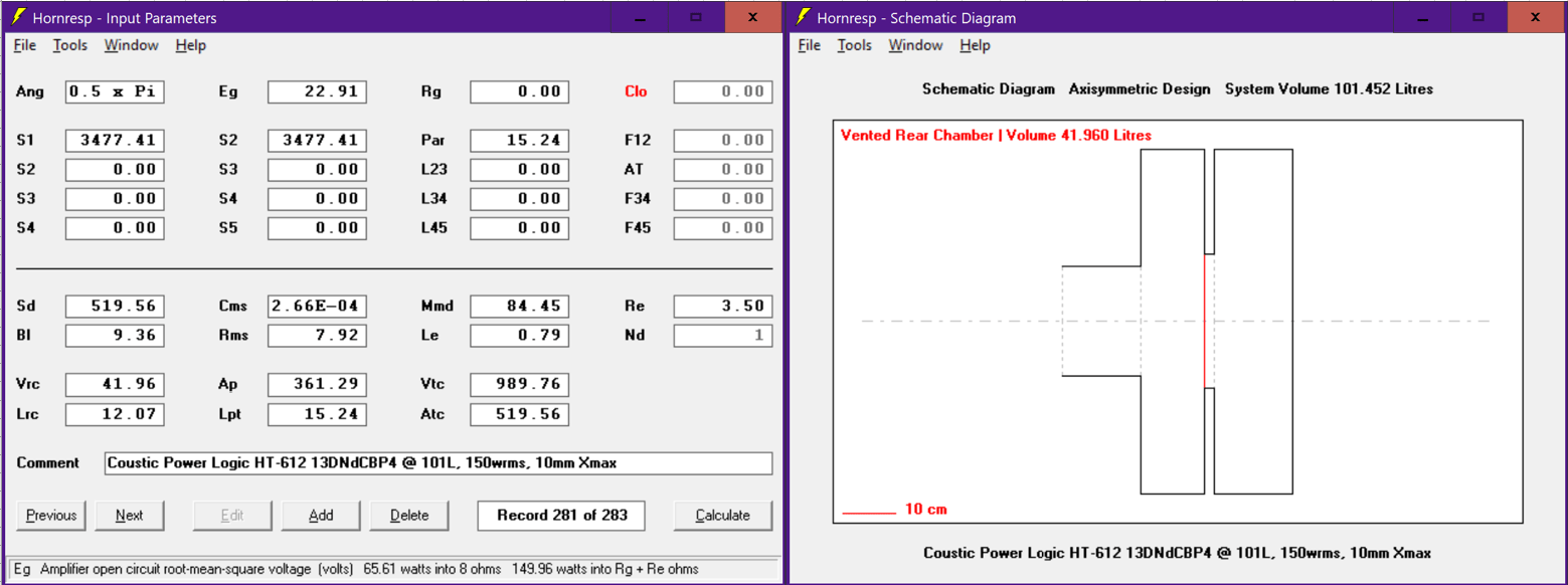

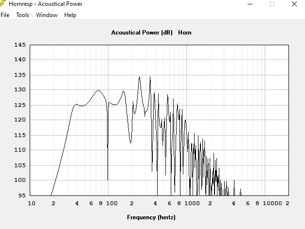

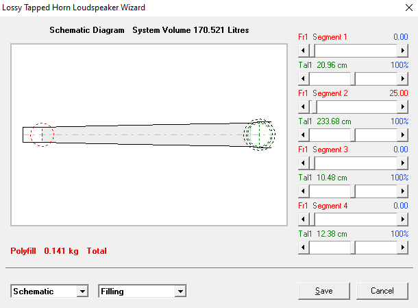

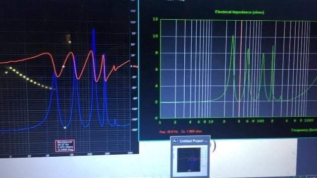

Gone on the right. An issue on the left. It’s not the driver, it’s the distance from each closed end to exit in the design and the ’q’ of the ‘bigger/shorter’ side that is further ‘wrong’ .

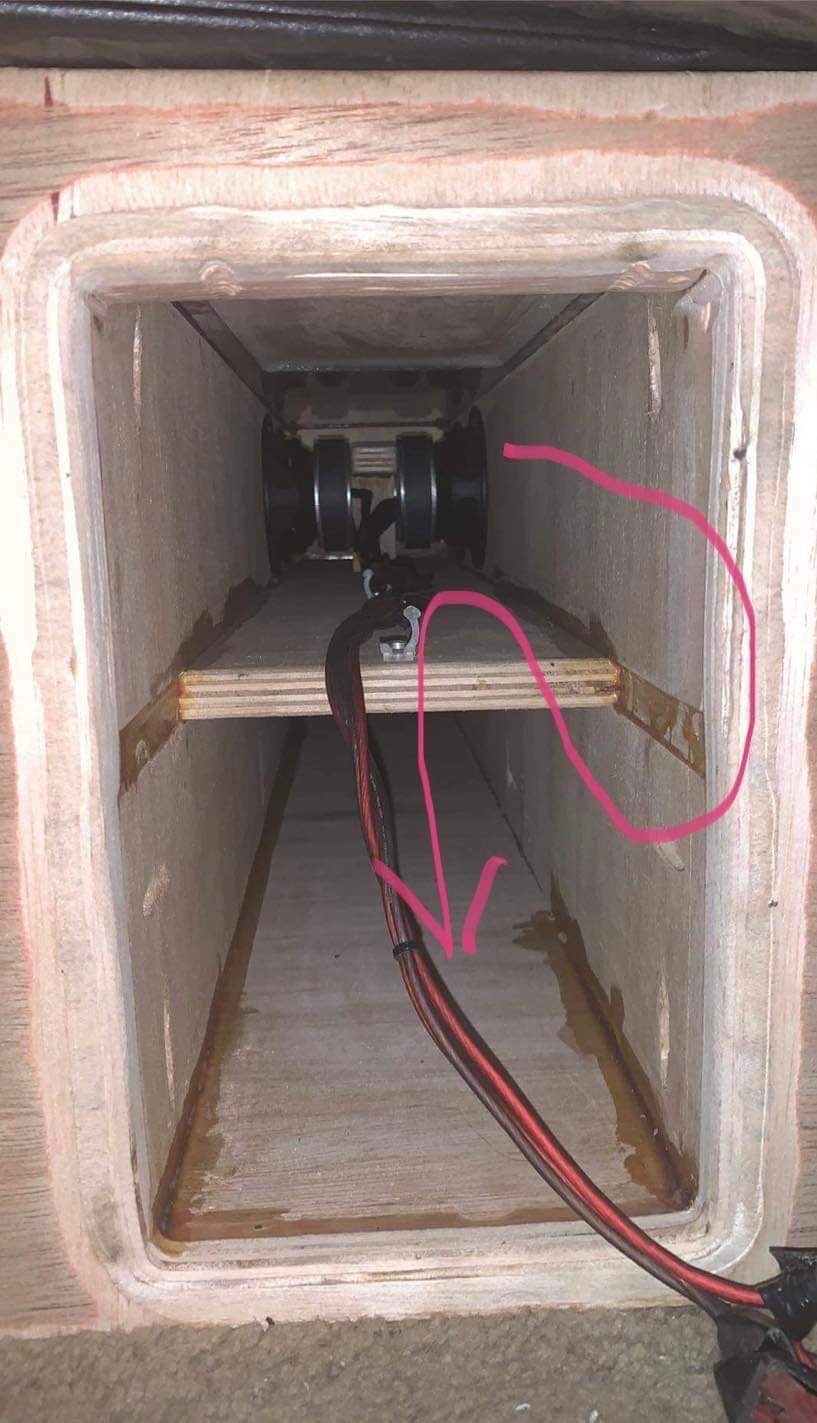

That enclosure is too big for me. This enclosure is in my car. I originally designed it for a 2000 Toyota Solara. It's now in a 2011 Ford Crown Vic. The wife is amazed how "tight" the bass is in the CV compared to the Solara. The Solara sounded better overall since it had aftermarket mids and highs. The CV still has the factory speakers with aftermarket amplification.
It does! Remember, a FLH is just a BP4 with a flared port. I'm waiting on the 30 year old driver to blow so I can build a vehicle specific enclosure for either 2 x 12's or 1 x 15 in a BP enclosure. I might try a BP6. I've never had a BP6 in my vehicles. Now what's funny is, I've only blown subs in sealed enclosures. Voice coils need cool outside air to stay alive. I always design my BP4's with the basket in the vented chamber.

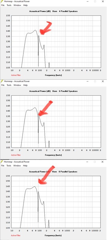

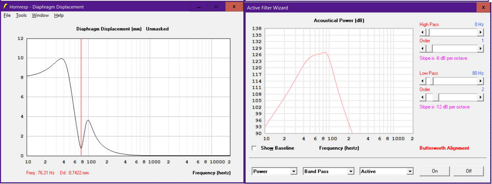

i punched in the 12TBX100 that goes to XMAX at only 600W in this design
besides that the graph look very similar, as you said is not the driver
can it be fixed ?
that thing is cause the maze of "resonators" that are not of the right size ?
ir it just need damping ?

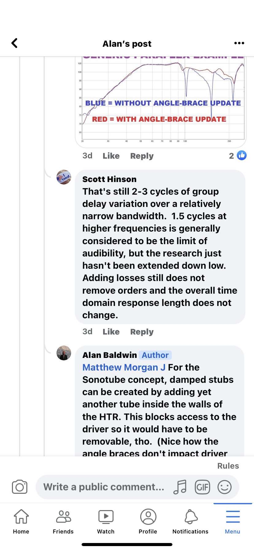

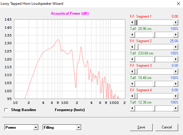

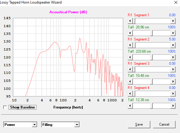

how much is 5 in segment 2 ?? of stuffing ... 5% ??
it tame that horrible spike a lot but is looks better ,
if i keep adding more stuff in segment 2 the low end suffer
It never goes away . Stuffing cannot fix real world geometry dissimilarities in CSA and </> 3:1 issues in qw resonators converging to exit 🥲 especially when a boundary condition further spreads those dissimilar ‘Q’ resonators.

GM has been right about this stuff for years …. Make one that’s ‘right’ and fits the 3:1

ok, so the fix is....

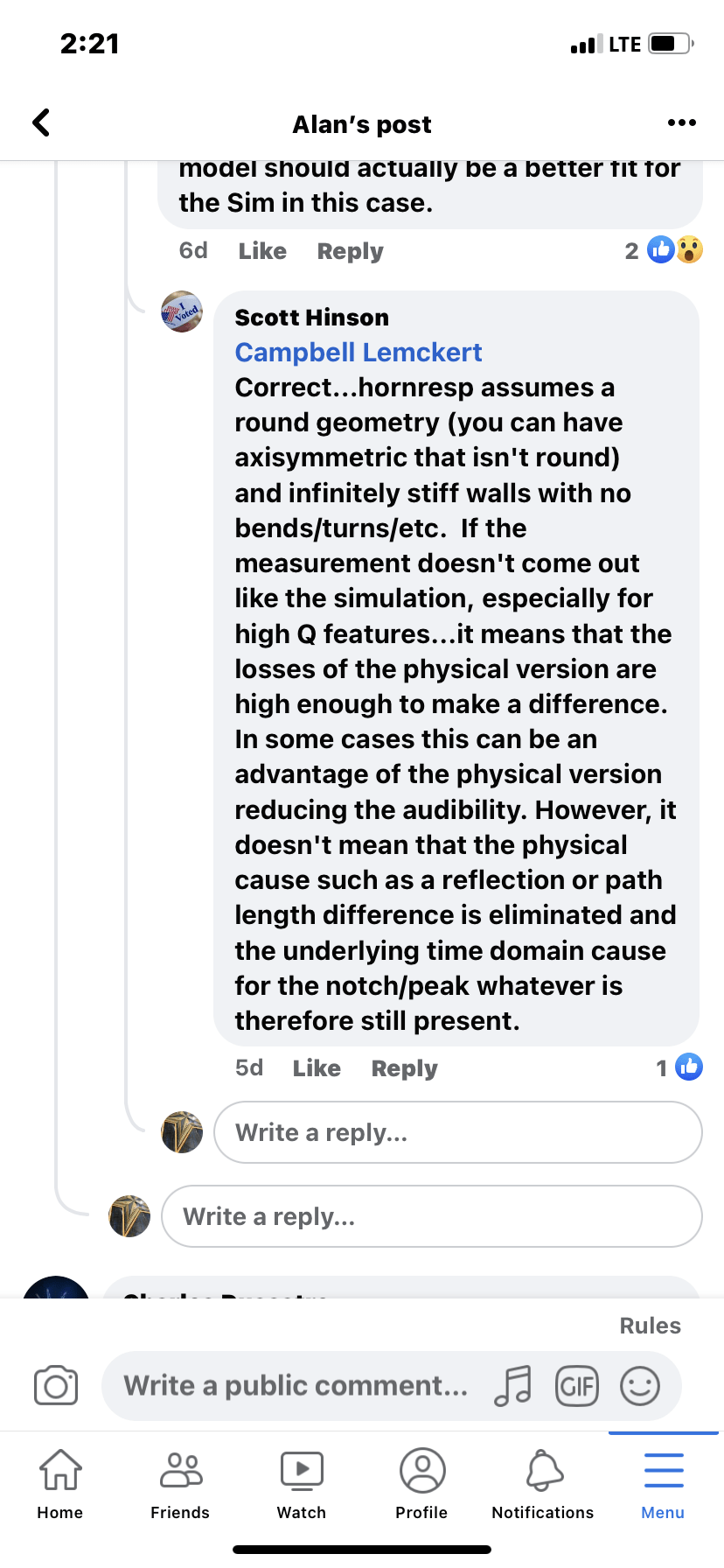

This guy is making valid points but he’s also ignoring the ’fixes’ they present to promote his white paper.. there’s no way to figure anything out here except to do it yourself because these people just argue with each other endlessly

It’s even crazier when using big motorforce . And trying to squeeze even harder on those things creates all kinds of time domain issues (???) and things that are in Scott Hinsons white paper. It’s important to read it …. But also to experience what he’s taking about with one’s own ears and decide if it really is an issue or just another smart guy with ocd confusing the fun 😝😝
