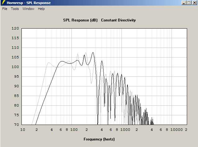

on the below design that was for the 12tbx100 originally, i plugged in the skar 12ddx
however it gave me a 10db difference from at the XO point, so i lowered the Lpt from 75 to 10 and that made the response more even
what i did in HR i do not if can be done on the real life
see the plan below
BEFORE AFTER
Btw, i plugged the skar in the SS15 and gave me one of the ugliest batman shape responses i have seen 🙁
moving the sliders don't get rid of the wings or decrease the valley in the middle just moved the overall freq response or the stuff up high above 100
