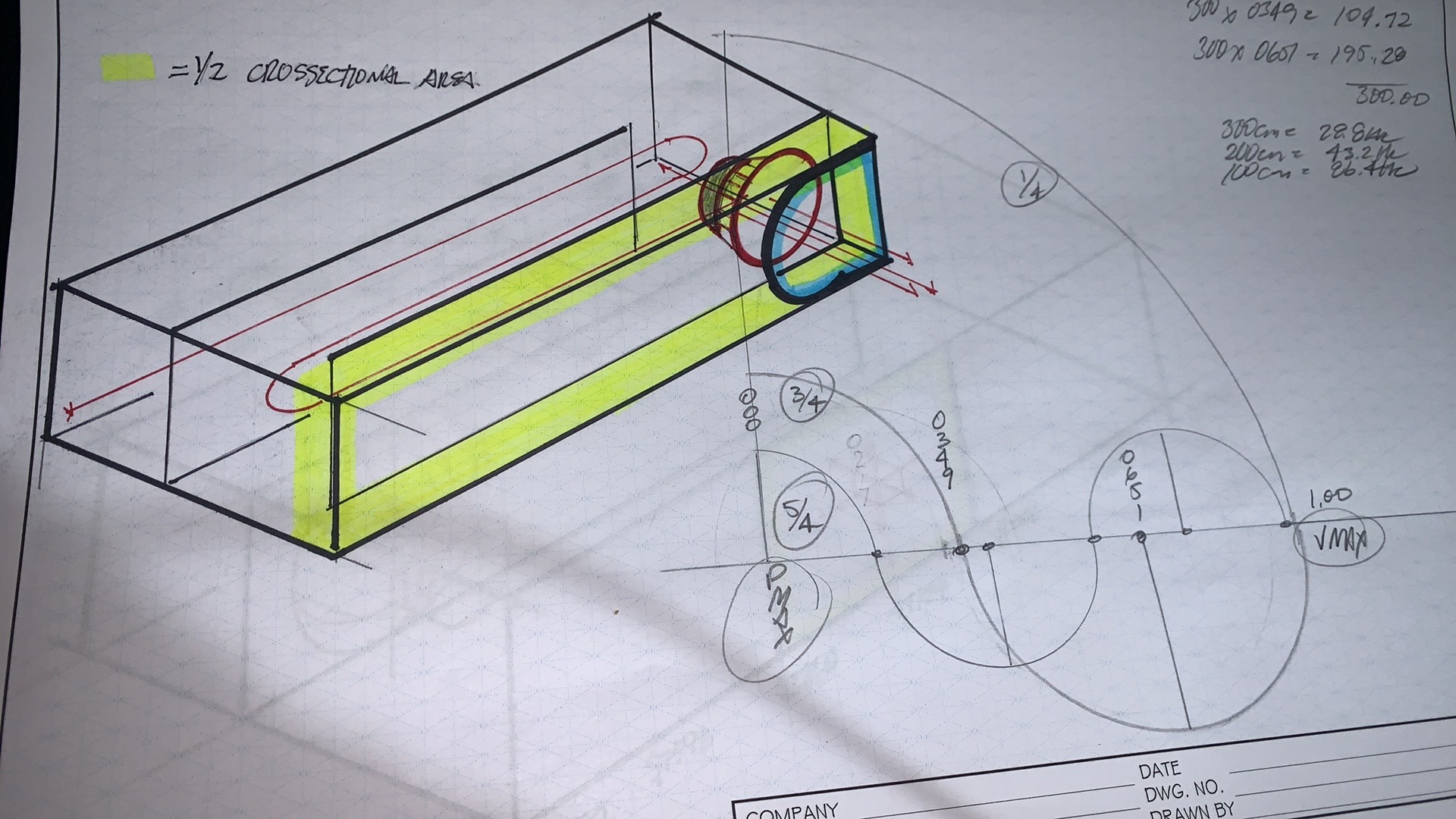

Why not move the driver down to fix the 3 Fb issue ? This is soooooo helpful and drops right into 3 folds, lightly stuffed to polish the sound, to the ‘perfect’ scenario to work with.
L12 is ALWAYS [pi/9 x total length] in this MLTL layout folded/excited at ~~~ the node/antinode Of the 3 Fb harmonic Point(s) along the way.

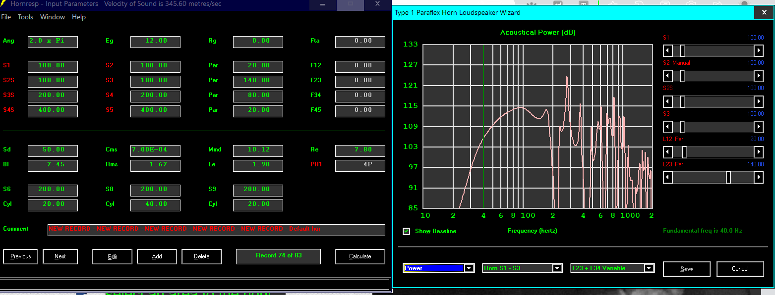

From this simulation we can see 3dB lost in the low range, so we Can't say this is an improvement, it might be a trade-off, you loose SPL at lower frequency to reduce the amplitude of the spikes in the upper range.
It's also important to check if the simulated numbers can be translated into a real box dimensions / geometry and we can do that with FreeCAD models.
Reducing the cross section area in the last segments helps to damper things, but it will increase air speed,

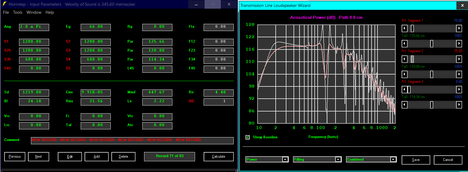

Standard ODMLtl using Martin Kings 2 decade old (?) tables. ‘Improvement’ is not ‘SPL’, it’s a flat/damped response to 5•Fb in reality. (Not including the 0.75 Fb drop from the mass loaded last fold?) undamp it and/or tune it higher if you want ‘more SPL’ ...From this simulation we can see 3dB lost in the low range, so we Can't say this is an improvement, it might be a trade-off, you loose SPL at lower frequency to reduce the amplitude of the spikes in the upper range.
swap the driver, Add some filter/dsp? B&c 18 ds 115-4 bolts right up in 5 minutes. Dayton Umax18 rings(heavy cone, lower Qes)
@ 18 ds 125-4, Shorten it to 104.72,100,95.28 cm and ~900,900,450 cm2 @ ~21.6 hz(I use this length for dayton rss265ho4 in an appropriately skinnier 300,300,150 cm2)
69.81, 66.66, 65.53cm … ~32 hz And so on

example 200cm (43.2 hz). Is split @ 200x (0.349 or pi/9) as 69.31cm, 66.66cm and 63.53cm … To exit (200 total). once damped, and or corner, loaded this line’s up perfectly as described, formerly in Martin Kings tables for transmission, line, offset and reduction ratios. Apparently It’s a combo of end correction and line split at acoustical center from the closed end of any pipe as this works perfectly for positioning, the hot/ cold/damped source in a thermal acoustic engine using glass test tubes or similar too(an exciting experiment to do too!!) .
66.66 cm is 129.6 (hz ( 3•Fb harmonic void is now filled)
43.2(x0.75) is ~32 hz , as a result of the 50 % cm2 reduction. Of the last of 3 folds. The CSA is far from the air speed of a ‘typical’ bass reflex port, or this TL is a hybrid of both…. I dunno, but I like these as well as the higher order version if the TS parameters will allow
Higher order qw pipe version is just moving the exit to the location of that 3•Fb harmonic in a parallel pipe that incorporates both sides of the driver, fired from each end, or or moved away from it, to smooth out any response ripple (if/as needed) at the same location (3Fb resonance over excited, or driver happier at that affectingly lower pressure zone from the closed end ??? )
