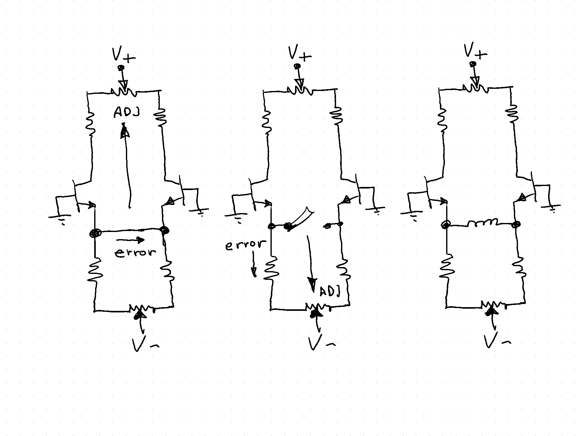

Come to think of it there are only two steps involved in setting up the network for zero volts across the coil using the two adjustment resistors. In step one the emitters are short circuited with the output adjusted for zero volts at the output. This causes whatever differential currents to flow in the short between the emitters, yet the emitters are both at equal potentials. Then when opening up the link the lower adjustment resistor is set for output zero, requiring the error current to be diverted in one of the two paths, coincidentally the emitters would then be at zero potential. This is similar to what Hans did in his analysis varying upper and lower resistors.

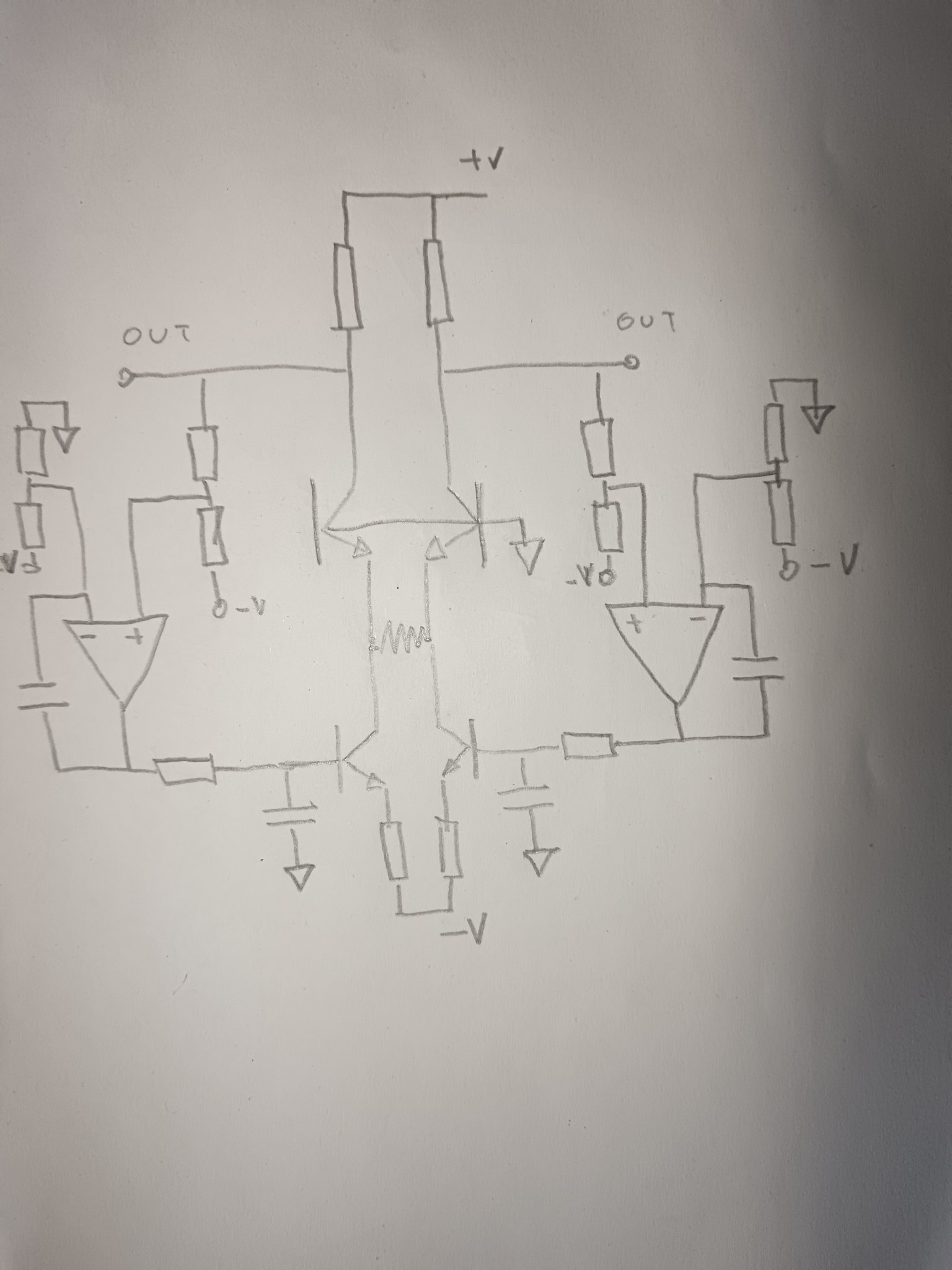

I was doing something similar, but transistors were mosfets and I put R-C filter between opamp out and gates, no need for super low Rin with small mosfet. Might be here it would work too if C is large enough to keep AC impedance very low....

Might be also idea, in the past I did something that looks unique with power amp, here; https://www.diyaudio.com/community/...ttle-fb-160watt-amplifier.412261/post-7672602
Output is brought to 0v DC (and can be set to any DC value) by servo driving current sources. Bias current is than 100% determined by collector resistors only.
The DC between emitters should always be 0 as on both sides as it is 0V-Vbe, as long as transistors are matched for it. In our case something like this:
Output DC level is adjustable by choosing resistors in V deviders feeding servo opamp.
This is just another idea, I think it would make it very stable from static DC perspective
PS, small capacitor can be added in deviders from outputs, to filter signal and leave only DC being fed to opamp + input

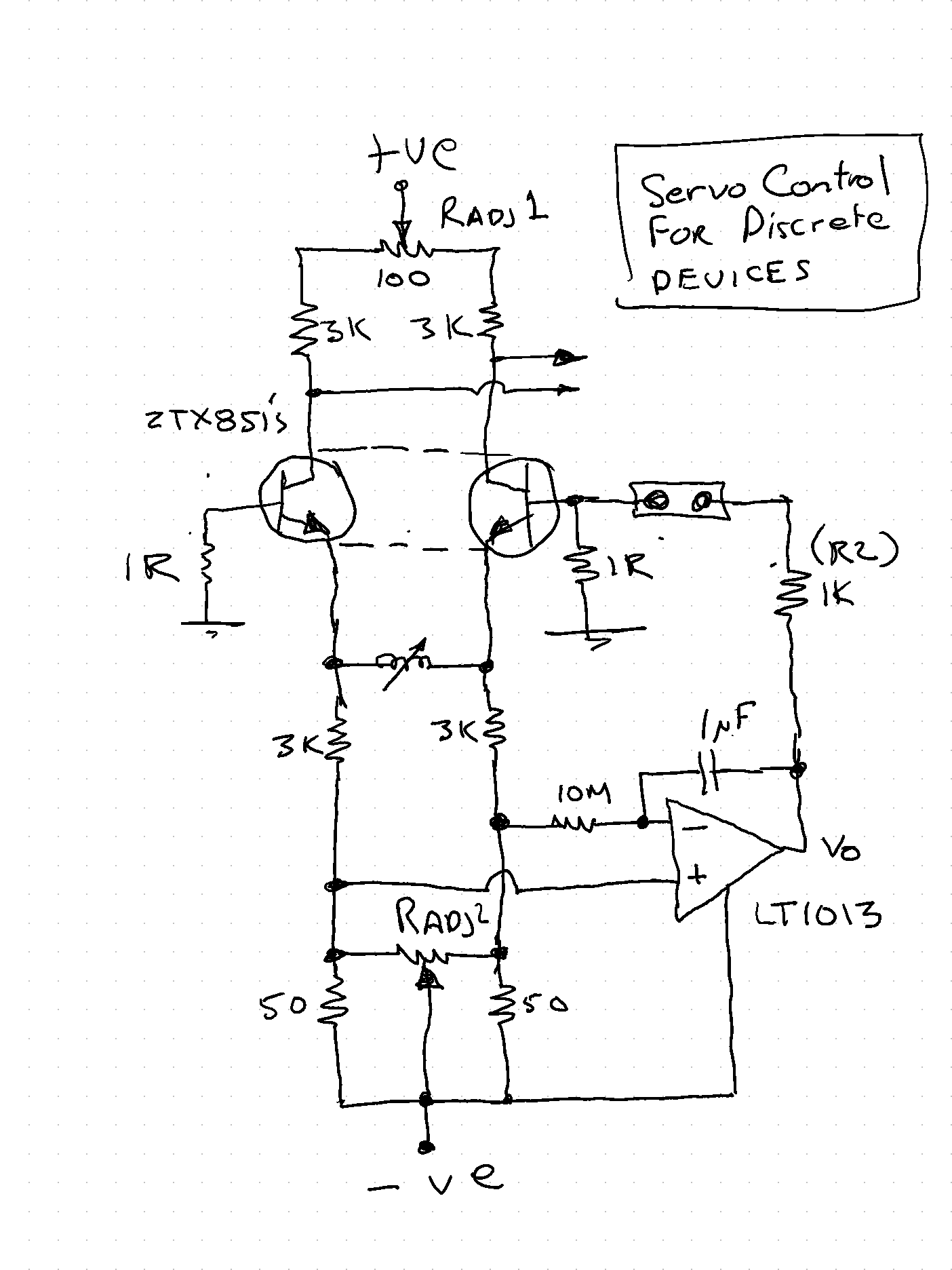

There may be no technically quantifiable reasons but I wanted to avoid electrolytic capacitors, even in the servos. Secondly it doesn't appear necessary if output servo's are an acceptable solution, though I can't remember, was it "Marcelg" that discussed problems as relatable to what I have done using a servo in the RIAA. Perhaps I should read that more carefully.
Your network seems well suited for handling individual lower noise separate transistors, particularly like ZTX851's, and as you pointed out seems can easily handle thermals as well. In rethinking this, to push the envelope in terms of noise performance in the ability to use separates, the following is a preliminary idea that could contain some critical flaws. It also uses a servo because it is doubtful if the output servos have the range to control the variance of separates. I used an LT1013 because it can operate with input signals at the negative rail, having moderate noise output that can be reduced by the division ratio to the base of the input pair. The link at the base is for calibration. H'm... seems the inputs to the LT1013 may need switching (?)....
I’m against any caps in the signal path, but in a servo an elecrolytic has the same function as in the power supply, where you can’t do without.
However your solution with 1R resistors is a nice one and saves on electrolytics.
Now the circuit you propose has to many regulators to my feeling.
You want to keep the DC currents equal in both LTP legs and you want to have a near zero DC offset at the output.
So two parameters to steer, for which you only need two regulators where you now have three.
When discarding the two 50R resistors and the pot between them, you could connect the opamp’s input to both emitters instead.
That part will then take automatically care of the equal DC currents in both legs.
The pot at the top will then be used to get the DC offset to around zero volt.
With one servo however there is always a DC voltage on the Cart lines, but that’s a choice to be made.
When using two isolated transistors, try to match their hfe, because their base currents will flow through the emitters.
So with equal voltages on the emitters it does not automatically mean that the collector currents are the same.
With the ZTX851 having a low hfe, much lower as the Mat02, it is of special concern.

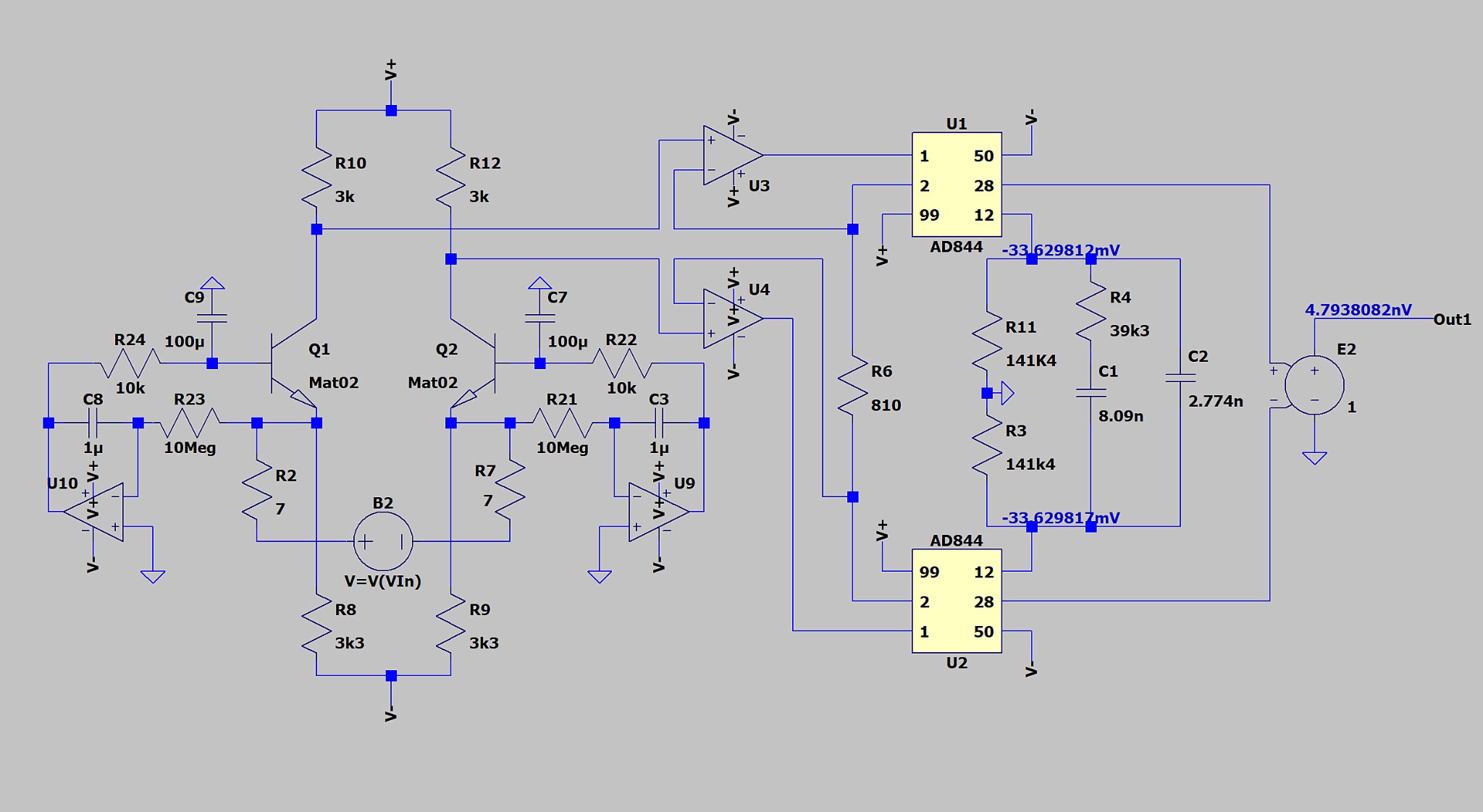

@Hierfi,
About the impact on the Riaa correction when using a servo, exactly what Marcel described, can be perfectly seen and corrected with your model in LTSpice.
Feed it with an anti Riaa signal and the outcome should be within the borders you have set, in most cases something like +/-0.1dB
Hans
Haven't worked that out in my head yet as common base is supposed to be unity gain. But things get a little convoluted with voltage and current of the cart interacting with the emitters. Things aren't all that clear without any feedback. LTSpice should tell me. I will check the rest out.
The reason I wanted to place the inputs of the LT1013 near the negative rail was to keep them away from the emitters for pickup reasons. The issues reduce by resistance division being closer to the negative supply. Just a guess...

By the way, what is your opinion about my construction to servo drive current sources for getting output at DC target?
It's a capable circuit with increased PSRR on the negative supply with the two additional transistors with their high collector impedances.
On the other hand, the two lower transistors will have unequal thermal behavior, so a single current source may improve stability, but this will have impact on the design.
And despite tolerances on resistor values, the collector DC values will still be kept equal, buy CMRR will be affected the higher the deviation from nominal value.
So my preference would be to split the PSRR and CMRR into two separate regulator circuits, one being a servo to keep the currents constant and a pot between collector resistors and positive supply to tune the CMRR.

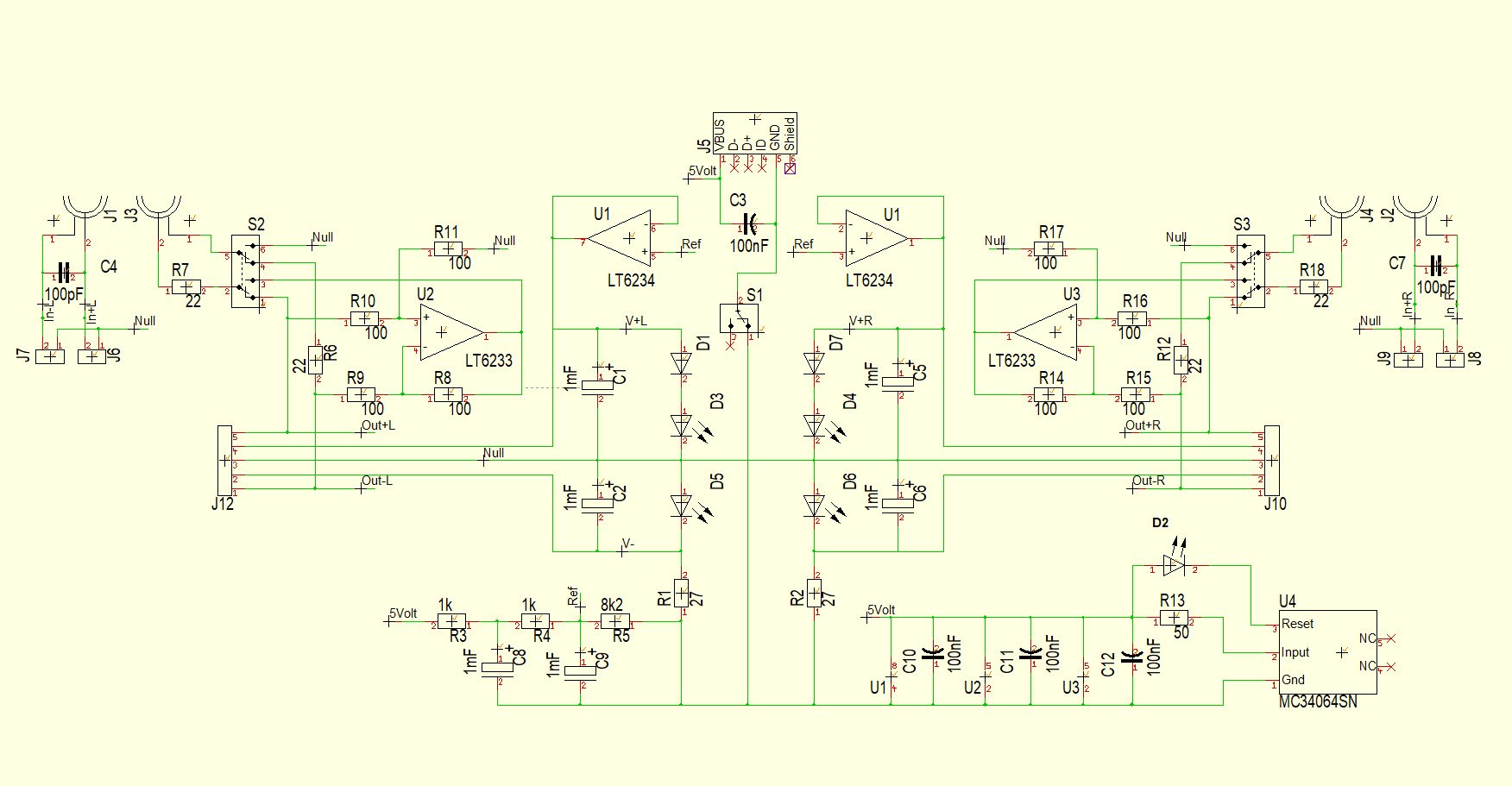

This was a 4nV/rtHz MM preamp, with current driven Riaa equalization, just as in Hierfi´s design.
Only the 90k9 resistors had to be a bit higher because of the drain impedances in parallel.
The problem is that you will have to match Fets, so you will need a large amount to get the right ones.
At the end a lower S/N will be much harder to achieve.
Basically it's a nice simple design from the previous century, that as far as I know has not been built by anybody but by Scott himnself.
Much more challenging was the basic John Curl design mentioned in the thread, of which I made a more modern differential version having below 0.3nV/rtHz input noise.
Several versions were build, where I sold PCB's and gave support.
See Circuit diagram for the Transimpedance version on a PCB of itself.
A Diff to SE converter plus power supply generator were situated on a motherboard.
Hans
