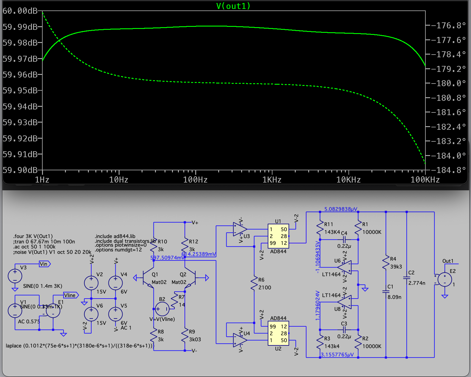

Some interesting results...
A DC servo control was included in the simulation network with performance to an extent unwarranted in the reality, this using an LT1464 op-amp. Though this device is incredibly inexpensive in simulator form (being less than $0.00US rounded up), it is about $8US in its more robust version. As an aside, bear in mind that the placement of the DC servo at the high level output side works well with matched input pairs, though further thought is required to implement non-matched devices like the lower noise Zetex devices, this for a variety of reasons.
It is expected that a TL082 (at $1US) would be adequate, as this has low enough input bias currents to generate an adequately low DC adjusted output, along with having the unnecessary speed at this point. The servo loop control is slow with its inputs unmoving around ground, hence does not need correction speed more than that of an ox protecting her furlongs (it turns out that's why the ox was chasing down my grandmother who was just trying to do some ploughing).
In the screenshots below the input current was offset slightly using a 3k03 resistor for R9 instead of 3k in the schematic. This resulted in about + 1 volt and - 1 volt on the outputs of the LT1464's with output lines servo corrected to around 5uV on the outputs (these appear shown on the schematic), values well below what is remotely necessary. Of note to consider is that the output correction (in this case +/- 1 volt) is almost directly correlated to the gain set by R6. Meaning that if current is doubled by changing R6 to half its value, this doubles the correction voltage required, all else remaining the same.
With the servo active and in place, the variance in the RIAA looks less than +/-0.025dB (over 20Hz-20kHz). I blame this response entirely on you Hans... as you were the one that gave me those values earlier... although if it appears an excellent result I plan on taking the credit.
Screen Shot 2024-11-03 at 6.00.44 PM.png Screen Shot 2024-11-03 at 6.11.03 PM.png

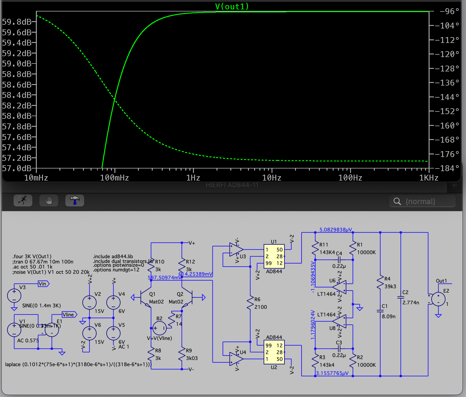

The screenshot to the right shows the frequency response shifted and extended from 10mHz to 1kHz to show the servo loop control affect on the RIAA. In this the input level was adjusted to set the output to an arbitrary value of 60dB at 1kHz. The vertical scale to the left was set to begin from 57dB at the bottom, hence becoming the 3dB down point for the DC filter response. This shows an intersection of the frequency response extending to begin at around 70mHz. It should be noted that this high pass frequency response can easily be changed by changing the integration capacitors, that when reduced causes the RIAA response to begin peaking, seemingly could be confirming results of studies by Marcel.

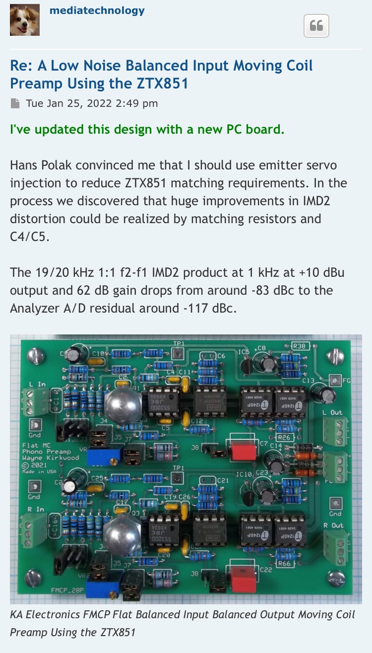

This is another approach to an MC gain stage https://proaudiodesignforum.com/forum/php/viewtopic.php?f=7&t=1179
The commercial incarnation of this is here https://ka-electronics.com/shop/index.php?route=product/product&path=66&product_id=121
But you apparently can buy a bare board and build it yourself.
Reason this rung a bell in terms of the above post is that he sells ZTX851 pairs too glued into a dome nut https://ka-electronics.com/shop/index.php?route=product/product&path=65&product_id=118
He also does a balanced RIAA stage too, described in detail here https://www.proaudiodesignforum.com/forum/php/viewtopic.php?f=7&t=753
And also available complete or as a bare board https://ka-electronics.com/shop/index.php?route=product/category&path=66
I have not tried any of these designs, neither have I any interest in KA. But I am intrigued by his approach.

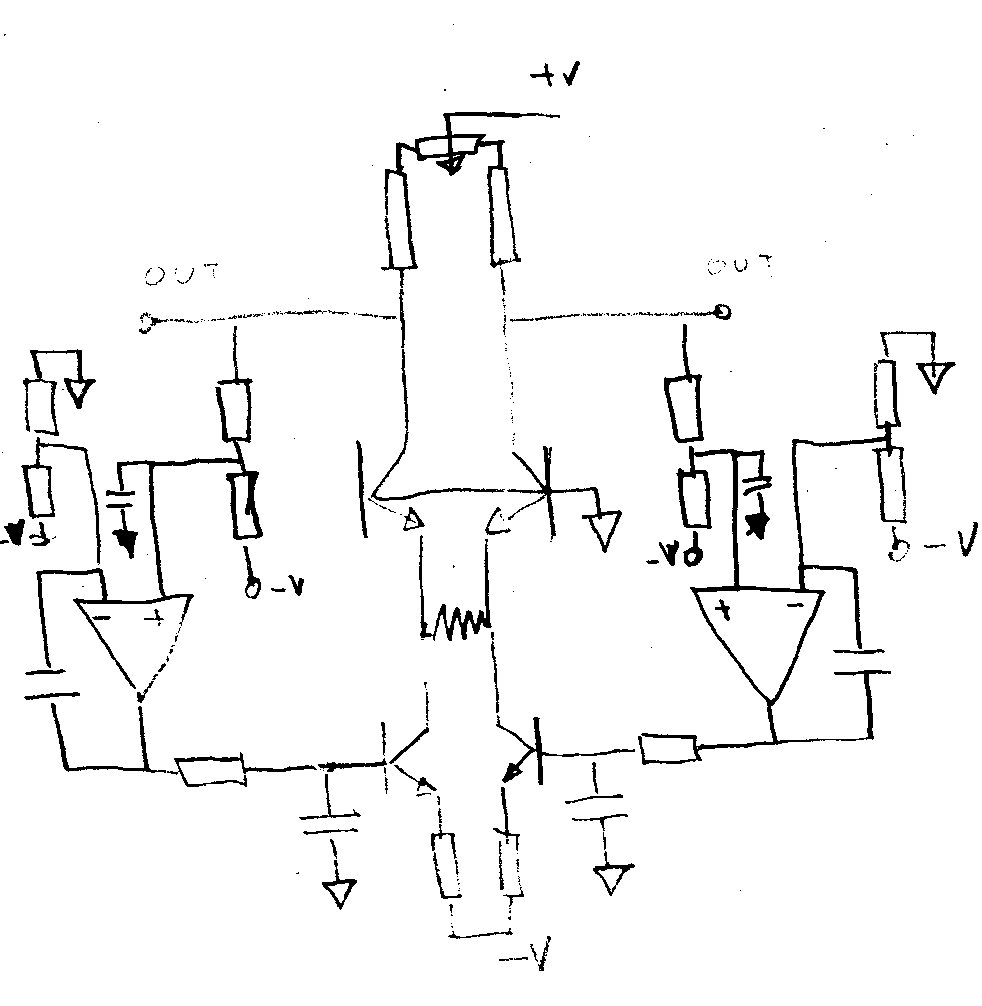

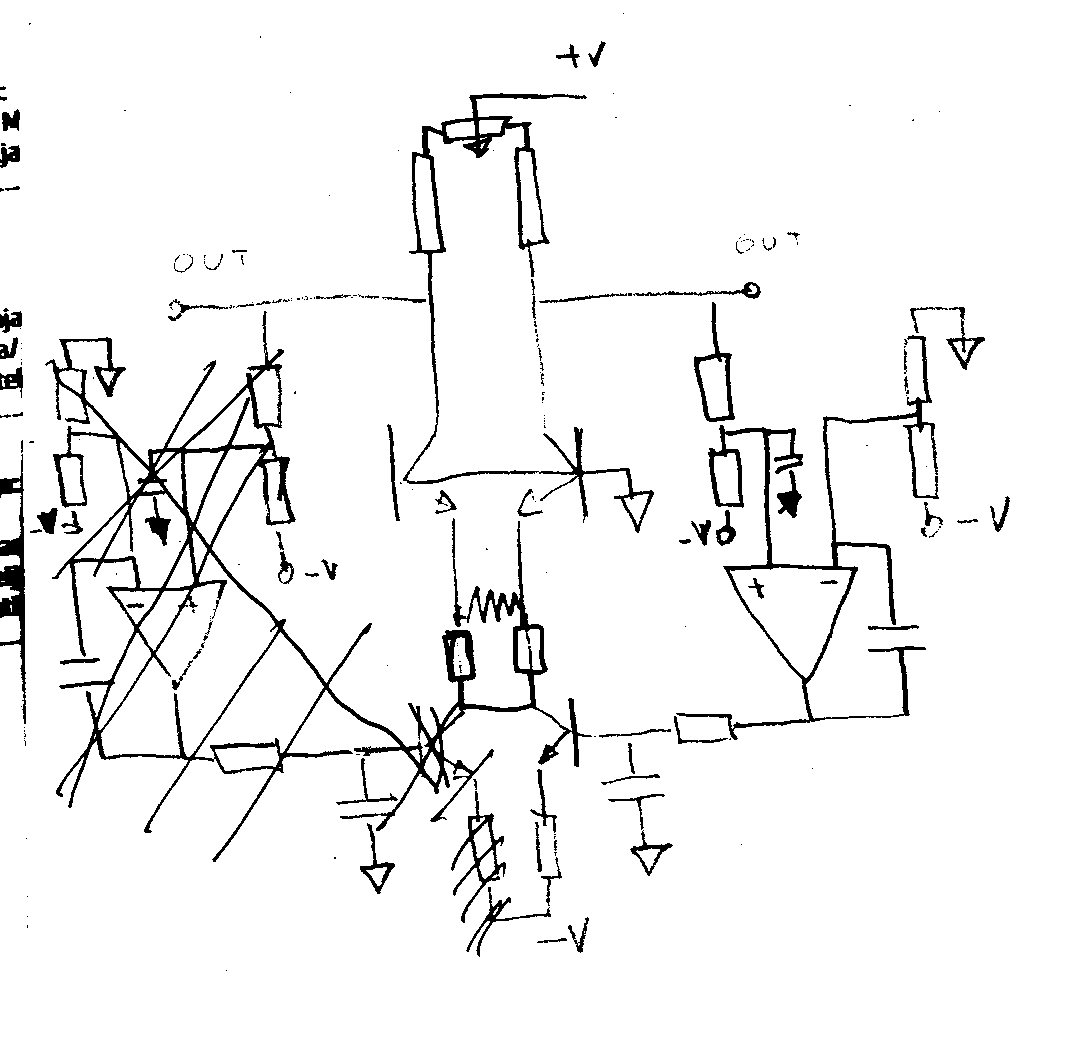

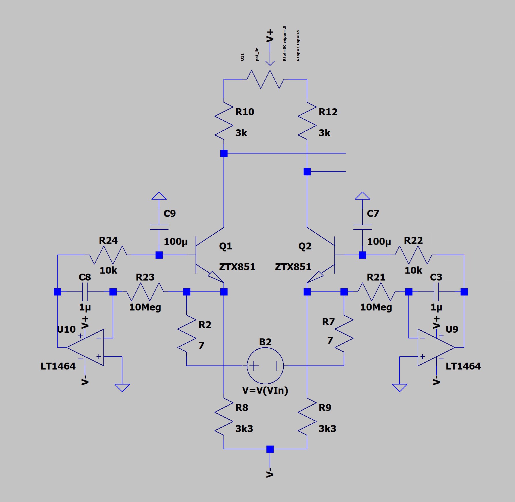

So my preference would be to split the PSRR and CMRR into two separate regulator circuits, one being a servo to keep the currents constant and a pot between collector resistors and positive supply to tune the CMRR.
Hi Hans,
Don't think matching 2 resistors is so difficult as matching 2 transistors. I hear your point nevertheless, installing small value pot is not a hassle.. Here are two versions of making LTP doing what it's supposed to do ideally:
First is just added pot at V+ collector resistors to match them
Second, since we have matching pot for collector resistors, we can delete one side of servo , and also one current source:
Is this what you ment? PS sorry for poor scans, I will make dwg next time
No, this is what I meant.
1) Equalising the two emitter voltages at zero volt, to stabilize the LTP currents and make them independent for thermal runaway.
2) Pot at the top to tune the CMRR.
When pot set for best CMRR, both positive and negative PSRR will be below 90dB and CMRR below 65dB
Then two Hierfi servos can be paced in the AD844's output lines.
Hans

Ok, got it, even I did not grasp why to get rid of servo-ed current sources yet.
@Hierfi, seems we will servo out the hell of this design 🙂, 2 servo opamps in ltp + another 2 in your current RIAA
The servo’s on the current sources are not discarded, on the contrary.
The two servos in my proposal keep the emitters at zero volt causing the current in the two emitter resistances exactly identical just as two perfectly matched current sources, independent of the used transistors.
That’s why PSRR also improved significantly.
Hans
