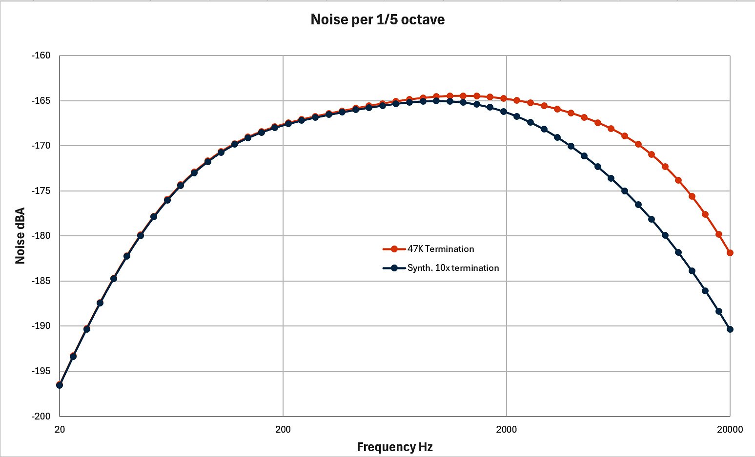

Our auditory system perceives sound in terms of fractional octaves, not in units like V/√Hz.
Therefore, to align with human perception, the frequency axis should be presented on a logarithmic scale when displaying data in terms of octave bands.
This ensures equidistant spacing for each octave or fractional-octave step.
Additionally, sound level perception is inherently logarithmic.
To illustrate:
An octave from 10 kHz to 20 kHz spans the same perceptual "distance" as an octave from 10 Hz to 20 Hz. However, the absolute bandwidth is drastically different, leading to a 30 dB difference in energy (assuming white noise), even though both are perceived as one octave.
This highlights that plots in V/√Hz are misleading when evaluating perceived noise.

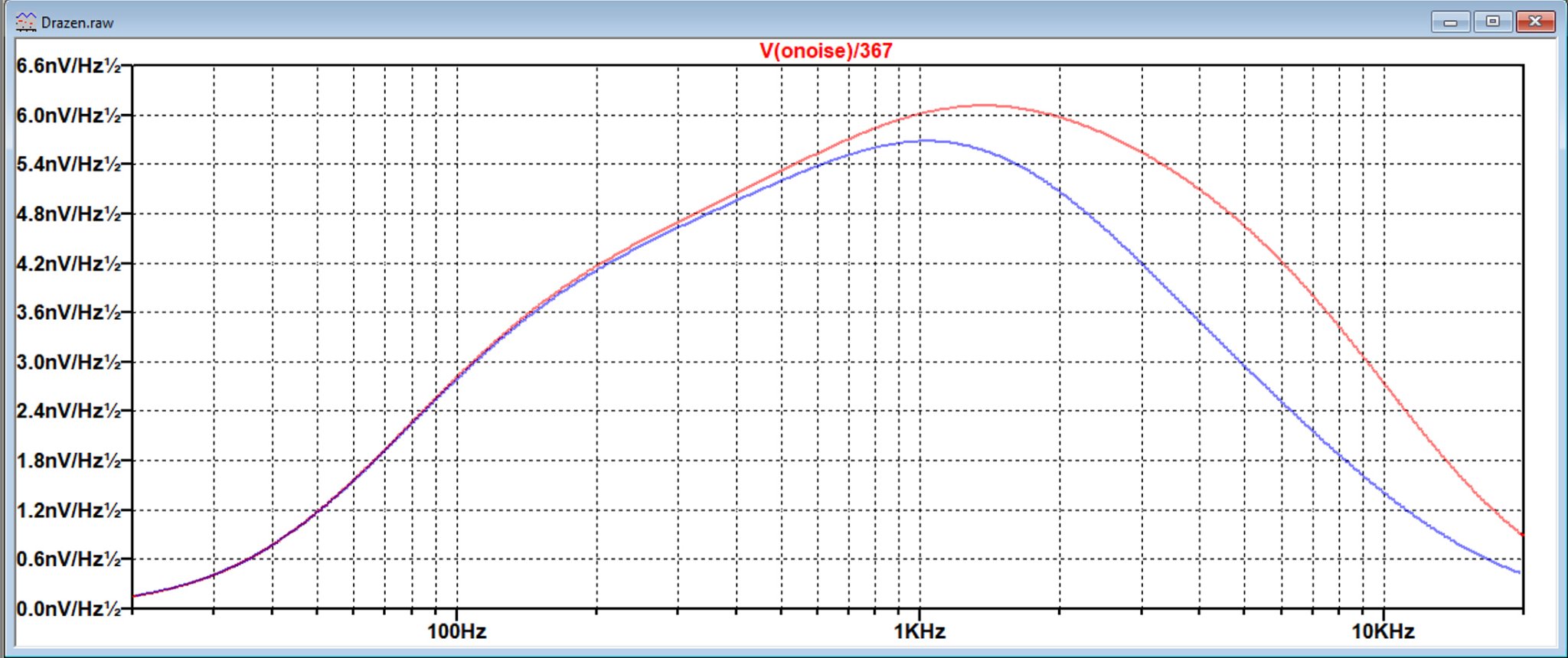

To correct for this, I have converted the original image (which displays A-weighted noise in V/√Hz) into a plot in dBA per 1/5-octave band.
The specific choice of 1/5-octave resolution is not critical; it mainly affects the vertical position of the curve (i.e., an offset) without altering its overall shape.
I selected 1/5-octave spacing as it offers a good trade-off between resolution and visual clarity of equidistant sampling on a log scale.
  • The first image shows the simulation results in the original V/√Hz format.
  • The second image shows how the same noise would be perceived, represented in dBA per 1/5-octave.
Both images include data for two termination conditions: a standard 47kΩ resistive load and a synthetic 10× load for comparison.
Hans
Reactions: Drbulj
Not sure I follow your argument?
I'm not a fan of A-weighting. It allowed a simple instrument to produce a single figure result, but it's debatable as to how useful it is. There's now no reason not to plot noise as a function of frequency (as has been done in this thread). It has been argued that synthesised loading is scarcely necessary because the difference is unlikely to be audible. I would argue that not using synthesised loading unnecessarily degrades the high frequency signal to noise ratio of a moving magnet cartridge, making it significantly worse than a moving coil cartridge. If we can improve the engineering, we should.
