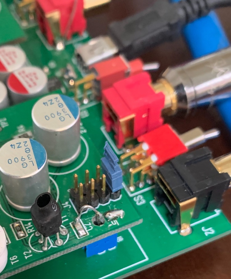

In my head amp I can choose from four gain positions, with jumpers on pin headers. That will do for every possible Cart.

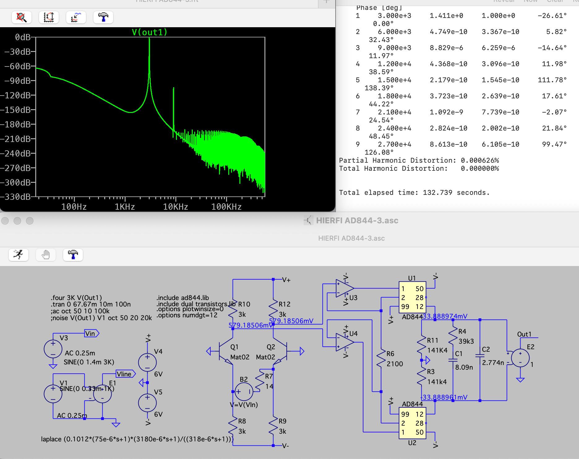

My skills in LTSpice are advancing thanks to Hans... though I'm still a furlong slower than the speed of my pet snail that I gave the name Grandma. My grandmother was a formidable woman... though somewhat senile in advancing age... "furlong slower" means the time it took for her in her declining years to plow that distance across an imaginary field being chased by an imaginary ox... In retrospect I still feel somewhat guilty in not tying up the ox...may she rest it peace...
I finally managed to obtain a simulation with crossed clumsy fingers as per below. In this, I altered some values to set the output to 1 Volt RMS, though I see now that the output is across the differentials, hence only 1/2 Volt per side. I also changed the output connection in advance of the buffered output to exclude the output buffers. I expect the measurement device has infinite impedance though don't know for sure. As is revealed the distortion reduction by the addition of U3 and U4 is formidable in addressing Ro nonlinearities of the inverting input terminals when driven with extreme variance created by the exclusion of feedback.

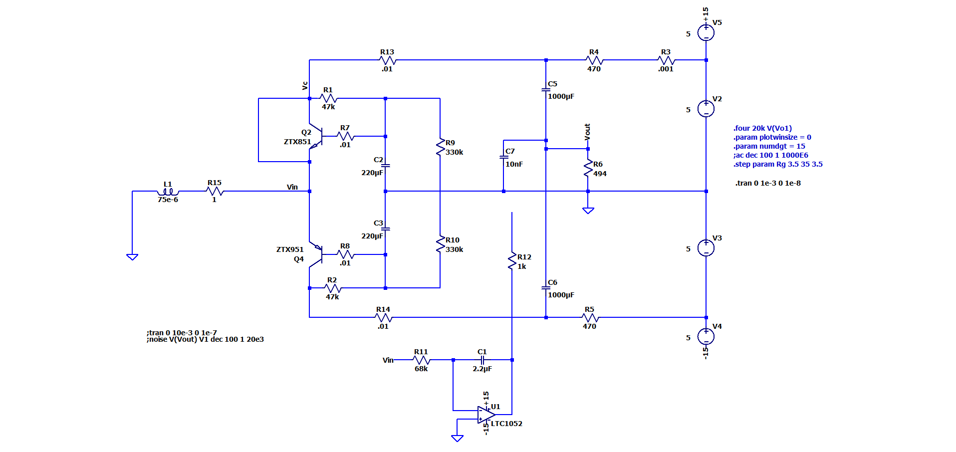

Hi Bonsai, do you have proposal for this protection circuit?
Here is the simplified front end of the X-Altra MC/MM - the current through the cart with Q2 shorted is about 4mA and about 2.5mA with the servo (U1) engaged. I disconnected it here to show worst case. V2 and V3 is an 1/2 LM4562 opamp each. You could belt and brace this by placing a 5.6V zener from each 5V rail after the 470 Ohm resistors to 0V. The other alternative in this example would be to raise the regulator output voltage to say 8 or 9 volts, and then raise the value of the 470 ohm resistors to give the desired voltage at C5 and C6. This would provide good clamping and short circuit current limiting with the zeners. Although I did not do it in my preamp, its good practice to place a pair of anti-parallel diodes across the MC input (1N4007 or similar). These will never conduct in normal circumstances, but they will clamp any high voltages accidently getting onto the input from an external source.

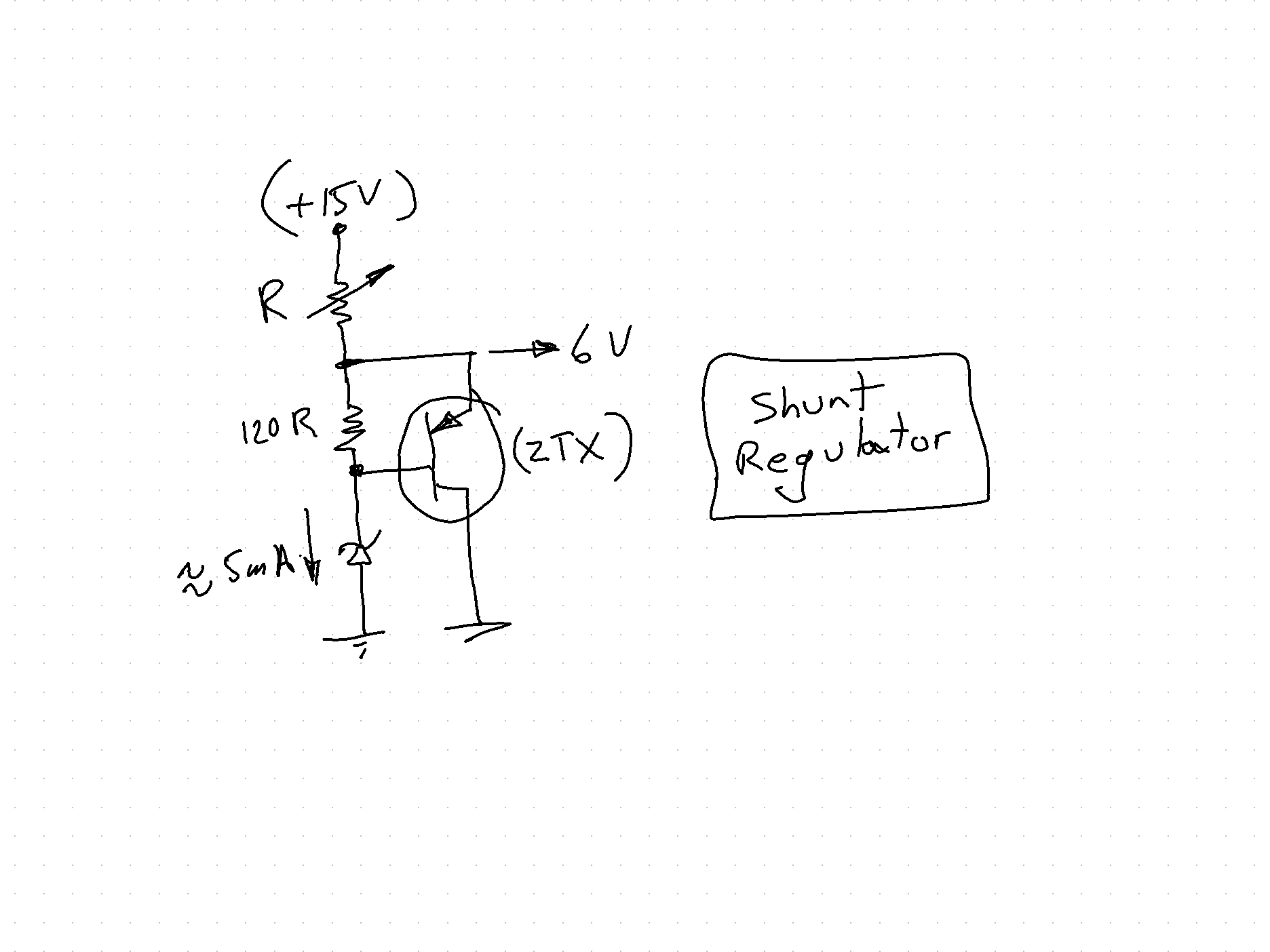

As an aside, how does your regulator compare to a basic shunt network like the one below Bonsai? This is the network I am currently using as copied somewhere from the diyAudio site, being also mirrored for the negative side? These were so simple I used independent regulators for each channel. Being of nature shunt this limits the available current in the event of faults... though not necessarily enough yet to prevent damage to the coils.
I used the LM4562 because the PSRR is very high - it is 100dB or better at LF and even at 100kHz, it is still very high - and you get low noise as well. The MC front end on my design has essentially 0 dB PSRR - so it has to be married up to a very clean power supply. I have not used shunt regs, but my only concern for a simple 1 transistor shunt reg would be the regulator noise and then the available loop gain to shunt any power supply noise/ripple. Again, I do not have practical experience with these regs, so this is only my opinion. As I noted earlier, the worst case fault current through the MC coil is 4mA. you would notice it straight away since the preamp would not work if this happened, so it's not a 'lurking' fault.
Reactions: Drbulj
Thank you Bonsai,
I see what you mean, worst case of complete transistor failure is still Vps / 1k047 of resistance.
In Hierfi's design , following same logic is even less, if both transistors fail one open, other shorted (quite low statistics for that) : max current wold be 12 V (+-6V PS) / 6k (3k in emitter and 3 k in collector) = 2mA.

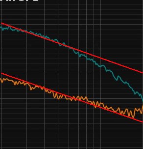

One interesting off subject observation, without wish to change subject from preamp.
Since I have indications that my Ruby 2 cart is worn, I installed Sumiko Blue Point that I have laying for years, that one has very little running hours. I know it is hi output MC, more like MM, but needed to check.
From first it is obvious that BM Ruby is several classes better cart (no wonder when I tried it first Sumiko went to bin). Without showing pictures now; channel separation is horrible, distortion visible even on scope...). Nevertheless it does work
Back to main question, here I compared Ortofon LP sweeps (these are peeks captured after 3-4 runs of needle over the track). Both are recorded without RIAA by RME mic amp (on different gain settings)
Hans earlier explained that sweep should have 10db drop / decade after 2kHz. I tried to make line between 20khz and 2khz and
Sumiko (bottom trace) has about 5db drop
Ruby has about 14db drop (and by far cleaner trace 🙂)
I applied little smoothing to traces so they are easier to look at.
Does this have explanation, both carts are bad?
Thank you!
What still puzzles me about the Sumiko is why the output below 800Hz is higher as from the Benz, but above 800Hz lower as the Benz.
Could this be a relative gain factor that is not equal, and I don't mean absolute gain because that would only shift the complete image upwards in dB
Your Sumiko has a much higher output, so for constructing the image you must have done something ?
