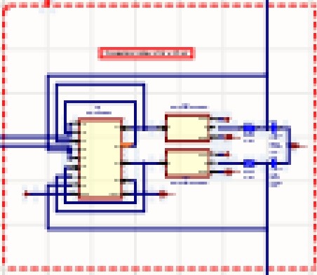

Hello Reactance
greetings whats the driver IC sI8244W
warm regards
Andrew

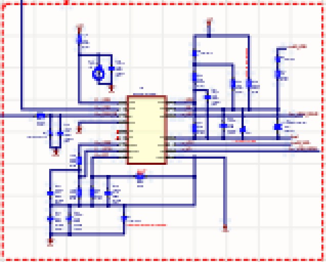

That is indeed IRS20957, nothing that you already havent seen before.
However the advancement is inside the controller board that does the following.
- dc monitor voltage +/- up to 100V (programmable 1V steps).
- dc offset +/- (programmable 1V steps).
- +/- current rail monitor 20A (programmable)
- temperature sensors each programmable.
- signal shutdown command output.
- switching modulator frequency monitor.
- 4-wire fan output + Fan RPM monitor.
- solid state relay. (will upgrade to x2 for full bridge application)
- spi control and communication. (I2C "master mode" is a dog to get right on a PIC16F18857)
- speaker voice coil temperature monitor.
- low frequncy sinewave DDS to test subwoofers.

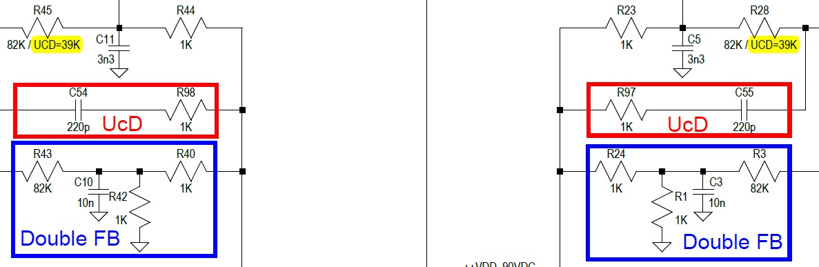

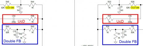

By the way this double feedback is totally rubbish you use, who uses pre and post feedback today? oh you. why? you dont understand how to setup poles and zeros, neither do you understand the 2nd, 3rd order harmonics they generate and cause instability notably cause your control loop uses random part values. its a lucky packet and box of chocolates you never know what you getting.
so you randomly select values, until they work and "become stable during startup" with werid hiss issues and artifacts like start-up problems and claim its some revolution when you fix it, I would caution anyone who uses your stuff as the orginal poster found out the hard way, toxic high part overcomplicated schematics and ideas you trying to keep up with us, you clearly looking for validation and trying to show people here you some kind of pro at this but all you doing is looking at establishing your dirty brand. hahah!

Double feedback is still used by B&O, don't you know?
It is a choice.
I give it free. I sell nothing. The double feedback is made as simple imrovement quality from standard I&R design and proven giving a lot of sound quality improvement.
