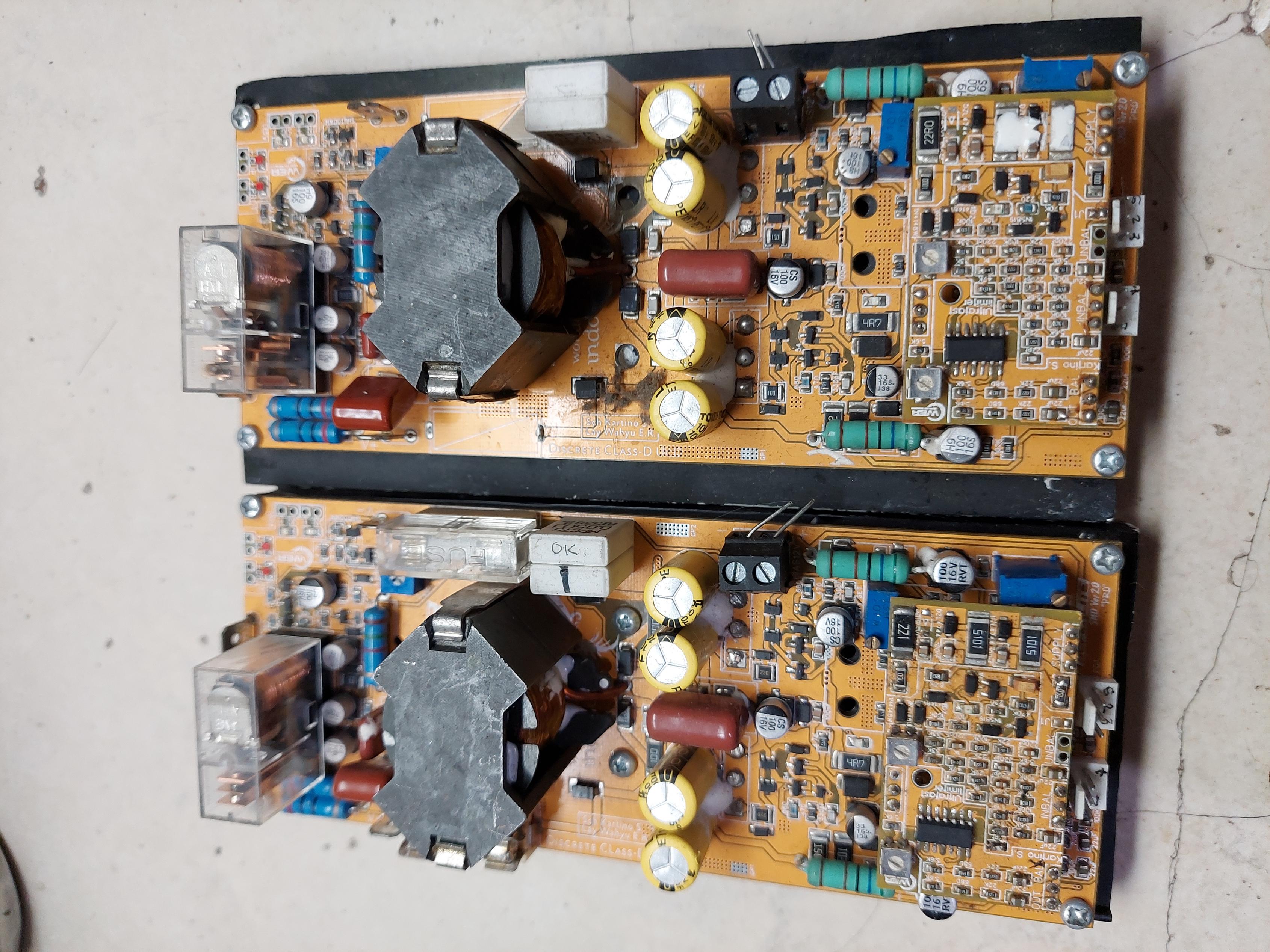

Hi Kartino
Do you have from Fullbridge D2KFB-DBF-UCD Combo Ver.1
maybe Half bridge Version D2KHB-DBF-UCD Combo for small ower available +/- 90 V DC ?
If possibile please add Half bridge schematic DBF-UCD Combo in the group
Finally: With the dual feedback design, is there a difference audible in live use or can it only be measured?
regards
from Germany
Hi NMOS,
Thanks.
I split the fullbridge design. Exactly from original fullbridge so you can understand how the schematic is working. Actually I made this for third country like us where ordinary parts is the only choice. I am glad it is also adequate for your needs.

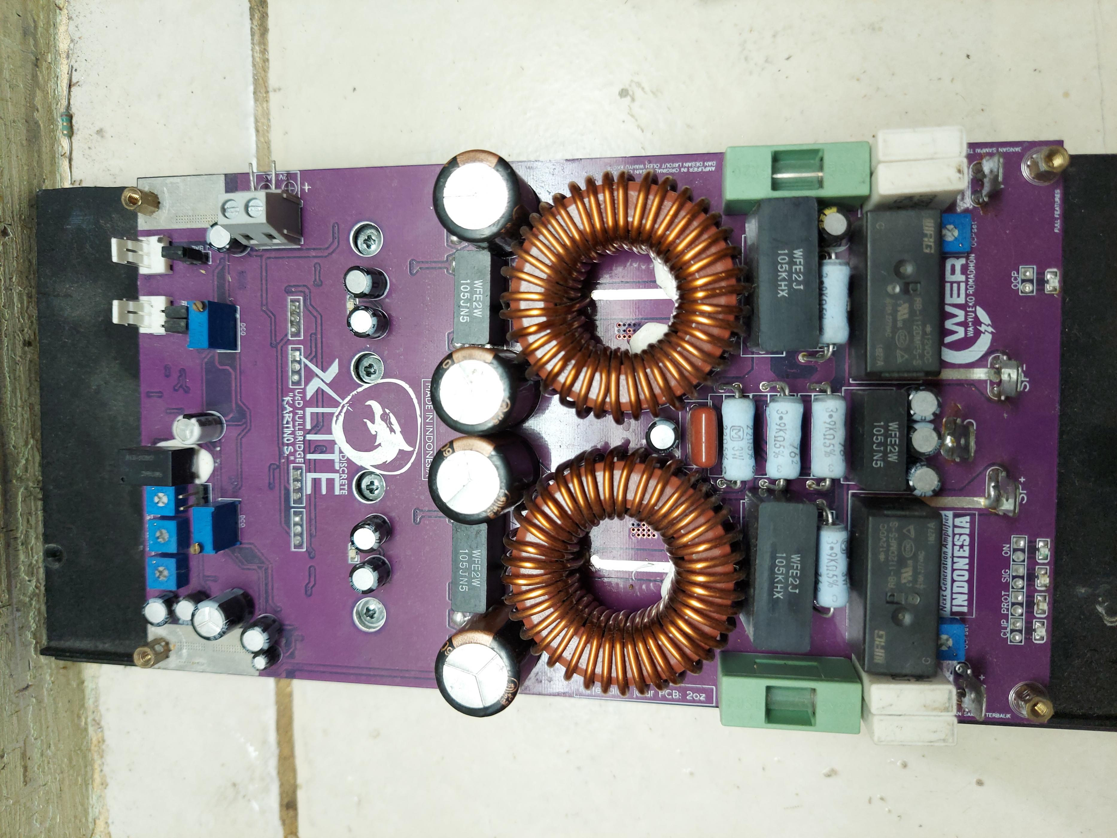

Yes it is look ugly but It can kick 18" x 2 sub very easy.
This amp is what TS looking for. The final version should be.
Another PCB design but same schematic from me.
Under dummy load test
