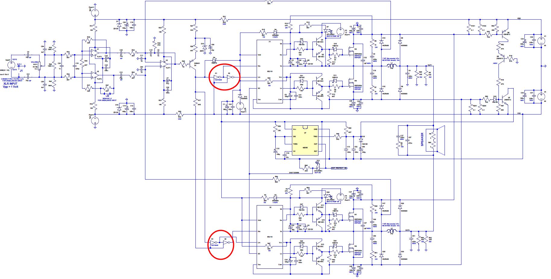

The other stuff is all commonly used blocks, but I added something different.
This stage is the "deglitch filter" stage (using basic logic + delay line), it's got some "negligible propagation delay" that needs to be accounted for when designing the compensation network, but... the benefits outweighs the annoyance, as it filters 100% false triggers and acts as a hardware "Noise Gate", blocking "jumpy, high-speed choppy PWM comparator signals", and it works pretty well, PWM signal is always outputting a "clean modulated PWM signal". This will increase the modulator THD quality in general, and avoid the destruction of the output stage if anything like HF rubbish is injected. (I don't think IR chips will block this nor will a discrete front-end block this out) in the event it does the output stage may be destroyed at random.
You can find a clever version of this circuit here.
US8487647B2 - Circuit and method for deglitching an input signal
- Google Patents
In my case, I'm using a TL3016, 7ns propagation delay comparator and even with some hysteresis applied there are still cases recorded on the Ti forum of choppy behaviour under tight layout with decoupled caps and the works. I'm lucky I have access to a 1GHz scope and I see many things during testing.
Most of my energy has been firmware, that was really hard, I spent 8 months getting it right, but now I have a very powerful supervisor circuit, I have removed all protection parts pushed everything into the firmware reduce part count.
I'm still curious how to design a integrator windup clamping circuit, direct that to ADC pin and add a priority order to control what takes over during different overload conditions.

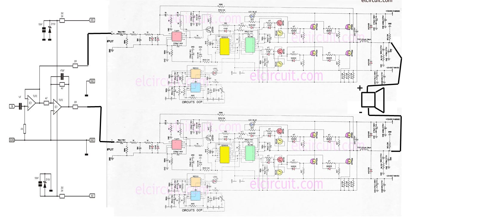

This one has feedforward active error correction implemented !
and working schematic for download or do you not share due commercial
interests?
What is the response time of your short circuit protection?

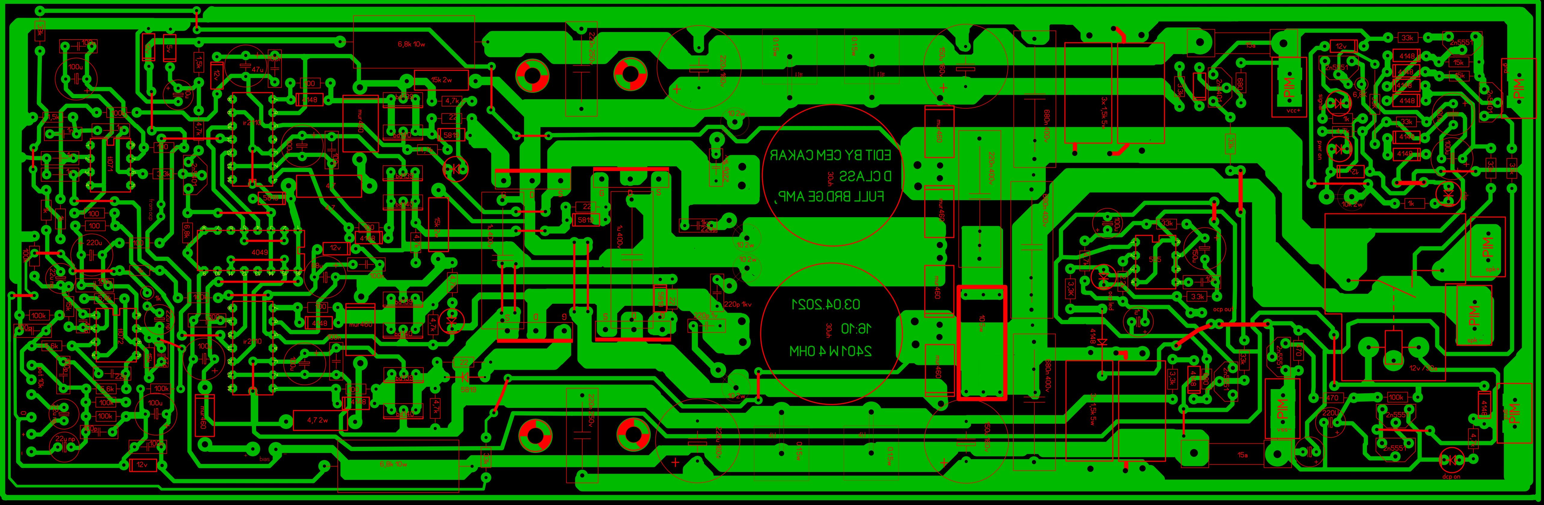

Class D killer is mostly not because short circuit but hard clipping which cause core saturated and kill the mosfet. So far we usualy limit clip use DLMS. But I start to develop anti clip. Slow progress as for just my hobby.

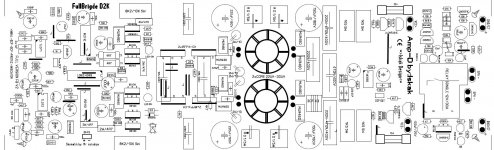

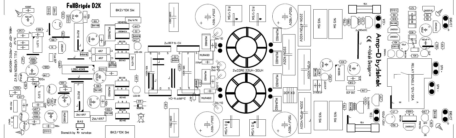

- Class D
- Fullbridge D class I could not solve the problem
