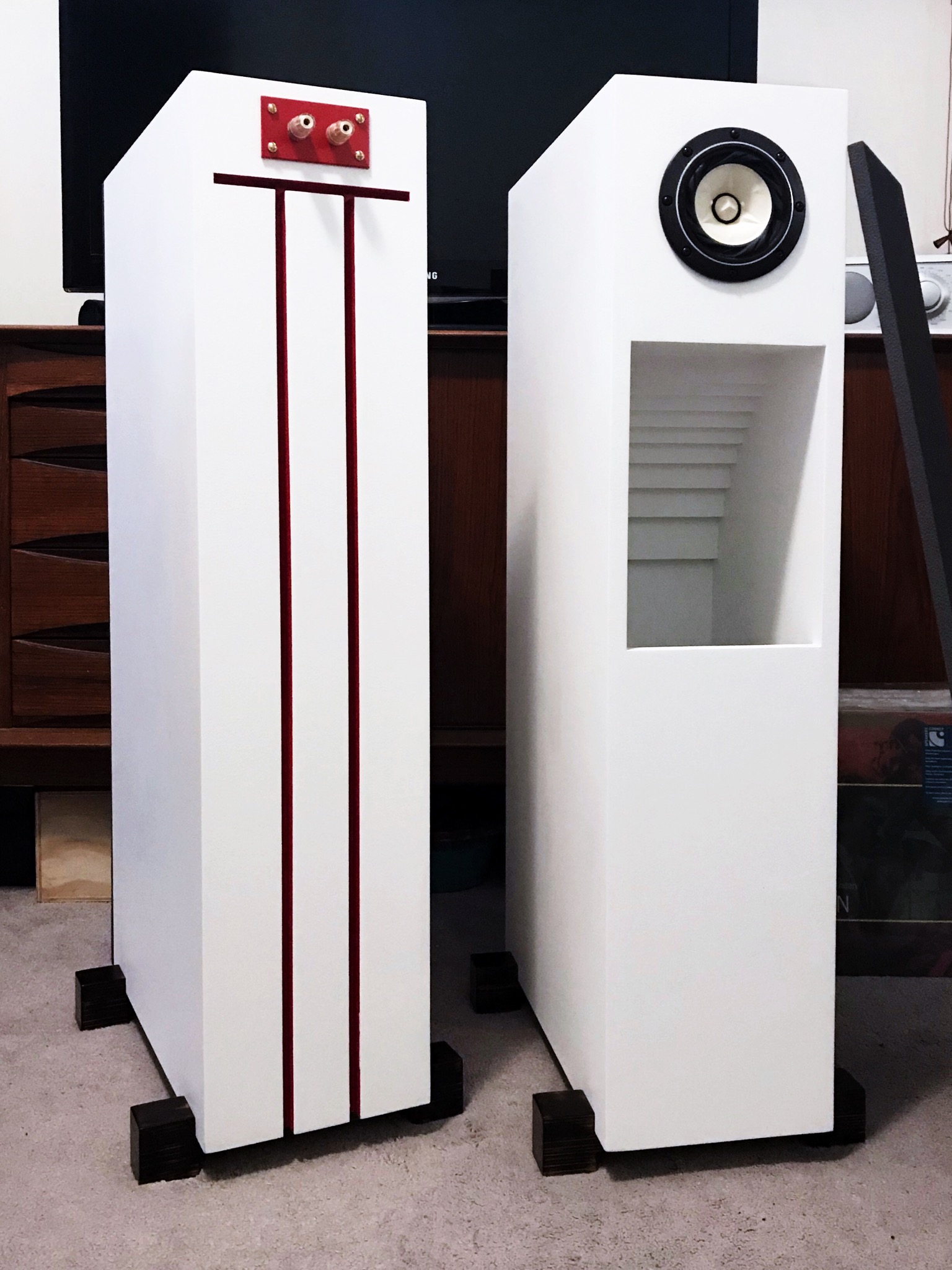

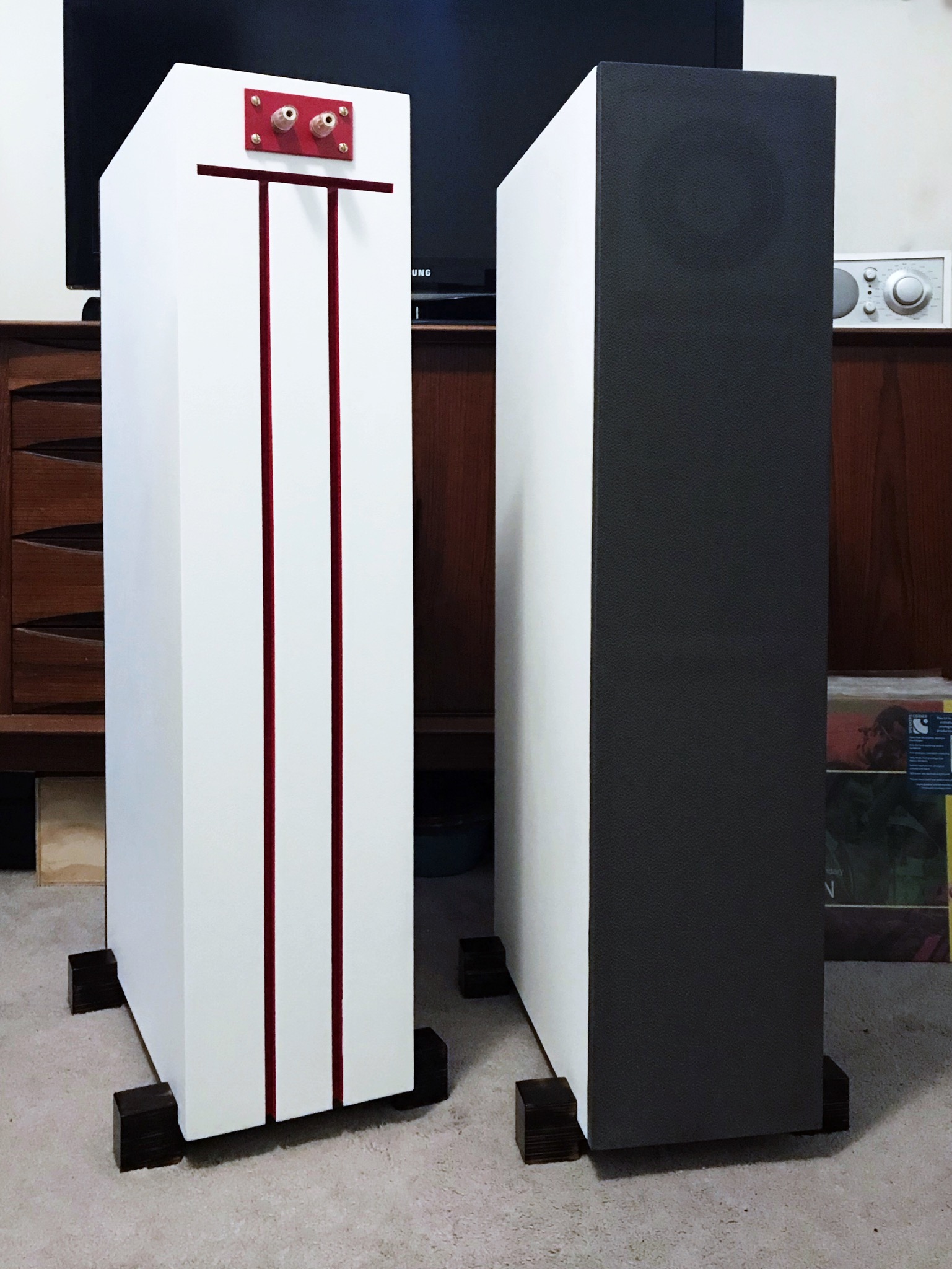

Bass from the A10P in the trapezoidal Onken is excellent. It goes surprisingly low. It really is an excellent design, and I recommend purchasing the paid planset from Planet 10.
Here’s the build thread:
Mar-Ken10pwTT Build
The 7C5/6L6 amp puts out about 1.5 Watts. I also built a version of the “Darling” 1626 amp thst about out about 3/4 watt. Both are fine for A10P in the trapezoidal Onken. I’ve also used SE 300B amps capable of 4.5 watts and 8 Watts, which had more than enough power.

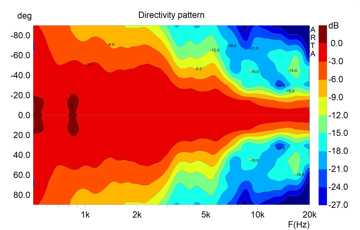

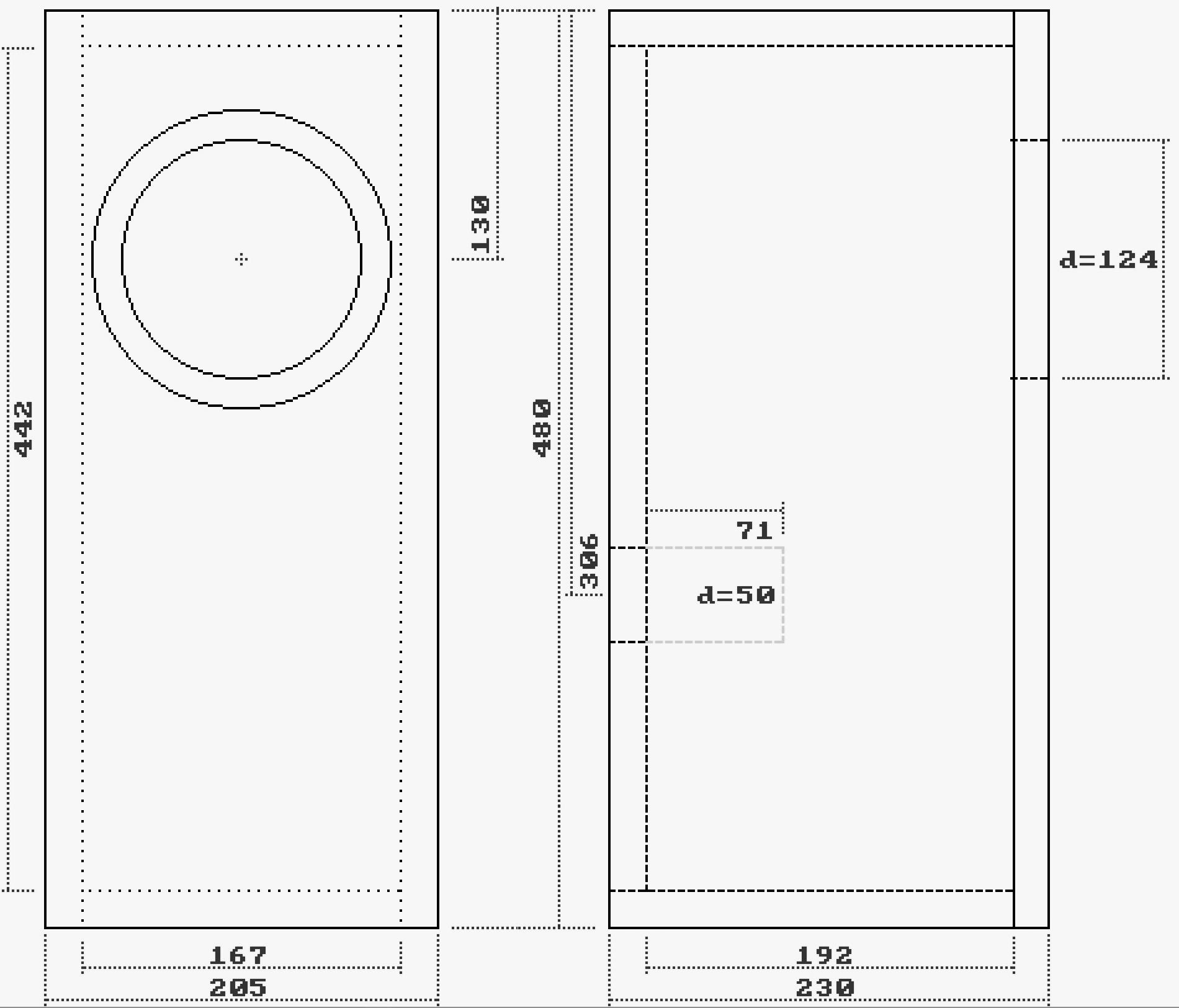

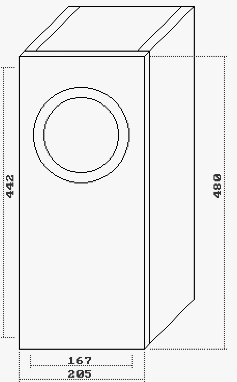

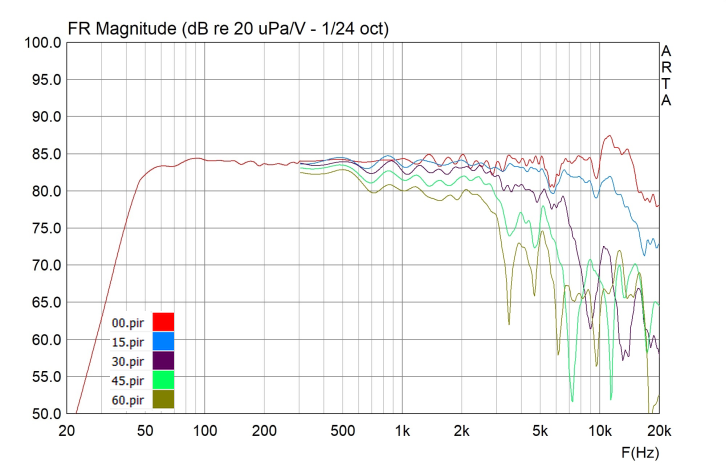

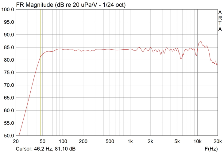

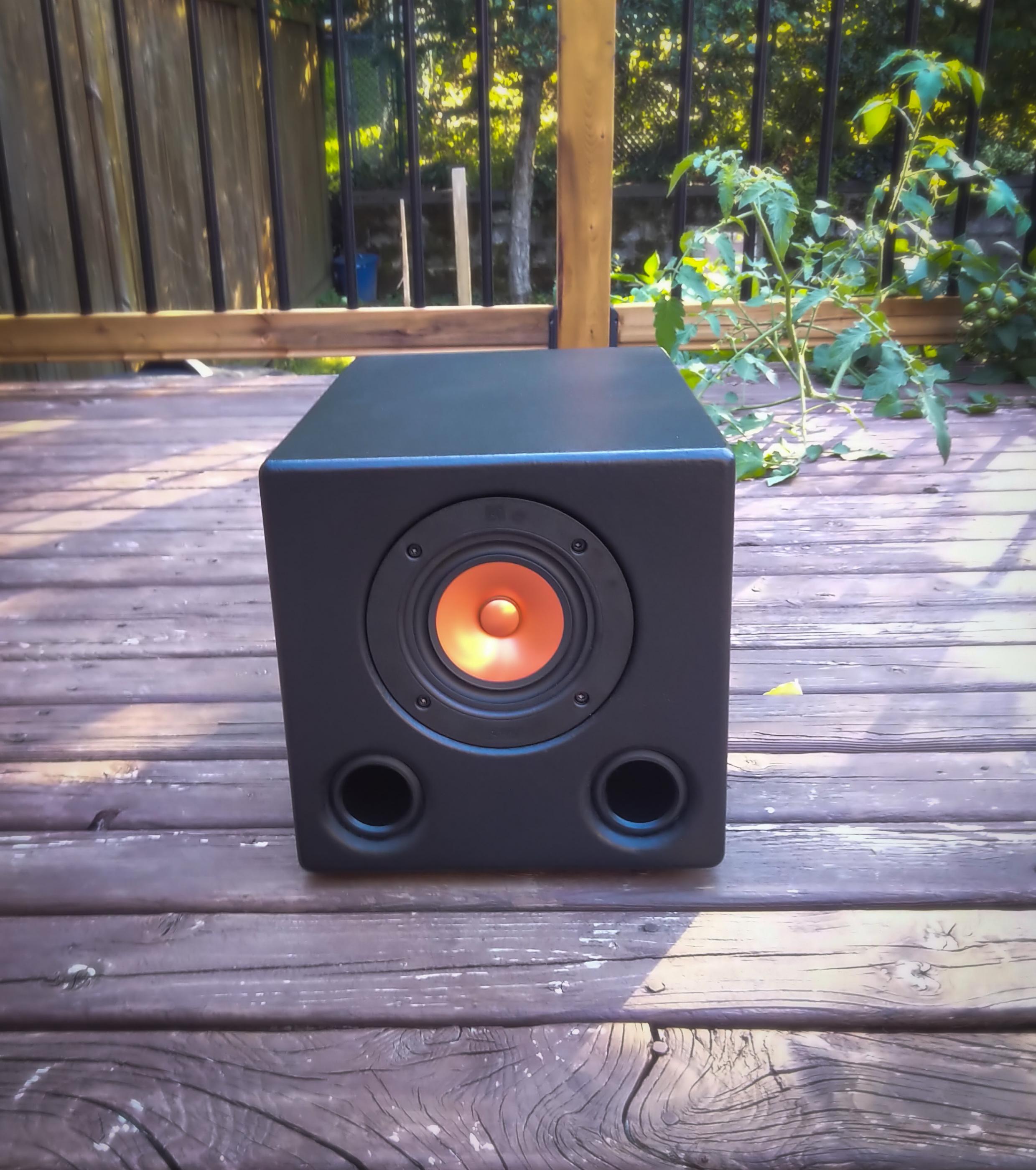

DSP-Controlled Speaker with Tang Band W5-2106
I recently constructed a DSP-Controlled bass-reflex speaker with Tang Band W5-2106
Plans (German): BB5 PC-Monitor

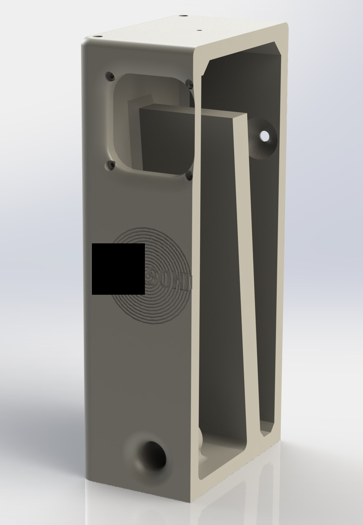

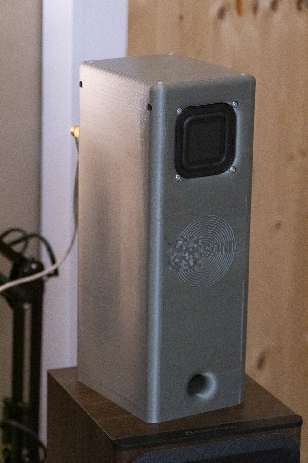

This is more of a fun experiment in 3D printing than something serious but it worked better than expected (which was nothing). Since the Tectonics square BMRs have a high fs, they can produce a tapered quarter wave tube that is quite economical with filament (500g). Done using the MH audio TQWT calculator and lightly tweaked in Transmission Line. There's nothing below 85Hz (to my ear, using a signal generator) but, down to that point, it's surprisingly even.
When I first plugged it in, I thought I'd accidentally invoked some audio dark magic before I realised my sub was still turned on.

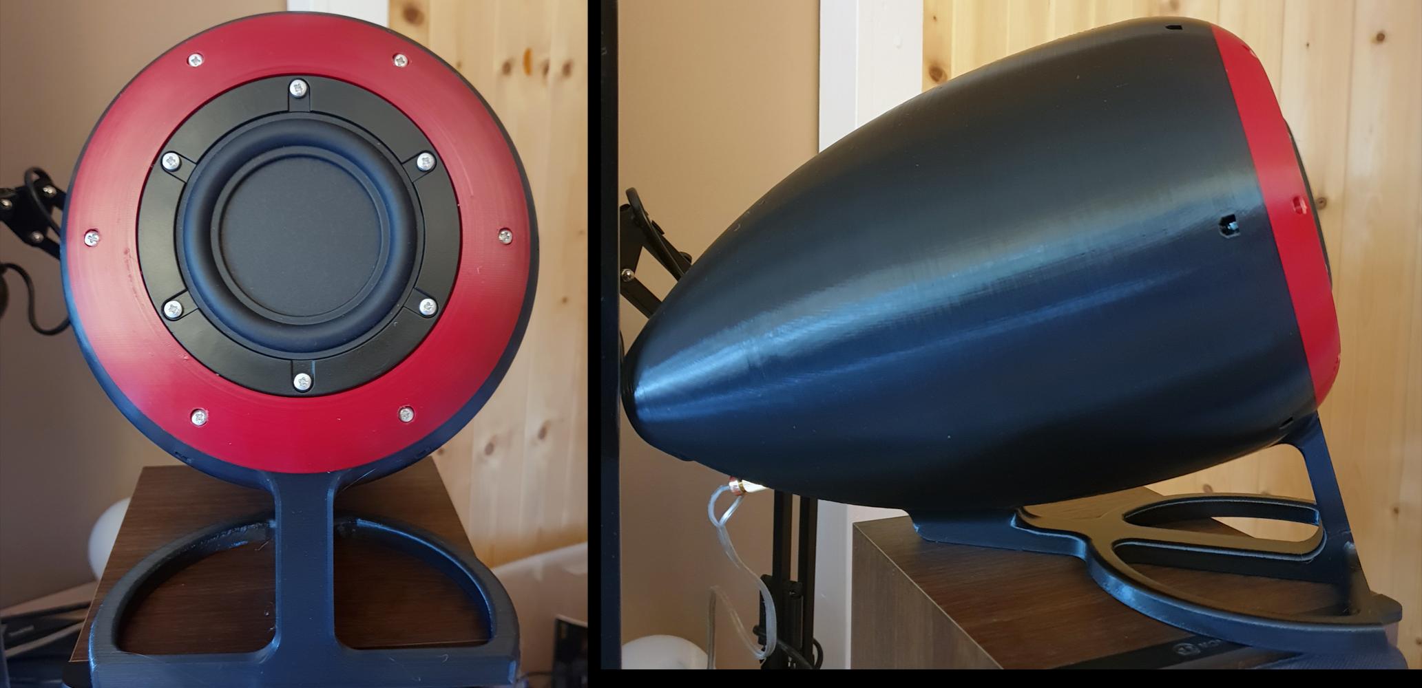

These are very strange to listen to: the mid-highs are extremely clear (as much as a single BMR will permit) while the bass is punchy but tonally compressed. It's like pairing a nice set of small bookshelves with the subwoofer out of a riced car. For some reason, there's 3 bass peaks, at 60, 70 and 87Hz.

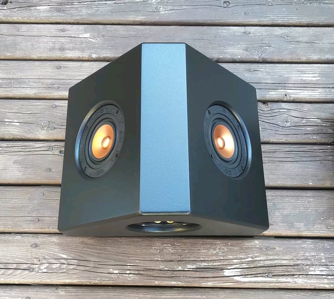

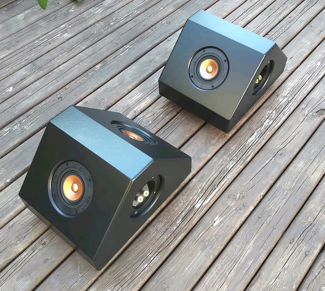

Alpair 6 sealed dipole surround speakers. Getting ready to test.
Edit:
I see some compression artifacts in those photos, will replace with better version later.

Because I autocorrected myself and didn't notice :) They are wired in-phase, bipole.
Listening position is quite close to speakers and hoping to achieve a more diffused sound with less gap in the soundstage. My current monopole surrounds provide a very direct surround sound effect but it is quite easy to detect the gap between them and they lack "envelopment".

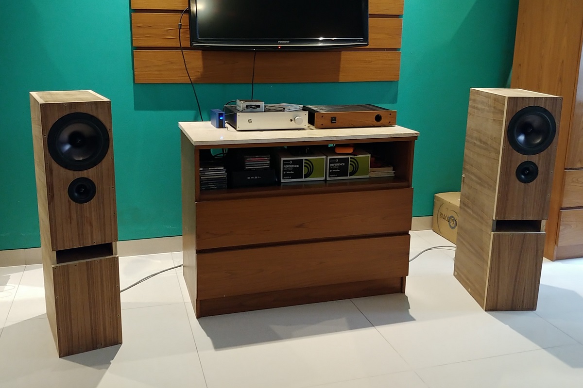

xrk971 RS225 FAST TL build
Here's a pic of my recently completed build of the RS225 FAST Transmission Line speakers designed by xrk971. My build uses the Visaton B80 as the mid-tweeter. The cabinets are yet to be stained or finished. My initial impressions are in this post:
10F/8424 & RS225-8 FAST / WAW Ref Monitor
Enjoying the sound. :) Thanks xrk971 for sharing the design with the DIY Community.
