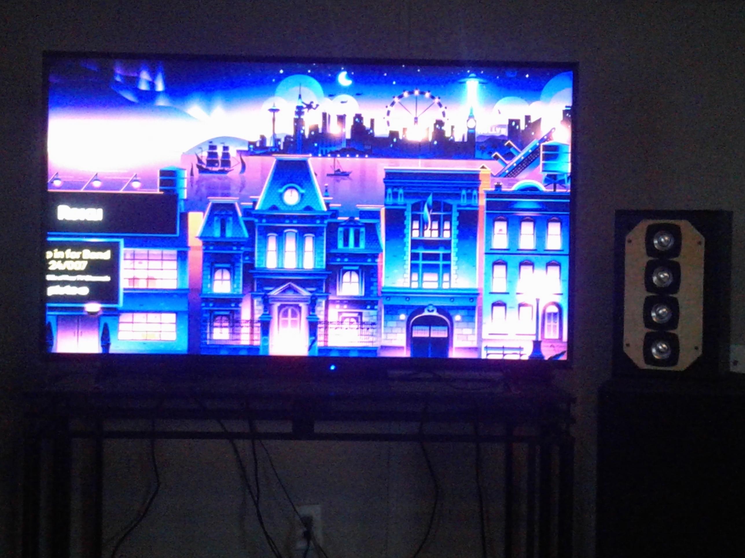

Mini array
4 x 3" fountek fe87
Seated 10-11' away, don't notice any combing, eyes roughly at 2nd from top driver.
Yes, you lose some highs standing.
Used as late night movie, more of a vocal monitor.
Voices handled well on "gattaca" dvd, used from stereo rca jacks from older bluray player.

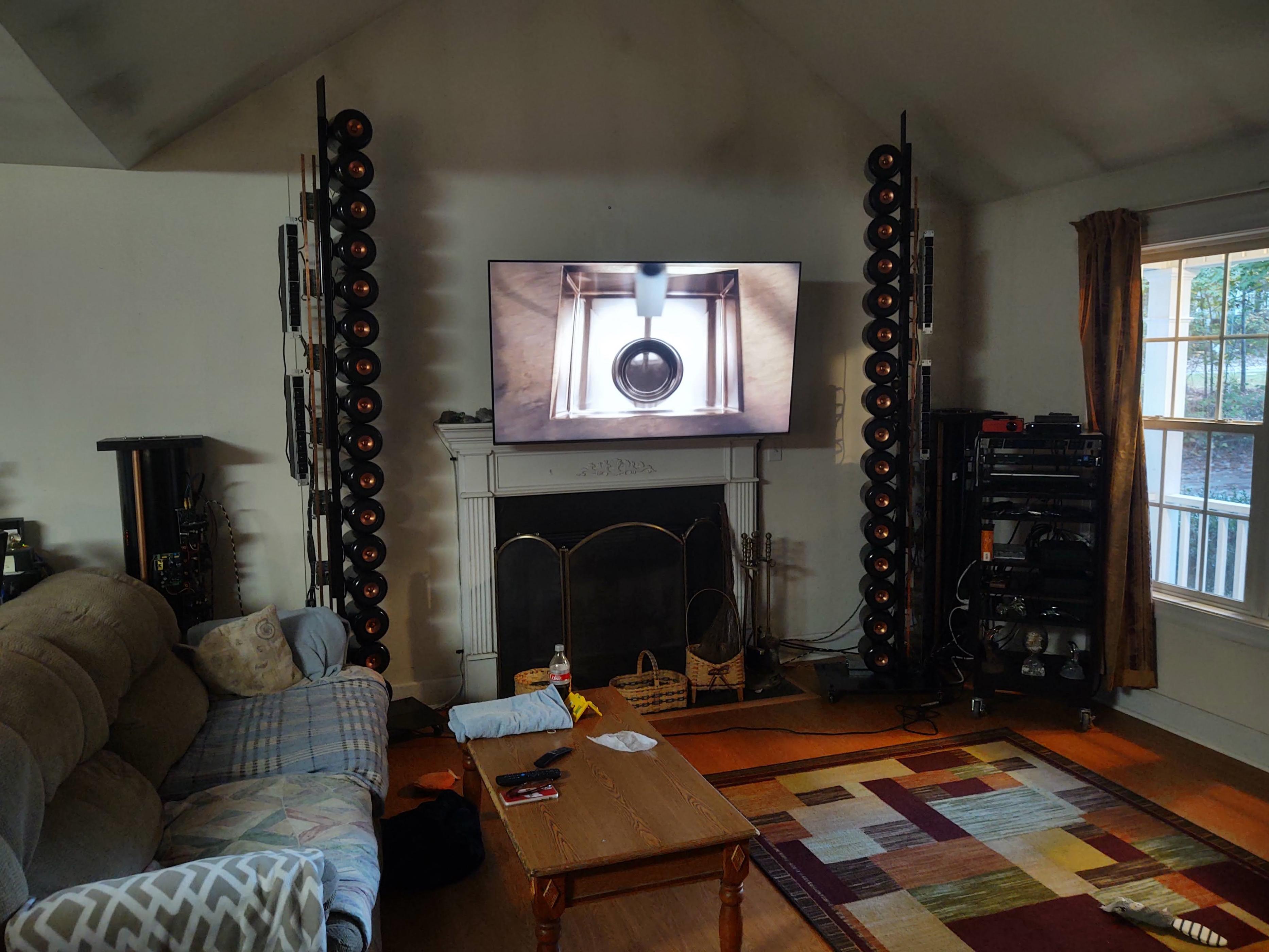

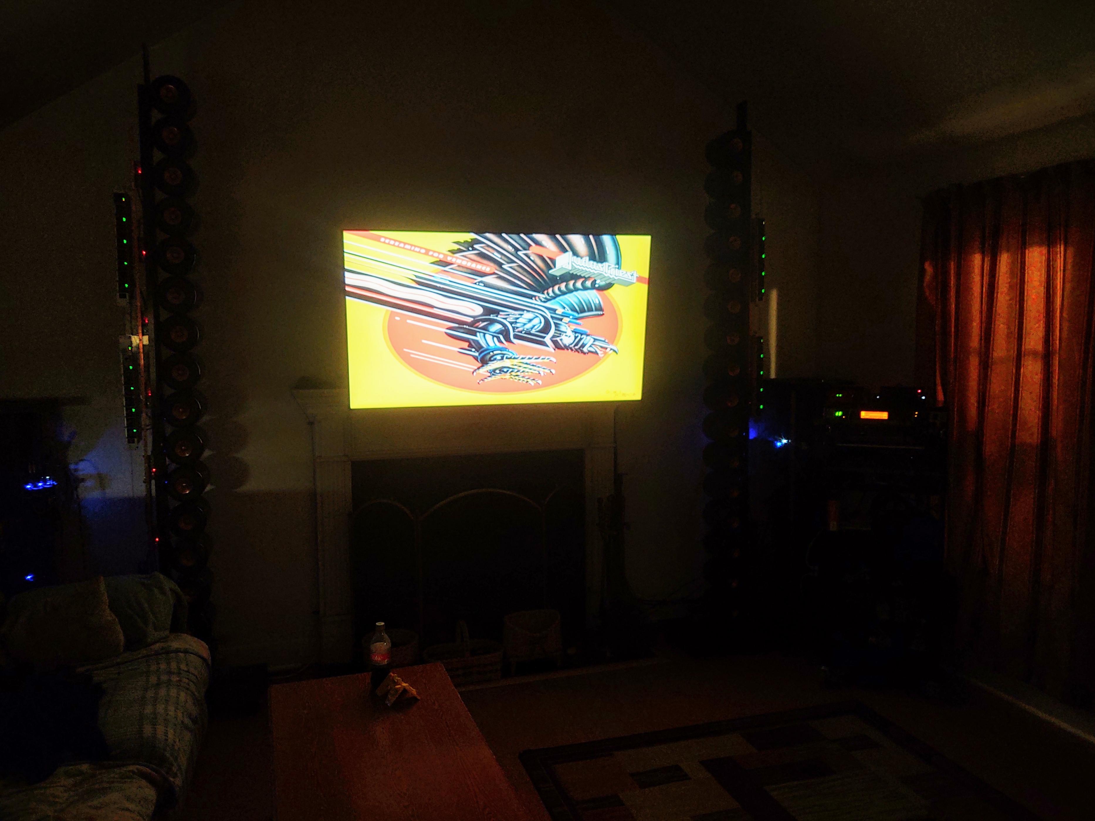

These are my new arrays which I call Lightning Rods. The 1/4" steel 109" towers have a -100% WAF factor which may result in death for any parties involved. They are built around the new MarkAudio Pluvia 7HD drivers and are currently individually powered by 120dB+ class D amplifiers made by Digital Amplifier Company with balanced inputs and volume controlled by 2x Behringer DS2800 per side. Right now each amp is driving 2 drivers. End goal is to purchase 8 more amps per side... Just now starting to enjoy abit at low volumes.
I thinks they’re great! Spouses are getting used to cellphone towers and these are much better looking albeit in the same species. You just need more minimalist ultra modern, Jetson’s-esque furniture. The rug can stay. Problem solved.
I should start a SAF advice column! 😀
Hello, thanks for the kind comments and interest in the design! I should specify more of what is going on with the electronics and the subs.
The amplifiers I use on the arrays are the InLine Maraschino amplifiers, boards only. Running them @48VDC. To assure they all get the voltage and current they all need across 8feet I use 2 strips of copper, measuring 1/2"W x 1/8"D x 8'H, for 48V and GND. You can see them mounted in front of the clear acrylic panel. The amps are mounted in the backside. The power supply is a Meanwell switching unit rated @2000W. 48V @42A. This is ridiculous overkill, as are the amplifiers, but this assures that nothing will get anywhere near their stress points. The fans on the power supplies were running at 60dB, so I had to replace them with slower/quieter 15dB ones and had to come up with a protection defeat strategy because the SMPS looks for a tach signal from the fans. No tach no power output.
For each of the subs I use 2 500W SMPS's powering 2 250Wx2 class D amps. Also each sub has a miniDIGI (made by miniDSP) module to handle SPDIF in+passthru and handles the 150Hz crossover. Inside the subs are 4 8" long throw Dayton subwoofers in a dual isobaric design. I've seen these things move like 2" peak to peak. They are mounted in 4' tall 5/8" thick PVC tubes.
As for the signal path, it starts as SPDIF out from the smartTV into the right sub miniDIGI (124dB SNR), then passthru to the left sub, then passthru to a Behringer DEQ2496 (113dB SNR) for EQ/hipass filter then to a Digital Audio Company DAC DAC HSV (130dB SNR). SPDIF ends at the DAC. From the DAC it's balanced cables to the dual Behringer DS2800 1in 8out splitters w/volume. Each output of the splitter goes to an amp, also balanced cables for highest SNR.
It's not perfect, as each miniDIGI stage adds about 3ms of delay for digital processing so the arrays get the SPDIF slightly later than the subs but I dare you to hear it.
One more pic from the other night: testing youtube from the smartTV. Did not sound good. But you can see the lights from the amps, subs and splitters. The green LEDs are the splitter signal levels per channel, so they blink. Not sure if I like the lighting yet but it does give me confidence everything is working at the beginning stage.
Cheers! Time for brew and listening, after a long slow day at work.

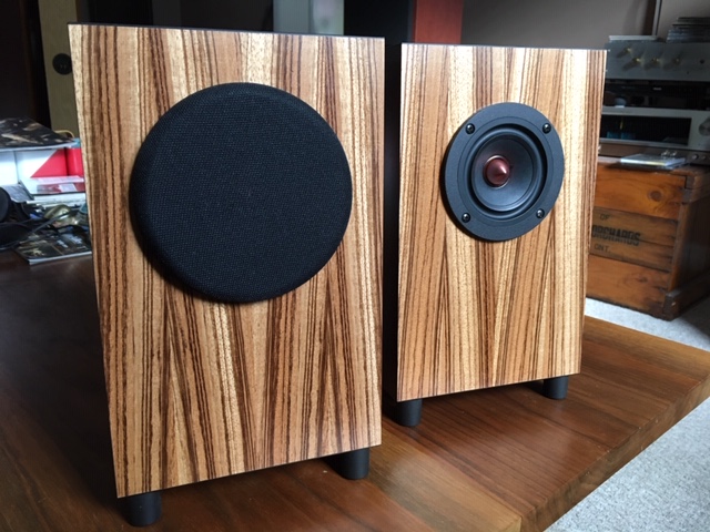

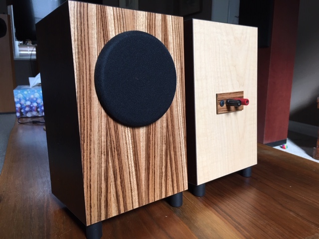

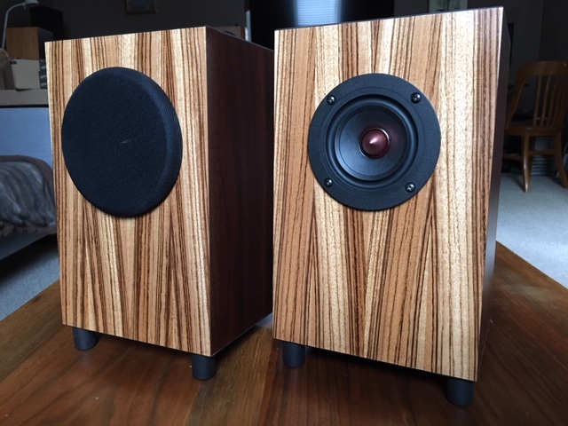

Mini Orangutan desk top build
I always liked the look of Devore Fidelity Orangutan 0/96 speakers so I tried to incorporate that look in my desk top build. I'm using the Dayton PS-95 driver.
