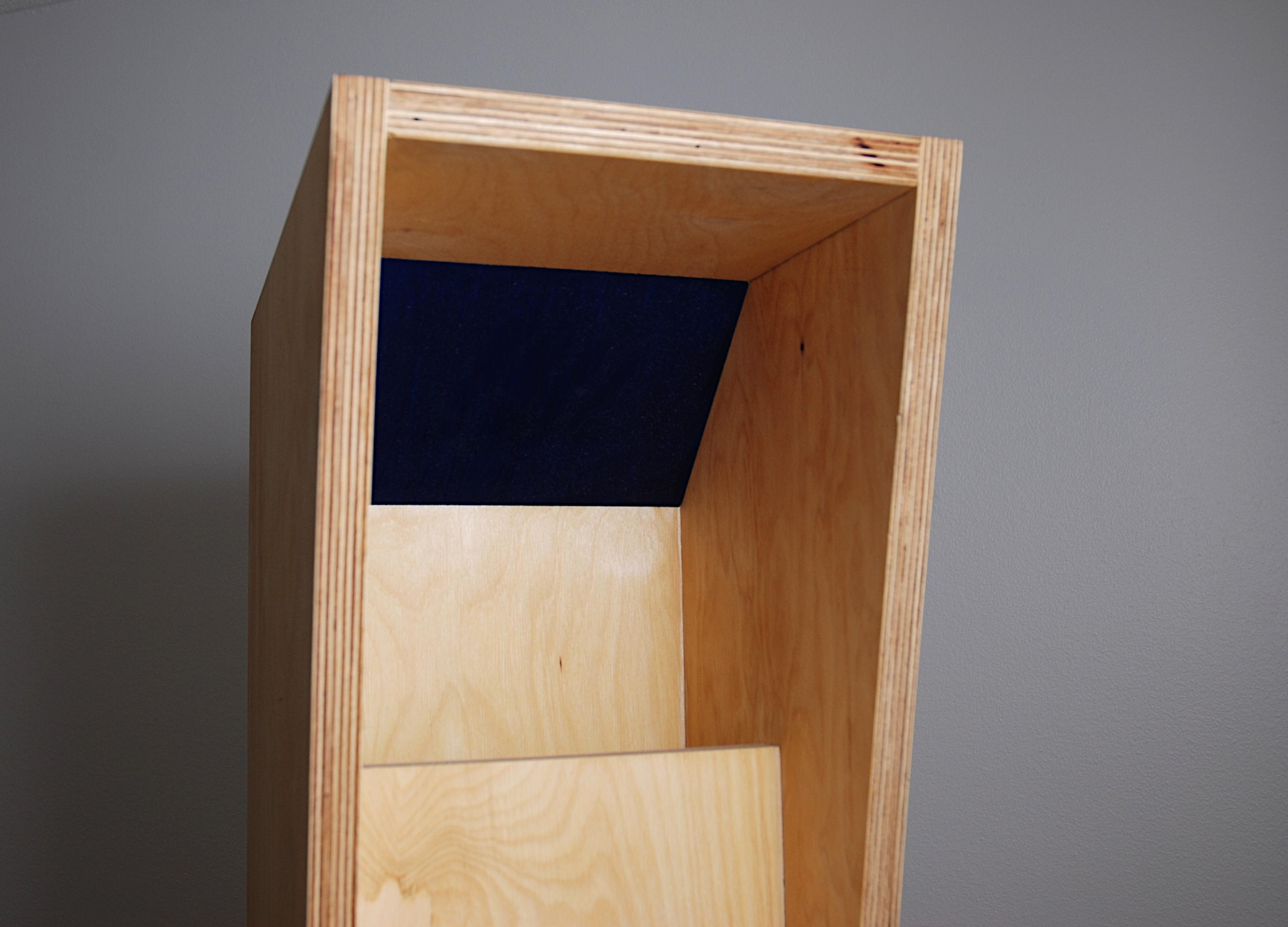

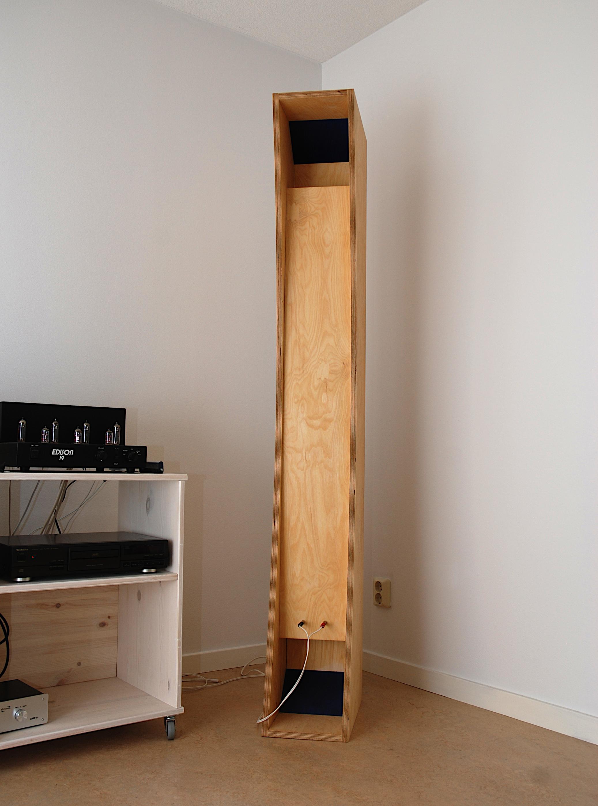

Can you post pictures of the back and/or during the assembly?
They are really nice! Compliments for the exceptional build!
Thank you. I had some help from a cabinet maker who cut the side panels in a CNC machine. I'm very happy with the result!
Attaching a couple of pictures of the back side. I painted the 45 degree pieces blue as a little flourish 🙂 No one ever sees that though, but I thought it was a nice touch. I'm planning on changing the driver mounting screws to black ones when I have the time.

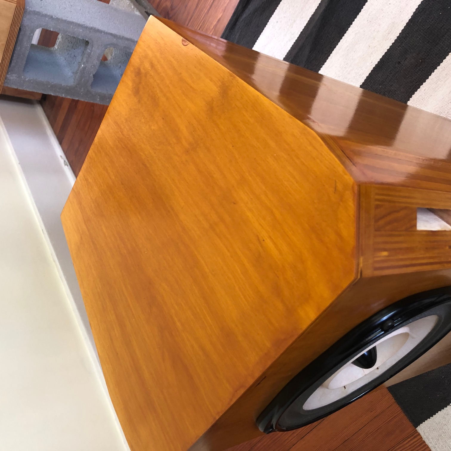

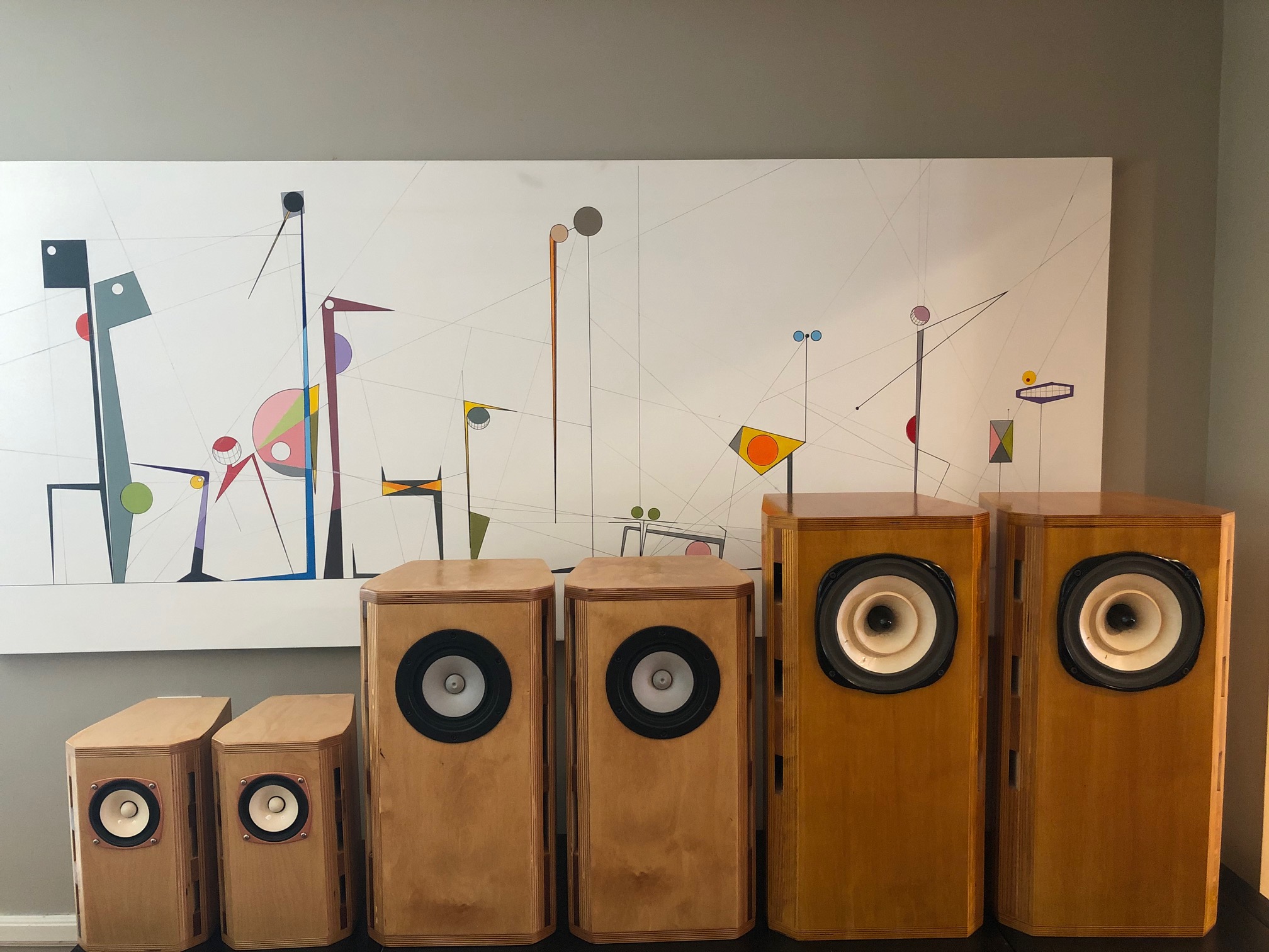

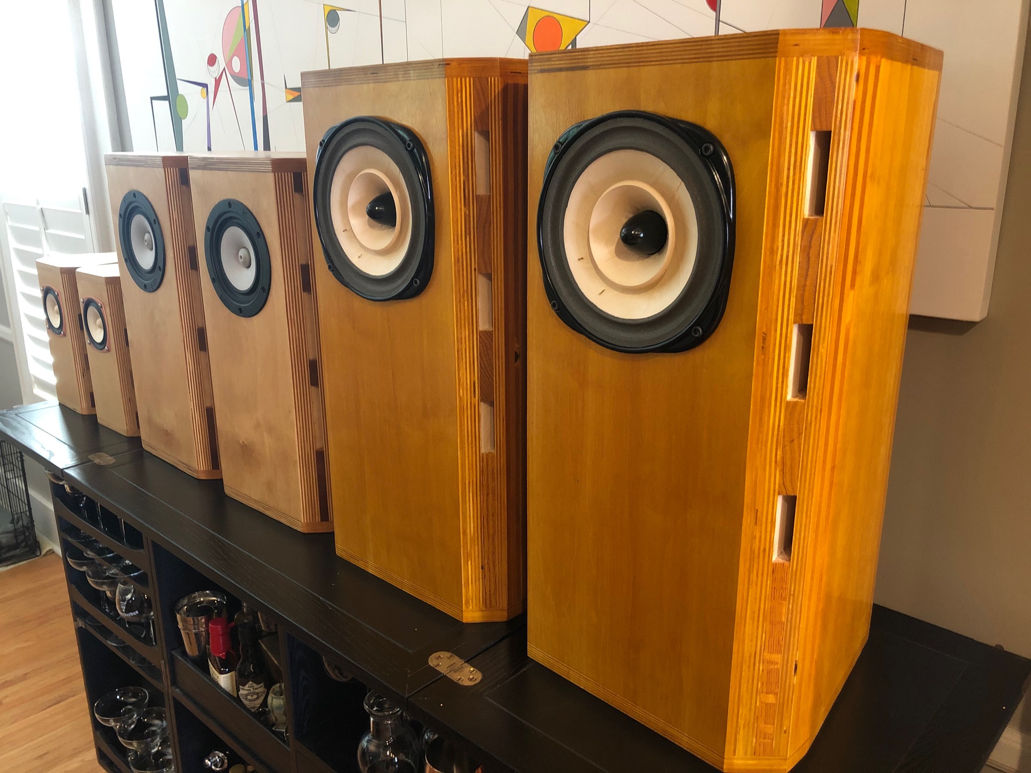

Trapezoidal Onken for Lowther PM6A. Thanks to David Dlugos of Planet 10 HiFi for the bespoke design. 18mm Baltic Birch plywood, solid red oak vent spacers. Finished with 12 coats of amber shellac and a top coat blend of orange oil, beeswax, and carnauba wax. I've only listened for a couple hours so far but they sound superb.
Also pictured are mFonkens for Fostex FE103Sol and MarkAudio Alpair 10P.
Those interested in more pics as well as thoughts on build process and creativity can follow me at Instagram: @boisetverre.
Edit: For some reason a few of the thumbnails appear sideways, but they correct when you click to open the larger version.

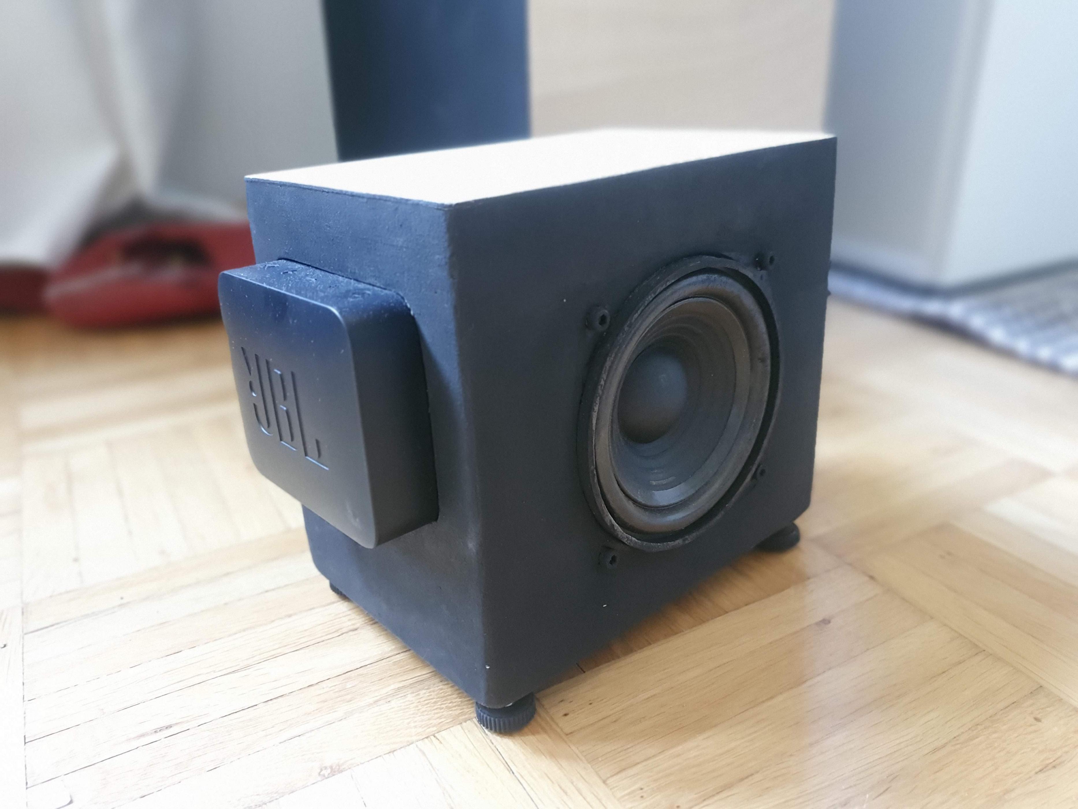

Now for something a little different - my quick summer project (one of many)
Decided that I need a portable boombox but didn't want any plastic shite so wanted to build my own. Quick google revealed that building from ground up the electronics part with batteries, charging, ports, amps etc would be too much for a quick fun project.
So in comes JBL Go 2 which had pretty good specs. Amp power 3W (questionable) and battery time 5-6 hours and BT / 3.5mm connections. Perfect.
Next thing I needed was a sensitive full range that would fit into something small, didn't want a barrel sized thing (for now) so Monacor SP-60 had pretty good specs. Fs 65hz and sensitivity 89db - Perfect.
They met each other in a 180x160x120mm enclosure (first prototype was bigger) made out of 12mm birch ply. Top part is veneered, sides painted with super-matte black. The JBL is attached to a shaped cutout so it's even removable later if needed.
Really happy with the end result, it's been playing almost daily now. Only thing that's wondering is the mid-range droop - is it coming from the amp, enclosure or element?
The mid-range droop is likely coming from the amplifier. Attenuation like that in that area usually makes it easier to listen to.
The rising around 10 kHz is probably a little harsh sounding. The amp is likely responsible for that as well. The original speaker intended for use with that amp may have needed a boost in that region. However, the measurements I found on this page show a breakup on the SP-60, but not with such peaks.
MONACOR SP-60 - 4" Mid-range
My guess is that the amplifier shapes the response as you have shown. Do you have a different amplifier to use for measurements?
That's my guess as well - the original peasized speaker likely needed EQ. Not a big issue as it's easy to fix up the response with the phone equaliser, another good thing about measurements. 🙂
Next time I'll make it ~7 litres for best bass, should reach some 60hz notes with decent volume. The mini amp can't overload it luckily.
