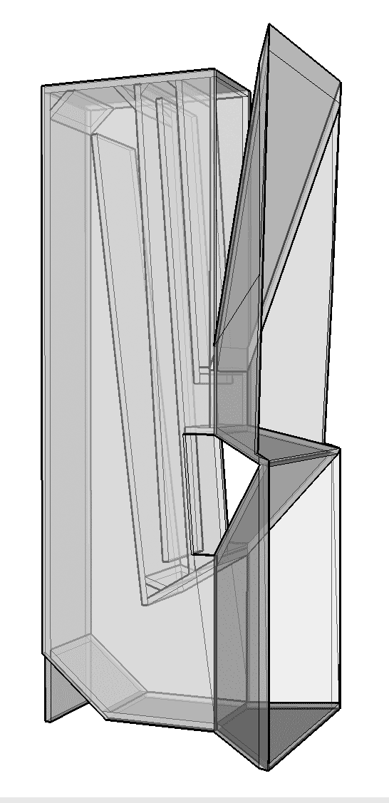

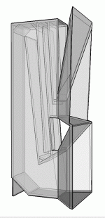

I saw these U-horns on a Russian site once. Do you have access to the plans? I'd love to have a pair built for me here in the USA.
Thetubeguy1954 (Tom Scata)
i have asked for plans on these horns w/ no response. i even joined the bgaudio.org blog & asked. no response???
i believe this is a composite design with the FR driver in a BiB bottom/forward firing enclosure w/ a waveguide based on the following & complimentary waveguide added for the LF exit.
plans would be nice!
Might as well join this thread now...
More info here: Lord of the Waves, The Two Towers
Same concept as Halair's towers, except this is the mentioned full monty ;)
Hi nuconz,
See the post #3079 in this same thread (previous page 308).
As i said there - 2D and 3D models (autocad) are available...and in case you're going to build this challenging project, you'll be supported by the few of us, (including the owner of the horns) which were in the team that build and tuned these monsters :)
Here again the link:
U-horn by Etheraudio
Kindest regards,
Kiril

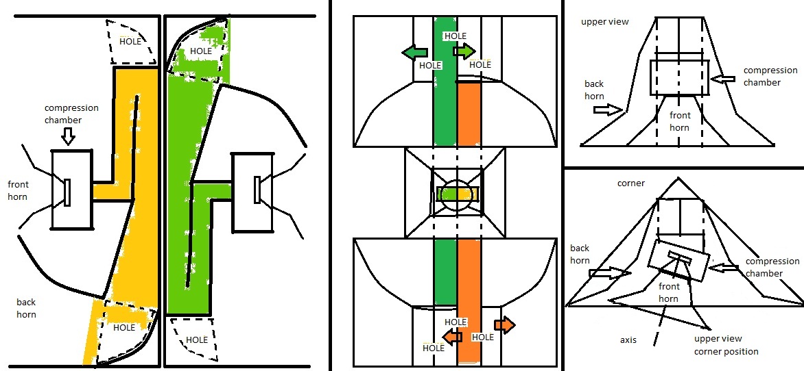

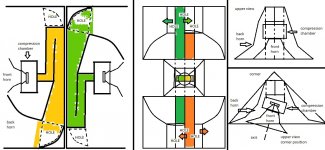

That reminds me my future (and endlesly postponed) project:
http://www.diyaudio.com/forums/full...loaded-fullrange-design-help-needed-wise.html
See post #22.
A front and rear horn loaded FR with the bass horn split in two, with each going in opposite directions. As front horn, I'll use the 2:3 Autograph's. The central diagram shows the front view. The left diagram shows an exploded lateral view of the split horns. The right diagrams show the upper view, with optional rotation of the front horn to allow room corner placement and firing of the transducer to your own sweet spot.
As I say, there is no thing as a too big bass horn...
And I believe the front horn should be "symetric and armonic", meaning symetric in at least two planes...
The FR transducer will be Audio Nirvana super10, coated with Dammar varnish.
Happy Christmass and prosperous musical new year.
M.

Thanx Kiril,
That looks to have all the information needed.
dave
Dear Dave, just be noted that there is a triangle (unused space) just before the exit of the horn which have to be removed during the construction. It took a lot of time to do this after making the boxes. it is a MUST to be removed! Thanks for the interest of my speakers. If you need any information or pictures of the consturction steps I can upload.
Best regards!!!

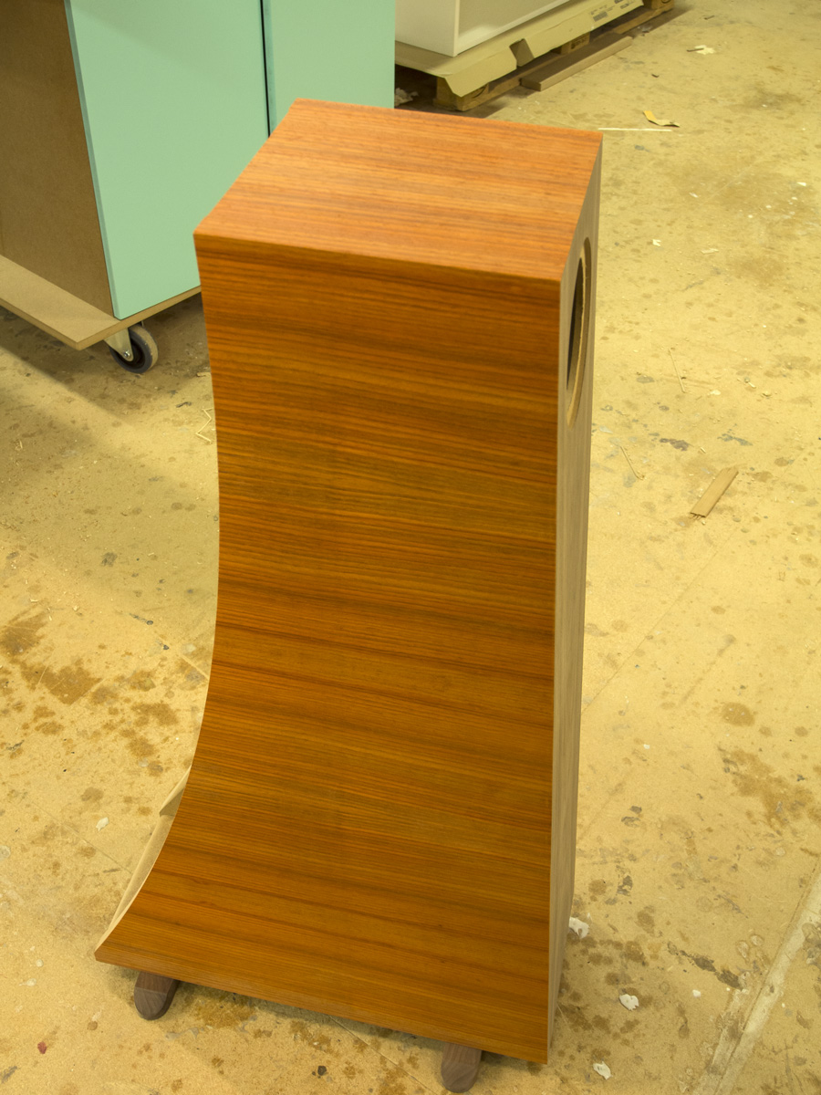

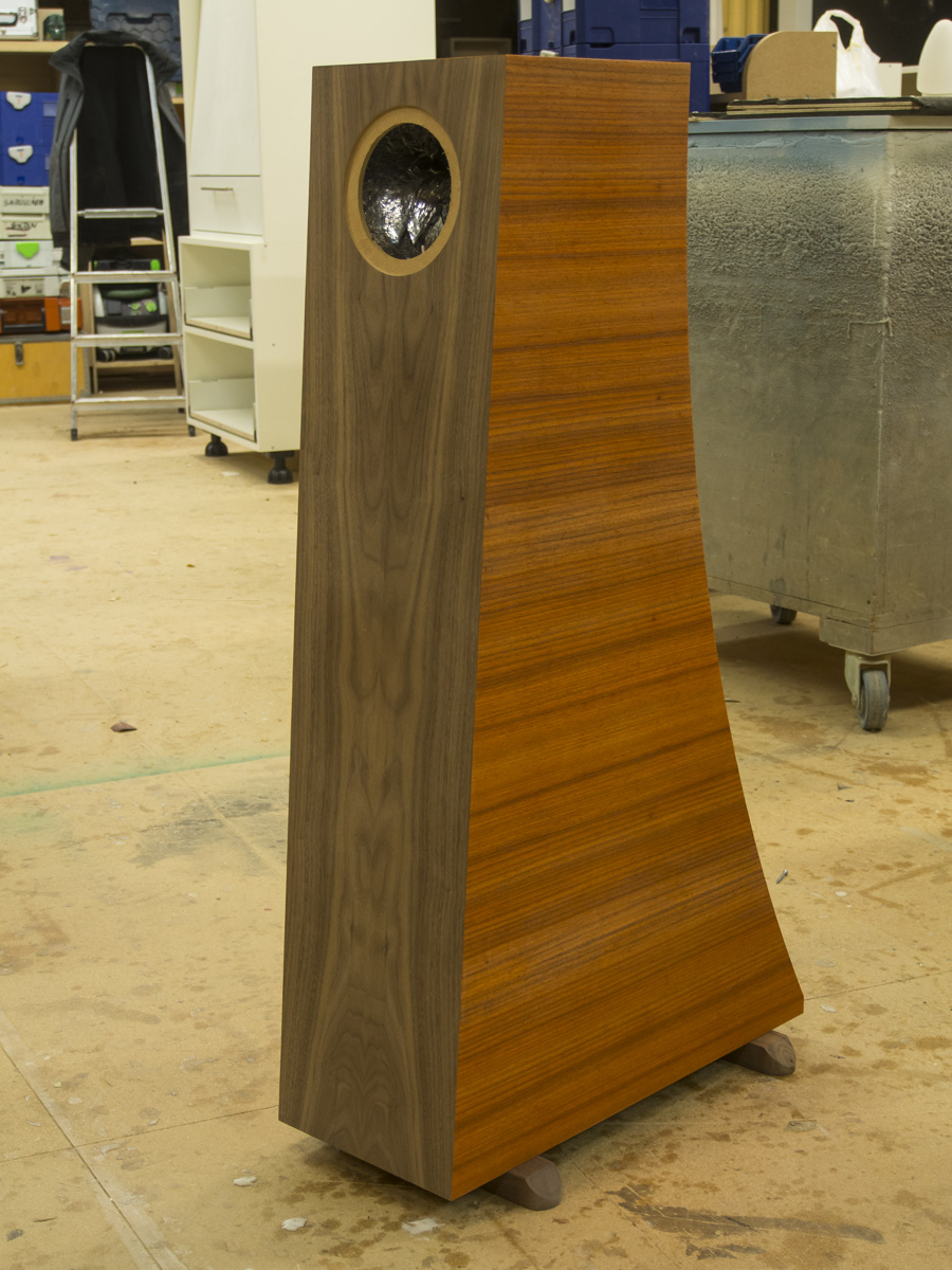

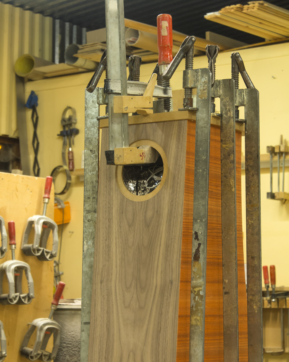

frugal XL-ish

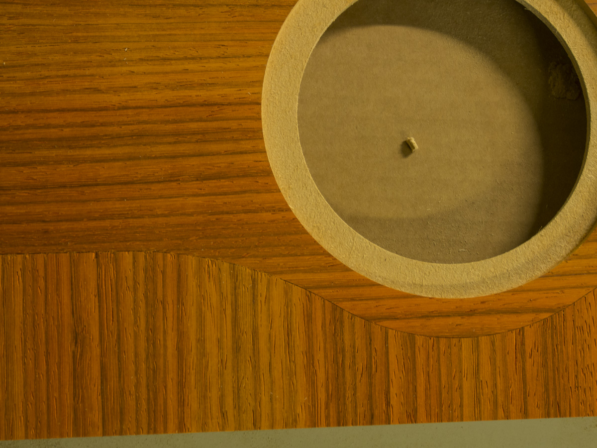

total newbie here, sharing some picks of my, soon to be finished - frugal xl-ish build.
build a test pair of the regular frugal horn, and was (are) very pleased. Wanted to build a bit bigger, and begun to do it, and then I came across pics of the frugal XL and saw that they were a bit similar. I know it's not "kosher" to just change measurements, but they not that far off, and being no expert, I doubt I hear any difference.
regarding the pics, nr3 (close up) was a f*ck-up, and I did not have more veneer (padouk) left to do a new baffel (showing is the one that is OK, but one is one short :) )
the new baffel is walnut instead. The color difference is now great, but in time they will move closer (walnut gets more brown, and the red/orange in the padouk will get darker (I'm told - first time working with padouk)
the padouk veneer is a decoflex Fineer en gefineerde producten - Europees marktleider in de verwerking van fineerhout - Decospan
the walnut is prelaminated on 19mm mdf
not decided yet on the feets/stand
edit: forgot - the drivers used: e100HD with their recommended zobelfilter http://www.eadsweden.com/drive-units/
