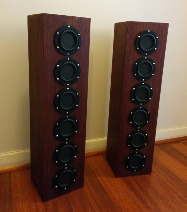

MLTL with Peerless 830986 3" full range. Dimensions are approximately 40cm x 10cm x 20cm.
Nice work Mayuri. How do they sound, and how low do they go? I have some 3" Founteks that I've been undecided how to use (FR, top end for a multi-way, ???). Just seems like it would miss too much on the low end. But maybe I wouldn't miss that for something like an office system.
They actually go very low for the size, they are tuned as a 1,9m pipe resonator meaning about 45Hz low end extension. Absurdly low, I know, but it actually works. I measured the response with REW (room extension also helps). Only filters on speaker are BSC and zobel network. I simulated them with the "transmission line" software from leonard audio and applied total of 21 grams of stuffing per speaker 21-27cm and 65-98cm down the line from closed end to tame 350Hz and 110Hz wide harmonic peaks. Driver is 1/5 down the line.

Overall, couldn't have been happier with these speakers. They don't produce SPL for rock concerts, but for everyday use they will serve me for a long time.

Cango, that padouk looks great. It has a funny grain structure like oak, but better colors.
yes - but it seems harder/crispier - like Merbau. It got a one layer laquer yesterday, and while still wet it had a depth in the coloring (it darkened as always) that was very beautiful. More pics when finished.

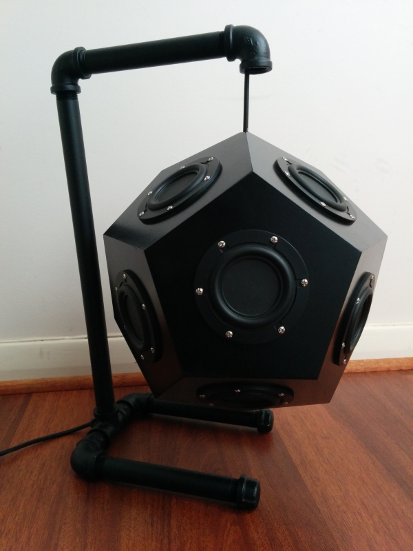

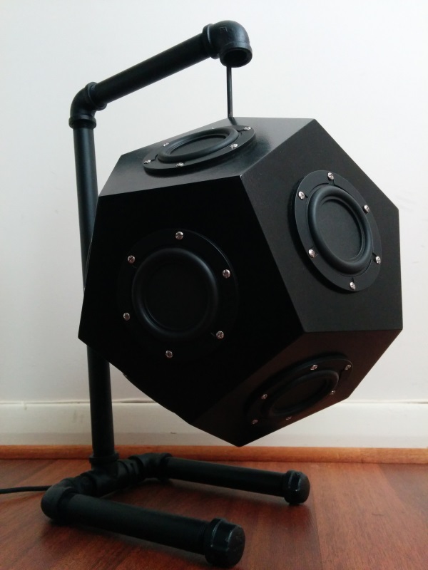

Omni-directional dodecahedron build

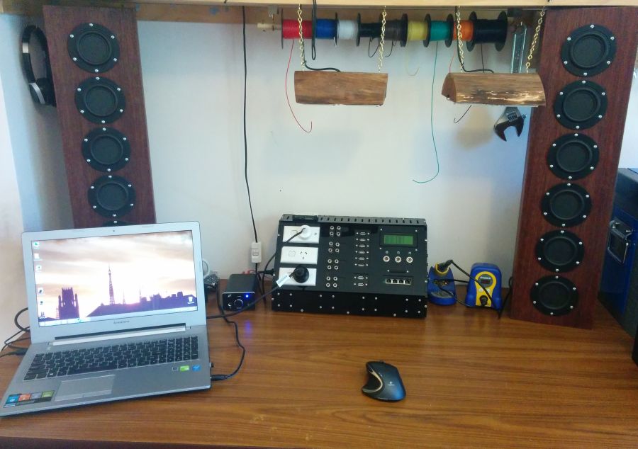

I got distracted and built a dodecahedron and some standard rectangle speakers a couple of months ago..
The rectangles sit on my workbench / desk and I am planning on turning the dodecahedron into a standalone speaker dock thing....
Both sound great considering the quick dirty construction methods..
Cheers!

How does the dodecas sound compared to the lines?
haha, you got me...
Honestly I have not had enough experience with speakers to give any quantitative comparisons, but I can say that I love the sound from the dodecahedron it is completely balanced and almost completely isolated from stand so it produces no unwanted vibrations, it's an awesome pulsing sphere of sound.
But I find myself using the lines more often, (which also sound great to my ear) mainly because I have two of them so I can play them in stereo.
I get a headache just thinking of how hard it would be do build a dodecahedron!
For the first one I had a lot of help from my dad who is bloody clever with the circular saw, I am about to build a second one over the next few weeks to try my hand at the 58.3 degree bevel...
