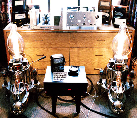

This looks like a system that Jules Verne would favor.
Or Nikola Tesla.
This would be a Nik's baby amp

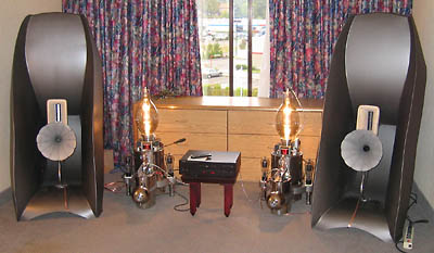

actually, Josh Stippich -VSAC2003 (like an idiot, I offered to help Josh and Terry Cain's crew load out this system after the show)
then the long shot, including speakers - welded steel, and really heavy
I remember that when Josh fired up one of those amps, that all three floors on that wing lost power. It took a couple of trys with everything shut off before it was up and running. Afterwards everyone turned on their systems. It's a little hard to see, but on the Left Hand Amplifier has a screwdriver handle sticking out. That screwdriver was actually about 3 feet long and Josh stood as far back as could get when using it to adjust the amplifier!

Yes, what was it 1900V on those mothers?
You forgot to mention the headaches from ozone that you could actually smell from outside of the room

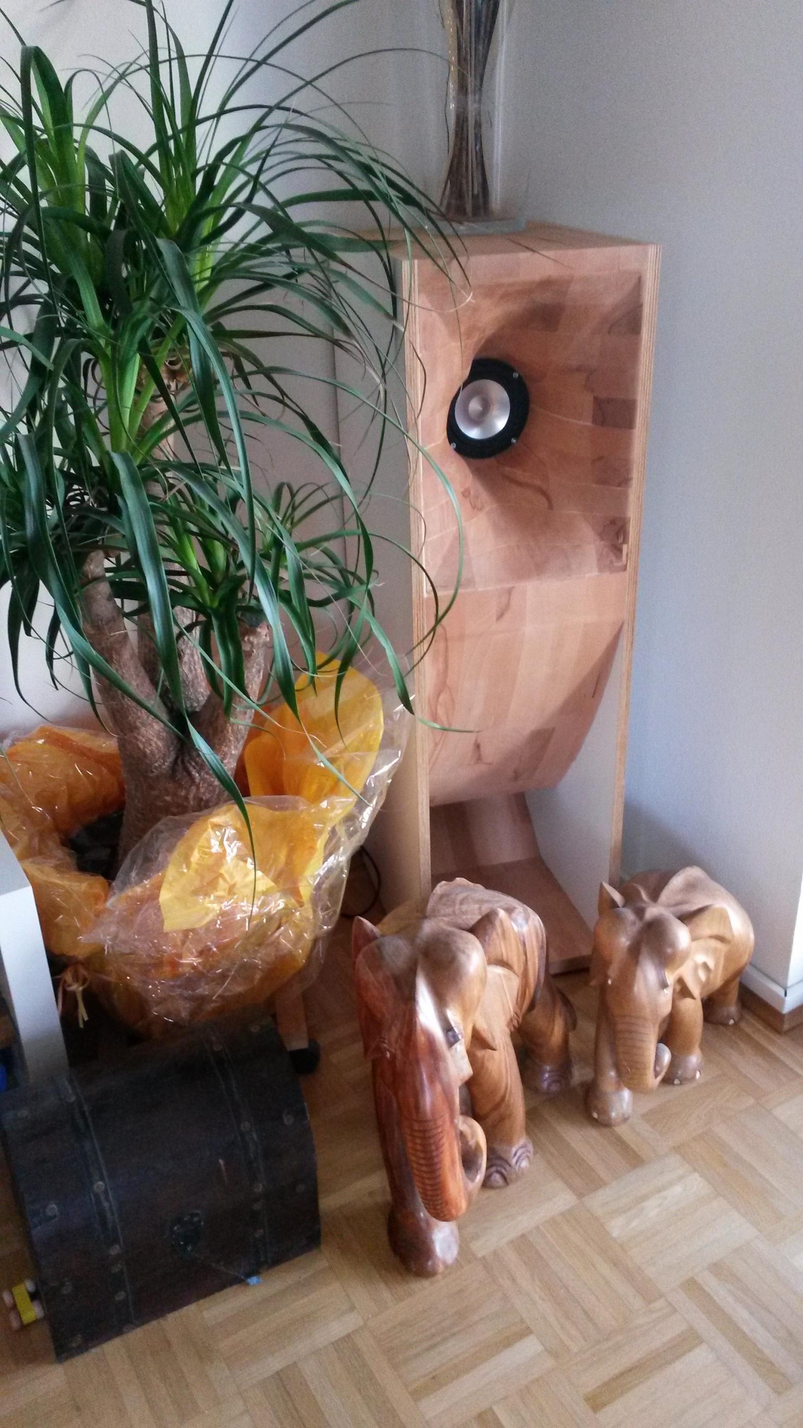

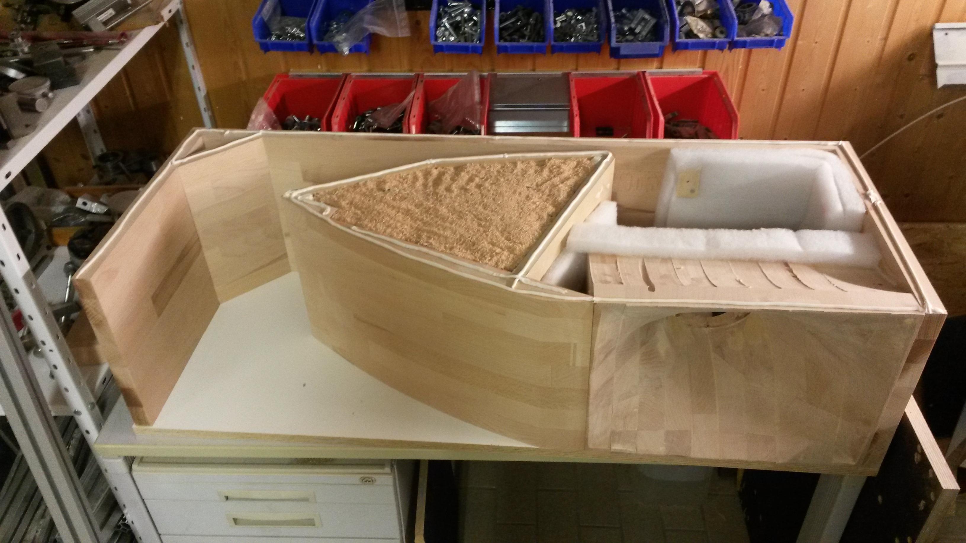

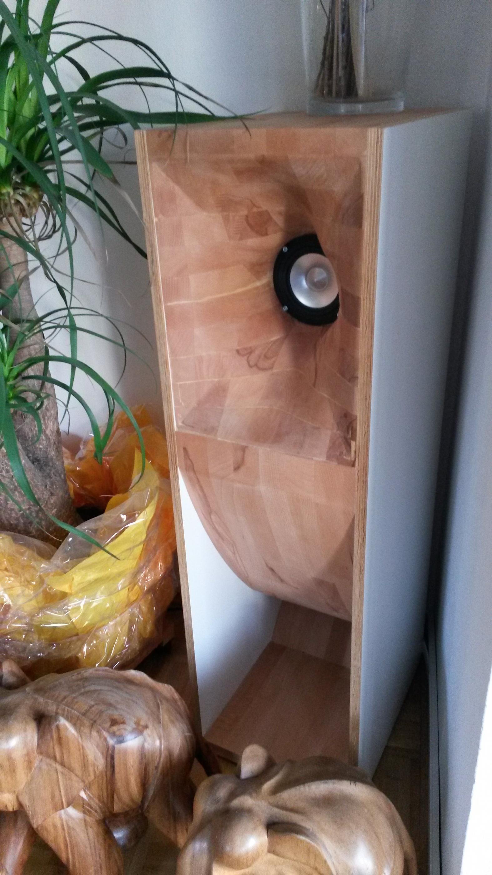

My latest speakers: Front- and backloaded horn for the Jordan JX92S:
I have not seen a cabinet made of glue-up panels before. I have plenty of experience with glue up panels in furniture and they are structurally sound.
But how do they sound?
From the looks of it the individual boards and glue joints would mitigate the resonance problems of a solid wood panel. But inquiring minds want to know.
Hi bruce,
this is my first massive Fronthorn, so I just can compare them to the normal 4 panel design I know.
I would say, they sound really dead silent.
I can feel no vibration at all on the fronthorn, no matter how loud I turn on the amp, they feel very massive.
Total weight of the enclosure is over 80kg, where the fronthorn makes 12kg out of it.
It's hard for me to describe the sound since my english ist not that good, but a few things impress me whenever I turn them on:
- very "listenable", relaxing sound.
- the instruments and voices are very close, in front of the speakers, but the stage is very wide, wider than the room itself
- they "flood" the room with music, no matter if you are in the sweet spot or directly between them, it's the same kind of sound
- they produce a deep (really deep ), rolling bass, very soft, sometime you just feel some pressure on your eardrum, but can not locate where it's coming from.
- SPL is of course very limited, but it's enough for me
You can listen to them for hours, they prefer male voices and reproduce them very neutral. These are my final speakers.
Even if sometimes I would like to have some more crispy trebles.
This speaker ist outclassing "the wall's" that I've build year ago by far. I love them 🙂
For me: Best you can get for the budget.

I designed it by myself, using a (single) horn calculation software and produced several prototypes before I started working on the final horn.Did you use an existing design for your horn or did you design it yourself?
Interesting to see how two horn corrolate, and how much the effect of a fronthorn like this was...
I've also build my own CNC last year, and I'm working on CAD since more than 16 years, so the way from calculation to the final design was very easy for me.
