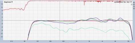

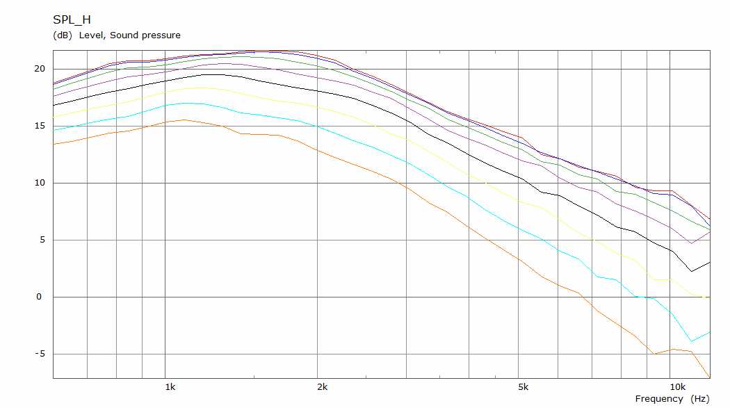

nc535, the 60x60 i have running right now is the narrowest H pattern I've tried, and one aspect about it that jumps out is how much more audibly defined the 60 degree H pattern's edge is than any of my wider H builds.
By edge, i mean in terms on VHF/HF rolloff.
Even barely inside the 60 degree wall angle is totally fine listening; even barely outside ....it's a different animal..
I'm guessing a narrower pattern makes for a sharper VHF roll-off.????
Here's 10 deg red, 20 deg blue, and 30 deg green out to the 60 H pattern edge. As you can see, VHF hangs in well. (there's a 20kHz low-pass in place)
The aqua is 40 deg.....
(This is the only tuning i've made for the box, a quickie indoors and at 1.5m...so traces shown are 1/3 octave smoothing awaiting cleanup outdoors)

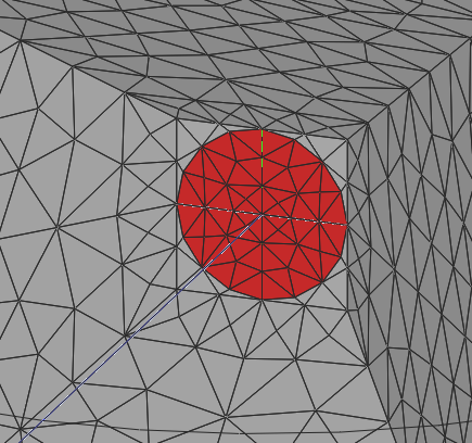

In my sim there was is no transition between round to square. The driver fires into a square throat like the SH50.
I doubt it hurts to smooth the transition but there is already a discontinuity between the conical exit of the driver and the entry of the waveguide. If the CD has attempted to create a flat wavefront that is also not a good match for a straight conical horn.
I suspect it is hard to see a difference when mixed in between those other issues.

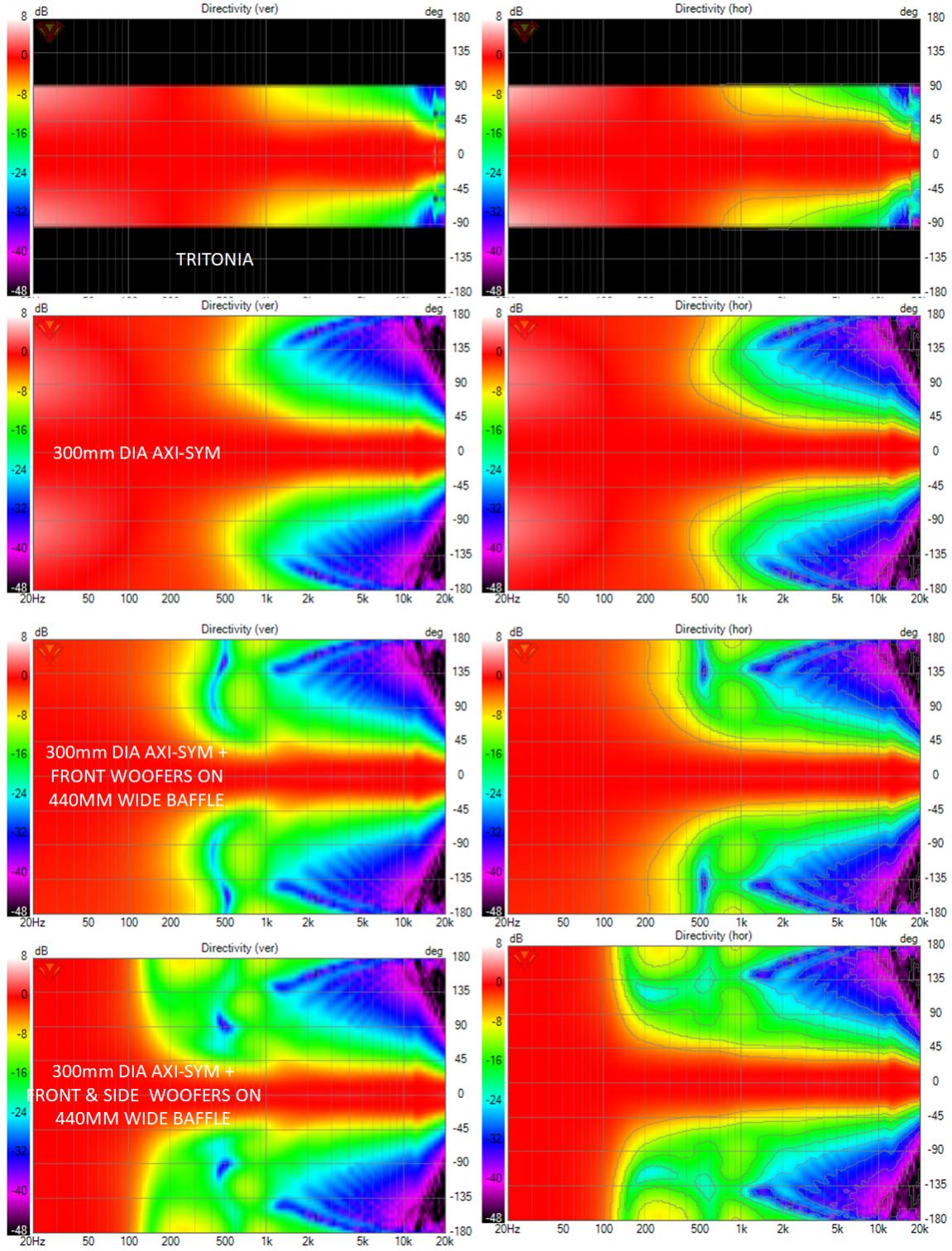

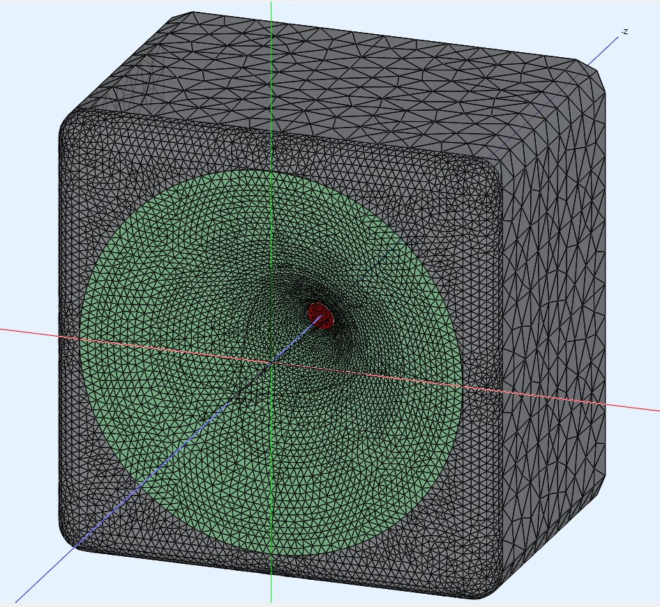

mabat was kind enough to publish the .cfg file so I found it interesting to simulate it. Doing the sim 300 hz to 18 khz with 64 freqs took 2.5 hrs. I then realized it had only computed 90 degree directivity. That was enough for a comparison.
The top row is Tritonia stand alone. It provides constant, controlled directivity down to about 1 khz and is impressively smooth. Overall dimensions are 422mm x 364mm.
The next row is my 300 mm dia axisymmetric waveguide. Its quite a bit smaller and has a narrower beam (60 vs 80 degrees) but it controls directivity down almost as far and then widens very gradually.
Augmented with front woofers that fit on a 440 mm wide baffle (next row down) it gives control to more than an octave below Tritonia.
Finally, adding side woofers for cardioid extends control downwards another 2 octaves.
Admittedly my simulations don't yet address the effect of the nearby waveguide rollback with the front woofers but if that proves to be small, then its quite clear which is a better path to wideband controlled directivity.

An infinite baffle sim can only give you +/- 90.I then realized it had only computed 90 degree directivity.
This sim says don't do it. Have a look at the ST260B scaling that up and rounding the edges of the baffle should give a pretty good response. A narrower version could be made to match the existing one if that is the pattern you want.
I suspect the box behind needs to be about same size or smaller than the WG in order to get rid of the diffraction problems in the listening window. The problem is the physical dimensions are different for the two systems (WG and the box behind) but around xo they both have output at same wavelengths. Both "systems" could have smaller physical dimensions to not diffract wavelengths at xo frequency but this is hard to pull of. ATH sims show the freestanding guide with rollback affects directivity little below physical dimensions suggest so it might be possible but you have to minimize size of the box behind. Get them systems to be the same size and you might be pull this off without problems = mount the woofers somewhere of the waveguide profile but no further. At the rim or as in multiple entry horn. If this is not possible, you might have to accept a little bit of diffraction ST260B on large baffle with the woofers around and generous roundovers might be the other option. Both have some diffraction, it is very hard if not impossible to eliminate with finite baffle. You might try to move the diffraction somewhere on the low mids with large baffle as well. Maybe it is not so audible.

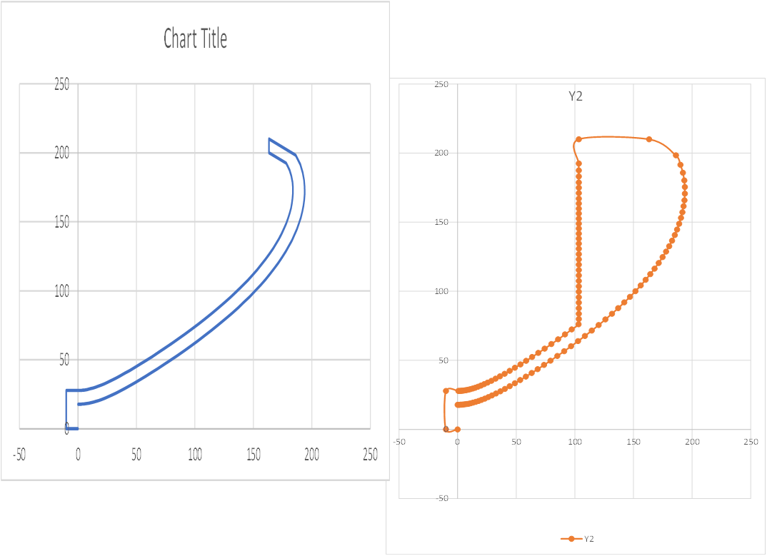

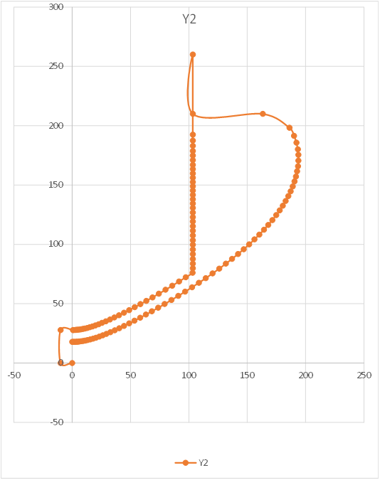

Heavens no; that would be too much work. I just modified the nodes.txt file which defines the profile of the axisymmetric horn to model a cylindrical back.
Here is the original profile and how I modified it

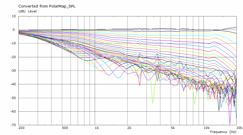

Here is the resulting response for this 420 mm waveguide:
It looks like I also intended to simulate this
including a baffle at the other end of the cylinder
but I don't see those results.
