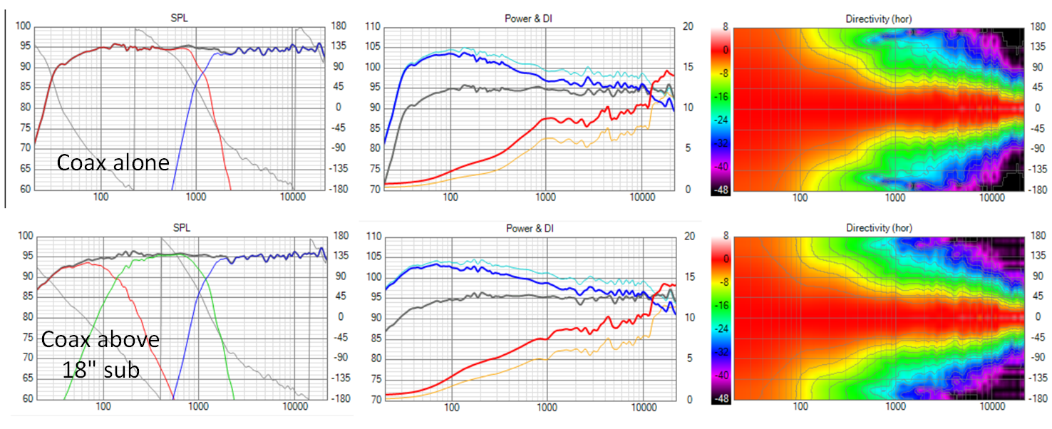

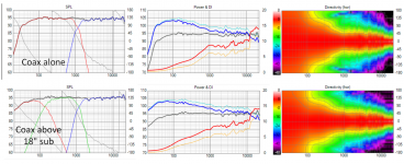

Here are Kimmo's responses with 15" coax with and without 18" sub
attachment.php
I see whatever irregularities there were in the raw response have been smoothed out quite nicely. The low end directivity makes me question the need for cardioid.

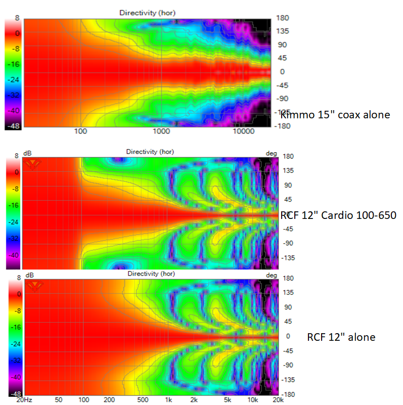

Here is comparison of the 15" non-waveguide coax to the 12" waveguided coax.
attachment.php
There is a huge directivity benefit comparing RCF waveguide with and without the side woofers. The difference is much smaller comparing the 12" cardioid to the 15" non-cardioid. Note I lowered the high pass on the side woofers to 100 Hz for this comparison.
This comparison doesn't do justice to cardioid which in my case is showing >= 10 db attenuation to the rear giving substantial freedom in room placement.
