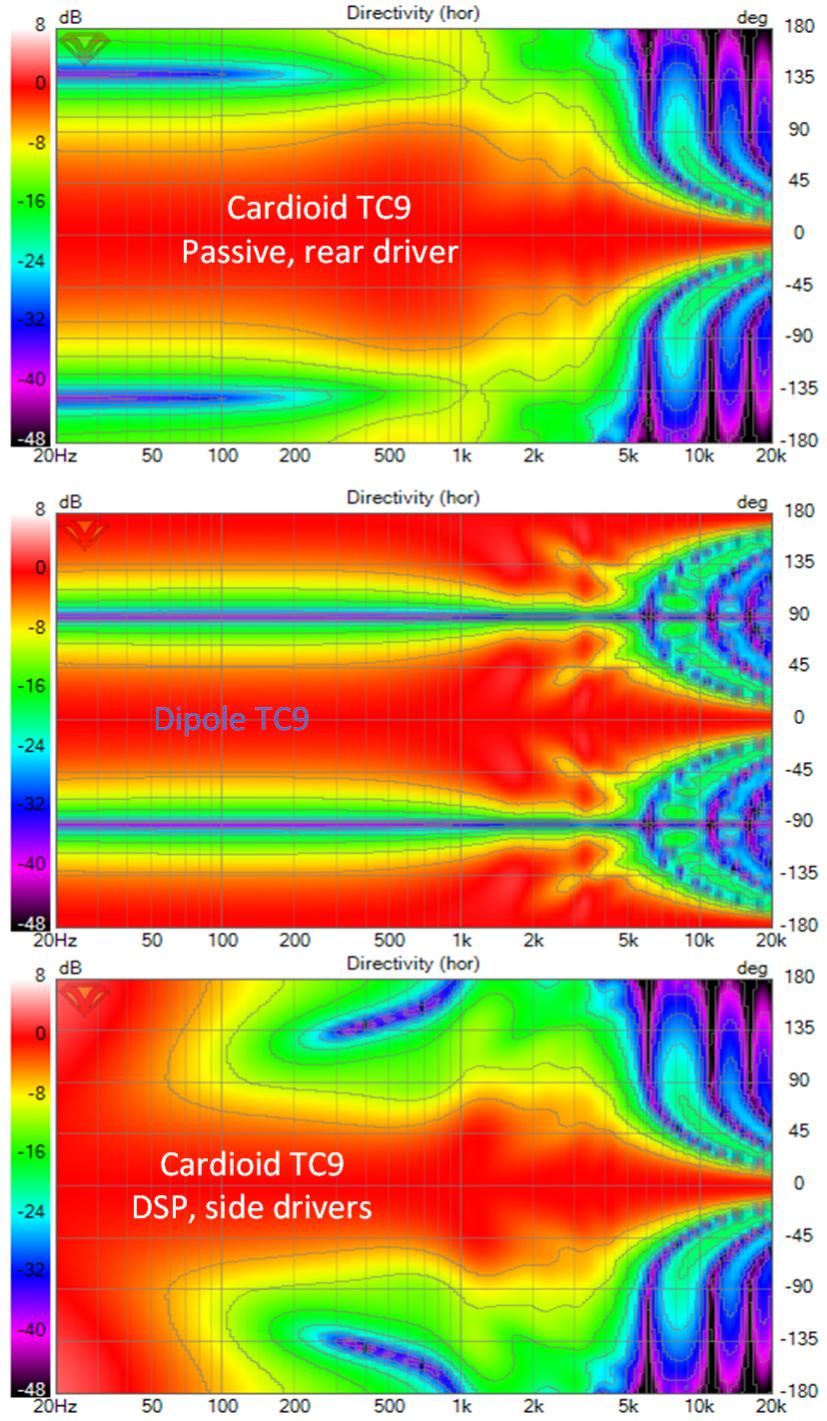

Thinking again of circles of doom, what is it about OB question
Here is comparison of OB and cardioid.
attachment.php
OB gives hard but narrow null out to the sides but obviously has equal rear radiation, which is put to good use in large enough space. Cardioid reduces output to the sides and rear allowing closer placement to walls and corner. The expectation is ambience drivers will provide the desired delayed reflections.

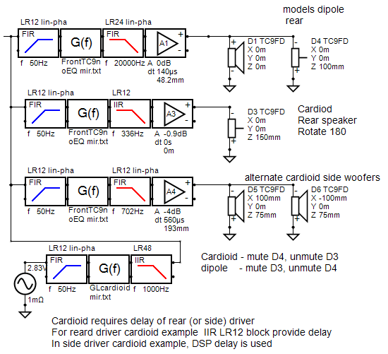

This modelling was done with TC9s. Here is the schematic
attachment.php
Anyone tempted to do a cardioid line array? Using the side or rear drivers to augment front below 100 Hz as in my 3D Cardioid Top, you wouldn't need subs.

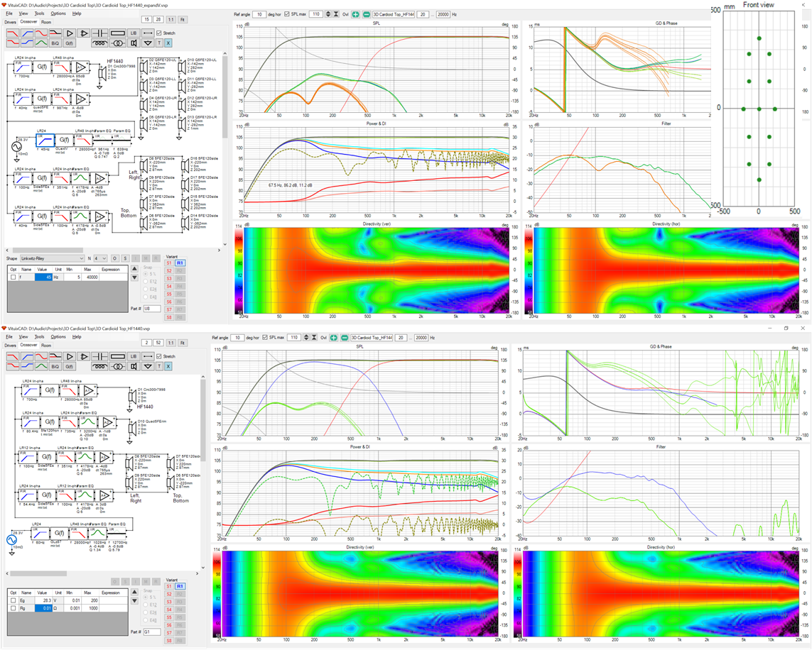

Finally got around to doing a Vituix enclosure model for the front and side woofers in my 3D cardioid top. It took some time to balance contributions from front and side woofers below 100 Hz. Ultimately, I found I had to high pass at 60 Hz to limit excursion to Xmax at 105 db SPL. I was a little bit surprised at that but then I realized that with cardioid response, there won't be any boundary support. What remains surprising is that this seems to be true even below 100 Hz despite the design transitioning to monopole there.

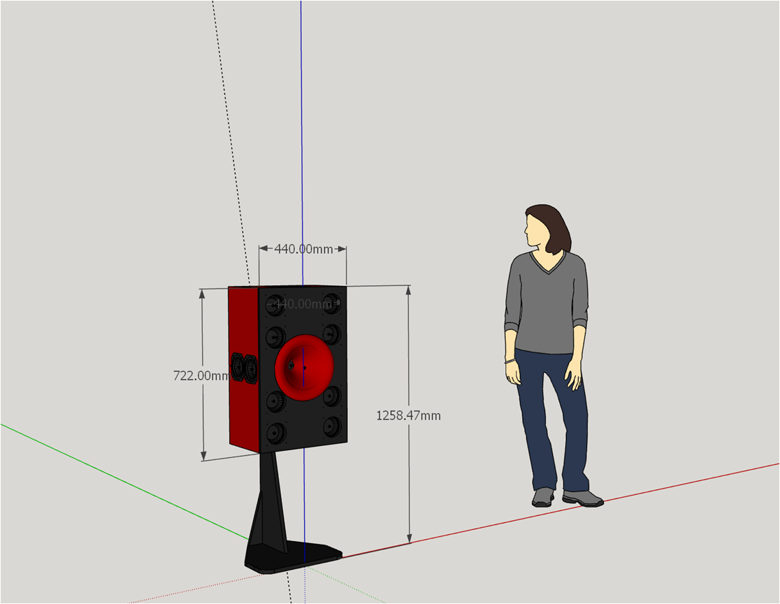

I then asked myself what if I doubled the number of woofers to 8 front plus 8 sides? The added fronts were just above and below the existing fronts. The added sides were placed next to the existing sides; deeper Z, same X,Y. That extended LF to 43 hz or so and narrows the vertically incrementally below 500 Hz.

I still have the 300 Hz floor null, just as wide but not as deep, and I still need subwoofers assisting for a dynamic full range response so to me the extra expense, size, and cost don't seem warranted.
This exercise does point back to where we've been before. If we extend the two columns of midwoofers flanking the waveguide to floor and ceiling and augment them with side or rear woofers for cardioid response we then have perhaps the ultimate expression of a line array with waveguided tweeter at center.

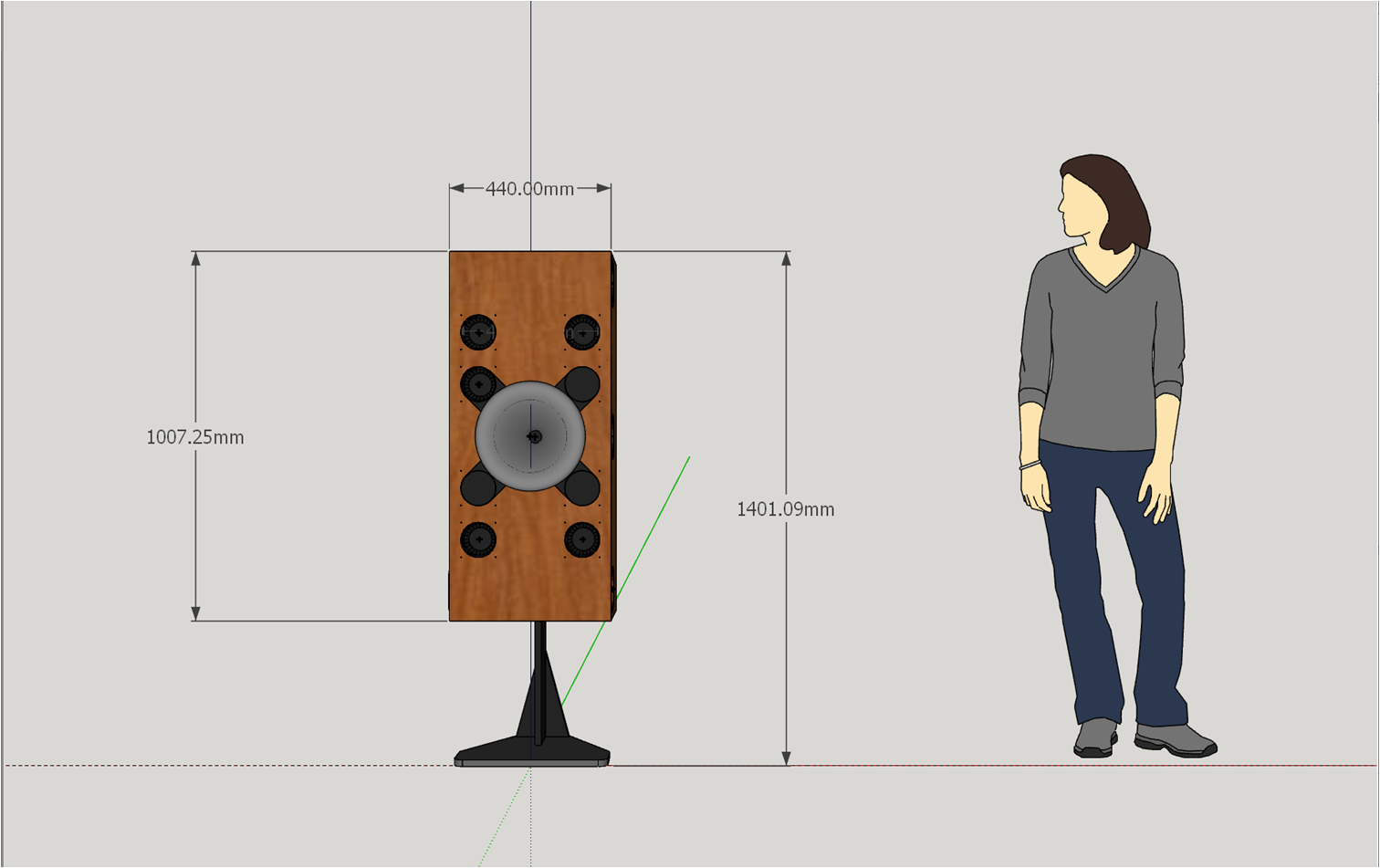

Definitely tempted! My wife wants me to find someone to build them for me so I'm open to proposals. Ever since my quad bypass surgery 6 years ago, she tends to treat me as an invalid, or at least tries to keep me from overdoing it. I'm doing 8 miles or so most days on my inline speed skates (so rehab does work!) but she still cautions me to take it easy each time I step out the door.

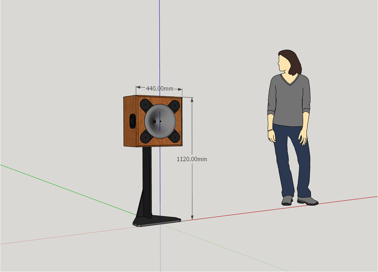

Shrank the volume to make the 16 woofer array more manageable.
attachment.php
I like the higher directivity of the 16 woofer version below 500 Hz. Its pretty much immune to early wall reflections when toed in near a corner. Its going to weigh about 75 lbs. I wonder if that is too much to put up on a stand.

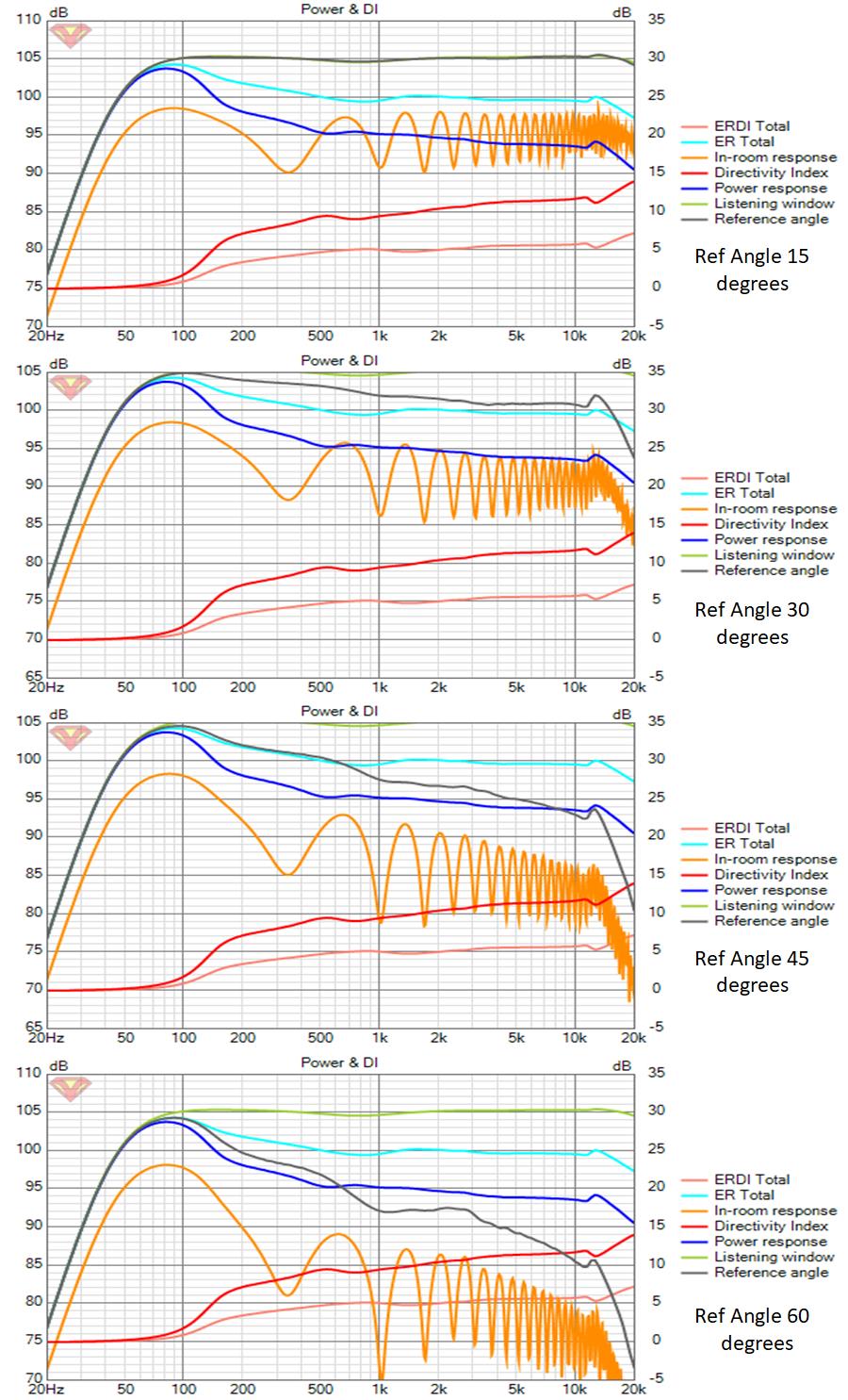

The ASR thread, Toole state the importance that the far off axis response, which gives rise to lateral reflections resemble the on-axis response in order for the reflections to be beneficial. Here are the simulations of my far off axis responses:
attachment.php
I show power and ref angle responses at 15,30,45 and 60 degrees. EQ was done at 10 degrees. At 30 degrees, the fringe of the beam, response is down a few degrees. There is progressive loss of treble the further off axis one goes. However, the power response does not show this because there isn't much power above 300 Hz more than 30 degrees off axis because of the directivity.
The in-room responses include only the floor reflection.
