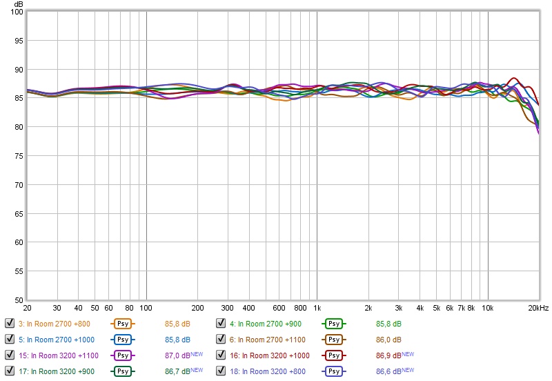

@fluid - I appreciate the tough criticism; I wouldn't make progress without it.
The narrowing/directivity mismatch is on purpose to get rid of monster early reflection circa 320 Hz. If I change the XO to the woofer from 475 Hz to 250 Hz. I get this response:
Letting the right amount of energy in the right phase through the bottom woofer and compensating by taking some away from the MTM pairs above it reduces that floor reflection null with little effect on the polar map.
A better job could be done of smoothing the room and power responses at the expense of each other but at this stage I'm satisfied with seeing that it can be done. I wonder what I would do in room where I won't get to see the power response so easily.
These responses are on a waveguide model shortened from 160 mm to 140 mm, which seems to affect only the very high end response. The peaking there in the longer/deeper version has been replaced with a rapid drop off off axis. I don't really believe it; I think the response there is more likely some kind of numerical anomaly as there is a kind of butterfly effect with length. Latest 2 hour abec sim at 120mm indicates I can shorten it further.
Afterthought on simplicity: Reducing the DMA45 array to 8 drivers was a big improvement. The bottom woofer can be left out entirely and replaced with separate sub(s). what one gets is a "top" with a floor reflection null at ~320 Hz with the vertical pattern starting to widen at 500 Hz, as does the H pattern. The purpose of a 3 way is to eliminate that null. I ended up with 4 ways because I chose to add the rim slot array to extend H pattern control an octave lower and eliminate vertical pattern flip for the asymmetric waveguide. Still a little complex for comfort but OK as a science project.

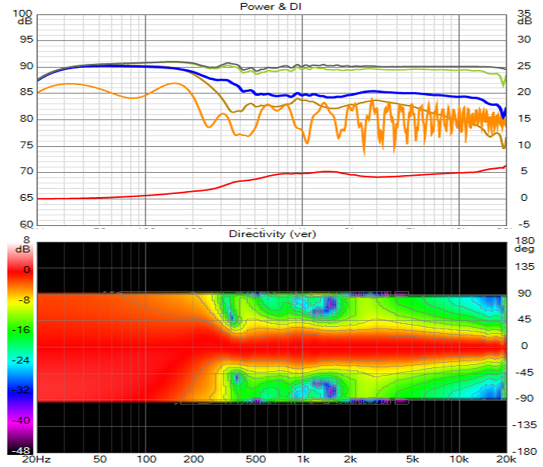

I guess the reason I've focused on boundary reflection nulls is the strength of my recollection of how difficult they made my crossover development for my Synergies using inroom measurements. Turning on reflections carried over from line array simulations where they are needed to model the line array.

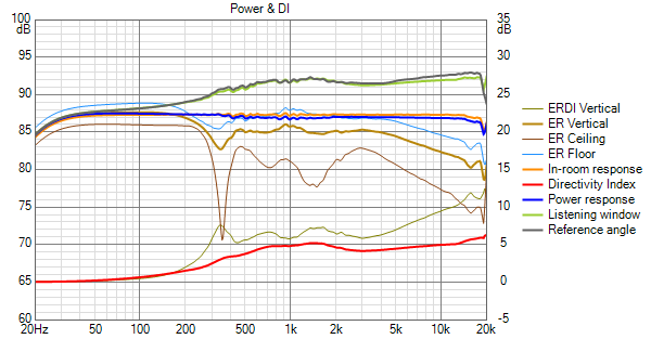

In Vituix, the in-room response without reflection boxes checked is the CTA-2034 PIR. If I uncheck the reflections, I see the PIR overlays the power response curve. If I then equalize the PIR, modelling equalizing an in-room measurement, I get this:
Now the predicted in room response and power response are flat but the axial response rises a total of 8 db over 20 to 20 khz. The reasons it rises is due in part to the waveguide. Thus your comment about the waveguide is right on.
Above 2 khz the waveguide, while flat horizontally, narrows vertically. Below 500 Hz, the system's horizontal pattern gradually widens. Below 200 Hz, the vertical pattern widens quickly. This accounts for the lack of bass and lower midrange in the axial response. Is that problematic? The early reflections that cause it are early enough that it may not be; especially with the speaker tight in a corner.

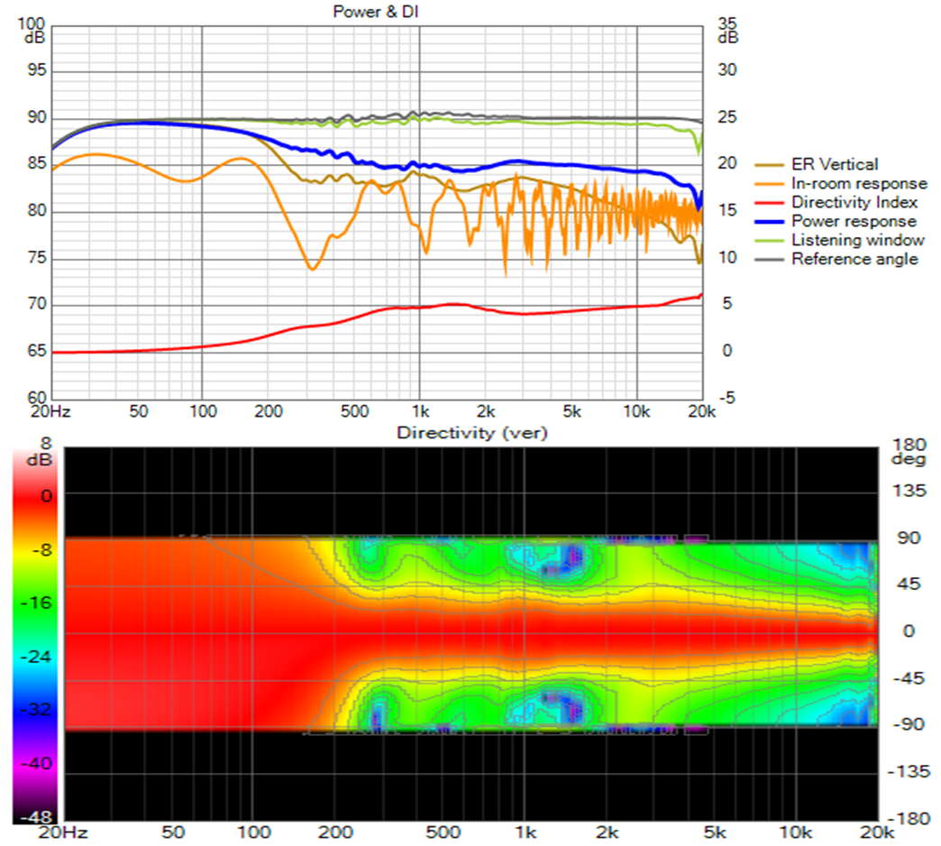

As to the high end of the spectrum, I've been running sims looking for a better DI within the baffle footprint. The length of the waveguide doesn't affect that. I will look at the Coverage.Angle formula next; suggestions welcome.

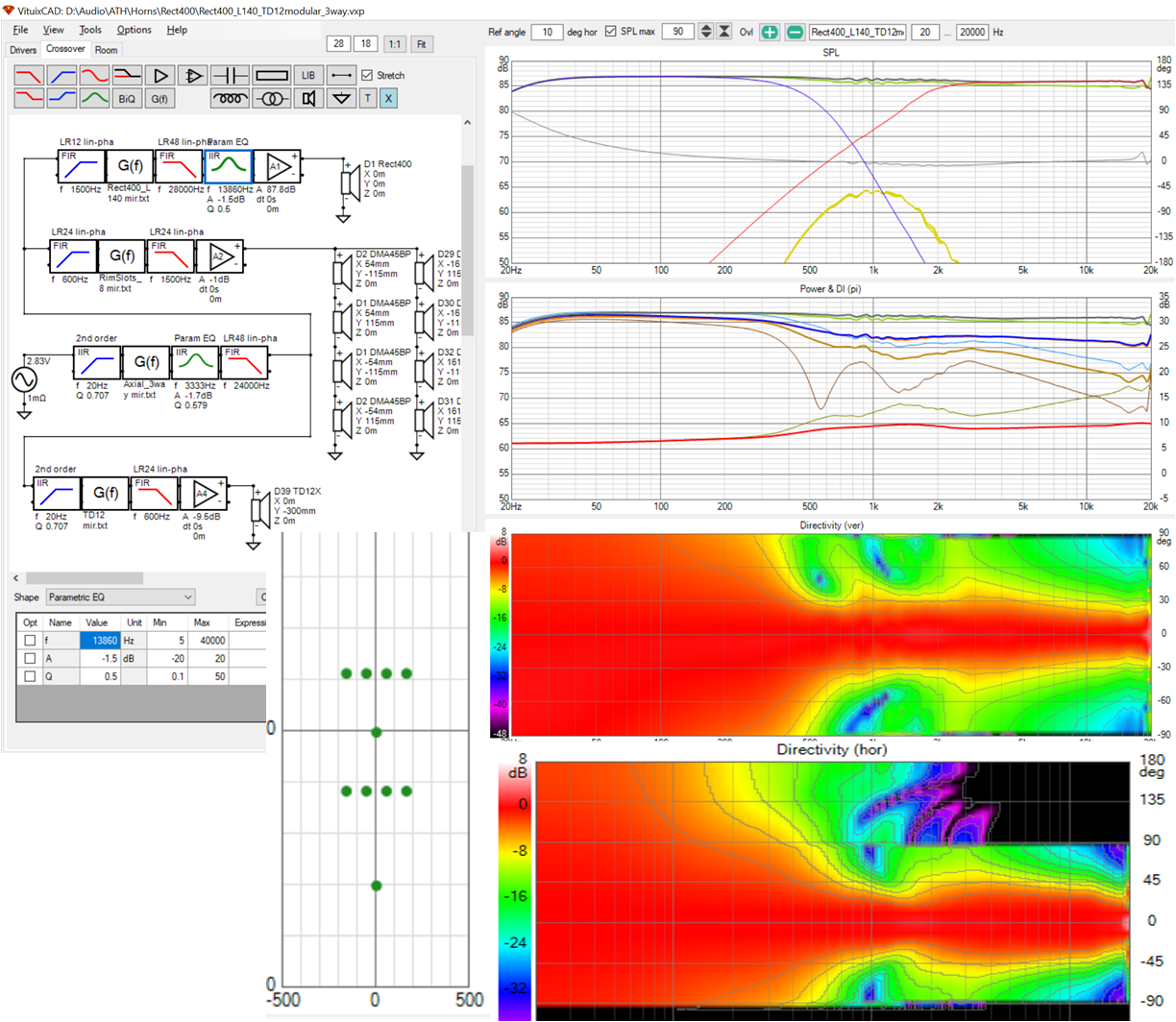

A look at the TD12 3-way equalized the same way.
The TD12 is now as close below the waveguide rim slots as I can get it. This plus lowering the XO to the rim slots almost eliminates the narrowing near crossovers. The DI and power response are as flat as I've seen them, with a 1 db tilt in the axial response to make that happen.

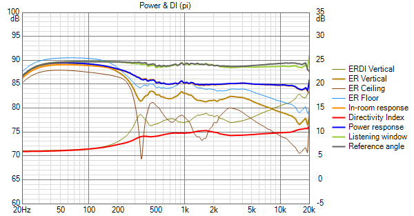

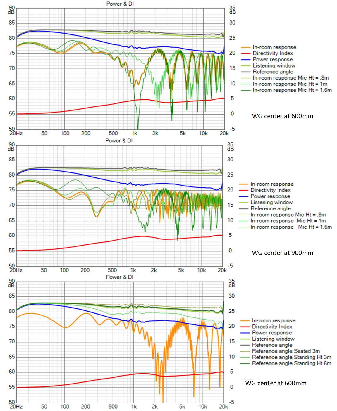

The Power response and DI are the inverse of each other so if you EQ the power flat the axial will be the same shape as the DI.
The more asymmetric the shape the harder it is to avoid a scoop in the DI as the frequency goes down. The vertical looses control too early. To closer match the DI in the array sim the overall directivity needs to be higher by a few dB. Narrowing the coverage might get you there.As to the high end of the spectrum, I've been running sims looking for a better DI within the baffle footprint. The length of the waveguide doesn't affect that. I will look at the Coverage.Angle formula next; suggestions welcome.

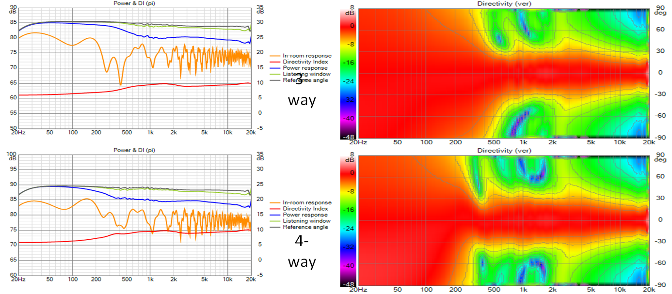

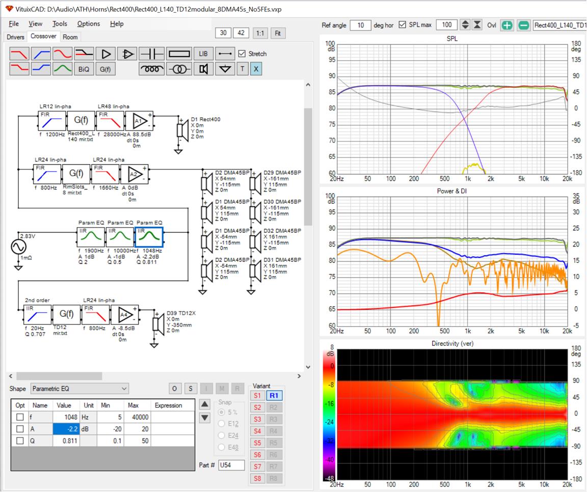

Spending more time on equalization, I've got the 3-way and 4-way responses looking very much alike, until I enable wall, floor and ceiling reflections. The 4-way is marginally better below 1 khz; beyond that I think the differences don't matter or would disappear with more work on the EQ.
I ask myself: based on this is the extra complexity of the 4-way justified?

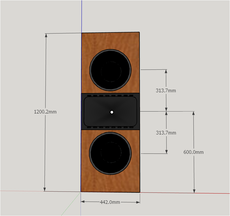

Dual TD12s MTM style has better vertical control as well as smooth DI but its still a 3-way.

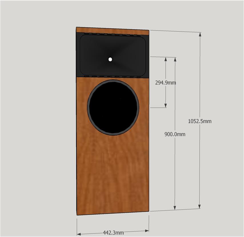

If I keep it down at floor level, which puts waveguide center at the rather low 600mm, the first floor null moves out to 1 khz where one expects such nulls to be filled in by the ambient sound field, reflections, modes,. (Top graph below)
I did the bottom graph because I realized the axial response changes slightly but significantly for seated vs standing. Standing up at 3m some treble is lost but not at 6m (bottom graph below)
If the waveguide center is raised to the original 900mm, the first floor null near seated is at 300 Hz where its harder to treat should treatment prove desirable.
Once again, I see I could have done a better job of equalization but now realize that its because these exported images are stretched vertically compared to those on screen.
