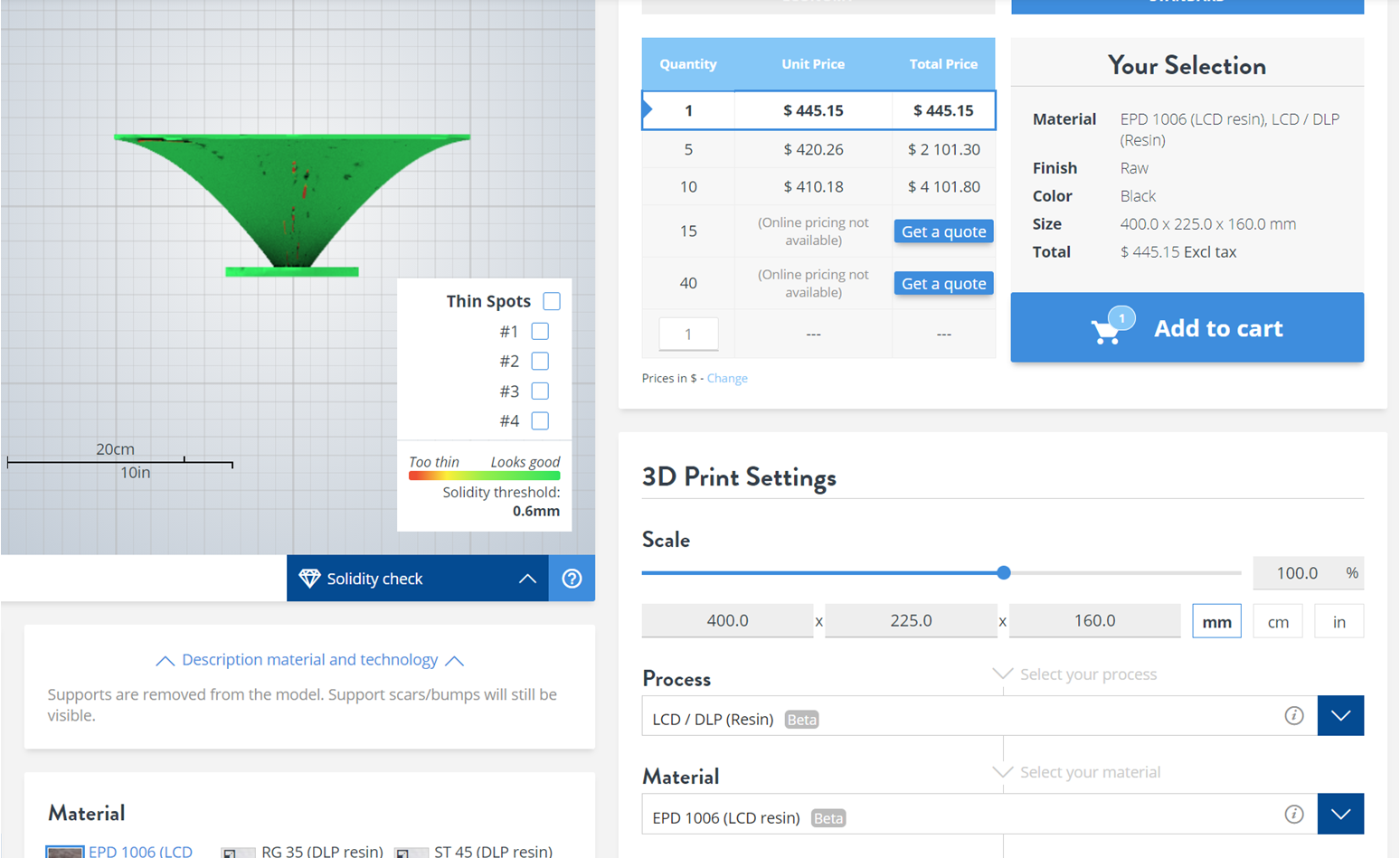

To get a quote on my waveguide, I thickened and added CD mounting ring. The 480mm waveguide came in at almost $1000. I quickly scaled the thing back to 400x225 resimulated and requoted. The new quote was $445. But their error/quality checks indicate I need to improve my CAD process for prepping for 3D printing. I have no idea about the suitability of the material they are quoting; options are limited due to waveguide size unless its printed in sections.
attachment.php
If anything, the smaller waveguide provides better performance.

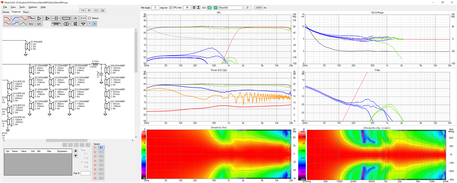

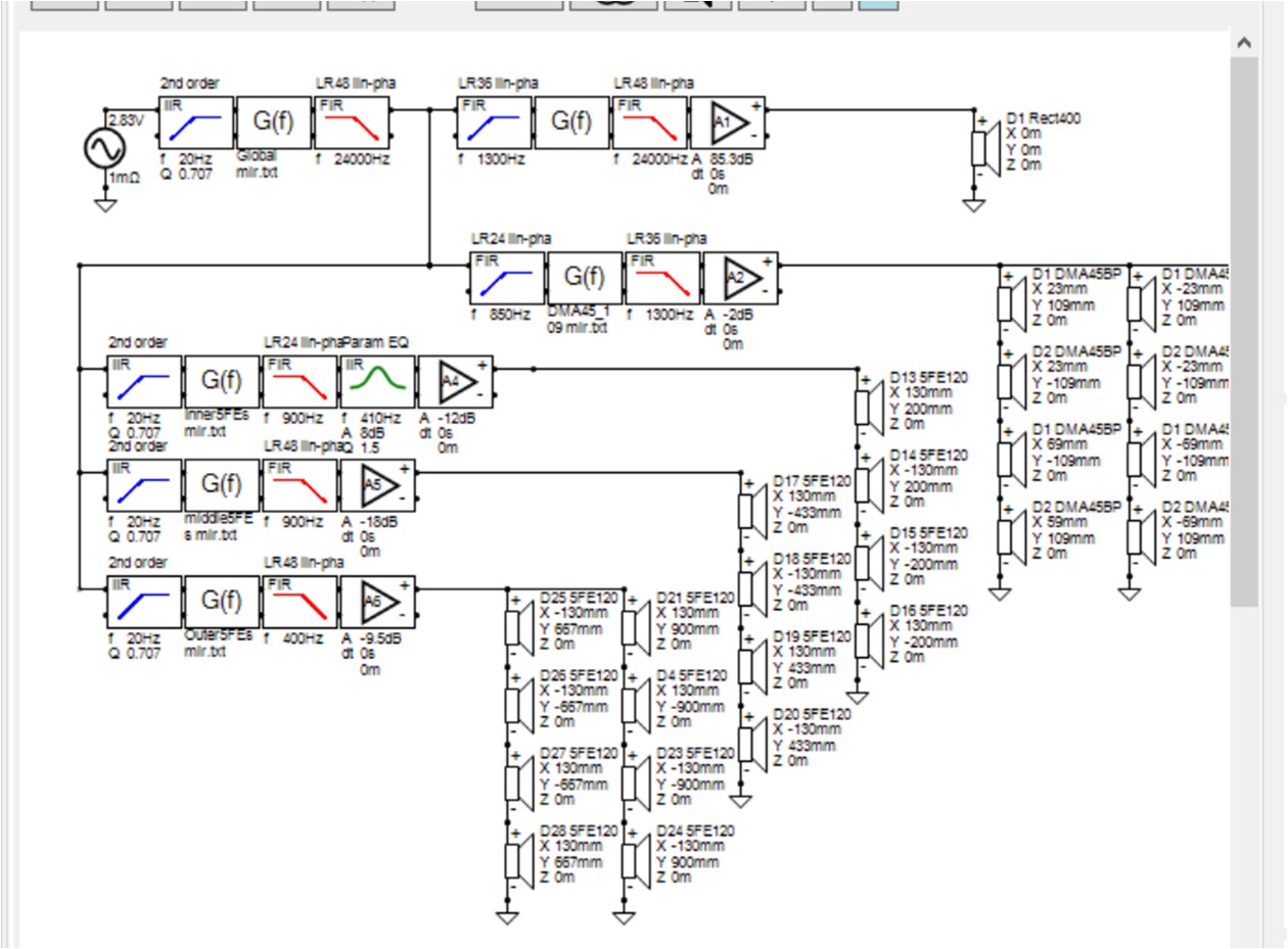

The horizontal narrowing at XO has been reduced greatly by adding 4 more DMA45s with a passive 2nd order low pass from the other DMA45s that I used to adjust the beam width. Chances are I could reduce the number of these drivers by spreading perhaps just 8 of them out, finding the ideal spacing.
XO frequencies were raised and some overlap introduced. Details are visible below:
attachment.php
Crossover to the waveguide is now at 1300 Hz. I would like to raise it still higher but vertical sidelobes from the arrays appear if I do. This tells me I probably can't shrink the waveguide further, at least not without changing the approach. I'm fairly happy with this size. The baffle will be 412 mm wide and the weight won't be much over 100 lbs.

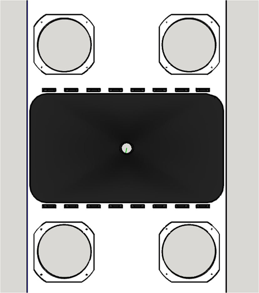

I've been doing some cabinet drawings to provide a dose of reality. Here is a close up of the bare baffle showing the rim slots. On a black baffle, they would be invisible.
attachment.php

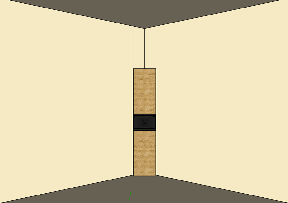

Here is a view of the completed system design tucked away in a corner with the woofers behind grill cloth.
attachment.php
Ceiling height is 9' and viewing distance is 8'. The array is 1950mm x 412mm x180mm with a trapezoidal footprint. I'm hoping that with grill cloth matched to the wall color all one would see would be the waveguide.

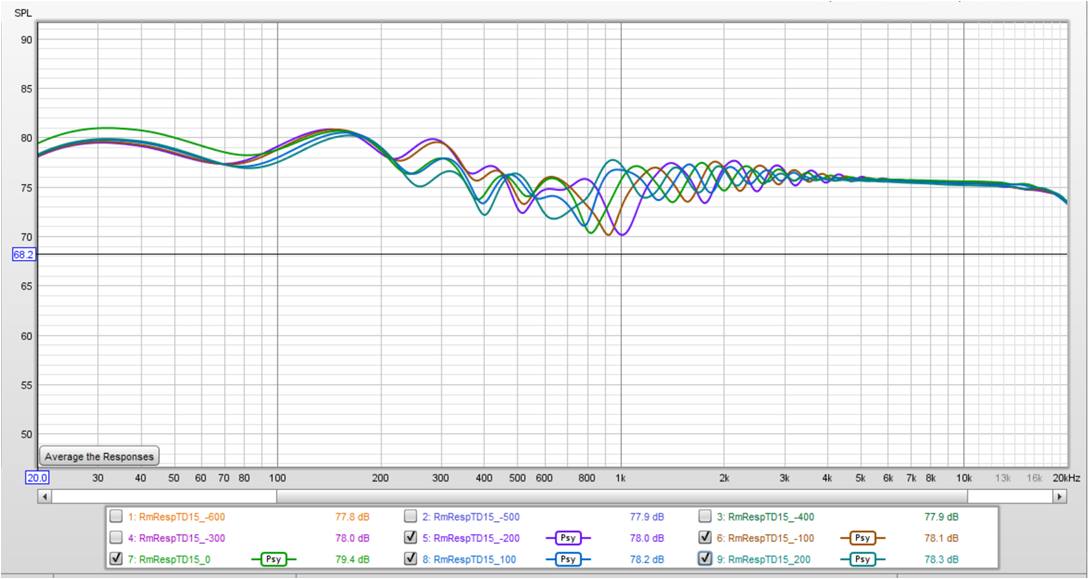

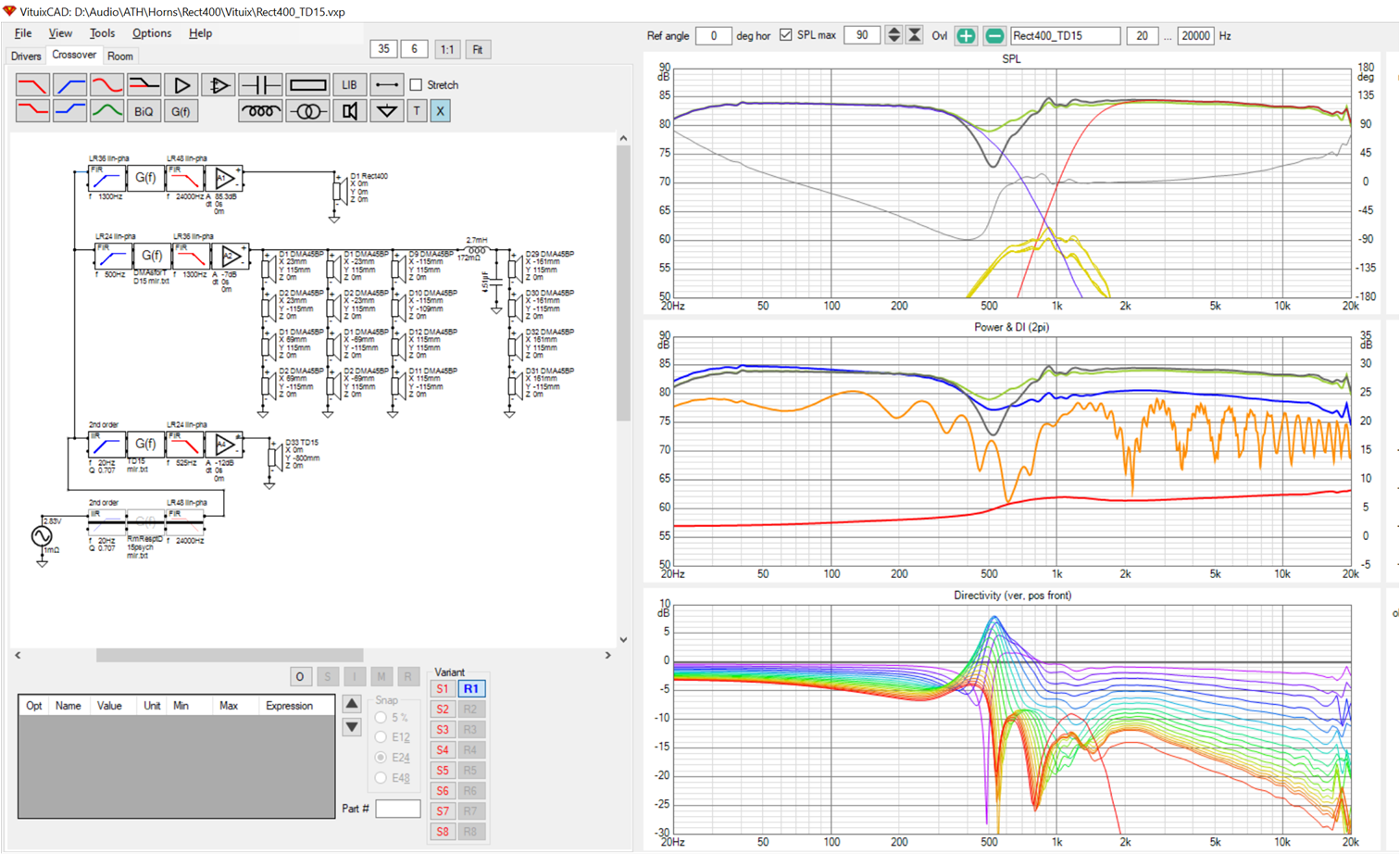

Sanity check: what if I replace the 5FE120 array with a TD15 at floor level?
attachment.php
The screenshot was taken with a driver offset of -600mm, representing standing listening at 3m distance. The response is fairly good around the seated position but falls apart at the XO between the rim slot array and the 15" woofer when you stand up.
attachment.php
The variation with vertical offsets around seated shown above peaks at +/-3.5 db near 1 khz. This is about 2x what is seen with the 5FE120 array in place of the 15" woofer.

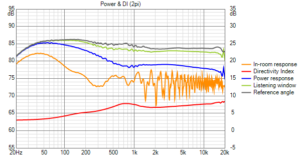

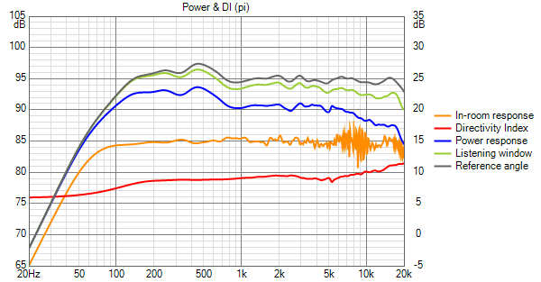

To me that last analysis proved that the extra complexity and height of the full 2m tall H-array was worthwhile. That being the case, how should it be equalized? This is what happens if the power response is equalized to a slowly falling target.
attachment.php
I should probably have a dip in the power response complementing the rise in the DI curve to flatten that axial peak....
I'd take the listening window as base. But actual DSP in room I'd base on single point measurements (just like with a full range array) seeing how close listening window is to Reference angle.
That's why I simulated my full range array with actual mirror copies acting as floor and ceiling mirror. That gave me a preview of what to expect in-room and determine a good way to target it with DSP tools (frequency dependent window based EQ plus some tweaks in my case).
If you are measuring at the LP in room, then you are measuring room response by definition and have to "filter" the room out of the measurements by averaging and windowing. In simulation, the LW and axial and power responses are presented directly.
I'm wondering which of these responses should ideally be flat and looking for a high degree of correlation with them and the room response. Room response appears to match the power response if reflections are disabled in the room tab, with floor reflection having the largest effect. Perhaps this is why line arrays sound so good - they aren't affected by the floor.

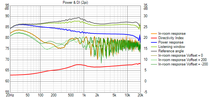

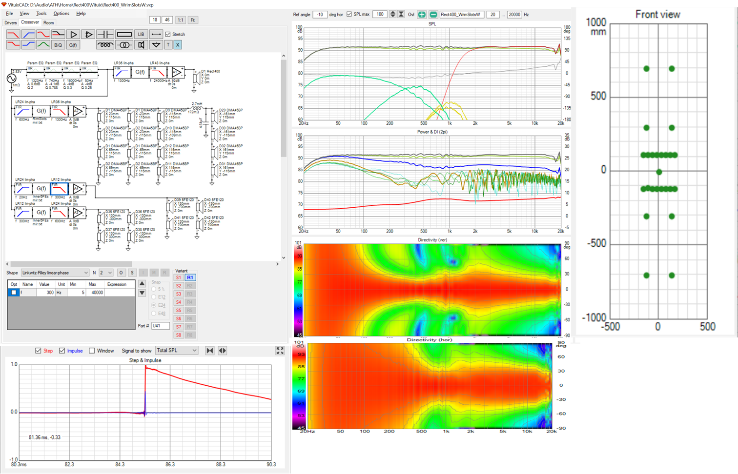

Here is a 4 way W M RimSlot WG RimSlot M W
attachment.php
The room response overlays are for offsets of +/-200 mm and -600mm. Its incrementally better than the 3way with 16 of the 5FE120s as the 3rd way and it needs less room equalization.
But both those designs are trumped by my coarse frequency shaded SB65 line array - if you look solely at the room response curve
attachment.php
room response overlays are +/- 200 mm vertical offset

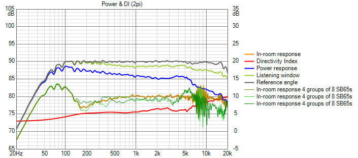

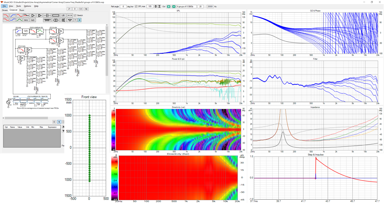

Here is the current state of my line array simulation
attachment.php
what I used to call coarse frequency shaded has been made finer by the incorporation of 4 inductors into the crossover to create 8 groups of 4 drivers.

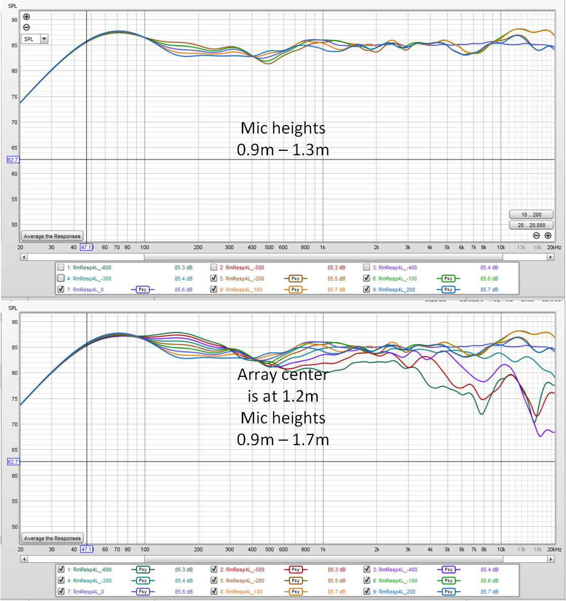

The room response overlays are for +/-200mm and -600mm offsets from center. More detailed response vs height
attachment.php
when room response is eqed to the average +/-200mm around center, this is what results on axis and in the power response:
attachment.php

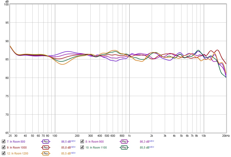

I believe that (small) DI elevation is due to the shading, a consequence of my latest changes adding the inductors and adjusting them to flatten the -5 degree line on the vertical line chart - a compromise I have no way of evaluating short of listening. At least I'm getting a feel for what affects what.
I believe if you'd allow a little more overlap, you'd be making the vertical beam a little wider. Overall leading to better/more consistent behavior over the area of interest, even though the on-axis would (probably) show a tiny bit of wiggling due to there being more interference overall.
In the end if the height variation is less, I'd still call it a win. At least, that has been my focus.
attachment.php
Psy smoothing used on a 40 cm height variation plot with 0 dB attenuation on floor and ceiling.
Do you have a plot of the unshaded 32 driver array to compare the two?

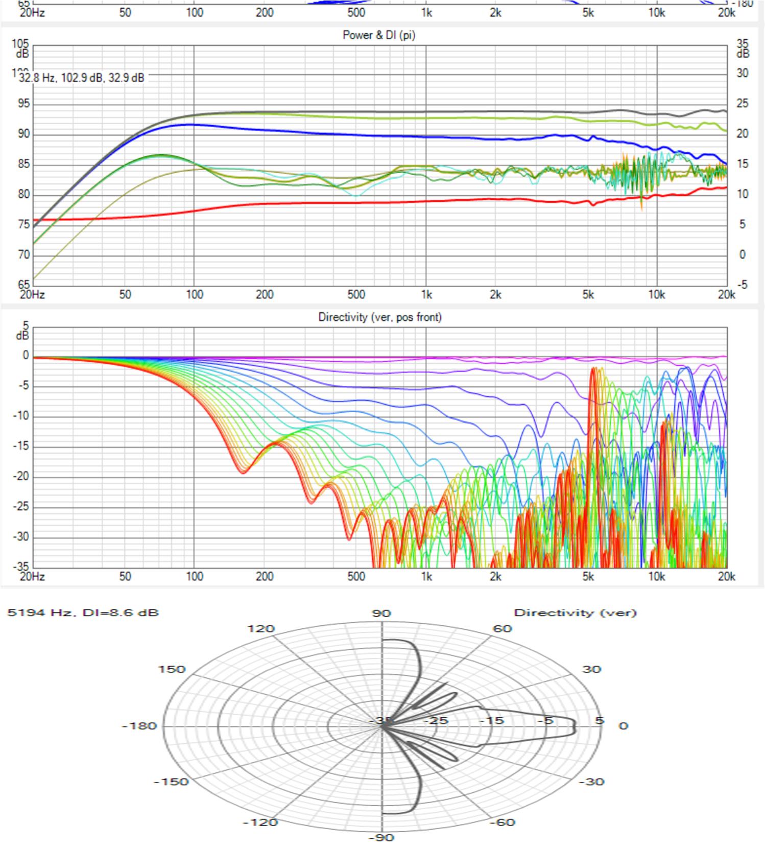

The rise in the power response seems immune to shading changes. Instead its correlated with the huge vertical sidelobes you see in the line and polar charts. Not surprisingly, the 66mm driver spacing is the wavelength of 5212 Hz.
