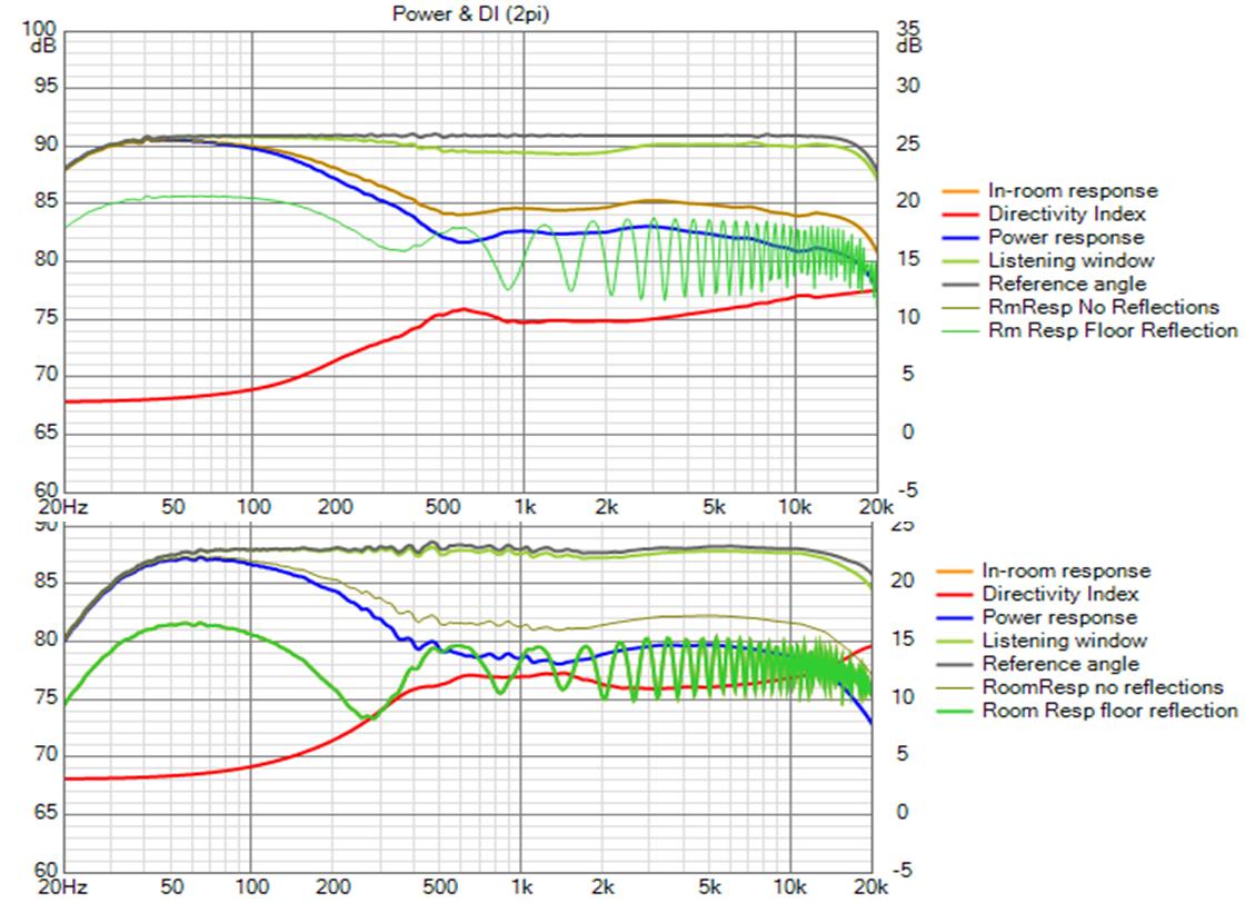

I was able to come up with elliptical waveguides that were good enough to evaluate the concept fairly quickly. The reasons for looking at expanding array with waveguide at center include controlling H directivity to minimize boundary interference from the walls.

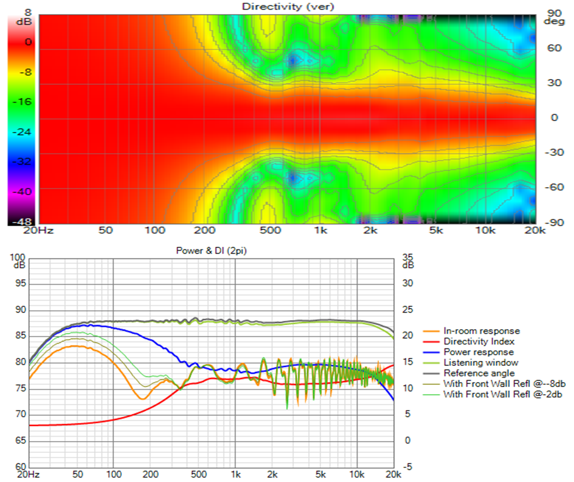

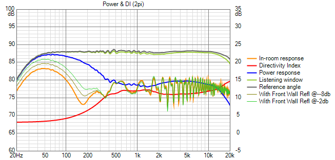

For comparison, I'm showing in room response below for my coarse frequency shaded line array (uncontrolled H directivity) with the new expanding array using an elliptical waveguide that is 480mm wide by 272 mm tall
First, the coarse frequency shaded SB65 Line Array
Now the waveguide expanding array
I think that is a worthwhile reduction in sensitivity to the wall!
Note: the ref angle and toe in were chosen so that the reflection point was in front of the baffle; else Vituix would not have included it in the response.

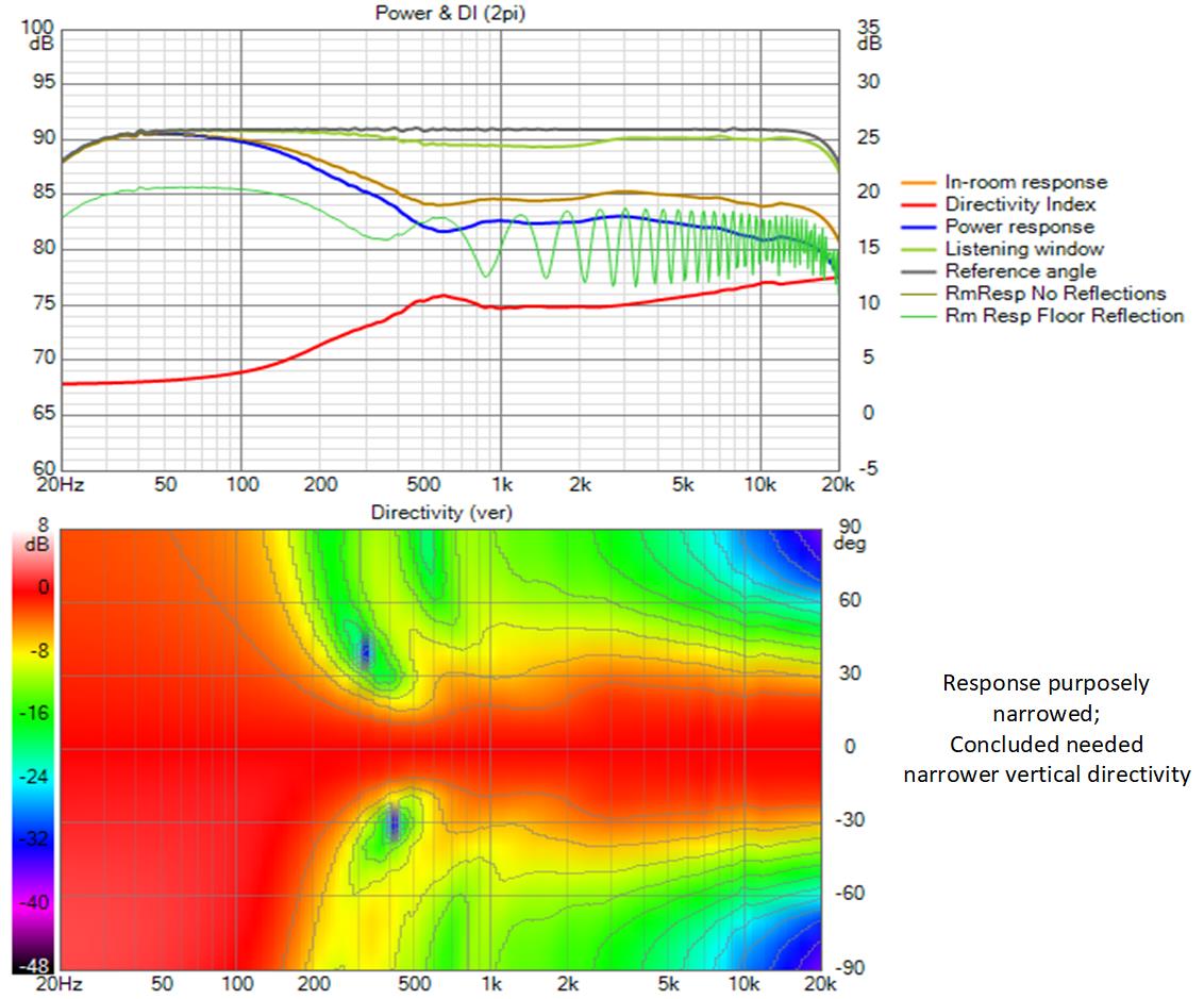

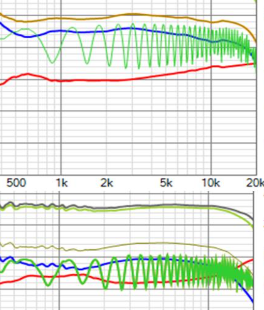

Before going to elliptical waveguide, I simulated with Fluids HF1440 472 mm diameter axisymmetric waveguide and concluded I needed a wg with narrower vertical directivity:
the round wg:
narrowing the vertical response near XO via overlap did improve the floor response but the shape of the vertical polar response is hardly optimal

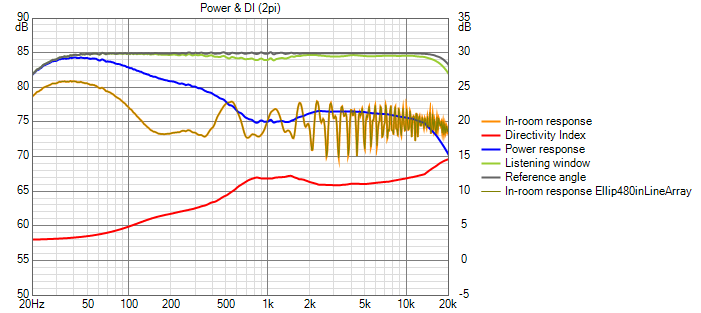

by contrast, the elliptical wg:
whoops the elliptical had both floor and ceiling. Here are both round and elliptical together each floor only, round on top:
The elliptical is clearly much better. Pattern flip isn't an issue when the asymmetric waveguide is incorporated in an expanding array because the array controls the vertical response (but only down to about 200 Hz because the array as simulated isn't floor to ceiling).

the round wg:

The vertical is a better match and has minimized the lobing at crossover seen before but the DI and power response is now worse. One good thing about the straight array is the rising DI with no real lumps or bumps.The elliptical is clearly much better.
I understand the desire for an even vertical response but I would not prioritize it over the horizontal or overall power response myself.
My "better" was in the sense of the wg's ability to reduce the floor reflection. As it contributes only above its XO of 1200 hz, the big hump in the power response is not due to the waveguide but to the array only having been expanded in two steps. The (elusive) goal is a vertical pattern enough wider than a line arrays to allow standing height response to be good after equalization at seated height.
Is it fair to criticize a corner speaker for its rise in power response in the bass when that rise is doe to corner support? The corner is acting as a bass horn and if one were to measure the power response, the measurement would follow the Vituix room response curve, which would have been equalized flat, and therefor show a flat power response.

I don't think you understood what I was pointing out.
The differences in power and DI are these sections below. In the one with the round guide the power response is generally going down with a couple of dips and maybe a slight rise. This looks pretty good to me apart from the glitch where it doesn't match the array directivity.
In the elliptical one the power response tends to peak through the top of the midrange which I suspect will be audible in a bad way that EQ won't fix. Below 3K the elliptical waveguide is loosing pattern control which is causing a mismatch in the overall power response below that point.
In your coarse shaded array on the page before there is a pretty nice power and DI curve up to about 5K. This is simulated in the corner?
With the waveguided sims both have the same more significant bass rise, this is not what I was talking about but it is interesting now you mention it as the behaviour is different to the shaded array and I am assuming they are all simulated in the same position.
You are correct, I didn't understand your point. I was too distracted by that big hump in the power response. I do understand the desire for ideally flat but if not flat then smooth power and DI curves; what I don't have a feel for how much deviation from the ideal is tolerable.

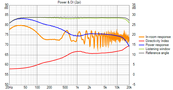

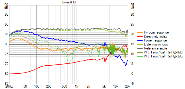

Here is my current state of the art with line array mid bass with a hole for the elliptical waveguide and TC9s
Its got more smoothly rising DI and falling power response with a wide 3db dip around crossover.
My take from reading research is that dips in the power response are quite benign but peaks are not good. I suspect that smooth is more important than flat for DI and I also suspect that slightly rising DI with a flat on axis response would be preferred. Flat vs rising is something I want to test with different horns.

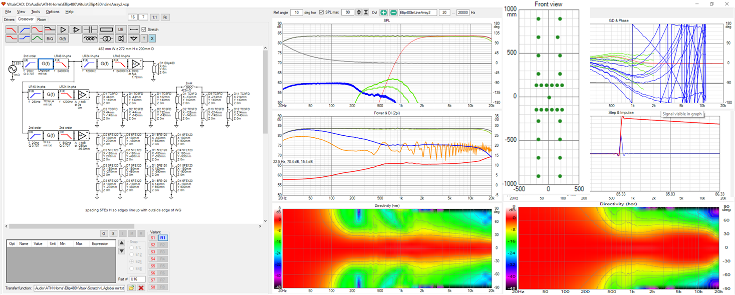

Further optimization...
I guess you could call this an expanded array - to the wg + 12 TC9s +16 5FE120s. Its also stretched out to almost 2m tall. The outside edges of the mids and woofers are positioned to line up with the outside edges of the waveguide.
By squeezing the initial 4 TC9s together and adding a shaded pair at the ends of the rows, I was able to take out most of the dip near XO in the H polar map
By playing with overlap range and slopes, I was able to almost completely take out the XO dip in the vertical polar map. Surprisingly, I ended up with an IIR low pass on the 5FE120s, which was a large part of the improvement. Were it not for my philosophy of trying everything when desperate🙂, I would not have found this.

That looks better 🙂 I see the reason for the rapid rise in the power response is due to the rapid loss in horizontal control below 500Hz. You might try some drivers bigger than the 5FE's but smaller than 15's on the outer, I think that would blend it better but this speaker has already become quite a monster size. What does the horn look like?Further optimization...
